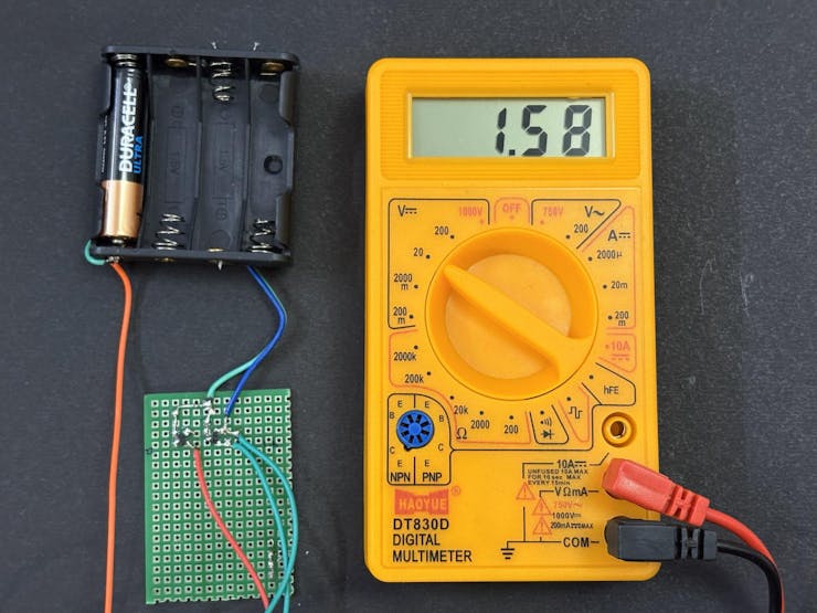

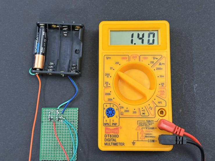

The two-step voltage SOC verification is required because fresh alkaline cells can read anywhere from 1.55–1.65 V. Mid-life cells still sit around 1.3–1.4 V. Under load, voltage droops heavily and recovers slowly. Temperature and internal resistance dominate the reading. With only voltage measurement, we can reach up to an accuracy of ±70–80%. So, we need more information than measuring voltage alone.

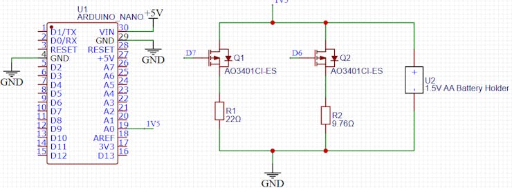

The idea is to use two known load resistors, Load 1 with 22 Ω and Load 2 with 9.7 Ω (2*4.7 Ω + offset. The values are not random, but at full swing, change should produce ΔI = I{9.7} - I{22} greater than 80 mA for better resolution over the range. What happens at the cell level is:

A better approach can be used with the use of a constant current load, but it comes with additional BOM and cost. However, it will make the measurements too easy. I will share one example in the end. This will drive the MOSFET into the saturation region, so when two constant currents flow, it will compute the voltage drop.

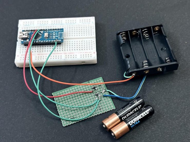

Components Required:
  • P-channel MOSFET
  • Arduino Nano
  • 2* 1.5V battery (one discharged to 50%)
  • 9.7 Ω and 22 Ω resistors
  • Power source
Circuit Diagram:
Here is the circuit diagram. Just with 4 components, you can build this circuit. Now all the computations are done with the help of the MCU. Q1 is turned on in the linear...
