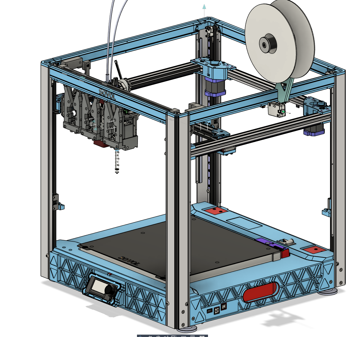

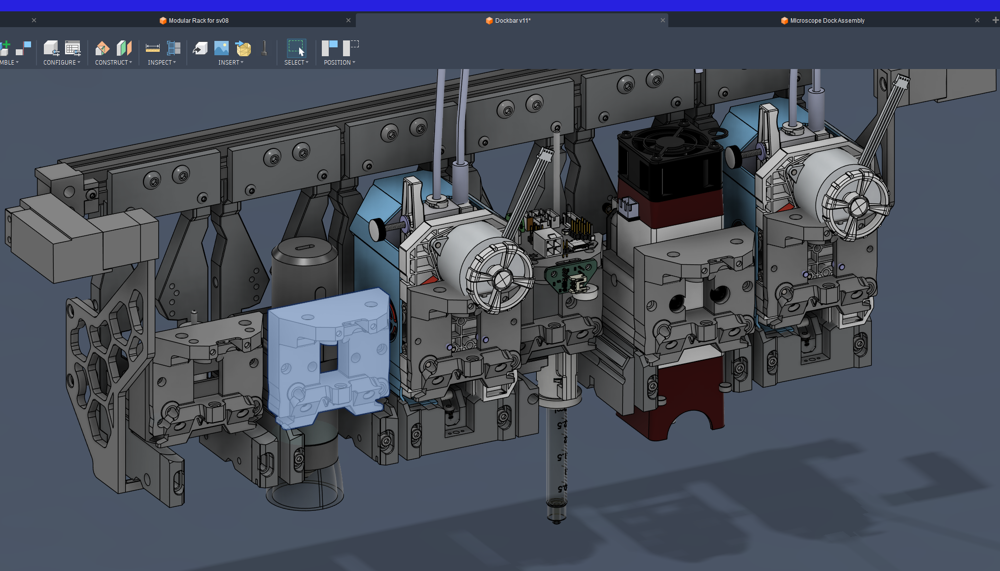

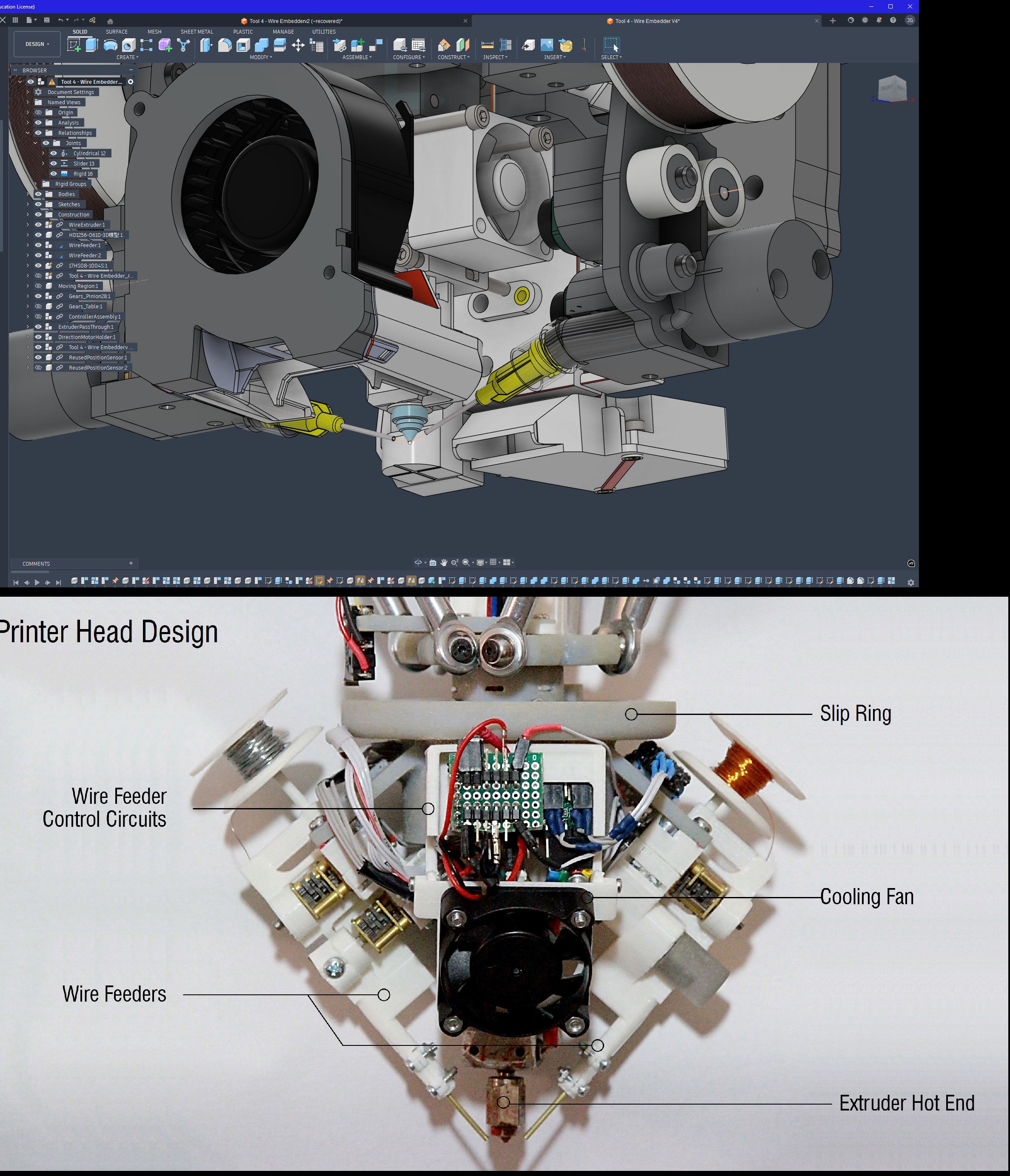

I am building an open-source Hybrid Tool-Changing Platform that integrates six distinct manufacturing processes into a single automated workfl

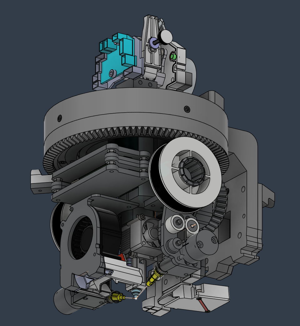

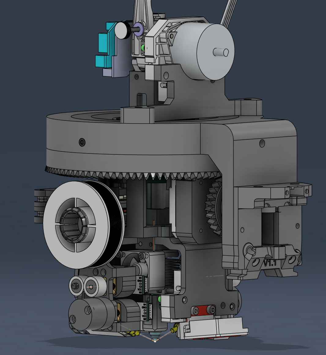

Consisting in a 3d printer that integrates six distinct manufacturing processes into a single automated workflow by using a toolchanger for printing/assembly electronic hardware:
  1. Structural FDM 3d Printer extruder: High-temperature extrusion of engineering thermoplastics (ASA/PC) to create the chassis and dielectric layers..
  2. Laser Sintering (10W): used for the in-situ reduction of metal-oxide inks, synthesis of Laser-Induced Graphene (LIG), and precision cutting/engraving of masks.In-situ reduction of Copper Oxide inks and synthesis of Nickel-Graphene sensors (LIG), laser engraving and cut.
  3. (Future goal/ outscope / pending) Direct Ink Writing (DIW): Precision dispensing of conductive pastes using syringes or inkjet cartridges.
  4. Wire Embedding: Automating the embedding of twisted-pair copper wire for high-current power rails and data lines.
  5. (Future goal/ outscope / pending) Pick & Place: SMD placement of commercial silicon components.
  6. (Future goal/ outscope / pending) In-Situ Etching: Laser-masked acid etching for high-precision copper PCBs directly on the bed.
  7. Drag knife tool / Pen Holder: for cutting copper foil if used or painting silk mask over tracks.

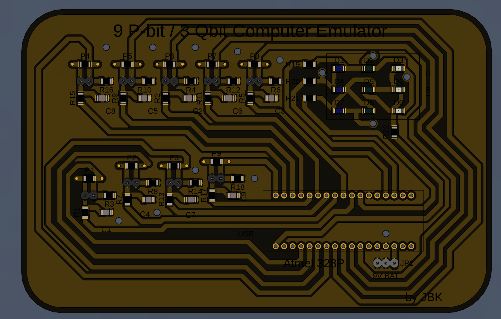

  • Academic / Scientific Hardware: Printing multilayer PCBs, custom RF antennas, Graphene Oxide P-Bit arrays for Quantum emulation, electrodes for Hydrogen electrolysis, mems microfabrication and sensors.

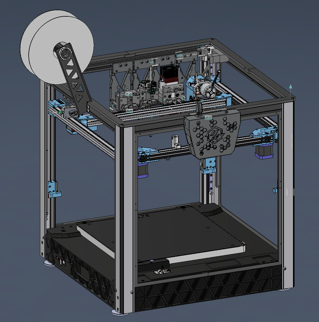

Project Overview
Fusion 360 file here> https://a360.co/4shNm0m
Modular Dock File here> https://a360.co/4rANtCX

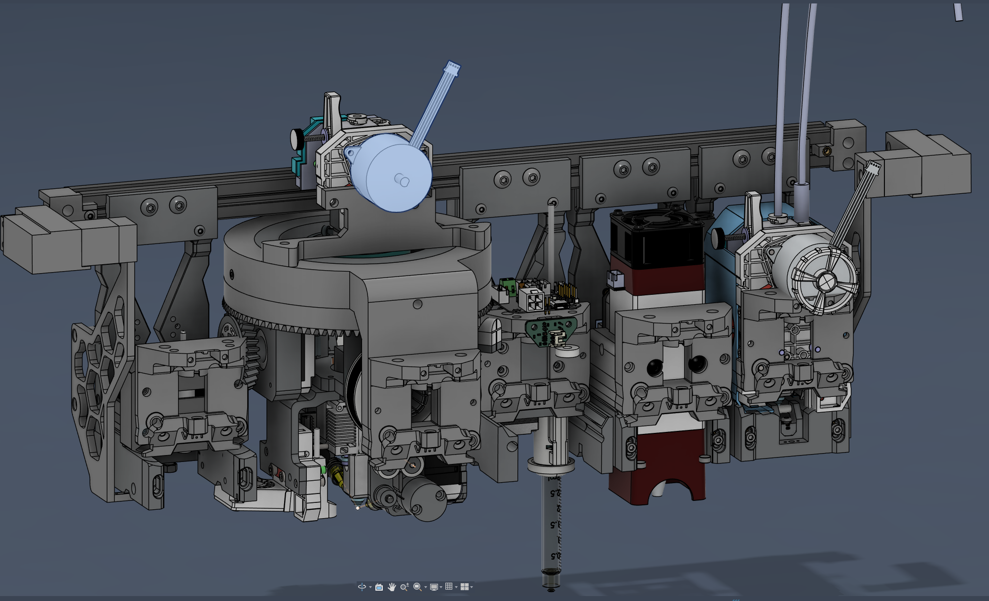

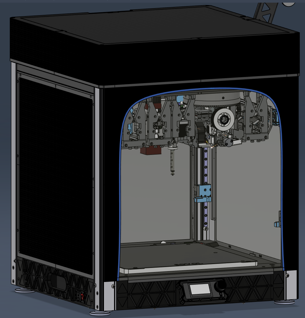

This version is with the wire embedder, but the microscope dock and second extruder is hidden.
This version is> https://a360.co/4cQAOYY
Wire Embedder model here> https://a360.co/4bsdkH0

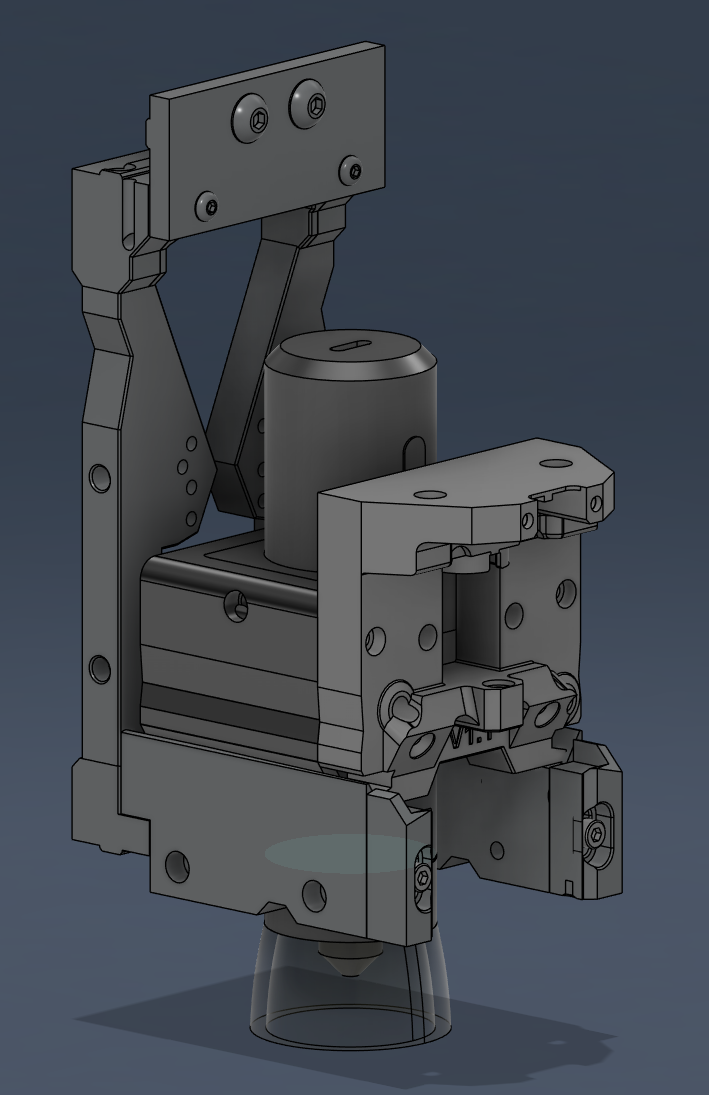

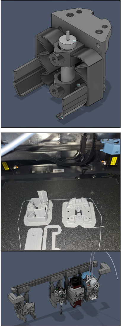

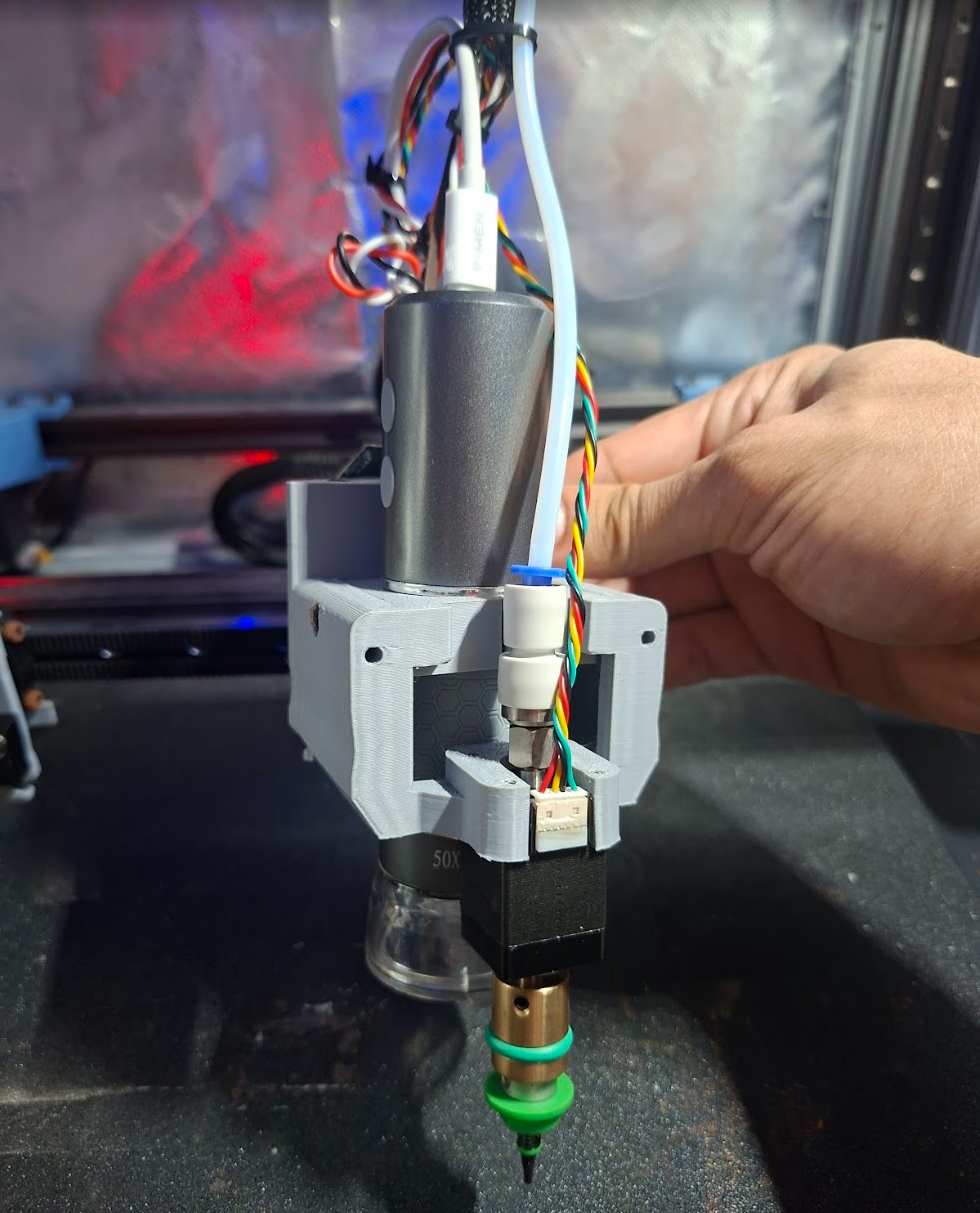

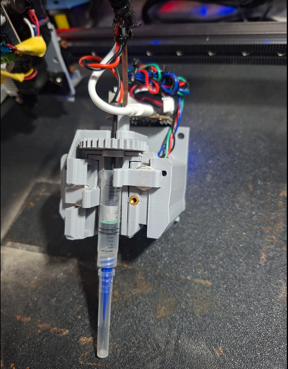

  • Dispenser Redesign and PnP Tool
    Joanbelk08/22/2026 at 18:20 0 comments

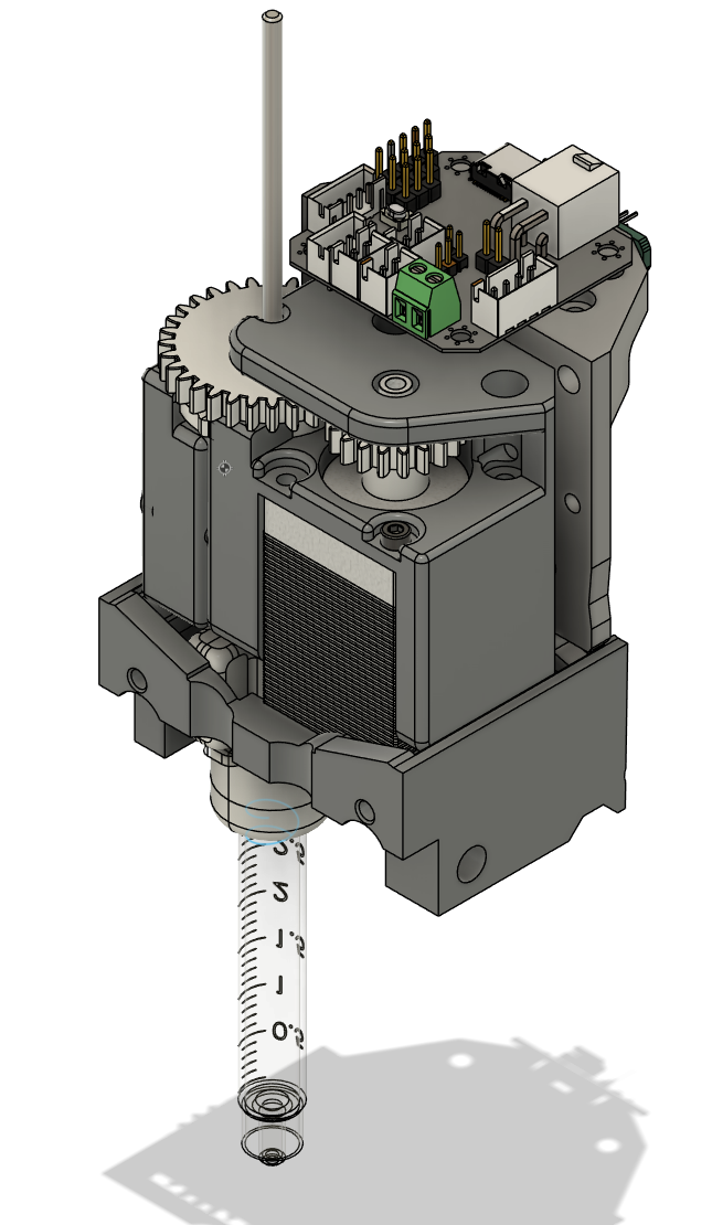

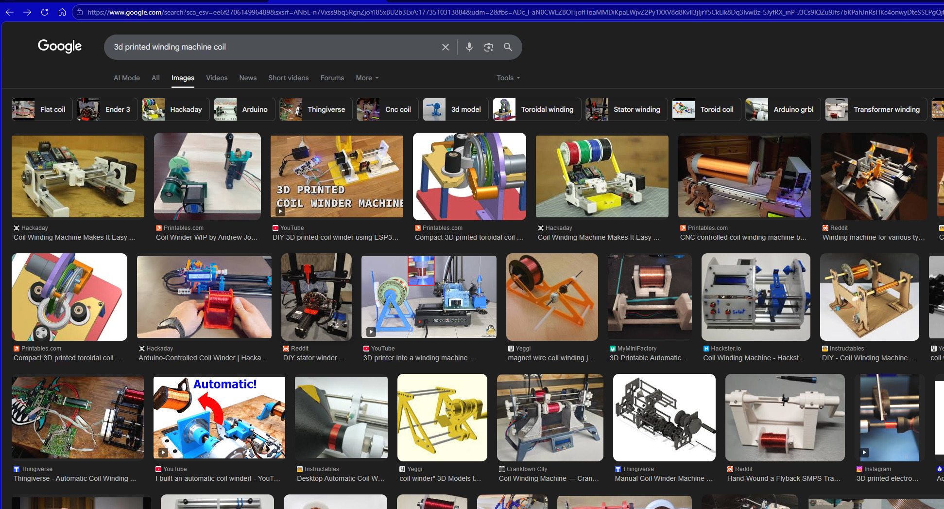

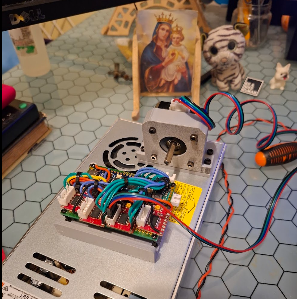

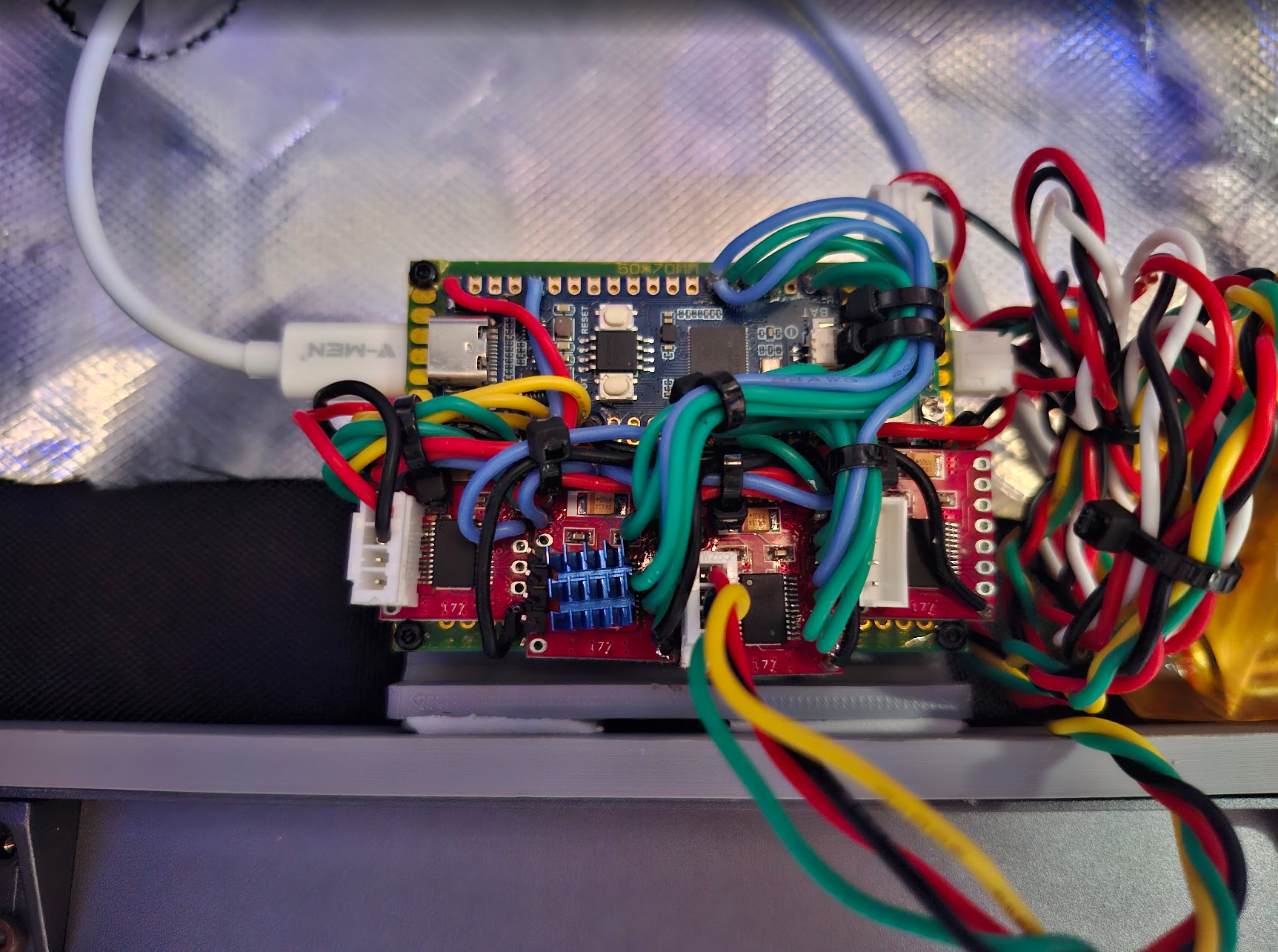

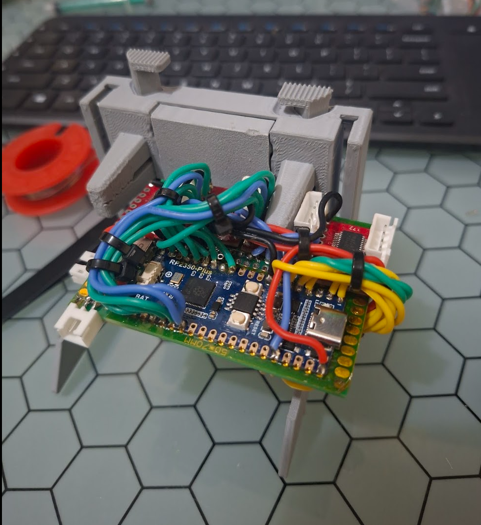

    In the last month I spent time prototyping a protoboard circuit for controlling a PnP nozzle stepper motor, a vacuum pump and a coil winding stepper motor addon.
    Also redesigned the syringe extruder to seems more like the Voltera dispenser with a quick disconnect Syringe mechanism and before building the new model, I discovered that calibrating the extruder with a Syringe is the same as calibrating the 3d printer Extruder in orca slicer, although I used custom G-code tests written by Gemini. First, I needed to do a flow test, then a Pressure Advance Test and finally a Retraction Test. But happened that the ink I used dried fast exposed to air and the nozzle constantly clogged. This was resolved by adding some skirt before printing, and maintaining the nozzle capped with a bit of acetone inside when not used.

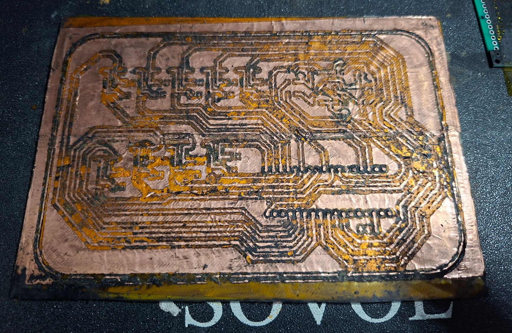

  • PCB Test using Copper Tape
    Joanbelk06/29/2026 at 14:19 0 comments
    I have been using copper tape and kapton tape on a ASA printed base to create a PCB aproximately 10x10 cm in size. Due to poor copper adhesion, the copper glue and overetching has been very difficult for me to create a working PCB. Most of the copper dismantled while cleaning the paint with acetone.
    I will try next to use adhesive transfer tape and copper foil, but i have to wait it arrive from amazon.

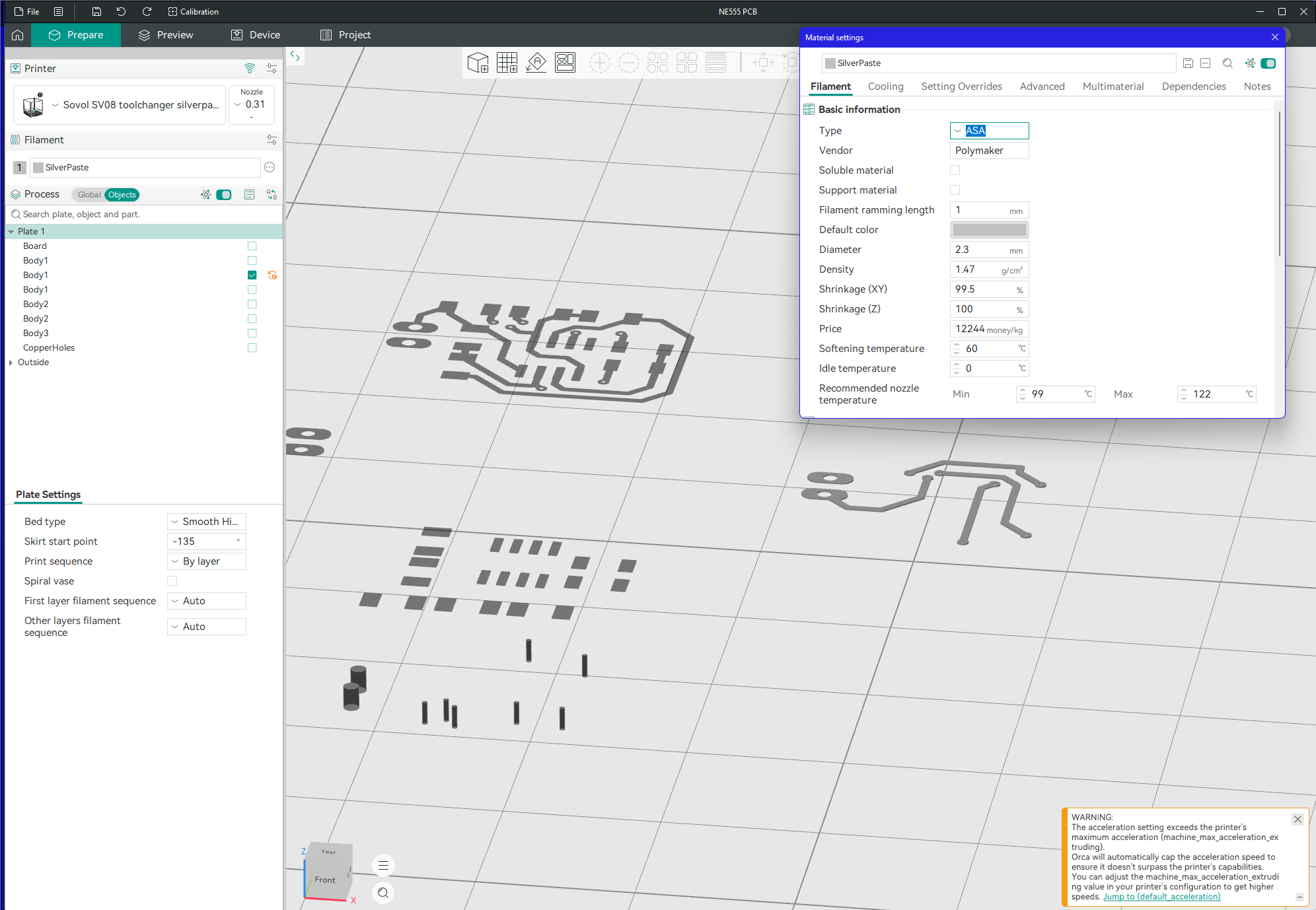

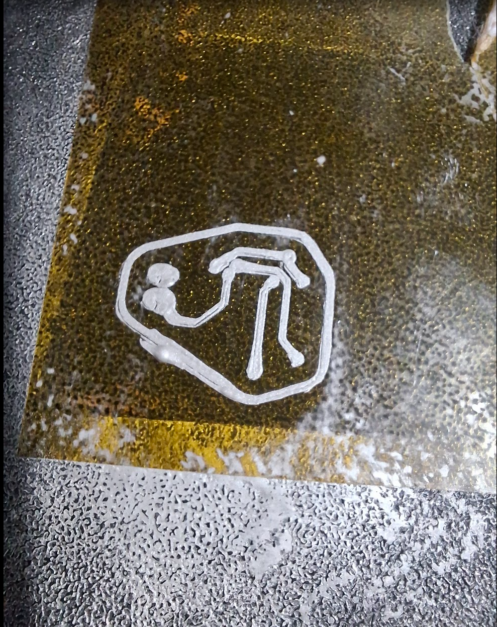

  • Direct Ink Writing Test
    Joanbelk06/26/2026 at 14:35 0 comments

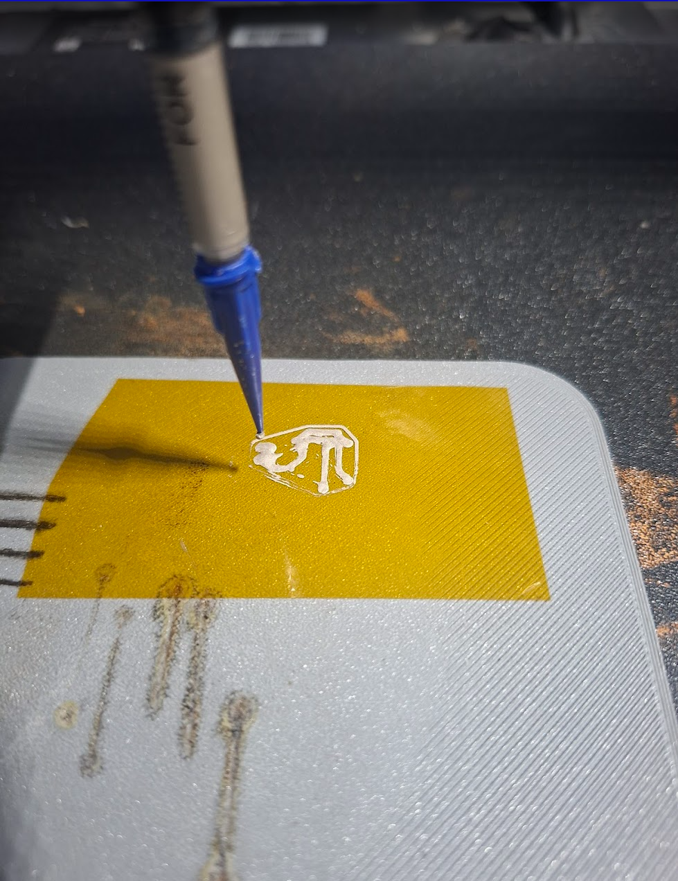

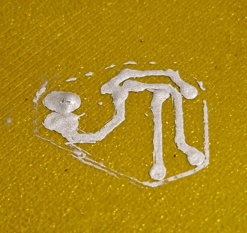

    In the last month I was also testing printing Commercial conductive silver Paste with the syringe. This was a difficult task as I was unexperienced about the fluid mechanics and rheology of extruding paste. I tried adjusting and creating a profile in OrcaSlicer in order to print silver paste as it was FDM filament. Up to date having fine tuned yet the process as I noticied some mechanical problems with the extruder mechanism in my printer. (borrowed from the LumenPnP project xD).
    The following webinar changed my mind about DIW. I was planning add an Inkjet UV printing>

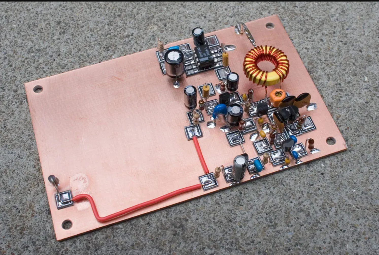

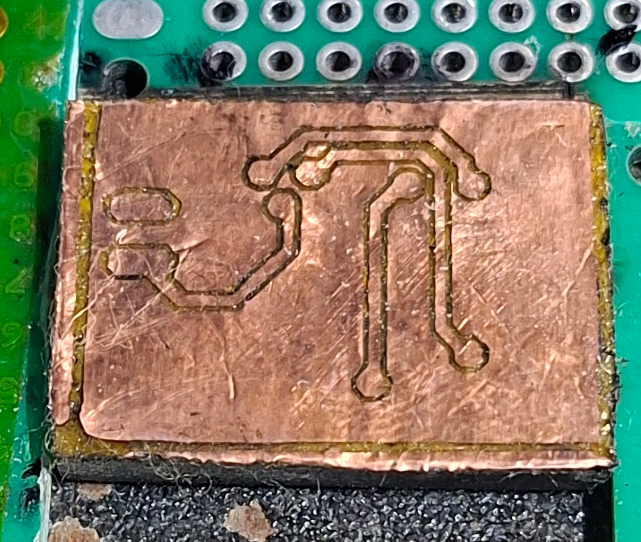

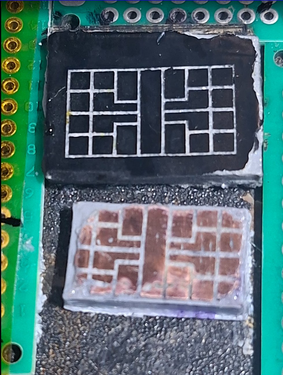

  • Laser Etch SMD Protoboards
    Joanbelk06/26/2026 at 14:22 0 comments

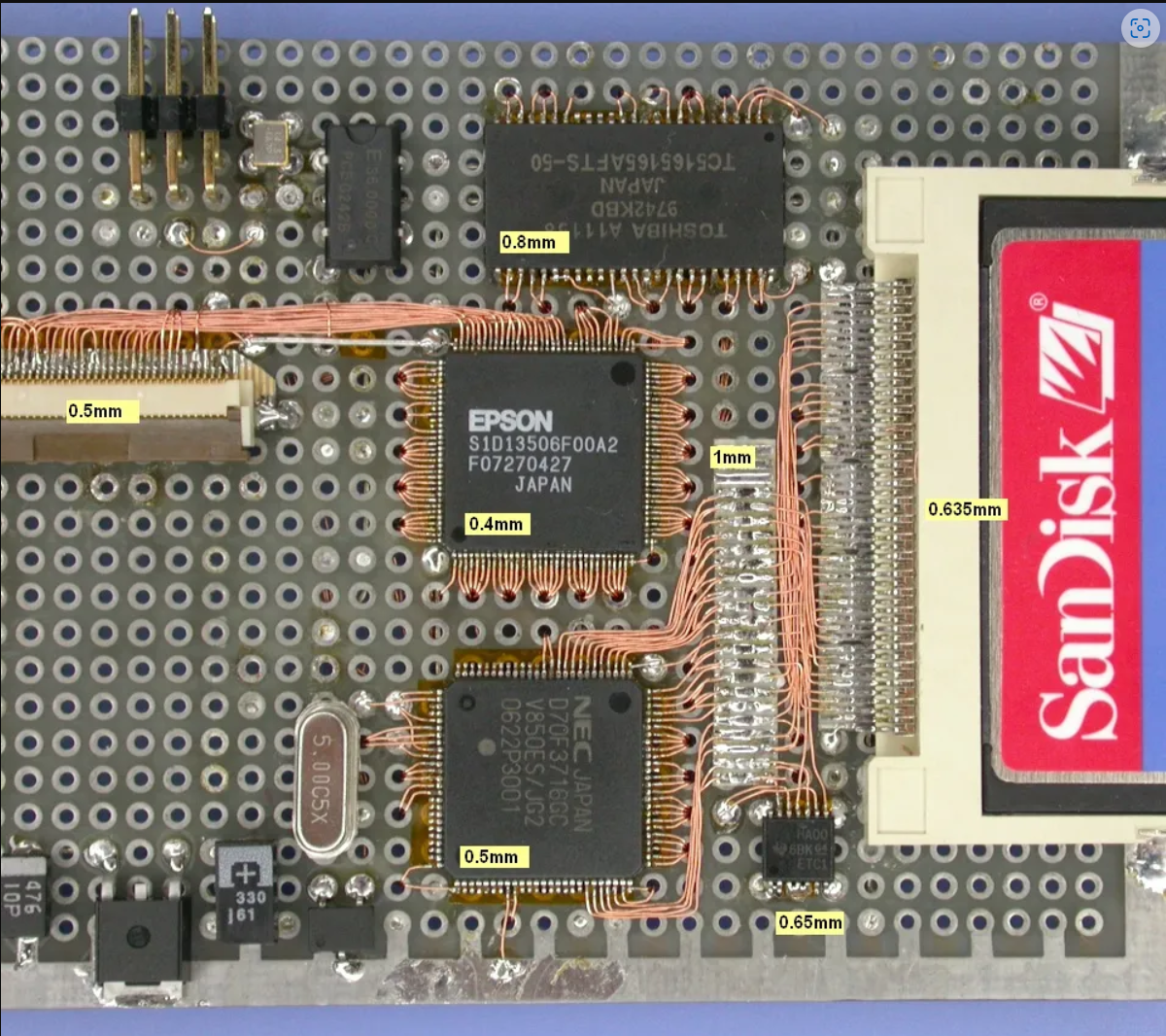

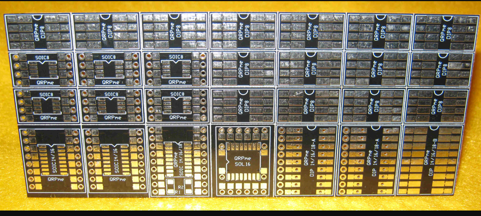

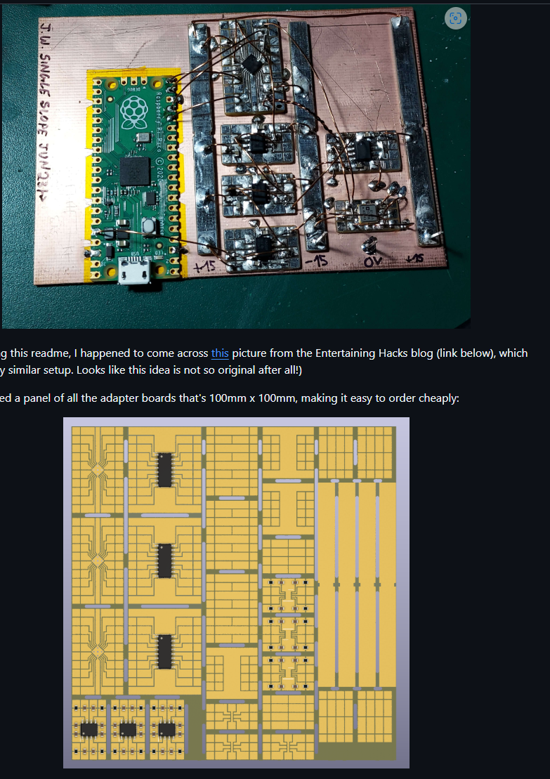

    I am new to PCB prototyping. Searching on the web I discovered many ways people used in the past for rapid PCB prototyping  and I tried to reproduce some by using the Laser Etching. I found the following techniques>
    1. Manhattan Prototyping:
    The WBR – A Simple High Performance Regen Receiver for 40M by N1BYT – Dave Richards AA7EE
    Adapter boards design> NNNILabs/Manhattan-Adapters-Prototyping-Ideas: SMD adapters for Manhattan-style prototyping.
    https://forums.parallax.com/discussion/164493/ground-plane-construction
    2. Wire Bonding like technique>
    Extreme Wiring on the Prototyping Board by NE555
    https://elm-chan.org/docs/wire/wiring_e.html

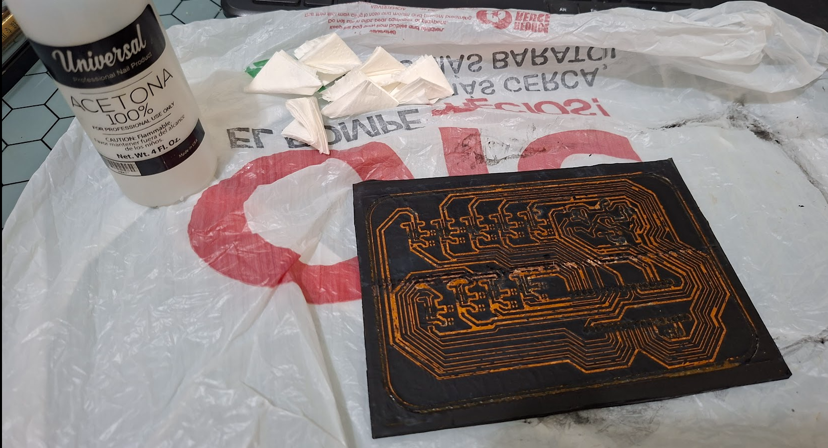

    So, I tried to use Laser Etching by welding with acetone a copper sheet to the ABS in order to create custom SMD protoboard for using as Manhattan Style prototyping.

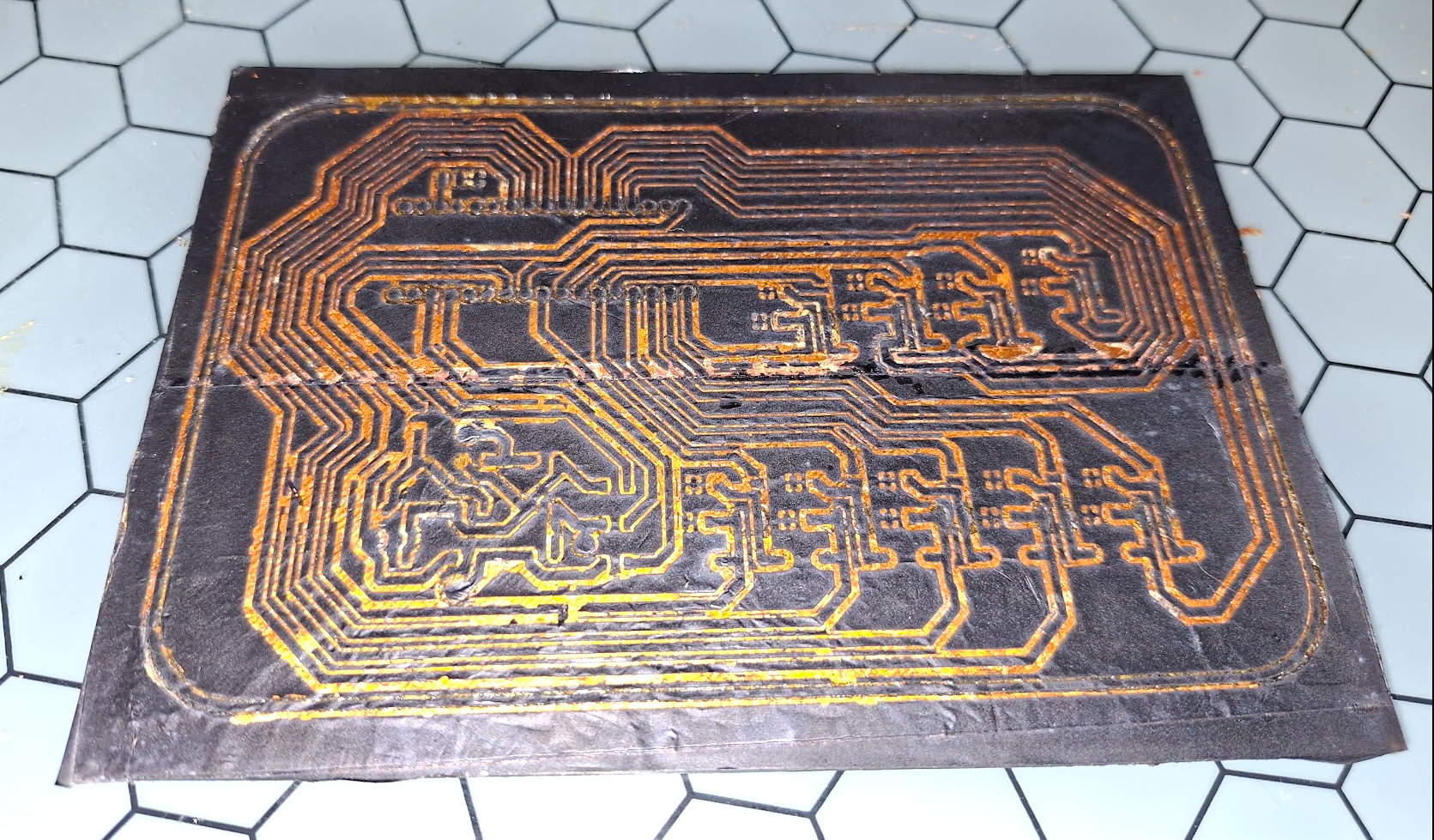

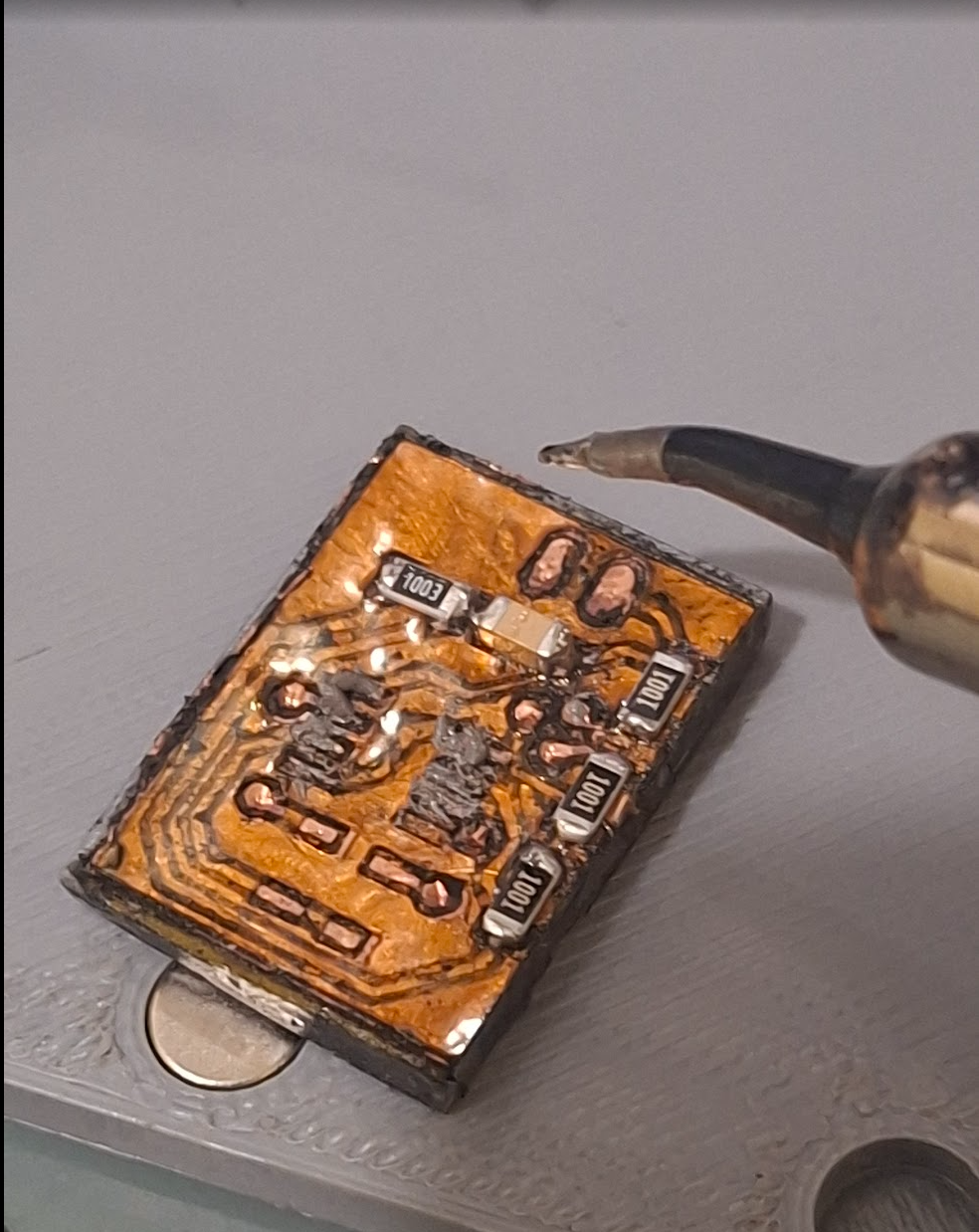

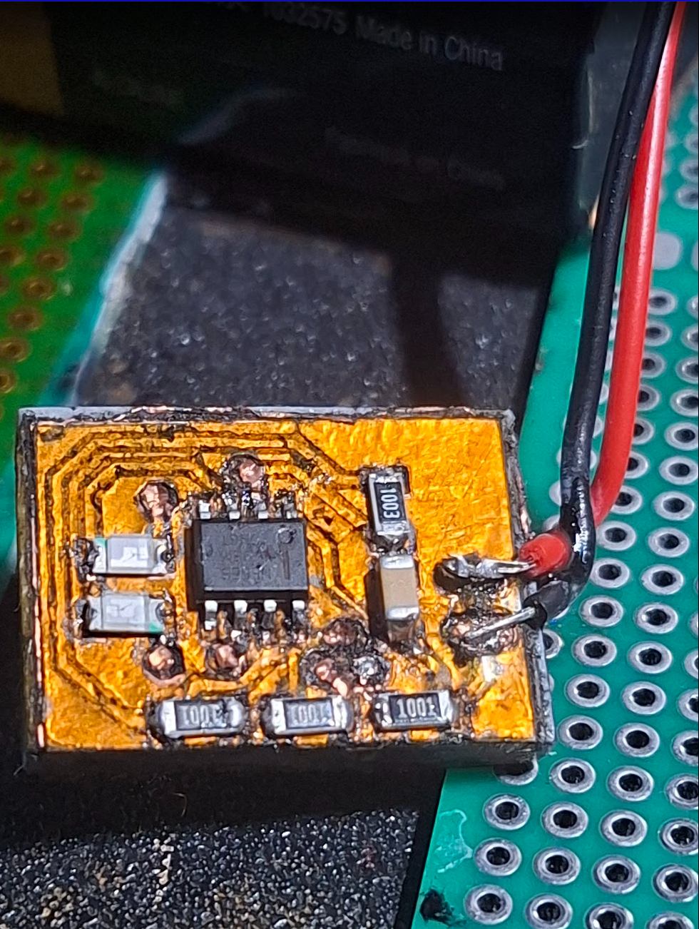

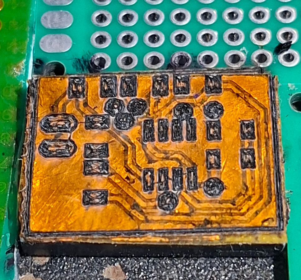

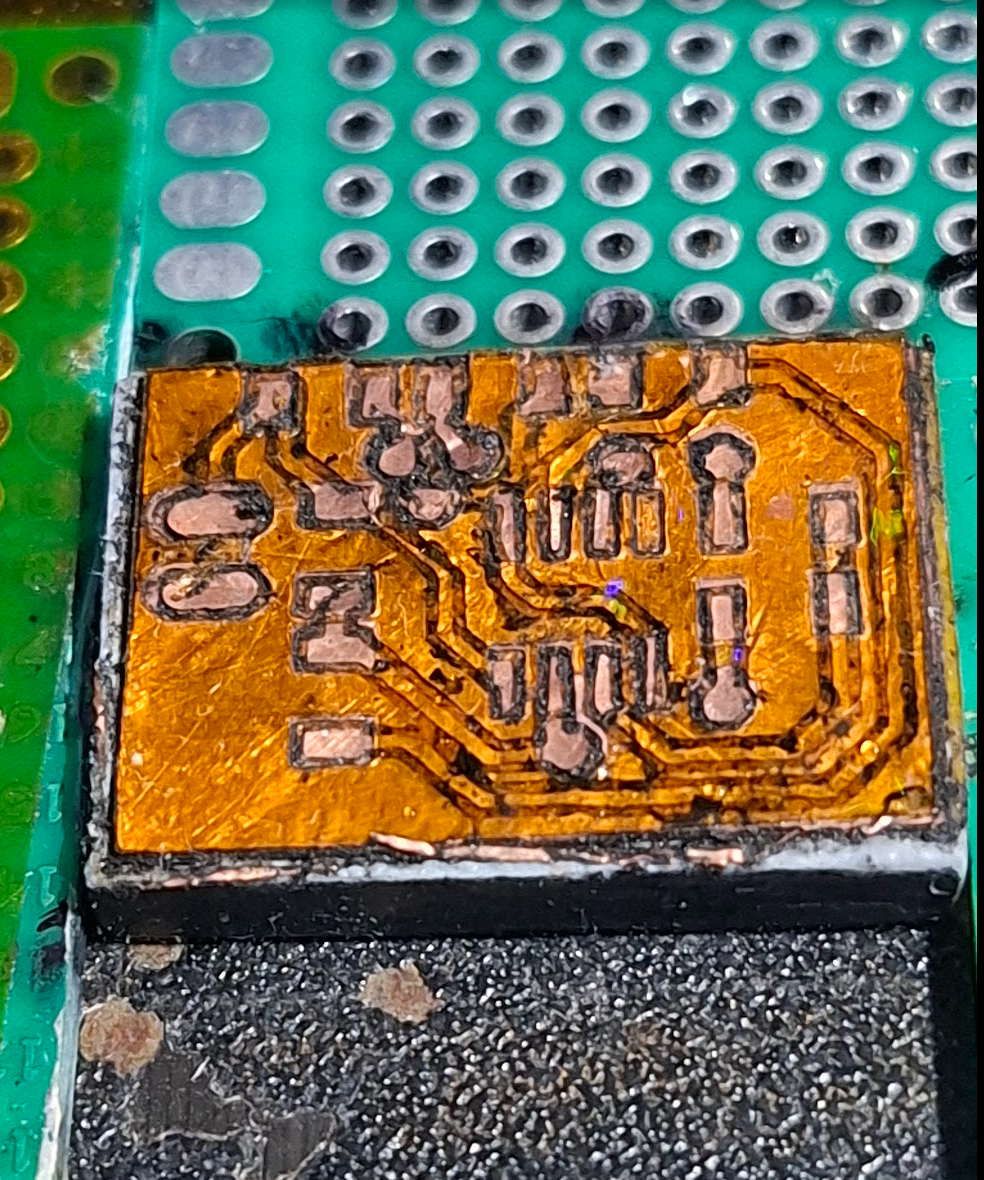

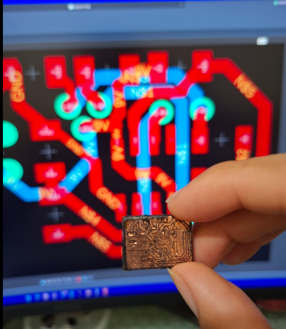

    In the last month I was trying to create a test PCB with 1206 size SMD components and an NE555 IC by creating the smallest PCB trace possible. According to theorical capabilities, the Laser has a pitch of 0.08mm and the Sovol SV08 printer has accuracy of 0.1mm in XY direction. I tried the following:
    1. Laser Etching:
     As I didnt have any experience with laser engraving, had many failures by not using Air assist. I regret using a 10w laser, a 5w laser was sufficient. The idea was to engrave an ink mask over a copper substrate. At the beginning I used acrylic permanent marker and etching gel to avoid taking the 3d printed base out of the printing bed, but happens that the Etching Gel (a mix of ferric cholride with fumed silica) after 20 minutes or more the ink starts to lose grip to the copper surface and ended cutting the small 10mil traces, was also very difficult to optically inspect the board.

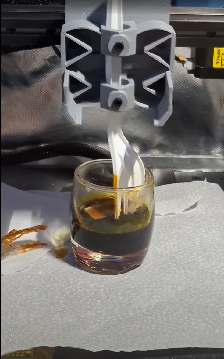

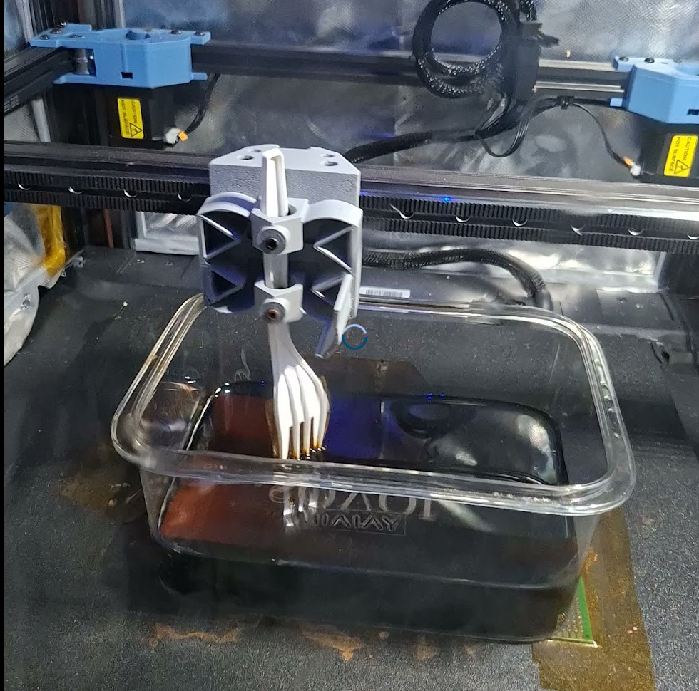

    I ended switching to the classical approach to etch the board in a bath of acid by taking out of the 3D printer Bed. But happens then that when wanting to add more layers insulated by kapton tape over copper tape, as I did not have a fixed plate was difficult to align again the laser. Also for VIAS had to use options like adding solder paste or conductive ink, and Had to use IPA for removing the graphene left by laser milling the kapton tape. For cleaning the paint mask I had to carefully clean by using Q-tips and acetone, one mistake and a trace would be blown away.  Finally after some weeks I was able to create a PCB. Every trace was conductive even through the vias, but after the soldering process with Low Temp Soldering, the circuit may had some shorts and the VIAS where misfriring because I relied in the acrylic tape of the copper tape instead of applying conductive ink. And as time passed I decided to move forward creating another PCB test.
    Agitating the acid etch reduced the etching time from 40 minutes to 15 or 20 minutes, avoiding overetching.

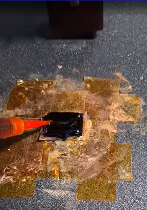

    At this time, following Gemini's recipe for a Reactive Copper ink ended up being very difficult to fine tune for me. Also discovered that I was running my gcode for the laser with Half Speed and ended up burning the ink every time, although not at 10% that is 1W 450nm laser power.
    In theory: If it looks Black and Ashy (Soot that rubs off easily): Too hot. The Vitamin C burned into charcoal; but if the black ink instantly flashes into a Salmon, Bronze, or Penny-Copper color, means it works.
    The recipe is as following:
     8mL Reactive Copper Recipe
    Part 1: The Carrier Fluid
      5.20 g Ethylene Glycol (approx. 4.8 mL)
      0.60 g PVP K30 (Binder)
      0.20 g Citric Acid
    Part 2: The Activator (Vitamin C)
     2.00 g Ascorbic Acid
    Part 3: The Metal
     6.40 g Black Copper Oxide (CuO) powder.
    Heat Bed at 85 Celsius for 10 minutes until ink looks bit brown and then fire the laser.
    Is estimated will last for 2 weeks in the refrigerator.

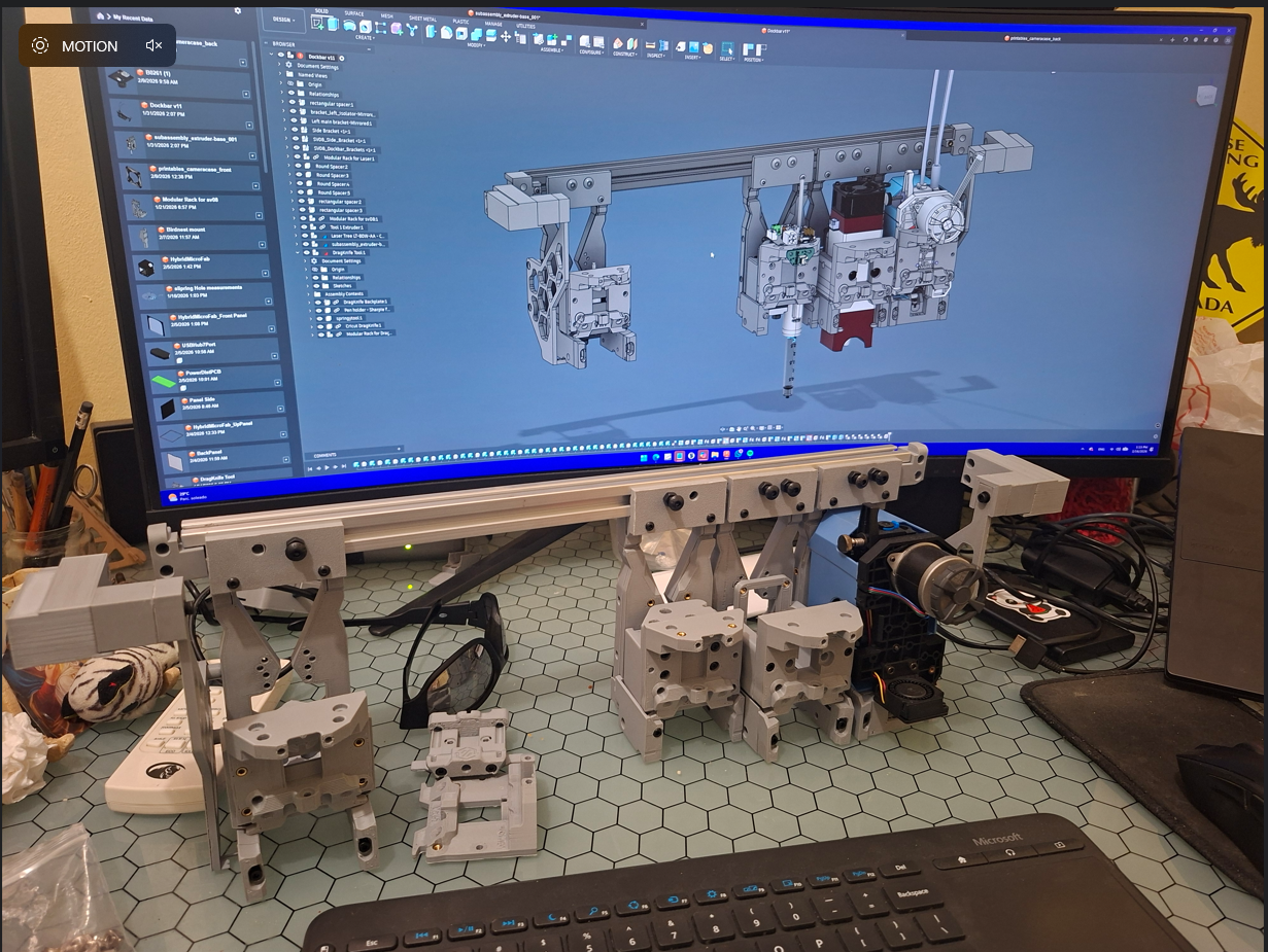

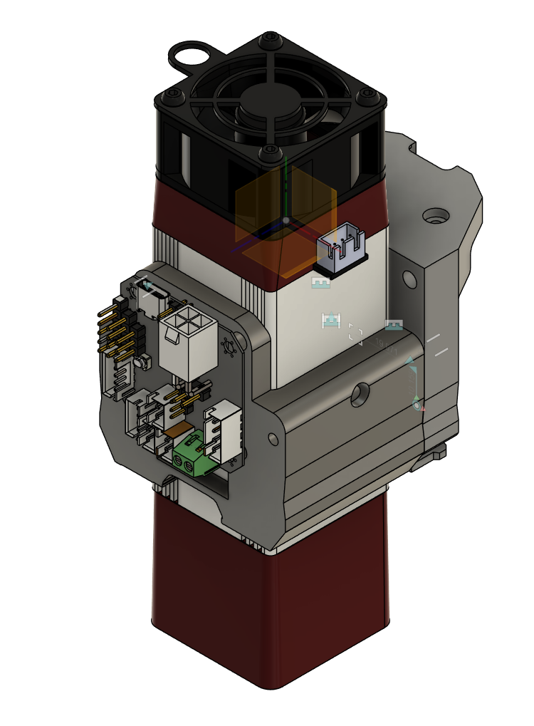

    This is a summary of the process followed for calibrating the offset of the main tools (Extruder, Deposition Syringe and Laser). I used the Axiscope software to manually adjust the offset.

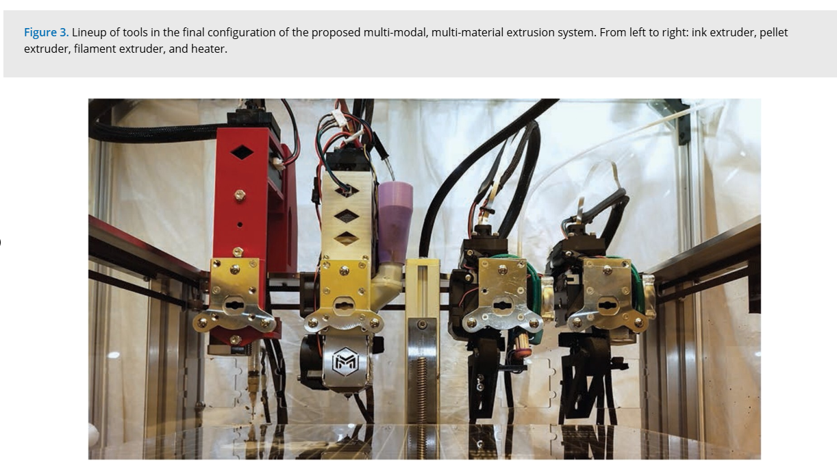

  • Toolchanger Tests: Switching Extruder, Laser and Deposition Tool
    Joanbelk05/10/2026 at 02:31 0 comments
    Actual Date> 1-May-2026
  • Toolchanging Tests: Deposition Tool
    Joanbelk05/09/2026 at 23:52 0 comments
    Actual date: 1-May-2026
    After struggling for weeks, finally is somehow stable.

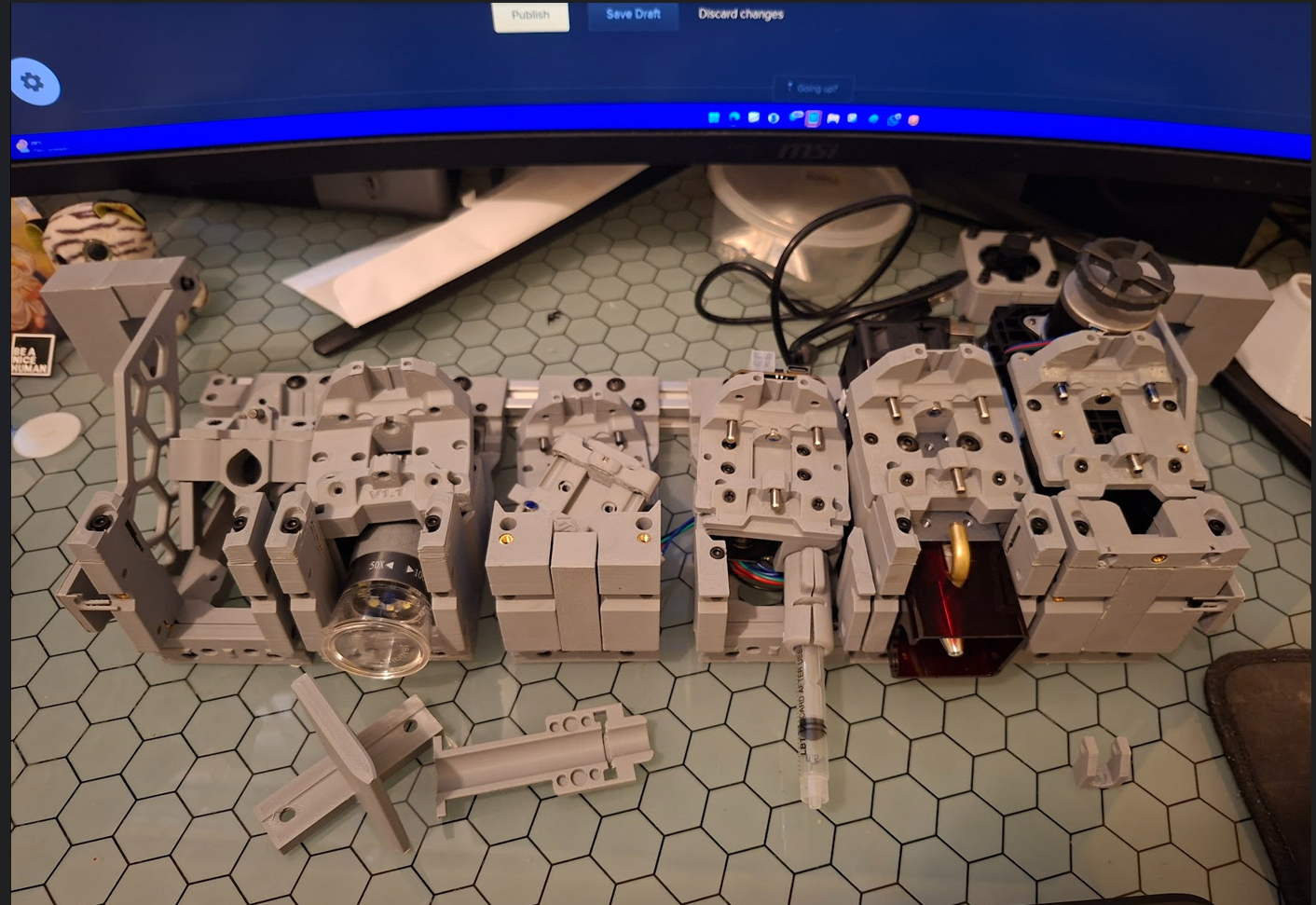

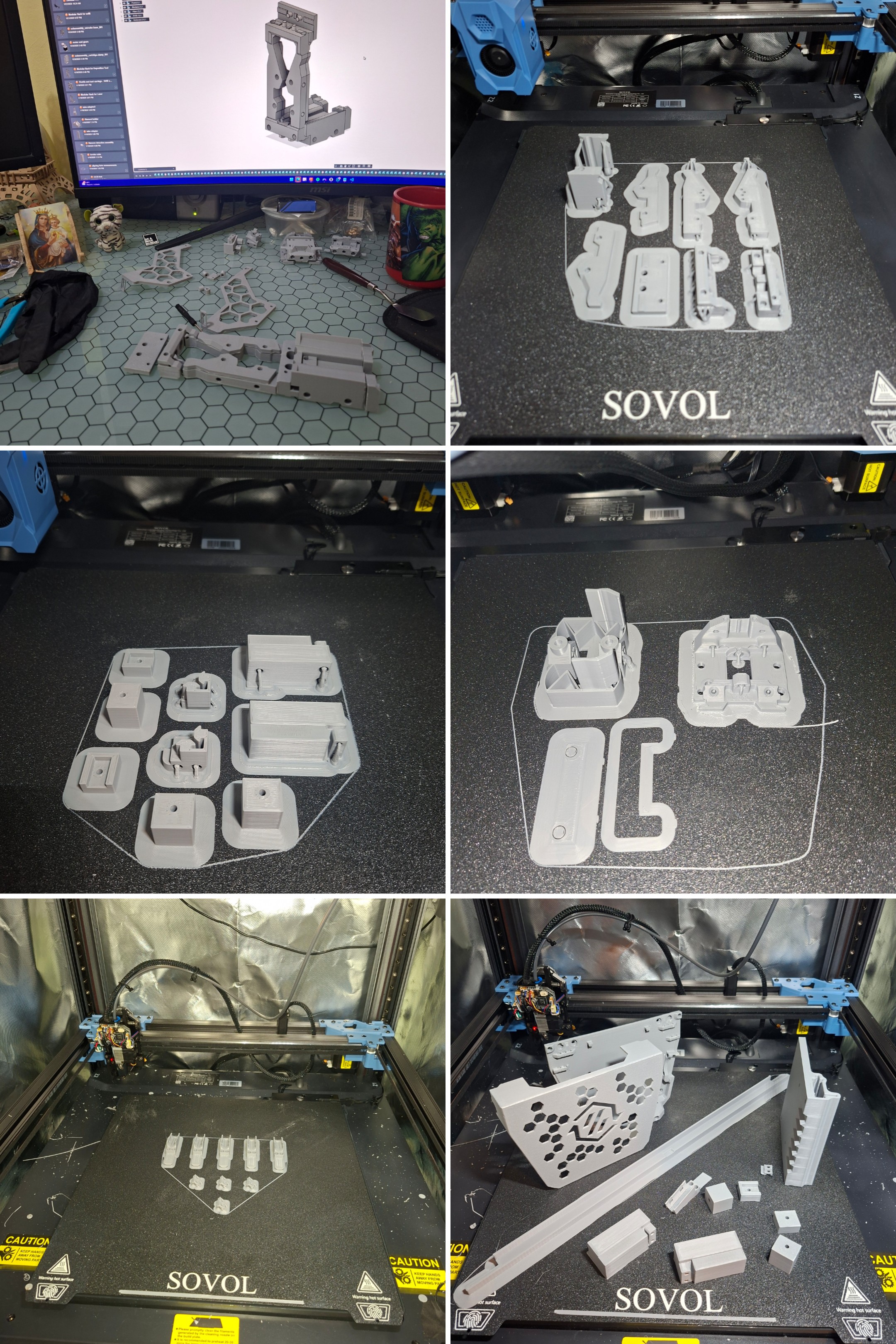

  • Stealthchanger Shuttle Installation
    Joanbelk04/20/2026 at 22:20 0 comments
    Last week I finished wiring the OptoTap Sensor in all electrical tools and installed the Shuttle for toolchanging. I ran on some problems, like not verifying the OptoTap sensor properly working, and also had a electric short with the Optotap sensor in one of the extruders... (doesnt power up now, maybe I will check the buck converter circuit of the micro in the PCB or buy a new one).
    I hope this week to work in the software to at least record a video of the system automatically switching tools.
