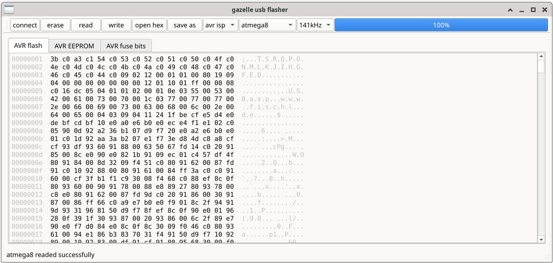

  • connect button - try target. For atmega it is register read and connect command.
  • erase - full erase of target. For flash write erase before write runs automatically.
  • read - read flash or eeprom or re-read fuse bits (reads the dump for current tab).
  • write - write and verify flash or eeprom from the opened file.
  • open hex - open file to write. For every tab there are separate files. So, if you change the tab, open file again.
  • save as - saves current readen data by read button to binary file.
  • family choice - choosing the type of IC, today atmega only.
  • chip choice - list to choose the IC from current family.
  • speed choice - connect to the target interface speed in kHz.
  • progress bar - read/write current percentage.
On the center here are usually the current dump. Or fuse bits for atmega. In the bottom left corner the status bar with status message. If operation or connect to the programmator device is success you can detect it by statusbar message.

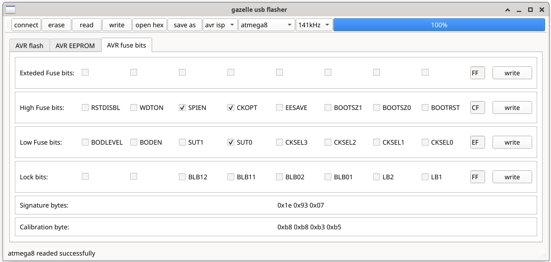

    Separate tabs for flash dump, eeprom dump and fuse bits. ISP interface speed set in kHz availability. Programmator auto detect function, if programmator not found, just re run the app.

    • atmelList - class with all information for every atmega. There are signature bytes, flash/eeprom page and total sizes, also names of every fuse bit. As for fuse bits, they are the same on all AVR's, but the bit locations are differs. So, I add an constant (static constexpr) strings for every fuse bit name, and set the pointers to this bit names for every atmega fuse byte bit. While the class returns not the pointer list, the string list instead.
    • avrFuse - the widget with avr fuse bit. Have a separate checkbox for every bit and field for setting byte from the keyboard. The invertive nature of the fuse bits is taken into account. A byte is in the same format as it is in the microcontroller, while checkoxes (separate bits) are inverted (1 is unset, 0 is set).

    At first i written a programmator for two flash IC's in order to switch off cartridge control function on the printer. As a way for connecting device with PC I choose the virtual COM port through USB instead of just libusb. Because we do not need a driver installation even on windows in this case. At the same time, there is no so much difference between transmitting data throught the USB bulk endpoint in USB-COM abstracion and without it. Another advantage of the first attempt was HEX viewer, which was able to open large files.
