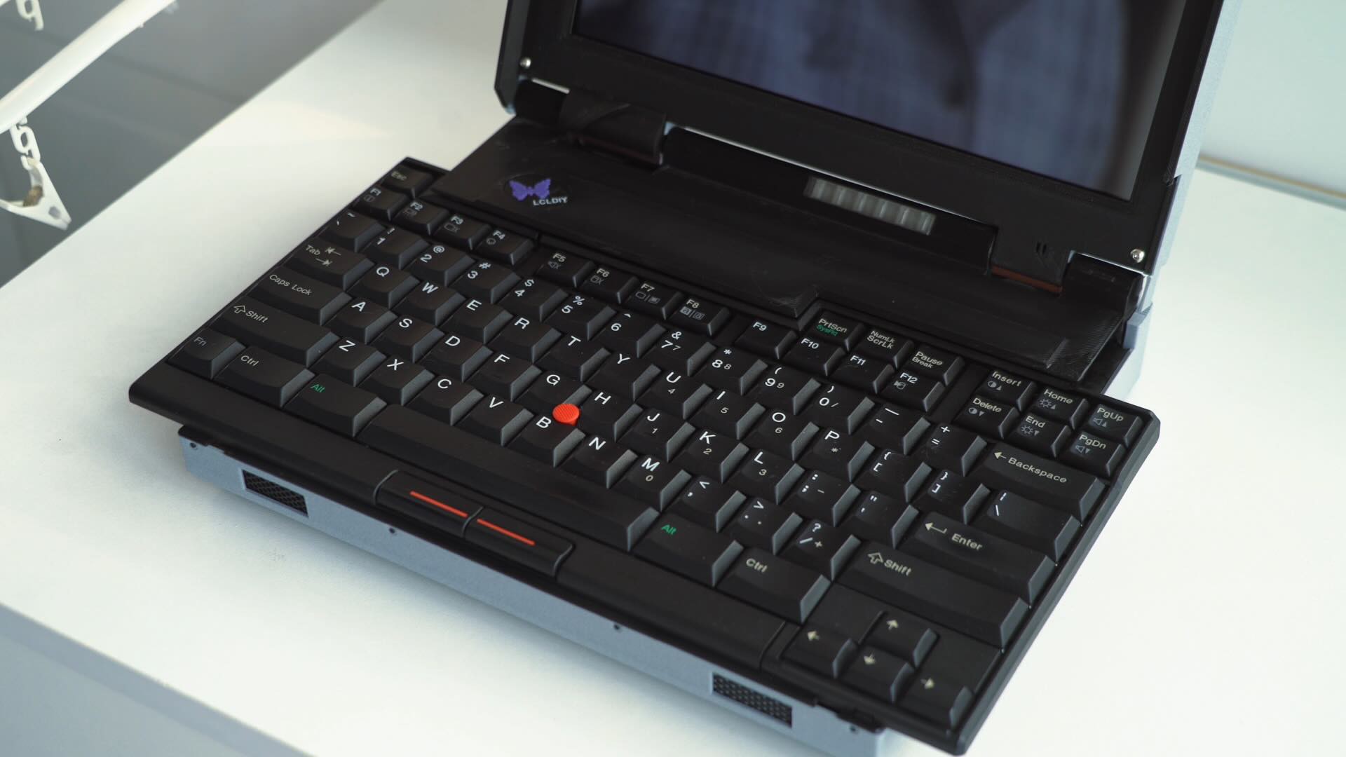

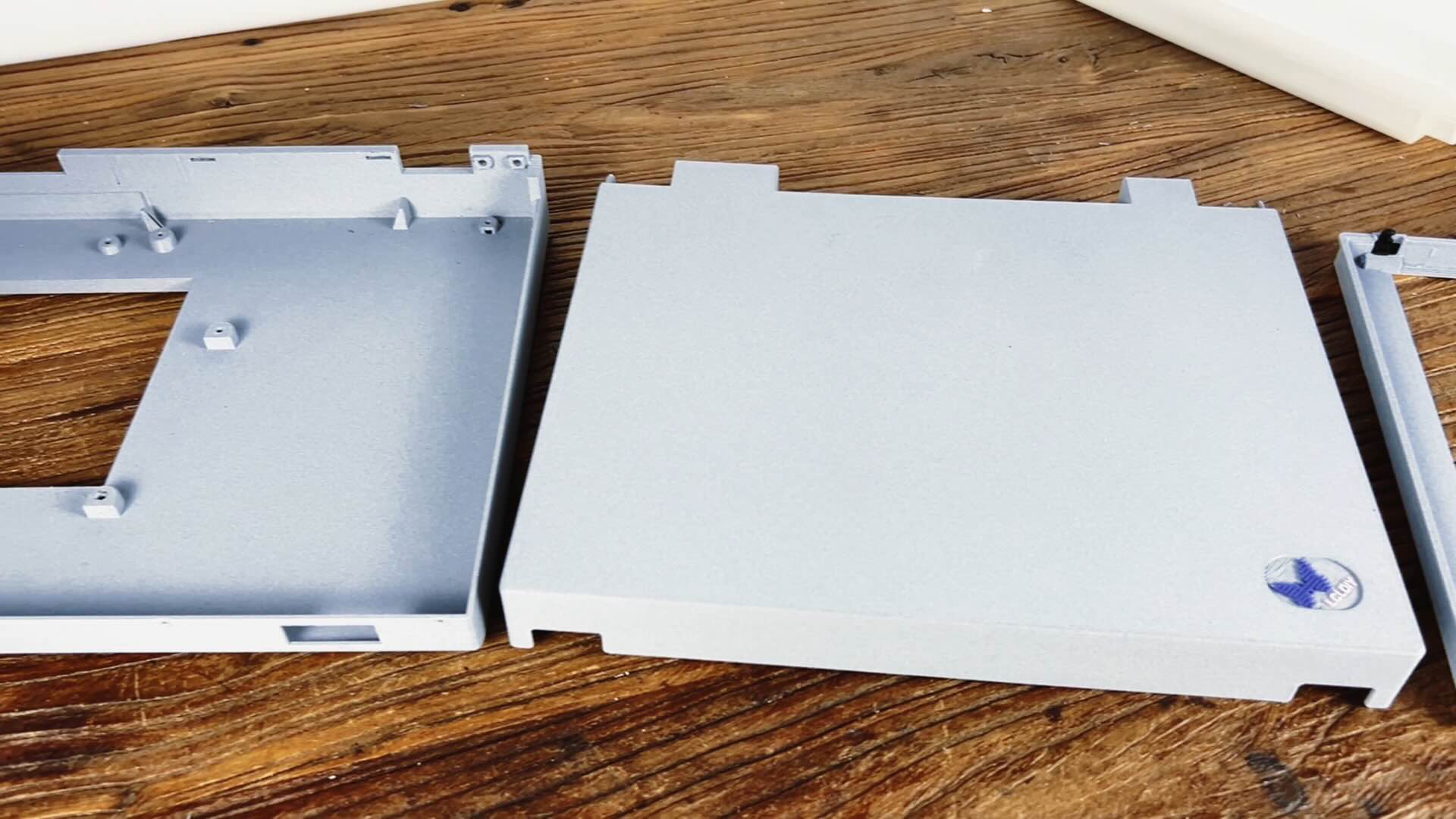

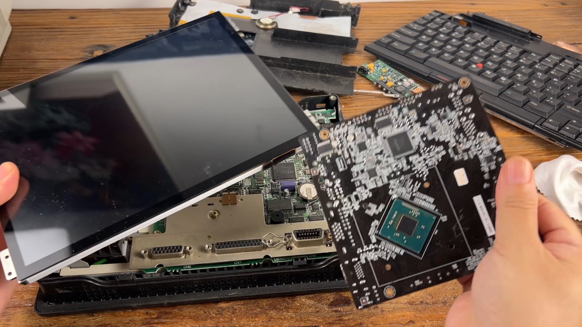

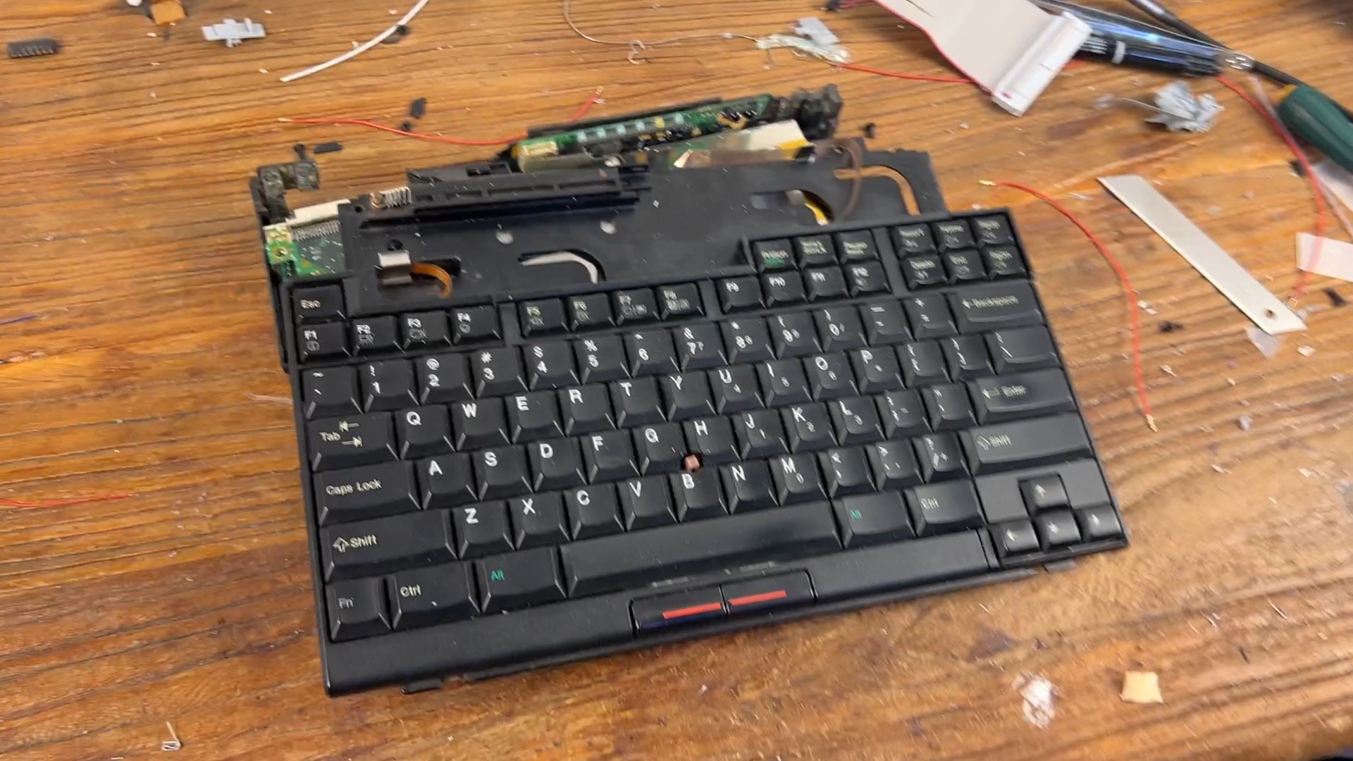

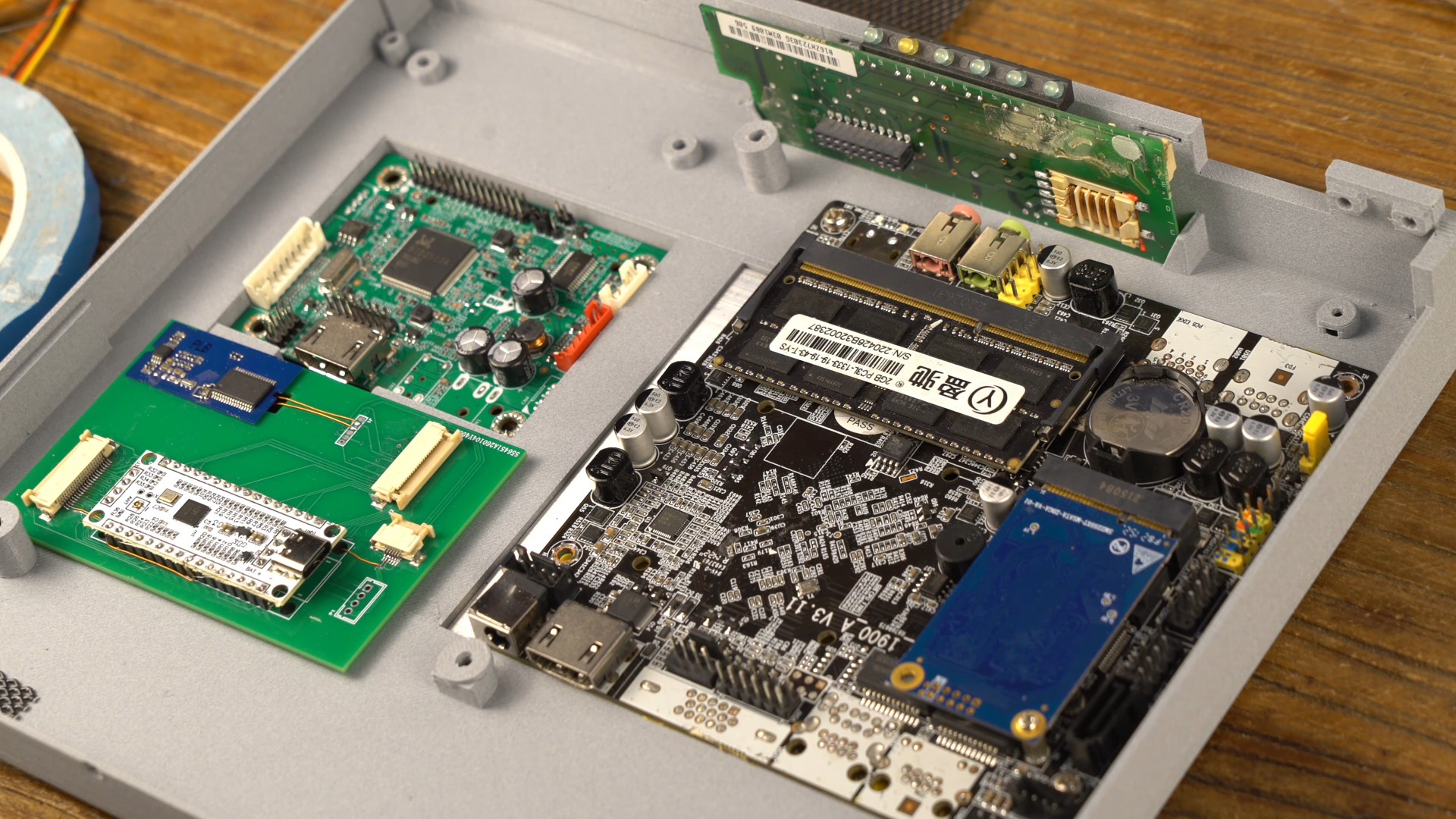

I got an IBM 701C laptop at a junkyard. Its screen was lost and the motherboard was damaged. The shell was old and broken. I tried to fix it with 3D printing technology. I also designed a circuit board to convert the keyboard to USB.

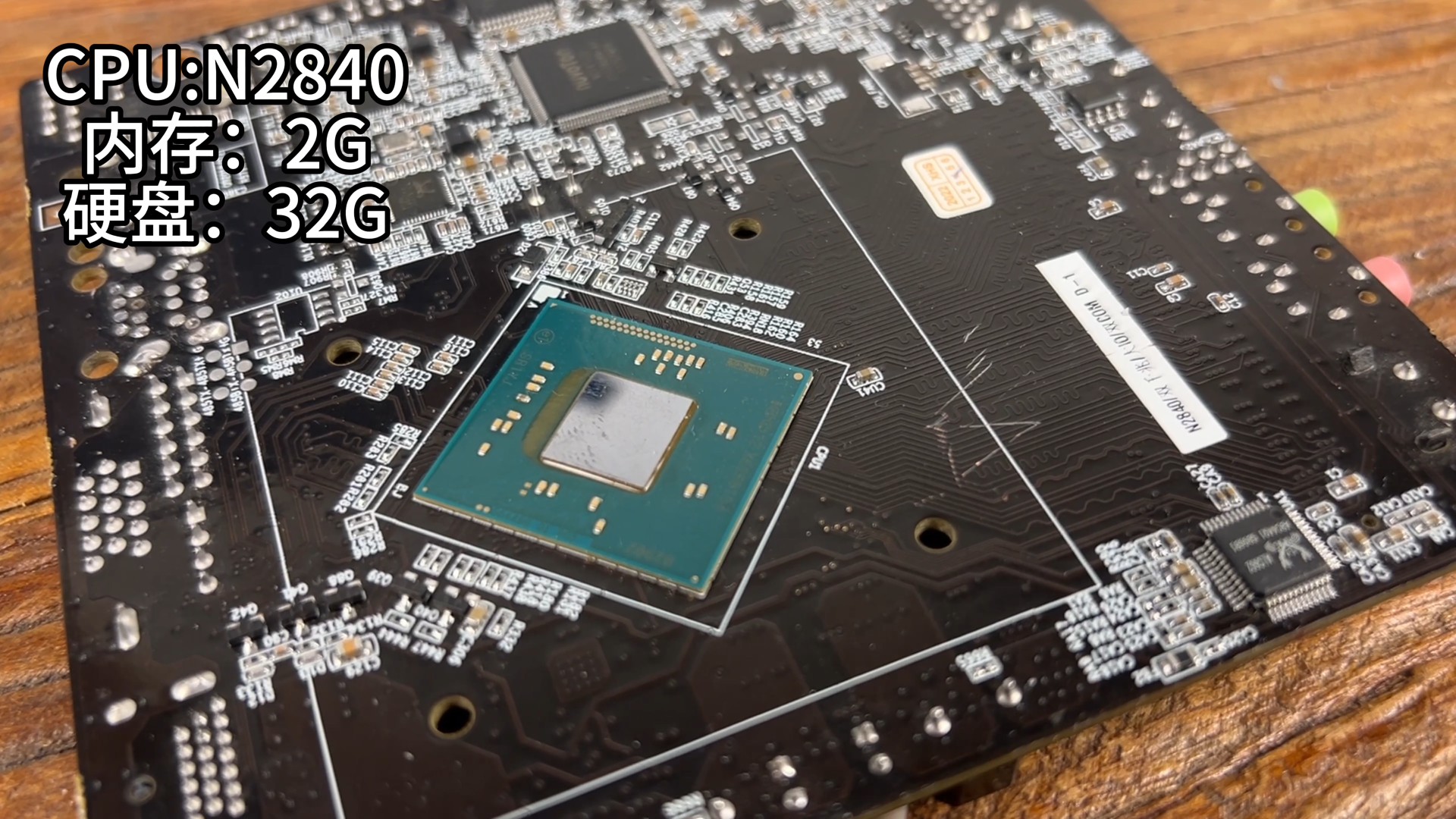

The CPU is an Intel N2840, with 2GB of memory and a 32GB hard drive.
Carbon fiber printed shell
