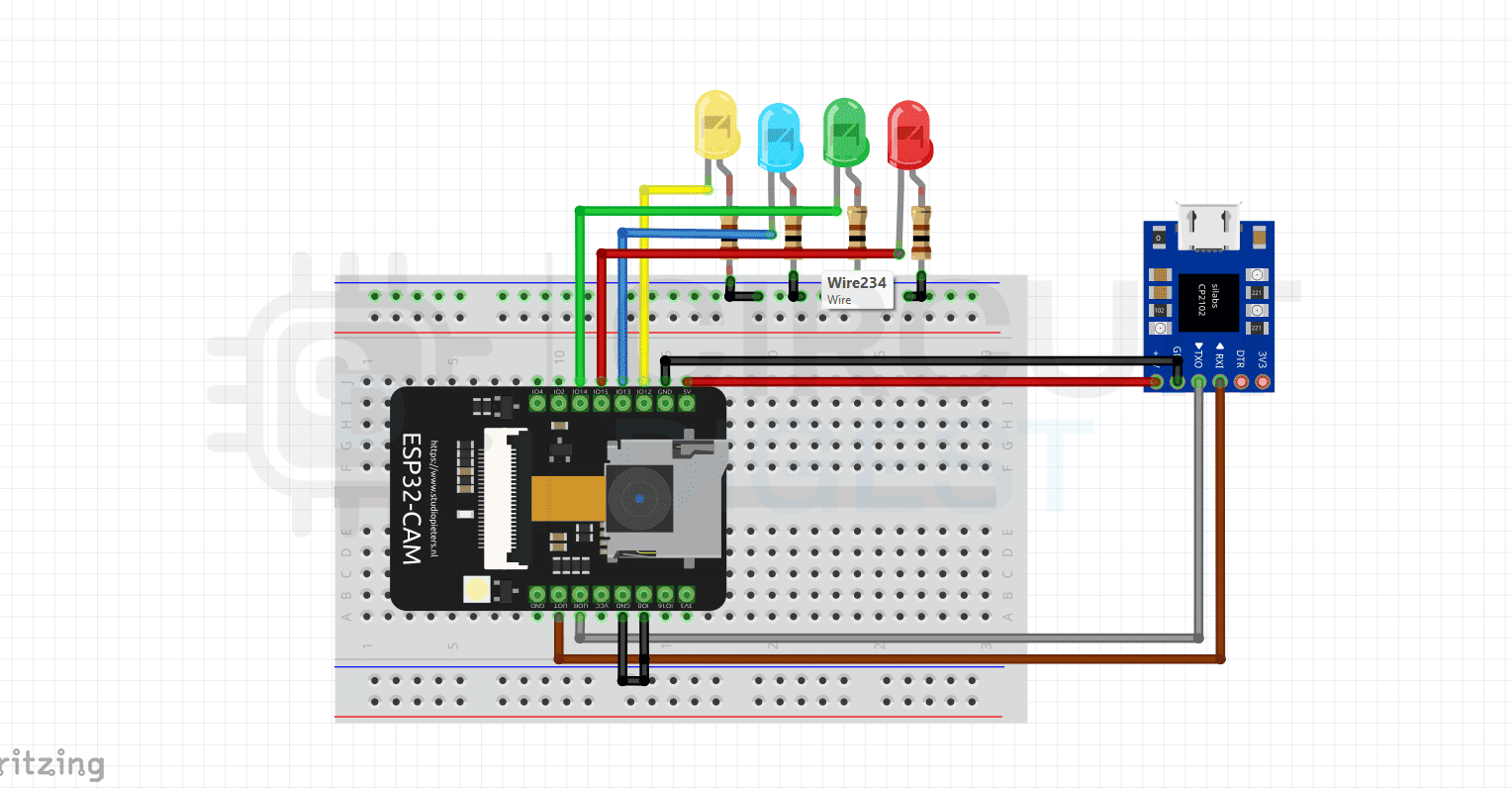

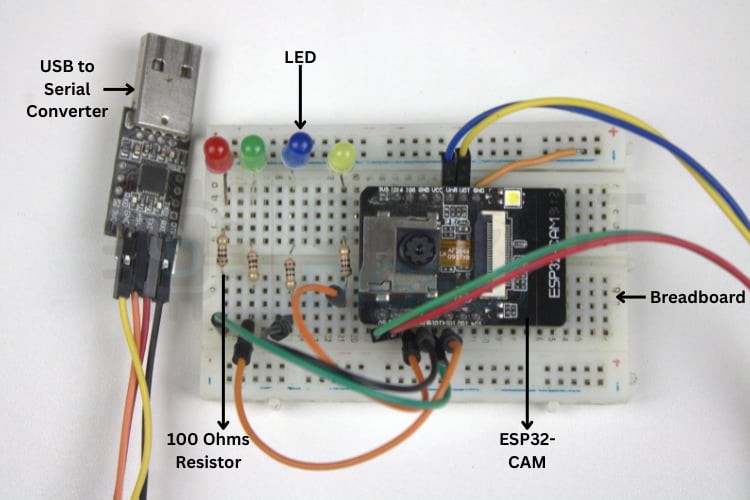

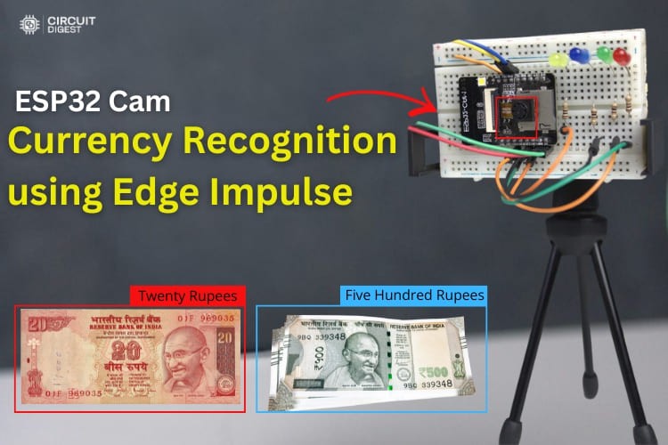

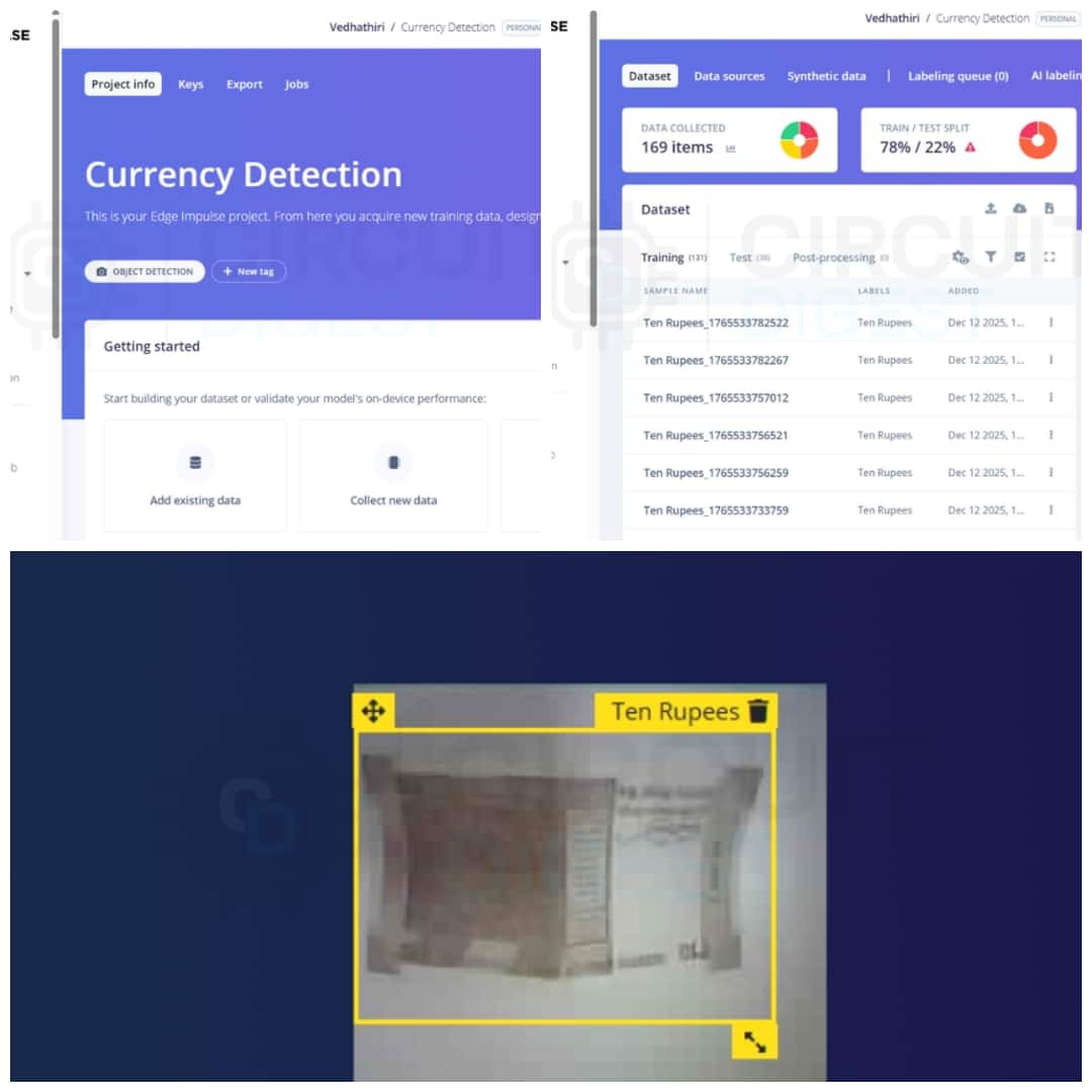

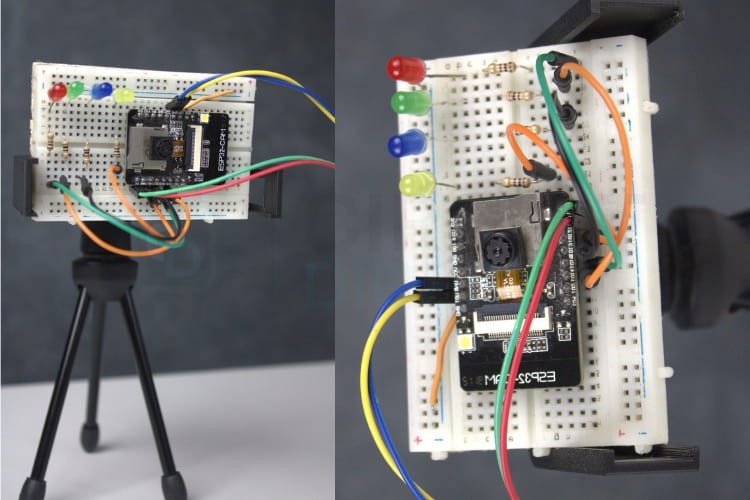

ESP32-CAM TinyML Currency Classifier – Edge AI on a Microcontroller
Modern AI isn’t just for powerful servers. With TinyML and smart workflows like Edge Impulse, even low-cost microcontrollers can perform advanced computer vision—locally and in real time. In this project, we demonstrate how to build a currency recognition system that classifies Indian rupee notes using an ESP32-CAM module and deploys an optimized machine-learning model directly on the hardware—no cloud or constant internet connection required.
Core Features
✔ Real-time classification of Indian currency notes (₹10, ₹20, ₹50, ₹500)
✔ On-device ML inference using a model trained in Edge Impulse
✔ Visual feedback via LEDs for each detected denomination
✔ Serial monitor output for debugging and human-readable confirmation
✔ Runs entirely offline after deployment
What You’ll Learn
This project takes you through a complete TinyML development cycle:
  1. Dataset collection and labelling
  2. Model training and optimization using Edge Impulse
  3. Exporting and deploying an Arduino library
  4. ESP32-CAM programming and hardware setup
  5. Real-world testing and performance insights
System Overview
At its core, this project combines a computer vision model trained on different rupee note images with the ESP32-CAM’s on-board camera.
  1. Image acquisition is done from the camera.
  2. The trained model classifies the note using learned visual features.
  3. Corresponding LEDs turn on to visually signal which denomination was detected.
  4. The result also prints to a serial monitor for developers.
This avoids latency and data privacy concerns associated with cloud processing by keeping the inference entirely on the microcontroller—a true TinyML edge application.
Step-by-Step Workflow
1. Collect and Label Data
Use the ESP32-CAM web interface (served over local Wi-Fi) to capture images of each note class with consistent lighting and plain backgrounds. Good data quality improves training accuracy.
2. Model Creation in Edge Impulse
In Edge Impulse:
  • Create a new project and upload labelled images.
  • Use object detection blocks with appropriate preprocessing (e.g., grayscale or resized inputs).
  • Train the model and evaluate with real-world test images.
  • Export the model as an Arduino library ready for deployment.
3. Deploy to ESP32-CAM
Include the exported library in your Arduino environment, adjust camera settings for your board (e.g., AI-Thinker module), and upload the sketch. The ESP32-CAM will now classify incoming frames and trigger output indicators.
Testing & Practical Tips
Fix the camera at a stable angle and consistent distance from the currency notes. Variations in lighting or orientation can degrade performance. A small tripod or custom mount improves reliability.
Use Cases
This inexpensive TinyML system can be extended into real-world applications, such as:
  • Assistive tools for visually impaired users
  • Point-of-sale transaction validators
  • Automated currency counters
  • Vending machine currency acceptance
Future Enhancements
Potential improvements include:
  • Expanding recognized classes (e.g., coins or higher denominations)
  • Detecting counterfeit currency through additional training
  • Adding LCD/OLED displays or audio playback
  • Integrating voice feedback for accessibility
Conclusion
This ESP32 CAM Currency Recognition shows how accessible and powerful edge AI can be. With an ESP32-CAM and Edge Impulse, you can build a robust, offline currency recognition system in just hours. It’s a great learning platform for TinyML, embedded vision, and practical maker applications.
Level up your embedded skills by browsing these ESP32 projects
