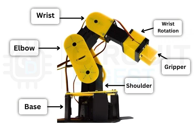

Understanding Robotic Arm Fundamentals
Before assembly, it's essential to grasp a few key robotics concepts:
Degrees of Freedom (DOF)
The number of independent movements the arm can perform; more DOF means greater flexibility and closer mimicry of human movement. A 6-DOF arm can perform complex, 3D motions.
Servo Motors
Hobby servos translate electrical PWM signals into precise angular motion. They are ideal for DIY robotics due to their ease of control and positional repeatability.

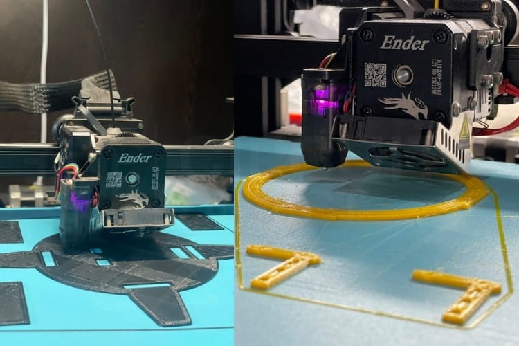

Mechanical Assembly & 3D Printing
All structural components — like the base, forearm, wrist, and gripper — are 3D-printed. Designing them in CAD ensures accurate fit and smooth movement. Assemble them using screws and ensure each servo is mounted securely to prevent vibration or unwanted torque.
Tips:
Ensure servo horns align to neutral (90°) before permanently fastening.
Use contrasting filament colors (e.g., yellow for moving parts, black for base) to visually differentiate sections.
