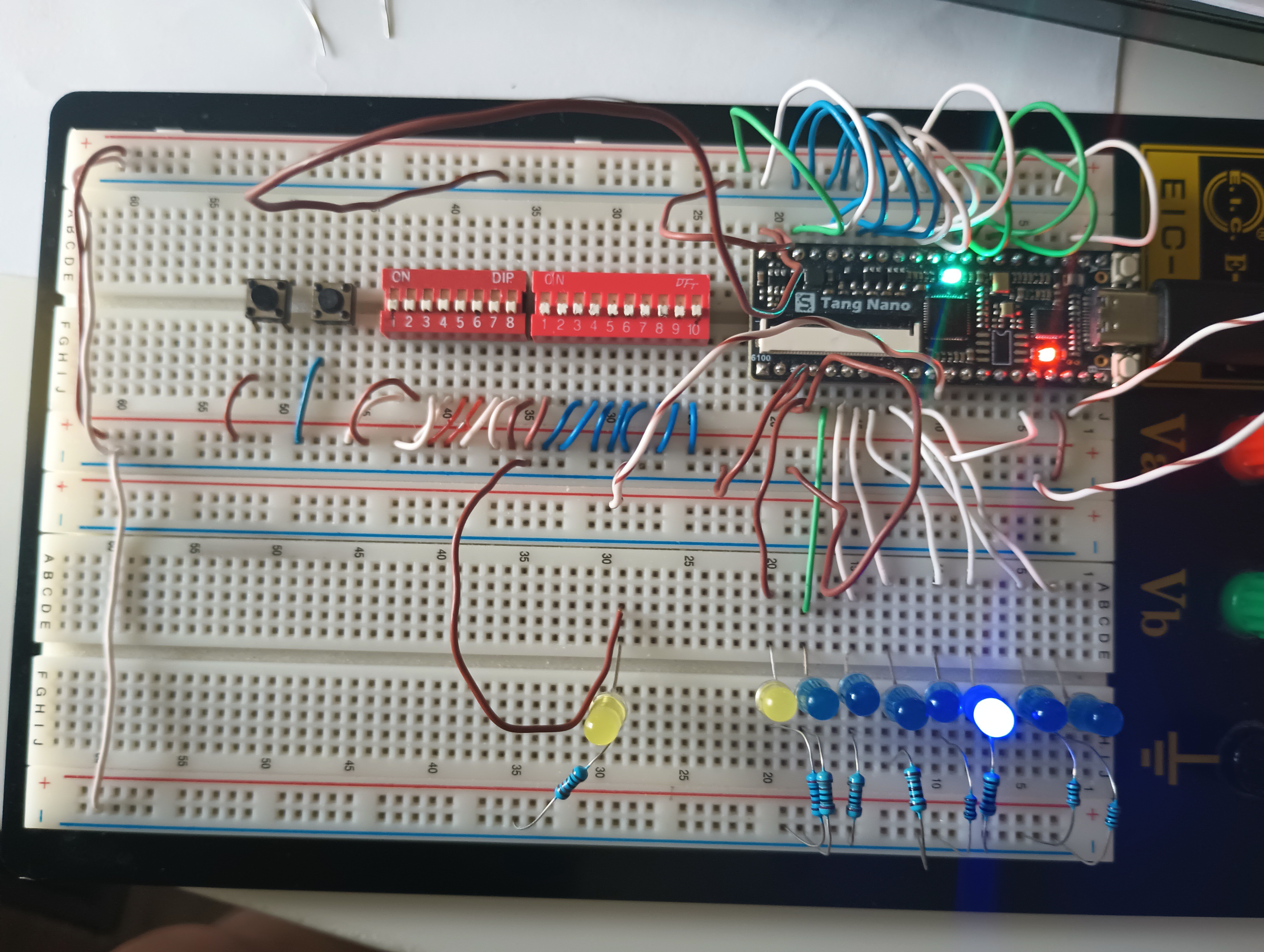

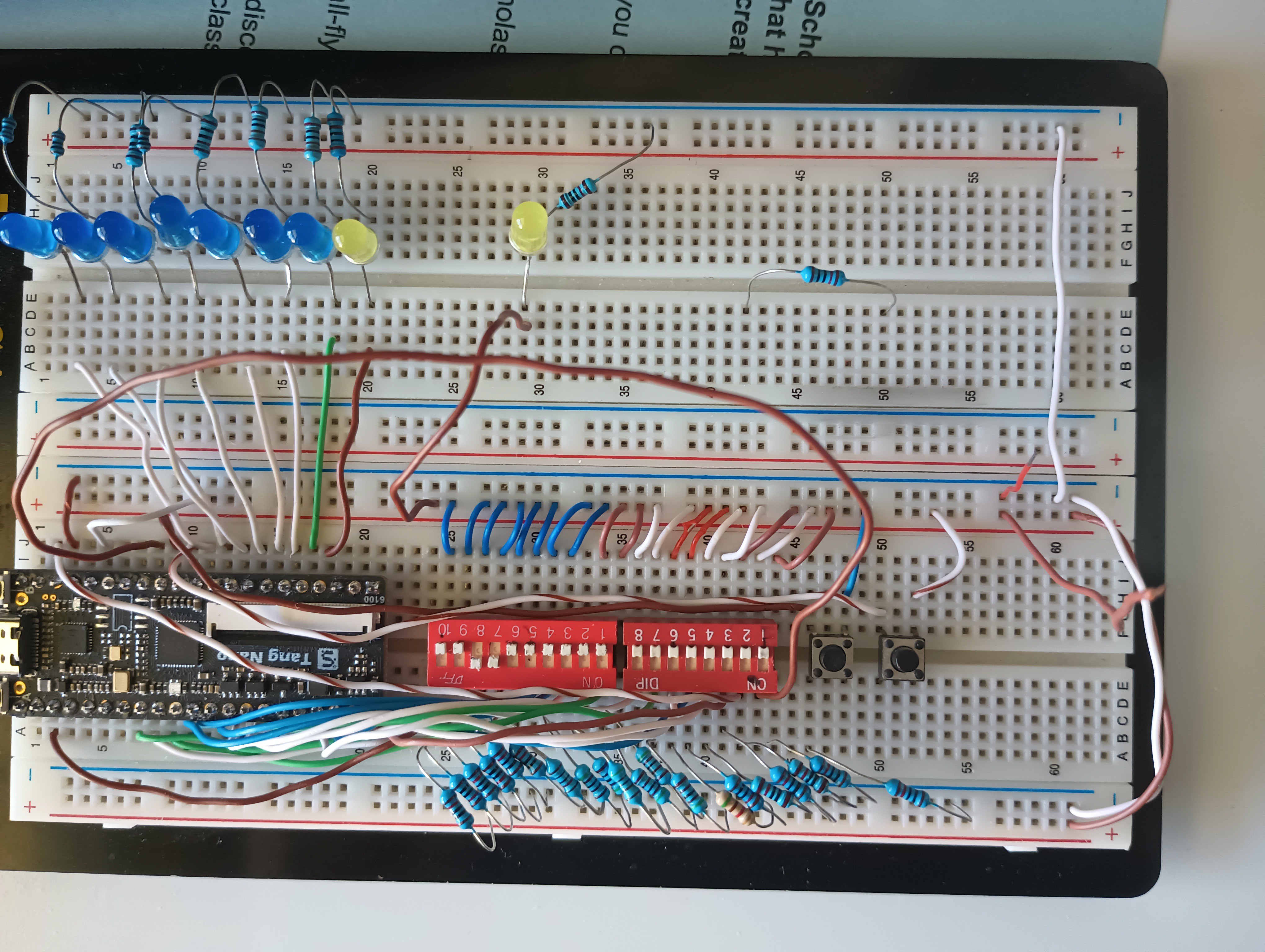

  • ALU works!
    Bohan Xu03/15/2026 at 21:10 0 comments
    YES! The FPGA works! It didn't work because I used one of the MODE pins as a normal I/O and when I would boot it it would not boot my program. I also changed the switches to just wires because that way I wouldn't have to worry about pull-down resistors.
    Please comment or follow! Thanks!
  • Testing ALU
    Bohan Xu03/13/2026 at 21:41 0 comments
    So the ALUI doesn't exactly work. I took the FPGA I was using and put it into a testing circuit. I'm testing it and it doesn't work. Trying to fix it hopefully I will find a solution sometime soon! If you have anything to say please comment! Thanks! Here's a picture:

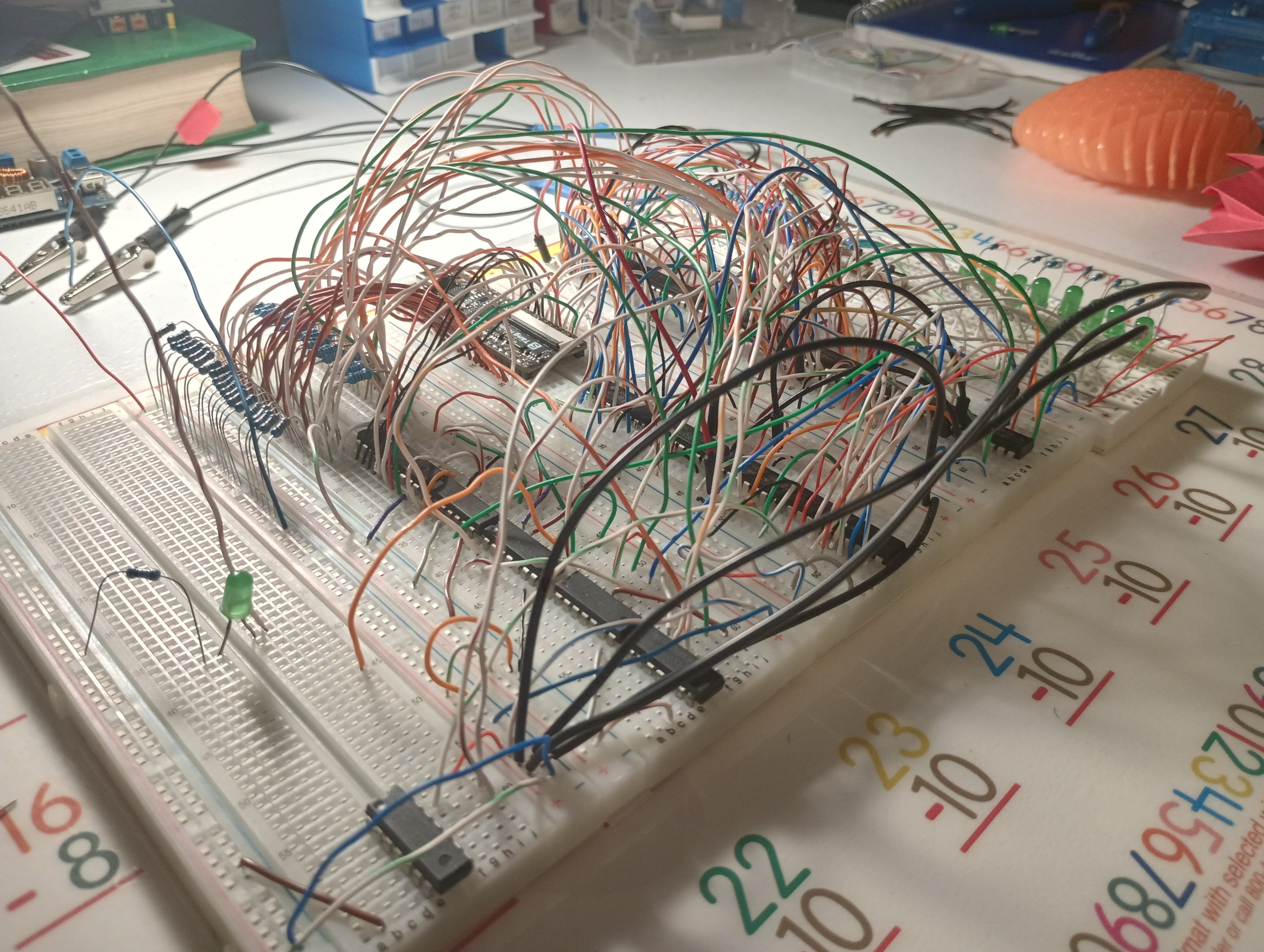

  • Finished building ALU!
    Bohan Xu02/18/2026 at 01:22 2 comments
    I finally finished building the ALU part! Here's a picture. The FPGA in the middle does addition, subtraction, complement, and, or, xor, and shifts. The rest off the chips are buffers, comparaters, registers, and the A register. The eight LEDs are connected to the data bus. If you have any suggestions please comment! Thanks!

MCUer wrote 02/08/2026 at 15:48 point
That’s absolutely amazing for your age!
Bohan Xu wrote 02/08/2026 at 20:45 point
Thanks!
Ken Yap wrote 02/07/2026 at 21:59 point
Should be interesting. More power to you! 👍
