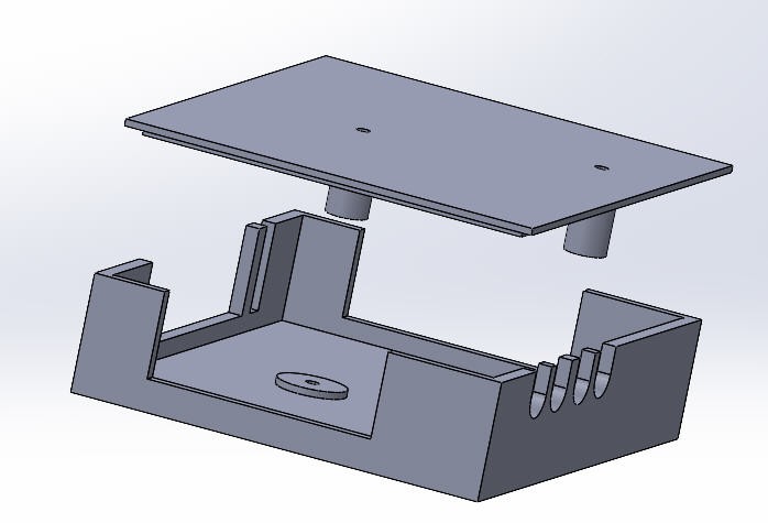

Box for the power box
An enclosure for the PCB can be 3D printed? It will accomodate the PCB soldered with 90° pin headers, so that its form factor should remain "flat" when inserted into the plane.
If you prefer vertical pin headers, you will have to redesign the box (which is not complex !)
Parts are available on thingiverse : https://www.thingiverse.com/thing:7291279
