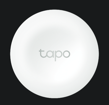

The first iteration of this project attempted to use TP-Link Tapo buttons https://www.tapo.com/en/product/smart-switch/tapo-s200b/ and a basic wifi plug https://www.tp-link.com/us/home-networking/smart-plug/smart-outdoor-plug/ and a fun light which I weirdly found for cheap at home depot: https://nmteaco.com/Solar-System-Night-Light_p_3382.html?p=20
Boy, would that have been nice if it worked. Although it sorta worked, sometimes presses would be missed, and the Tapo buttons don't have any state indicator so if you press it and it fails, you have no way to know. It failed a LOT.
