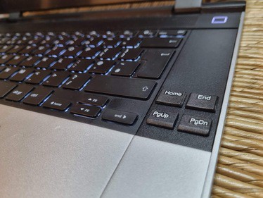

ThinkpadDellFramework

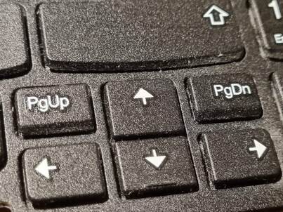

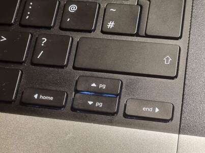

The problem was immediately, glaringly, obvious. I use those keys. All the time, especially when reading articles. Page Up and Page Down are well, if not my most used keys, then surely very often used. And now I have to use the Fn key, clumsily, to access them.

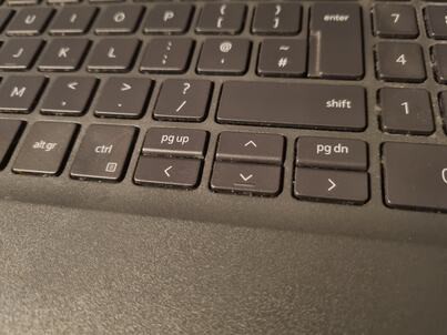

Why couldn't they have done this:
The spaces are right there, sitting empty, doing nothing! Why, Framework, why?!

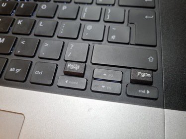

But wait. This is the hackers' laptop. The one where everything can be modified. The one where they want you to mod it. The one where all the firmware and specs and CAD models are published. Then, surely, surely, I can do this:
Disclaimer: May not reflect reality
If those keyboard spacers can have grids of RGBleds on them, then they can have keys, right?

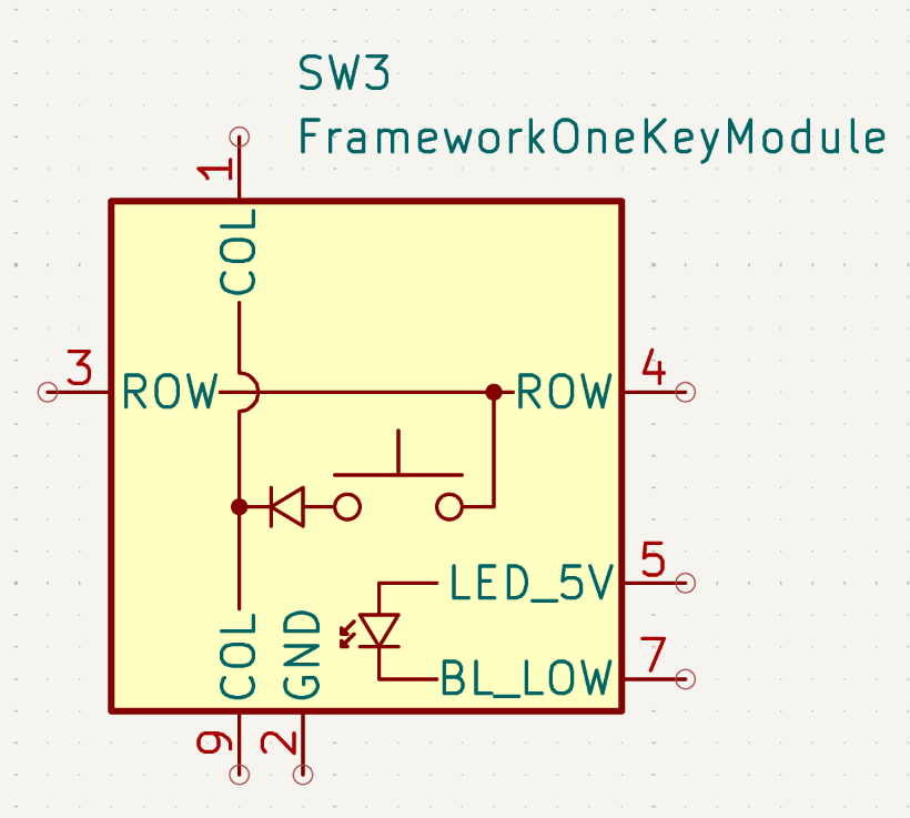

    I realised that Framework have provided a KiCad PCB footprint for the one-key module, but I don't think there's a matching schematic symbol, so i created one. Of course, now I'll discover that there was one all along and I'd just missed it...

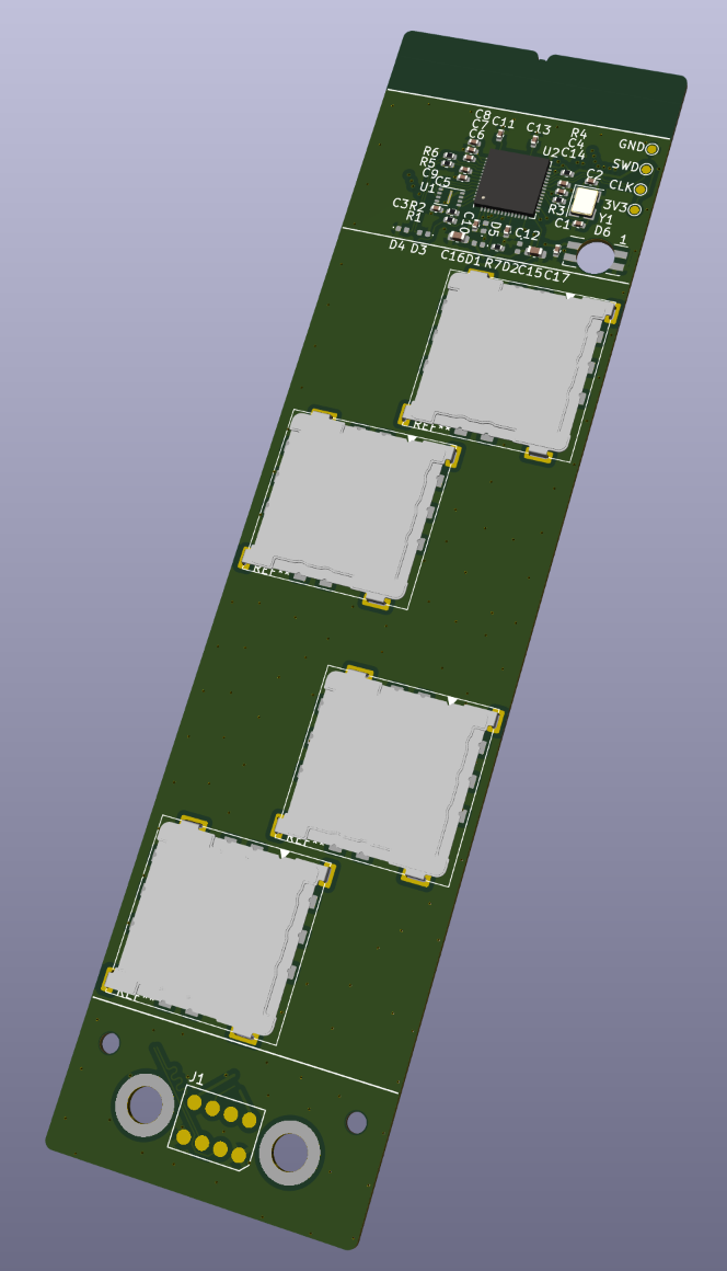

  • Trying PCB layouts
    Matthew • 03/02/2026 at 19:28 • 0 comments

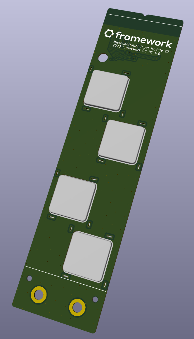

    I've started adapting Framework's "Microcontroller Input Module" reference design to try out potential PCB layouts. Because I want the keys near the bottom of the module as much as possible, next to the arrow keys, I've moved the microcontroller to the top. And I've staggered the keys left and right instead of making a vertical column of them, partly for ease of recognising them by touch, and partly so that I can get PCB tracks between them. There's not much space because the one-key-modules mount to the bottom of the PCB so there needs to be a huge cutout for the keycap to poke through to the top. So I need to make sure I've left enough space for that. It's complicated more by the locating lugs which also eat into space around the modules. This is what I've got so far:
    I'm not sure yet if it might be possible to fit in a fifth key. It depends how much the space "below the line" with the contacts needs to be left clear, and whether I can squeeze the MCU in one of the gaps next to the keys (with all its tracks and supporting components...)

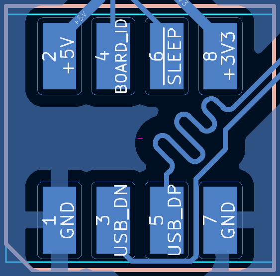

    I know the Framework keyboard uses an RP2040 microcontroller - from the Raspberry Pi Pico. I've never used those (my standard choice is STM32 chips) but I figure it makes sense to use the RP2040 for consistency with the other Framework hardware.
    The electrical connection to the input modules is USB via a pogo-pin connector and they're held in place by magnets:
    The pogo pins provide +5V power and ground, USB and a board ID resistor:
    I can create the connector as pads on a PCB, so I'll need to find a way of making the PCB magnetic so it holds in place.
