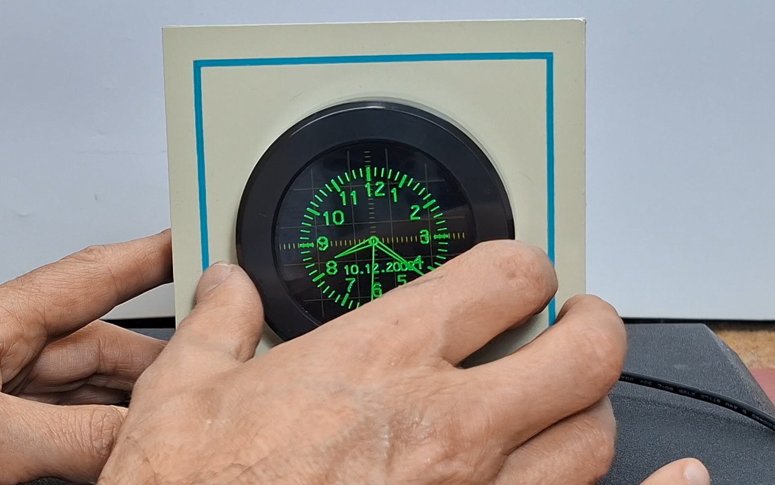

This time I will show you an extremely simple way to make an "oscilloscope clock" on a 2.1 Inch Crowpanel circular display that completely visually imitates the original. Starting from the circular shape of the Display, through the original green color, the marked scale, up to the shape, the way the lines are displayed and illuminated, irresistibly reminds of a CRT Tube.
It is also desirable to mount it in a suitable housing that would resemble a retro CRT oscilloscope for the effect to be maximum.

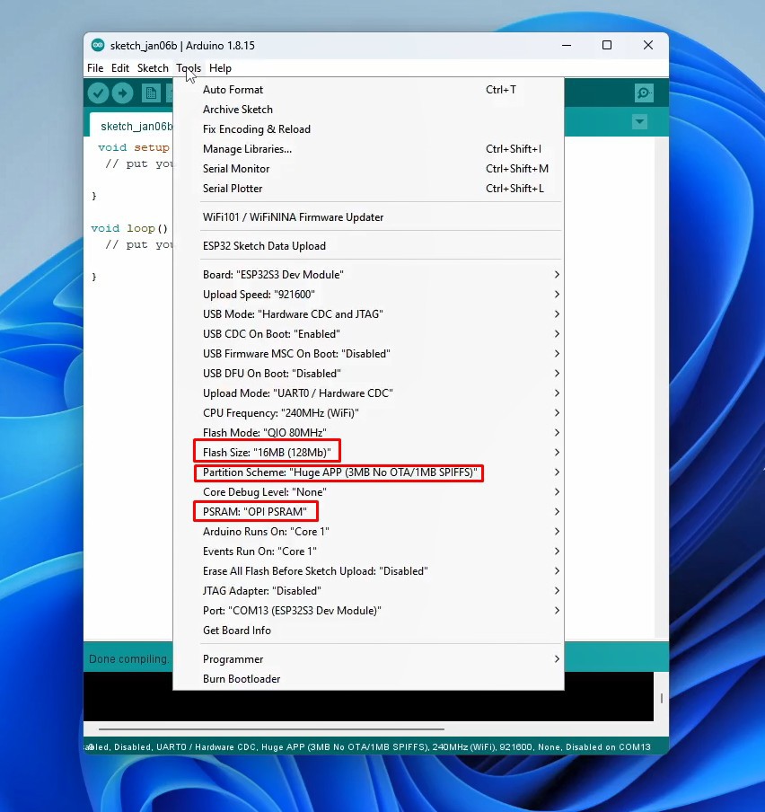

First, you need to use Arduino IDE version 1.8.15 or later. Then you need to install Newest ESP32 Core. Now in Tools-Board-ESP32 Arduino, we need to select ESP32S3 Dev Module. In this board, we need to make several changes to the properties: Flash Size 16MB, Partition scheme- Huge App, and PSRAM - OPI PSRAM.

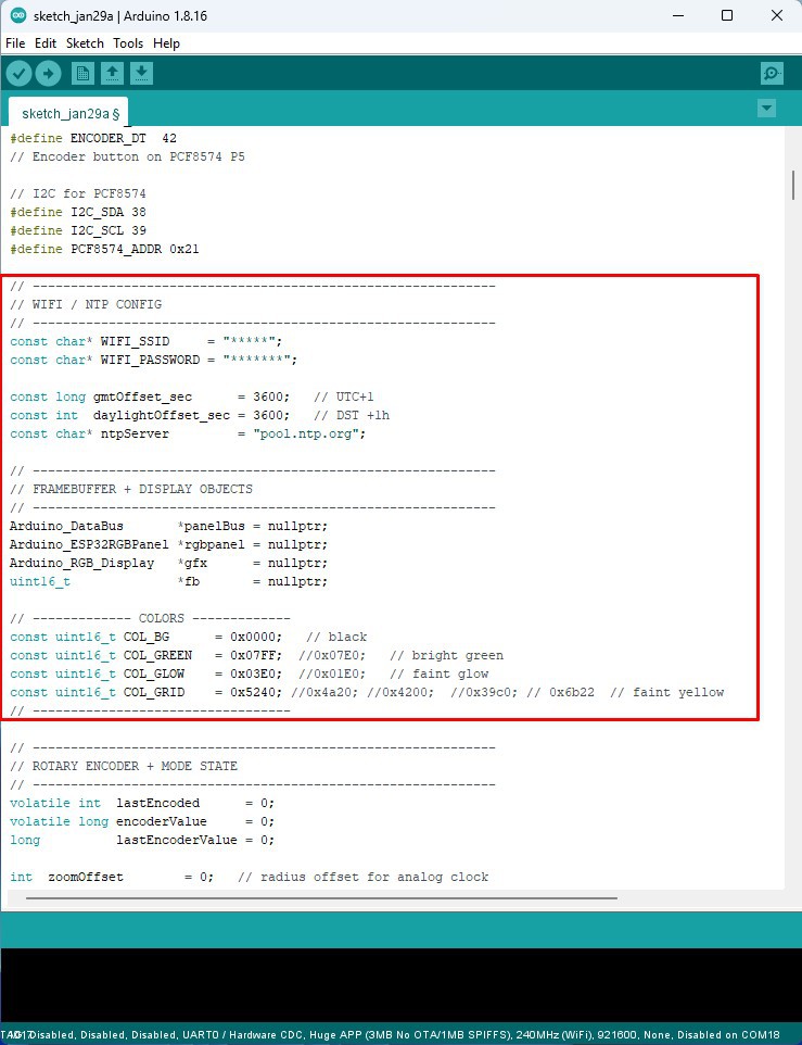

You also need to install the Arduino_GFX_Library. Now we can compile and upload the code without errors. As for the code, the basic settings are located at the beginning, here you need to insert the Wi-Fi credentials, the NTP Server, as well as the definition of the display colors.

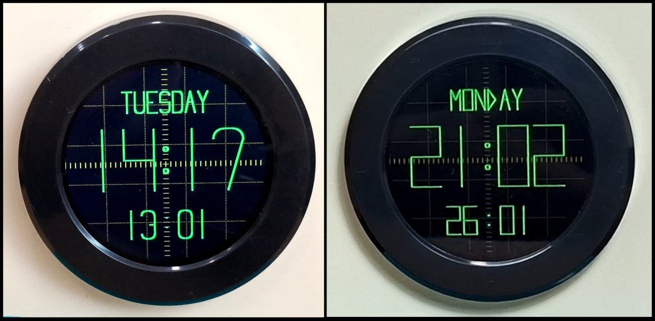

Now let's see how the device works in real conditions. Immediately after turning on the clock connects to the Wi-Fi network and gets the correct time from the NTP server. Then an analog clock appears on the display in the style of an Oscilloscope clock with a characteristic green color. Even a "glow" effect has been added when drawing the characters, but unfortunately it is almost not noticeable in the video recording. To make it even closer to the original, I added an option to change the dimensions of the clock using the rotary encoder that is part of the display module.
In this way is simulated a change in the amplitude of the signals fed to the X and Y inputs on the original oscilloscope. By pressing the display (the button on the rotary encoder), a digital oscilloscope clock is activated, drawn with arcs and straight lines, which is characteristic of the original oscilloscope version. Here, as before, I introduced a "glow" effect. By pressing again, we return to the analog clock. As for the digital clock, in the first version of the code, the content was formed only by drawing straight lines, which is also characteristic of these devices. At the end of the text, both versions of the code are given.
