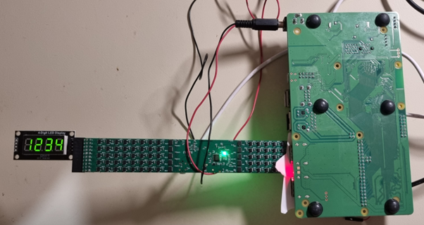

As shown in the picture, Jumperlink has one FPGA in the middle and 20 pins on both left and right sides which is symmetrical in design. a multiplexer is added to each pin between FPGA and connectors, which makes each pin of the board able to be connected to 5V, 3.3V, signal and Ground. All signals are connected to a FPGA in which all of them are able to be configured from software. 3.3V and 5V are selected because they are the most common power in the embedded world.
this is the PCB I completed:

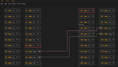

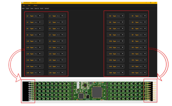

1, Open the software tool
There are 40 units in total, labeled L1–L20 and R1–R20.
They represent the 20 connector pins on the left side and the 20 connector pins on the right side.
2. Select the pin options—such as 5V3.3Vground, or a specific signal type—and connect the
signals together according to your actual requirements.

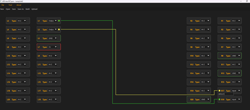

The above configuration is equivalent to the one shown below—imagine two physical wires connected between L15 and R7, and L17 and R9. It would look like this:
3. Click Save to store the file in a local folder.
Click Build to generate the configuration bin file.
Click Upload to download the configuration bin file to the Jumperlink board when the USB cable is connected between the PC and the board.

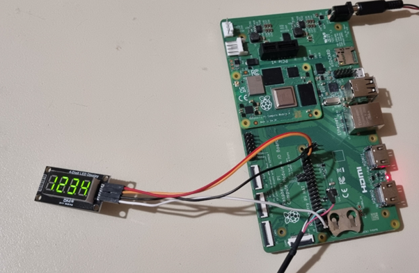

Below is a simple project that I previously worked on.
It’s a simple setup: a Raspberry Pi I/O board connected to a TM1637 LED module. Four jumper wires
are used to establish the connection.

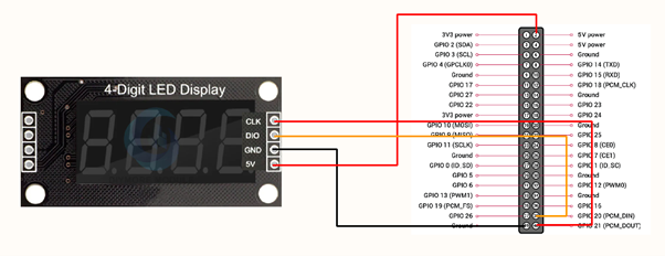

The specific wiring diagram is shown below:
I chose GPIO20 and GPIO21 because they are located at the end of connector J8 on the Raspberry Pi board, making them easy to access and reconnect whenever needed.
However, if I want to use GPIO5 or GPIO6, for example, it becomes less convenient. Each time, I need to refer back to the pinout diagram and count the pins from 39 down to 31 several times to ensure the connections are correct.

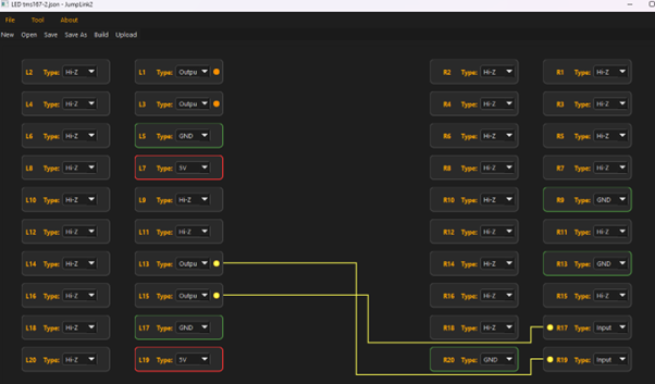

By comparison, using Jumperlink makes the setup much easier. As shown below, I configured GPIO20 and GPIO21 in the Jumperlink application to replicate the same connections as the jumper wires. The detailed configuration is as follows:
No changes are required in the Raspberry Pi software, and the program runs as expected:
As shown, Jumperlink’s right-side connector is aligned with the lower section of the J8 connector on the I/O board (pins 21 to 40). This alignment makes it very easy to verify whether the connections are correct. Compared with using jumper wires—where you often need to count pin numbers repeatedly—the pin order is much easier to follow, as long as Jumperlink is always connected to the CM4 I/O board with bottom alignment.
With this setup, pins R1 to R20 correspond directly to pins 21 to 40 of J8. Users can also rename pins in the app for clarity. For example, R16 can be labeled as GPIO19, since R16 maps to pin 35 of J8.
Once R1 to R20 have been renamed and the configuration file is saved, users can duplicate and reuse it for future projects, as long as the setup is based on the J8 connector of the I/O board.
Now let’s look at how to connect the left-side connector.
The basic rule is that any four pins on the left side can be used for the TM1637 LED module. For example, you can connect L13, L15, L17, and L19 to the module.
Alternatively, the same four pins can be used with the module rotated 180°, depending on the physical orientation of the TM1637 board.

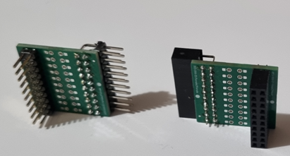

Extend boards
Some of you may have noticed that an extension board was used in the example above. The purpose of the extension board is to make Jumperlink more universal and adaptable to different connector types.
For example:
A male-to-male (head-to-head) pin connector allows Jumperlink to connect to devices with female headers.
A female-to-female extension board allows Jumperlink to connect to devices with male pin headers.
Extension options are also available for right-angle connectors, making it easier to accommodate different mechanical layouts.
