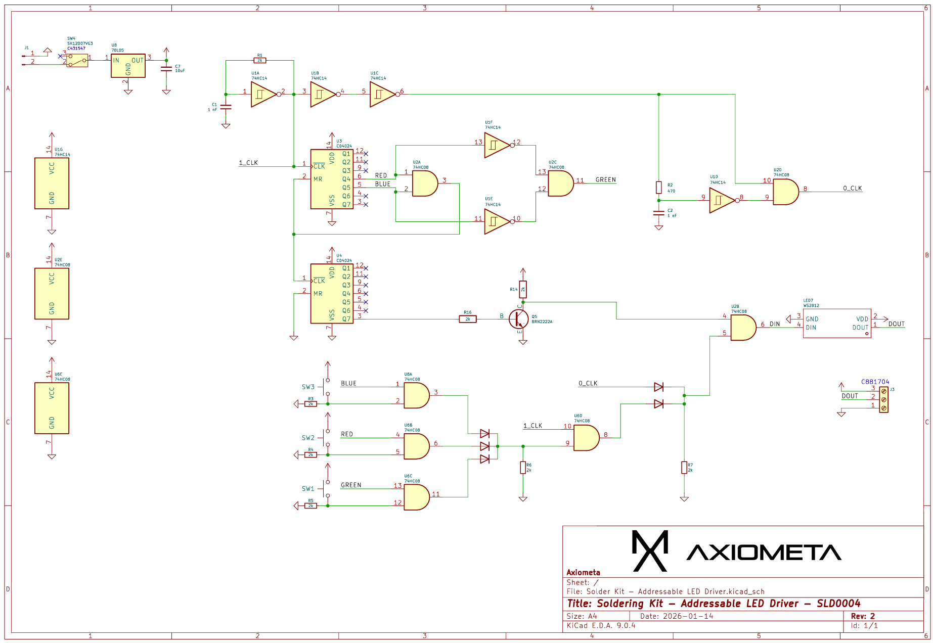

The Full Signal Path
  1. Schmitt trigger oscillator → ~720 kHz clock (also serves as logic-one pulse train)
  2. Phase-shifted AND gate → logic-zero pulse train (shorter highs)
  3. Binary counter → 24-bit cycle with color identification signals for green, red, blue
  4. Buttons + AND gates → on-demand color selection and mixing via OR gate
  5. Final AND gate → selects between long and short pulses based on button state
  6. Second counter → generates 50 µs reset gap every 64 LEDs
  7. Output AND gate → combines data with reset timing → WS2812 data stream

Full Schematic

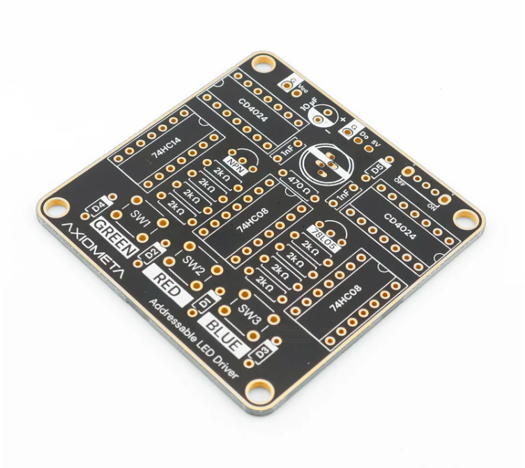

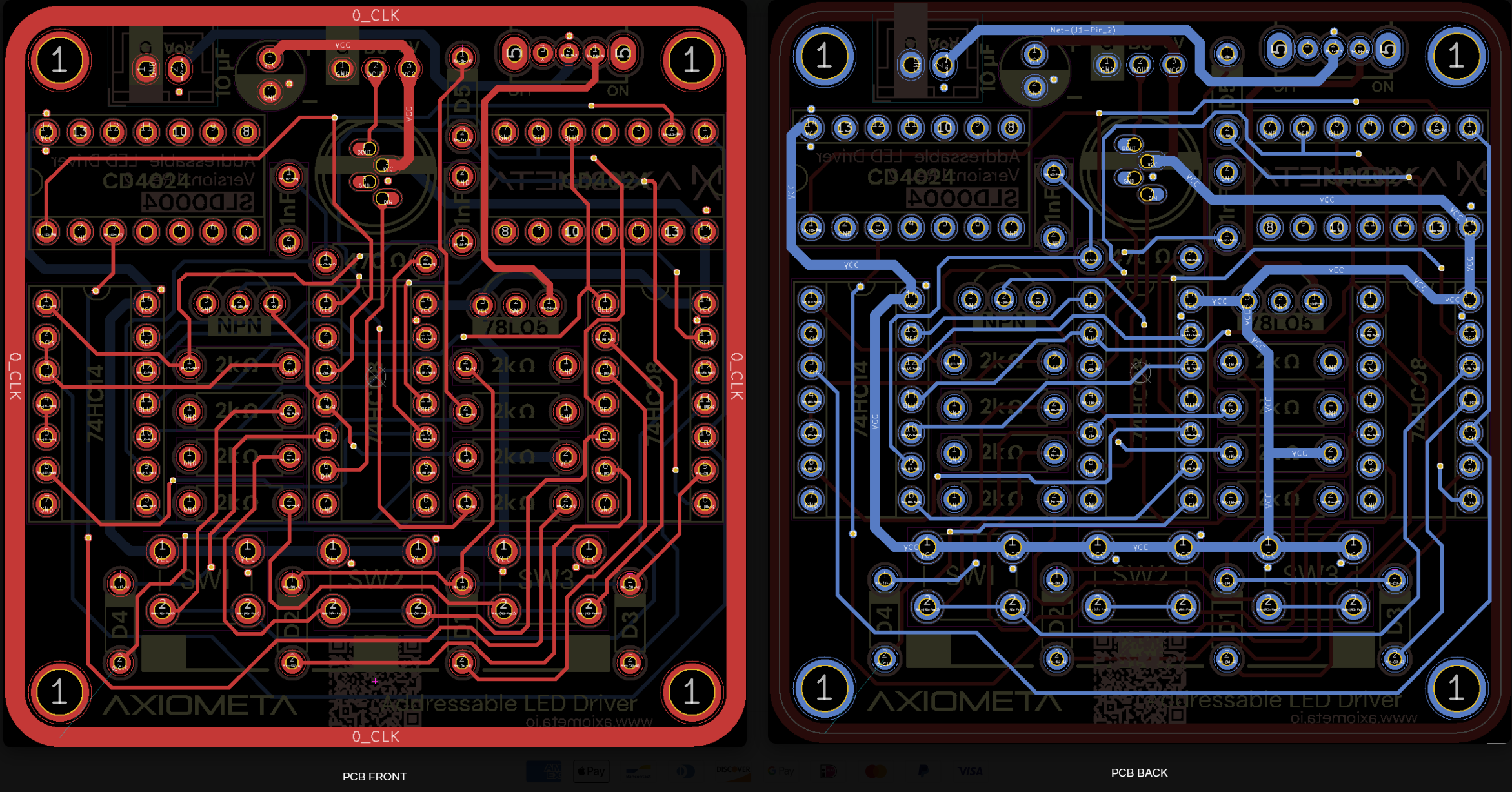

The PCB
I laid out a soldering kit version of the circuit, designed to be 55 mm × 55 mm and symmetrical. It includes a through-hole WS2812 LED on the board itself so it works standalone without an external strip. Three buttons, all the logic, and a header for connecting more LEDs if you want.
After soldering everything and spending an entire day debugging: a self-sustaining, code-free WS2812 driver. Three buttons for RGB, hold two for mixing.
