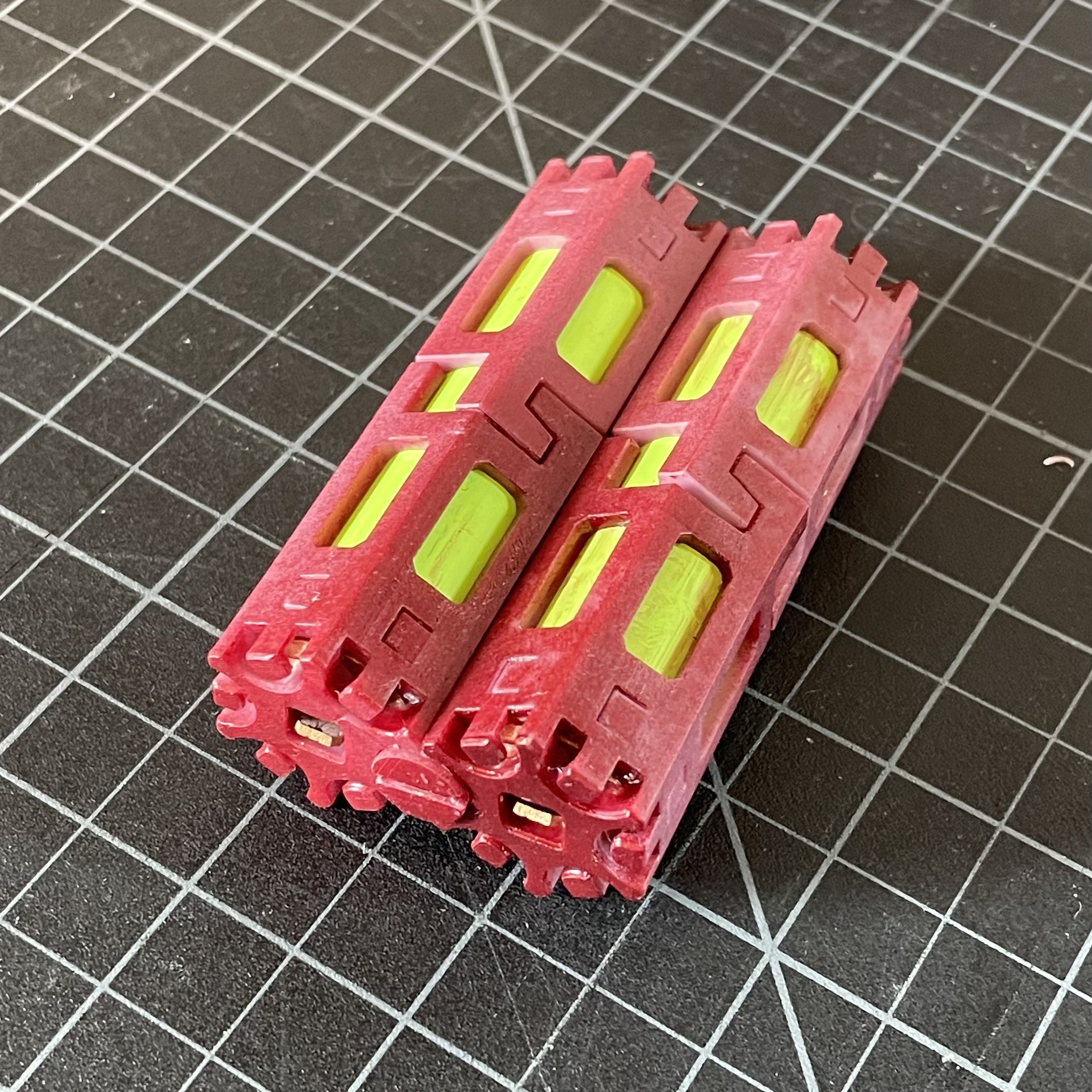

I took inspiration from standard cell holders, and begun trying to incorporate electrical connections into the overall square or hexagonal profile of these plastic parts. These initial efforts produced mixed results, with poor connections that would sometimes make it to the correct voltage, but often would work their way loose during assembly or usage. Additionally, they didn’t provide the mechanical rigidity I was looking for in the full battery.
Initial Prototypes
I then started to design my own press fit connectors, using 3d printed parts and laser cut copper sheet to connect the batteries, which was a significant improvement, but still suffered from issues when attaching more than 4 or 5 cells together. It was around this point where I got stuck, and started to work on other projects.

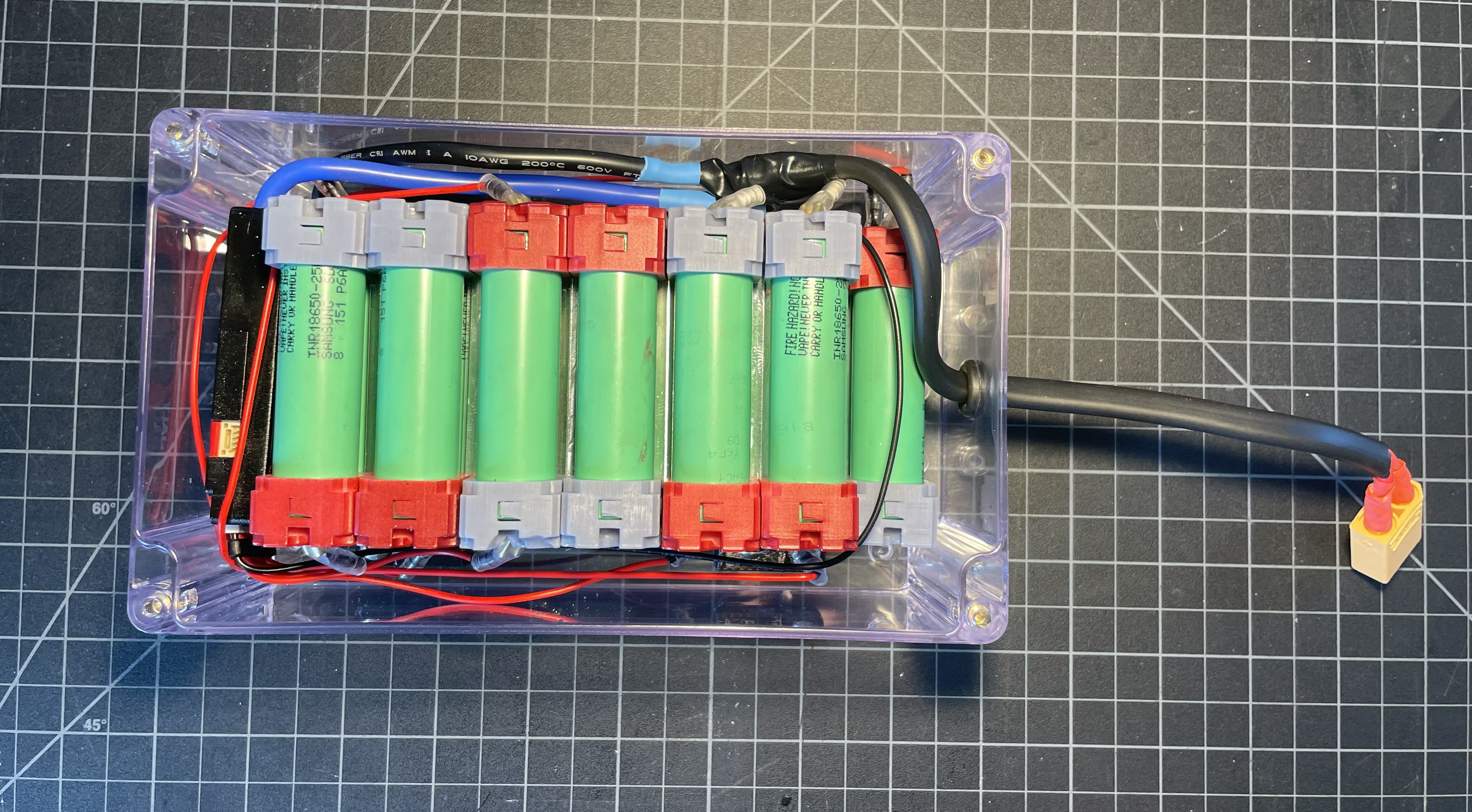

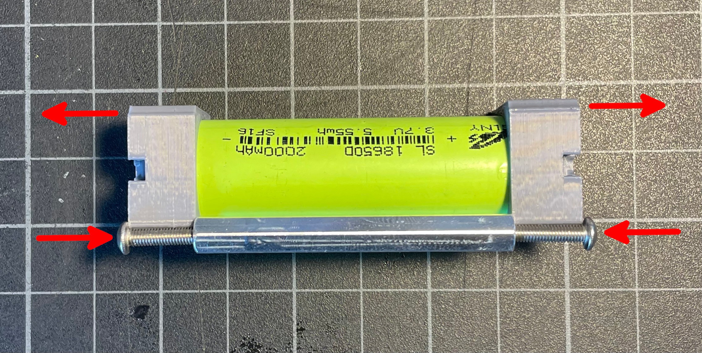

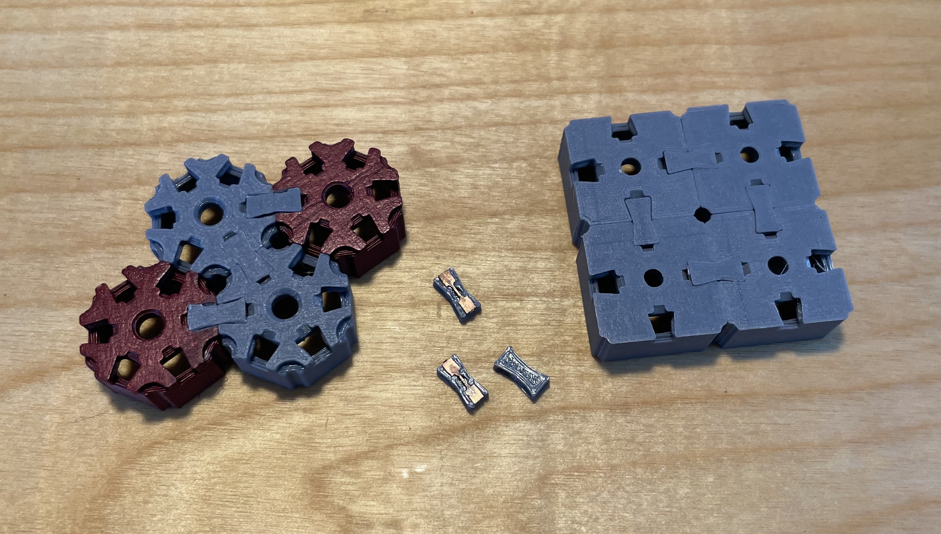

The current Cell-Lock design uses a twisting connector to attach pairs of battery caps. These connectors are either entirely plastic to attach batteries without conducting electricity or include a copper pad on the bottom to form a solid electrical connection. Using a screwdriver to twist the connector 60 degrees engages the cam; locking the two caps together and creating a strong connection. Parallel and series cell groups can be attached and tested in this manner before continuing assembly. The cell caps on the positive and negative sides are held in place using M3 aluminum screws and 60mm standoffs or can simply be mounted directly into their enclosure.
Batteries built using these connectors perform much better than any of my earlier prototypes, and I’m currently using a 36-volt battery to power my E-bike with no vibration or strength issues.

I’m still working on improving the design and assembly process for these parts, as my current method involves a lot of manual fussing around with the small copper parts that I use for the connectors. Currently, I use a resin printer to make the plastic components, and order my copper parts from SendCutSend, which are then shaped and attached using several custom jigs.
