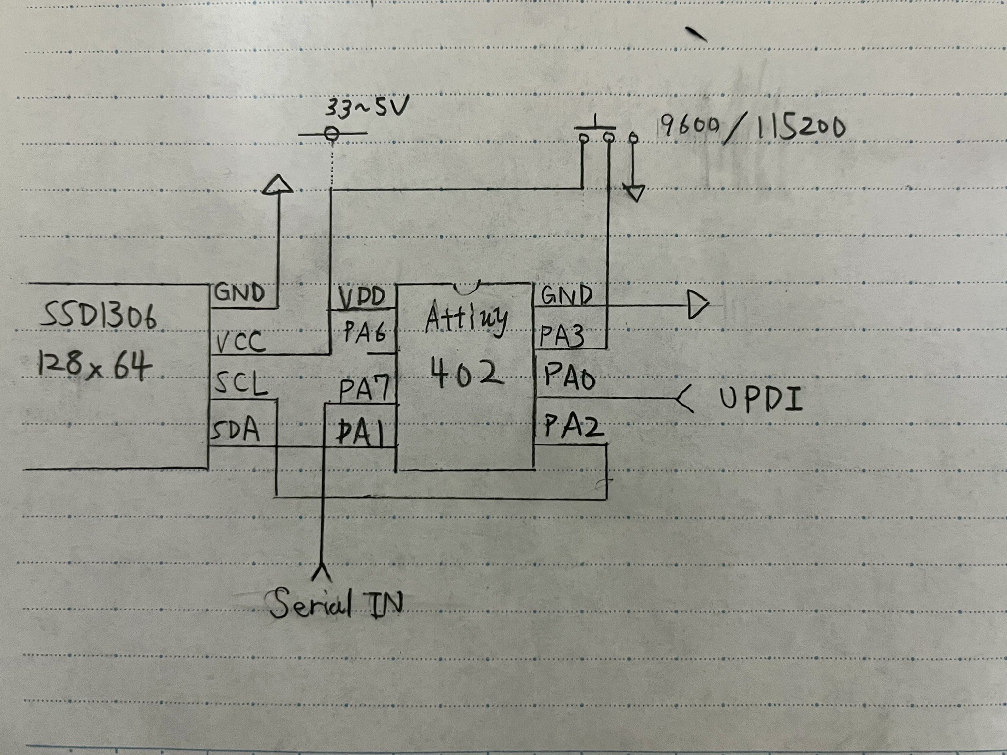

How to Use
After selecting the appropriate baud rate with the switch, connect the signal line to PA7/DAT and then connect GND.
Pocket-sized serial monitor
