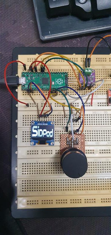

    Around February/March of 2024 I came across a GitHub repo that let you create a SID player based on a Raspberry Pi Pico called SIDPod. I liked how simple it seemed to use a microcontroller to play SID files so of course I had to build it.
    SIDPod testbuild

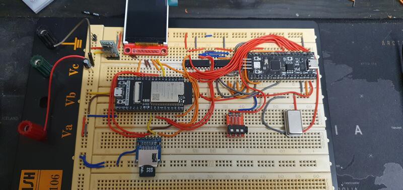

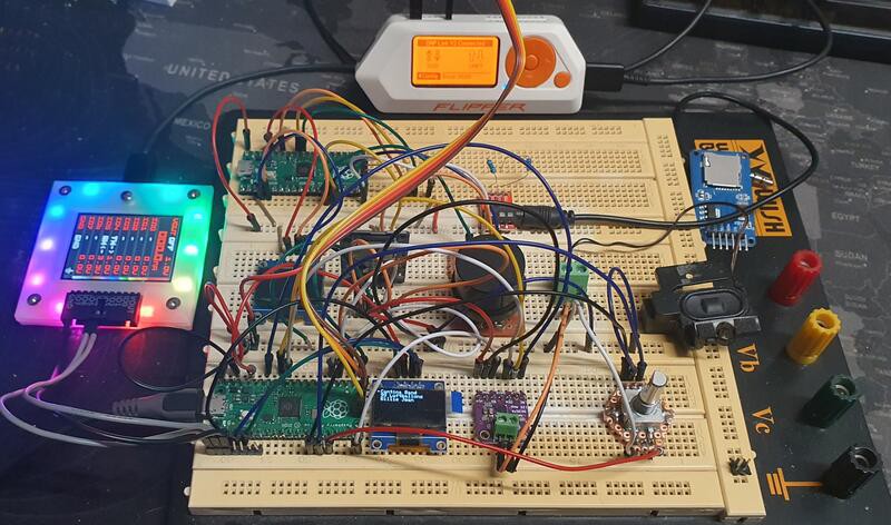

    In early April 2024 still not satisfied by the results I found ESP32-SIDView. This seemed like a nice replacement SID player for SIDPod with the added benefit of supporting real SID chips! Building one was the logical next step, but since I did not own any real SIDs at that time I had to find one. SIDKICK-pico was the first SID replacement I found, no schematics, but orderable. Having some hobby level experience in hardware reverse engineering I recreated a schematic and figured out the Pico to DIP-28 pinout so I could use it on a breadboard.
    ESP32-SIDView testbuild

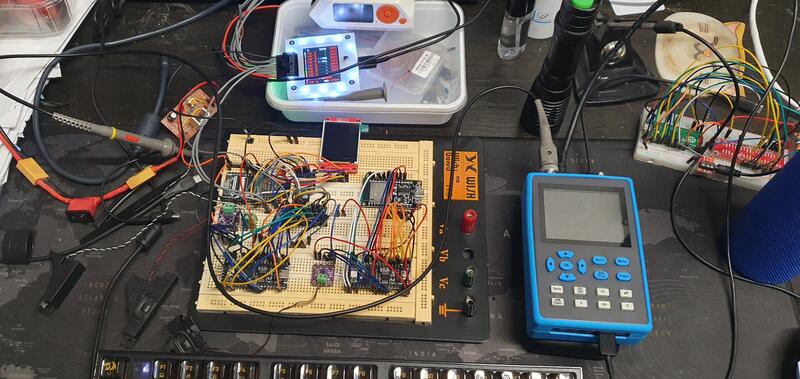

    Not being satisfied with the spaghetti in that picture, I had to tidy things up a bit.
    ESP32-SIDView tidy testbuild
    Having some issues getting ESP32-SIDView to work, I contacted its developer tobozo through GitHub. We exchanged countless messages about this project on GitHub. We later moved to a different platform and continued talking (and still do) about his and my project(s), coding, cats, daily life etc. This one GitHub issue lead to a, if I may say so, great digital friendship.

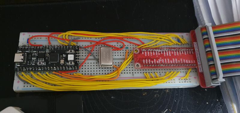

    In the meantime I also found SidBerry. A Linux based console application for playing SID tunes via the Raspberry Pi's (not Pico) GPIO pins.
    RPi breadboard extension with SKPico

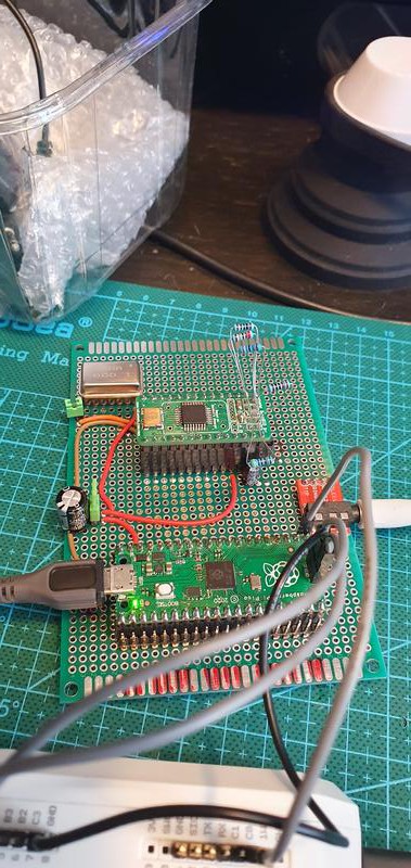

    Log: FTDI USBSID - First Try at a USB SID Controller (May 2024)
    SidBerry with Raspberry Pi is what in early May of 2024 eventually led to the creation of FTDI USBSID, my first try at creating a USB controlled SID device. To do this I used a FTDI FT223HL breakout board I already owned for reverse engineering. Somewhere in between I acquired a v0.1 SIDKICK-pico and 2 half broken MOS6581's.
    FTDI USBSID
    Creating your own hardware supporting board meant also creating software support. Reminiscing about that, here are the links:
    Using the FTDI breakout board came with a lot of limitations. It wasn't a microcontroller, so all the GPIO writes and input/output switching had to be done in the driver and using the FTDI ecosystem wasn't really something I enjoyed.

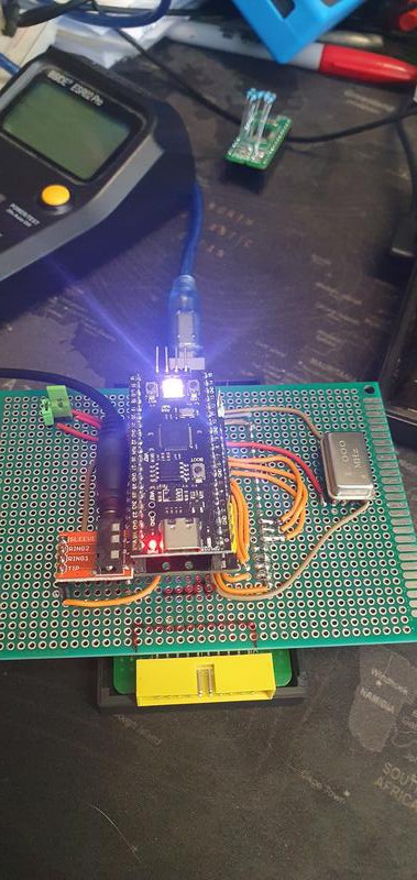

    Log: PicoUSBSID - Single SID Perfboard (May 2024)
    By the end of May 2024, having had enough of the FTDI limitations, is what led up to creating USBSID-Pico, or actually called PicoUSBSID at that time. A perfboard version with support for a single SID.
    PicoUSBSID single SID version

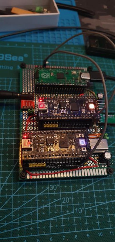

    Log: Dual SID Perfboard (June 2024)
    Halfway through June of 2024, I added dual SID support to the same perfboard.
    PicoUSBSID dual SID version
    With the continued support and encouragement of tobozo (thanks m8) the first actual USBSID-Pico v0.1 board came to life that...
