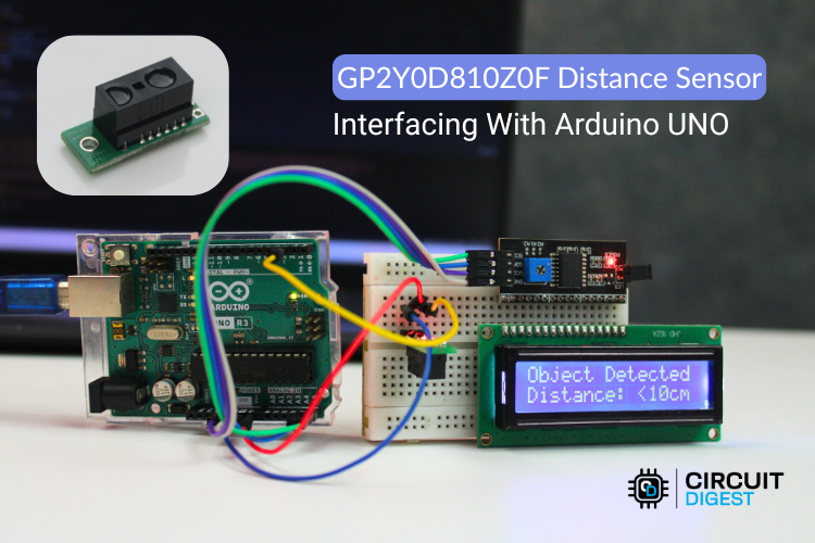

🚀 Project Overview
This project turns the GP2Y0D80Z0F digital infrared sensor into a rapid proximity detector with visual feedback on a 16×2 I²C LCD and serial console. It reports whether an object is within ~10 cm in real time, making it ideal for obstacles, presence sensing, interactive installations, or basic automation.
Unlike analog distance modules, the GP2Y0D80Z0F outputs a simple HIGH/LOW signal that your Arduino can read directly — no ADC or conversion math needed.

📍 How It Works
The GP2Y0D80Z0F Distance Sensor with Arduino Uno emits infrared light and detects reflections from nearby surfaces. When an object enters ~10 cm range, its output goes LOW. When nothing is close, it stays HIGH. Your Arduino reads this digital pin and updates the display + serial output accordingly.
Quick tip: The sensor’s binary output means it can’t measure exact distance — only object present or not present.

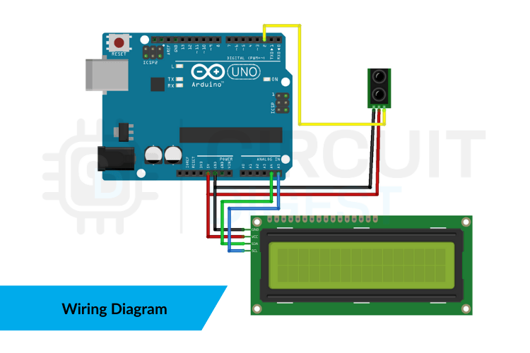

🔧 Wiring

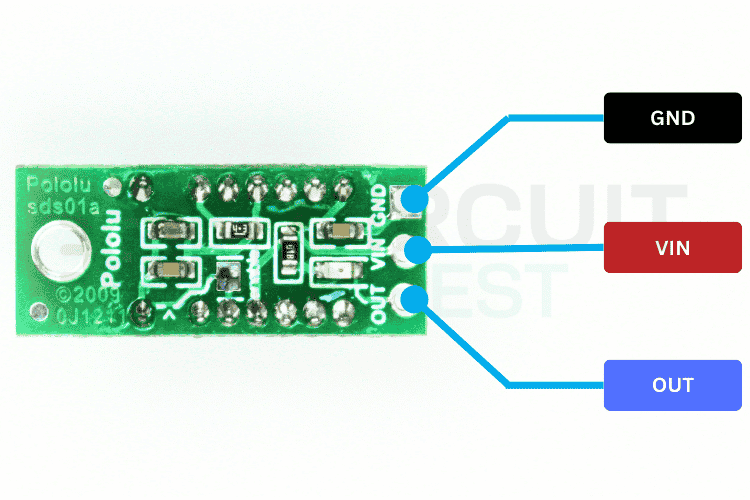

GP2Y0D80Z0F → Arduino Uno
  • VIN → 5 V
  • GND → GND
  • OUT → Digital Pin 2
16×2 I²C LCD → Arduino Uno
  • SDA → A4
  • SCL → A5
  • VCC → 5 V
  • GND → GND
