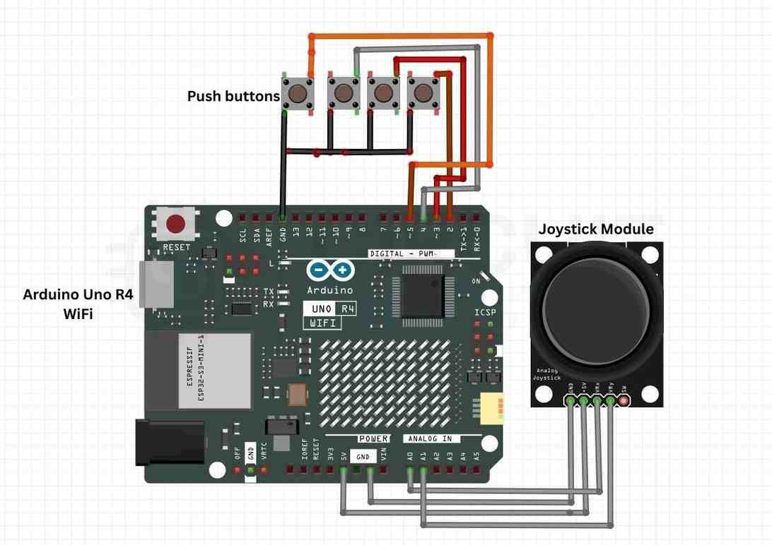

Circuit & Wiring
Joystick:
X-axis → A0
Y-axis → A1
VCC → 5 V, GND → GND
Buttons:
Four button terminals → Digital Pins 2–5
Other button terminal → GND
Internal pull-ups used in code (no extra resistors).
This wiring lets the Uno read analog joystick positions and digital button presses.

Connect the joystick to the analog inputs and power pins on the Arduino.
Wire the push buttons to digital pins (2–5) and ground, enabling internal pull-ups in software.

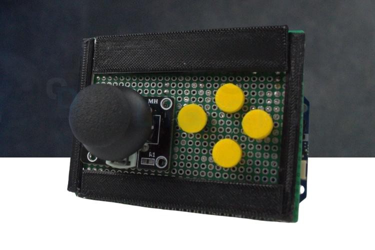

Mount everything on perfboard neatly — solder for strength and durability.
Connect the Arduino to your PC via USB for power and data.
