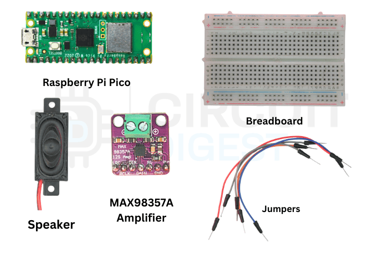

🛠️ Parts You’ll Need
ComponentNotes
Raspberry Pi Pico WWi-Fi enabled microcontroller
MAX98357A I²S amplifierDrives speaker from Pico audio data
Speaker (4Ω–8Ω)Produces speech output
Breadboard & jumpersFor prototyping
USB cablePower & programming
This setup uses the Pico’s I²S interface to output audio via the amplifier and speaker.

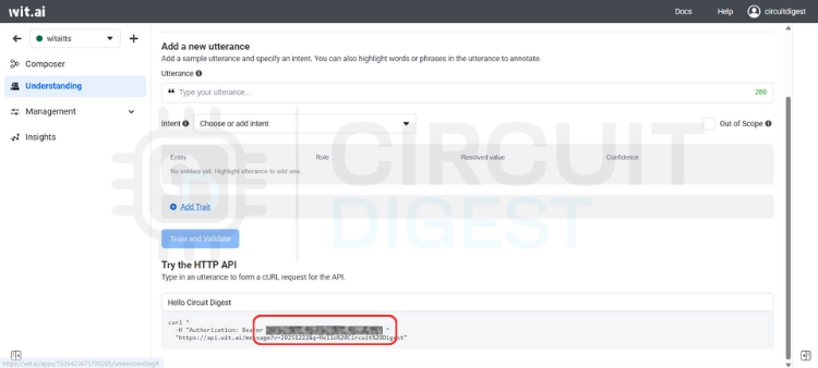

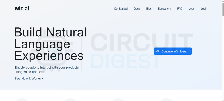

☁️ Set Up a TTS Service
This project uses Wit.ai (a free AI speech service by Meta) to generate audio from text:
  1. Create a free account at the Wit.ai website and log in.
  2. Create a new application for your Raspberry Pi Pico Text to Speech using AI.
  3. Find the Server Access Token (Bearer token) in the app settings.
  4. Save this token securely — you’ll need it in your code.
