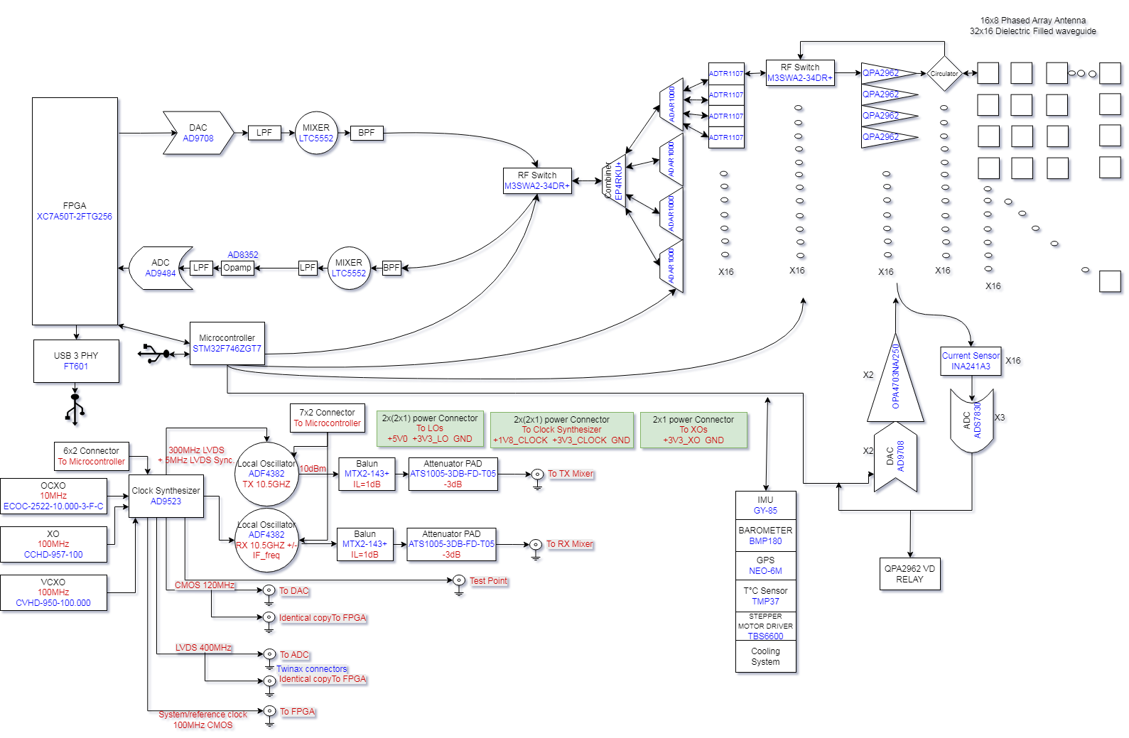

I'm building the “AERIS-10” to change that. An open source “32x16 element X-band phased array radar” with full electronic beam steering, Pulse Linear Frequency Modulation (LFM) at a fraction of traditional cost.

AERIS-10 changes this. By combining modern SDR technology with an innovative system, we deliver true phased array performance at 90-95% below commercial alternatives—with open APIs that let you build your own applications.

- Frequency: 10.5GHz
- Antenna Type: 8x16 patch antenna array for the Nexus and 32x16 dielectric-filled slotted waveguide antenna array for the Extended version.
- Electronically controlled Elevation and Azimuth Beam steering. (The prototype uses the 16 antenna elements to steer the Elevation beam and the Azimuth is performed using a stepper motor; but the designed system can be hacked to control both Elevation and Azimuth electronically.
- Output: Range & Doppler of Multi-Targets
- Interface: A GUI written in Python
- A Power Management Board that supplies all the necessary voltage levels to the electronics components with proper filtering and sequencing (This late is ensured by the microcontroller)
- A Frequency Synthesizer Board using a high performance Low Jitter Clock Generator (AD9523-1) that supplies phased aligned clock references for the:
- RX and TX Frequency Synthesizers (ADF4382)
- DAC
- ADC
- FPGA
- A Main Board containing:
- A DAC to generate the RADAR Chirps
- 2 Microwave Mixers (LT5552) for up-conversion and IF-down-conversion
- 4 4-Channels Phase Shifters (ADAR1000) for the RX and TX chain
- 16 Front End chips (ADTR1107) used for Both Low Noise Amplifying (RX) and Power Amplifying (TX) Stages
- An XC7A100T FPGA used for RADAR Signal Processing:
- PLFM Chirps generation via the DAC
- Raw ADC data read
- AGC
- I/Q Baseband Down-Conversion
- Decimation
- Filtering
- Forward FFT
- Pulse Compression
- Doppler, MTI and CFAR processing
- USB Interface
- An STM32F746xx Microcontroller used to:
- Ensure the proper powering up and down sequencing (Check the Power Management Excel File)
- Communicate with the FPGA
- Setup and Interface with the following components:
- The Clock Generator (AD9523-1)
- The 2 Frequency Synthesizers (ADF4382)
- The 4 4-Channels Phase Shifters (ADAR1000) for proper RADAR pulse sequencing
- The 2 ADS7830 ADCs used on the 16 Power Amplifier Boards to measure Idq
- The 2 DAC5578 used on the 16 Power Amplifier Boards to control Vg
- The GPS used to set the center of the map on the GUI
- The GY_85 IMU to apply pitch and roll correction to the processed target longitude and latitude
- The BMP180 Barometer
- The Stepper Motor
- The 8 ADS7830 Temperature Sensors used to activate the Cooling Fans
- RF switches

The AERIS-10 main sub-systems are:
- 16 Power Amplifier Boards used only for the AERIS-10E where a 10Watt QPA2962 GaN amplifier has been chosen to extend the RADAR Range
- 8x16 patch antenna array board for the Nexus and 32x16 dielectric-filled slotted waveguide antenna array for the Extended version
- Miscellaneous (Slip-Ring, Stepper Motor and its drivers, Cooling Fan, Enclosure…)
