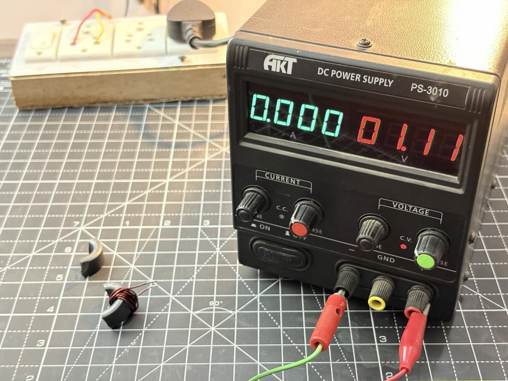

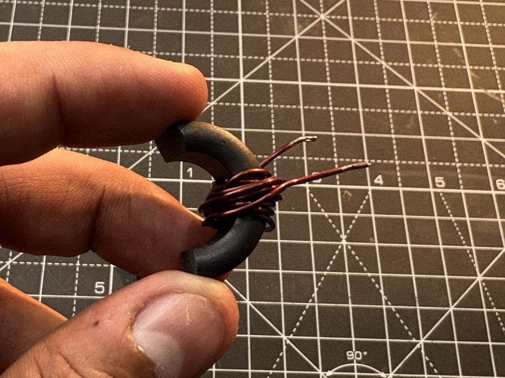

The toroidal ferrite core is the heart of this ammeter. You can salvage one from an old power supply, a common-mode choke, or buy one online. The size doesn't matter too much, but a larger core gives you more room to wind wires.

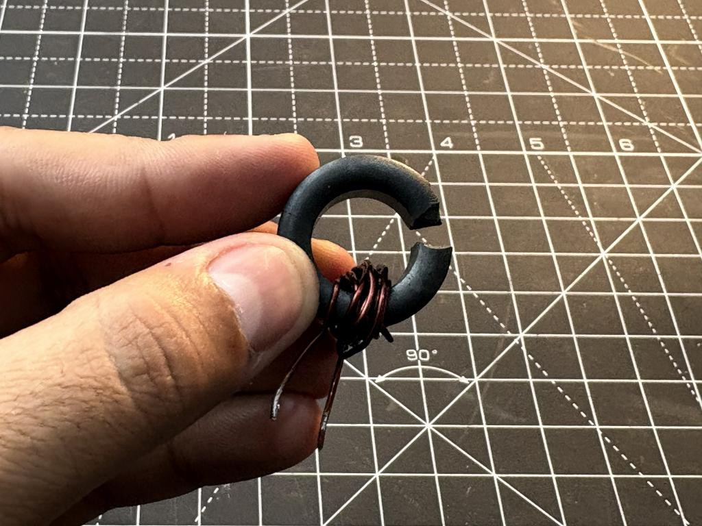

Cutting the Air Gap:
This is the most critical and tricky step. We need to cut a small gap in the toroid where the Hall sensor will sit. Let me tell you what I did, I just took a plier and broke it into two pieces. This may be non ideal but I can later glue the parts to fix it. You can use a Dremel with a thin cutting disc or a fine hacksaw blade. Cut slowly and steadily. After cutting, use fine sandpaper to smooth both cut faces. The smoother the surfaces, the smaller the effective air gap, which means better flux coupling to the sensor. The air gap should be as small as practically possible while still fitting the sensor. A larger gap means more flux leakage and lower sensitivity.
Winding the Toroid:
I used 10 turns of 24 AWG enamelled copper wire on a ferrite core.The number of windings (N) acts as a multiplier for the magnetic field. More windings mean a stronger magnetic field for the same current. Higher output voltage from the Hall sensor for the same current.nBetter resolution because small changes in current produce larger changes in voltage. Easier ADC conversion because the voltage swing is larger. For example, if 10 turns at 1A gives you 0.5V output, then 20 turns at 1A might give you 1.0V output. The higher voltage is easier to read with an Arduino ADC and gives you finer measurement steps.
However, too many windings can saturate the ferrite core at higher currents, and the core has a limited physical size. So you need to balance the number of windings with your expected current range.

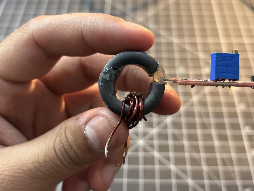

Placing the Hall Effect Sensor
You can place the sensor, make sure it is flat in the middle of the gap, then secure it using hot glue and some tape. The orientation decides the polarity, but it doesn’t matter even in this case because the steady state sensor readings are common mode by VDD/2. We will talk about it in the measurements section. Wire connections are really simple:

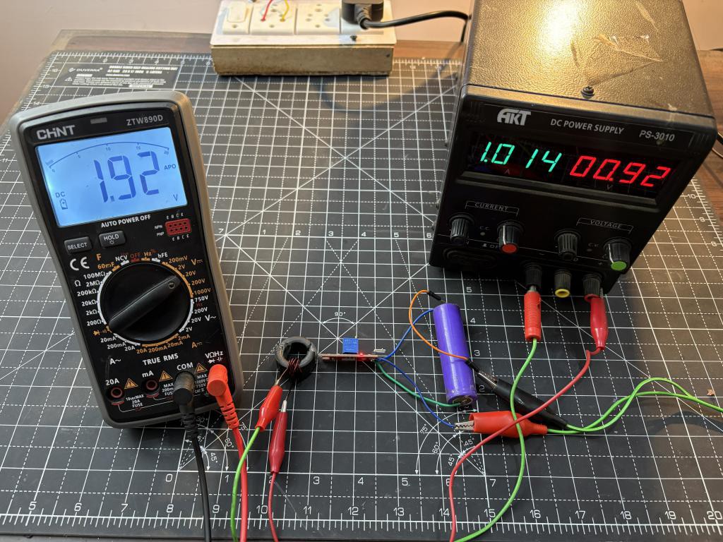

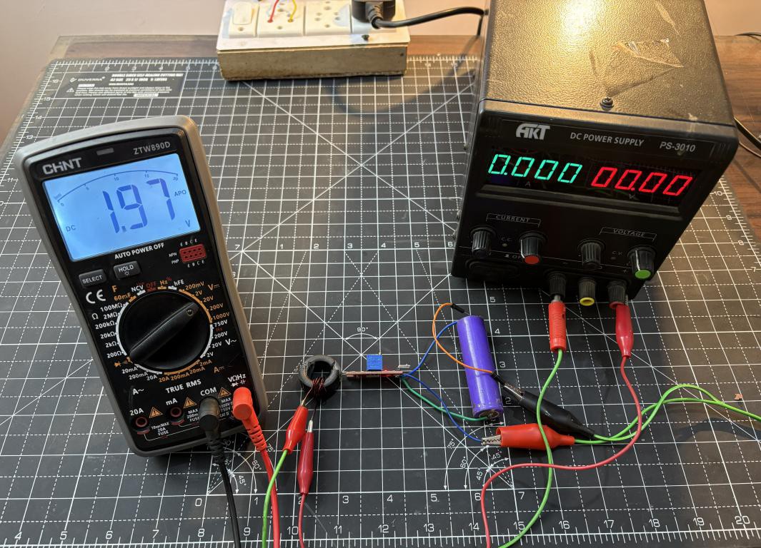

Taking First Reading:
The sensor output pin produces a voltage proportional to the current flowing through the windings. Now to measure this voltage either can use a multimeter and then convert the readings to current values manually. I did it by flowing a constant current from my lab bench power supply and then writing down the voltage at 1A, 2A and 3A. Which gives me an idea how the readings change.
For example at steady state, when no current is flowing the output voltage is VDD/2 + offset. When the current starts flowing it changes by some value, decreasing or increasing based on how the sensor is placed and in what direction current is flowing. Which means it is capable of measuring bidirectional current.
Steady State:
At 1A Current:
As you can see, the output is linear, the voltage increases proportionally with current. This is exactly what we expected from the theory. The linearity is key because it means we can use a simple linear equation to convert voltage back to current or just do it in excel by measuring slope.

Working:
1A:
2A:
3A:

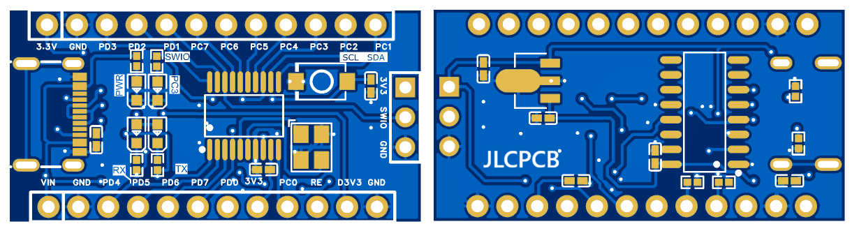

Giving a try to Low cost MCU:
Because over the time Arduino Nano/UNO got old, still it is the king of prototyping but, as RISC-V came into the market even with a very low price tag, industry start moving towards it. Due to the overpower speed, functions and low power features here is the my design of CH32V003 development board which can be a great alternative to arduino for this project. You can see all the details from here. And if you want to have the same board Download the Gerber files from here.
It is designed in the same form factor of a Arduino Nano. I got my fabricated one from the JLCPCB, and they have done a great job in the PCB side. I will release a full coding tutorial soon.
