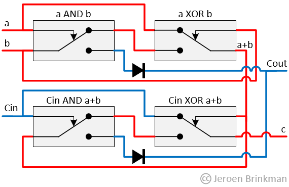

How the binary adder works
The diagram shows a 1‑bit full binary adder, which adds two binary inputs (a and b) together with an incoming carry (Cin). The circuit produces two outputs: the sum bit (C) and the carry‑out (Cout).
First, the inputs a and b are combined using both an XOR and an AND operation. The XOR gate generates the preliminary sum (a ⊕ b), while the AND gate generates a carry if both inputs are high (a ∧ b).
Next, the incoming carry (Cin) is added to this preliminary sum. Again, an XOR operation produces the final sum bit (C), and an AND operation detects whether this second addition generates a carry.
Finally, the two possible carry signals are combined to form the output carry (Cout). This means Cout goes high if either:
- a and b are both high, or
- Cin is high while a ⊕ b is high
In logical terms:
- C = a ⊕ b ⊕ Cin
- Cout = (a ∧ b) ∨ (Cin ∧ (a ⊕ b))
By cascading multiple identical stages, this 1‑bit adder can be extended to form a multi‑bit binary adder.
