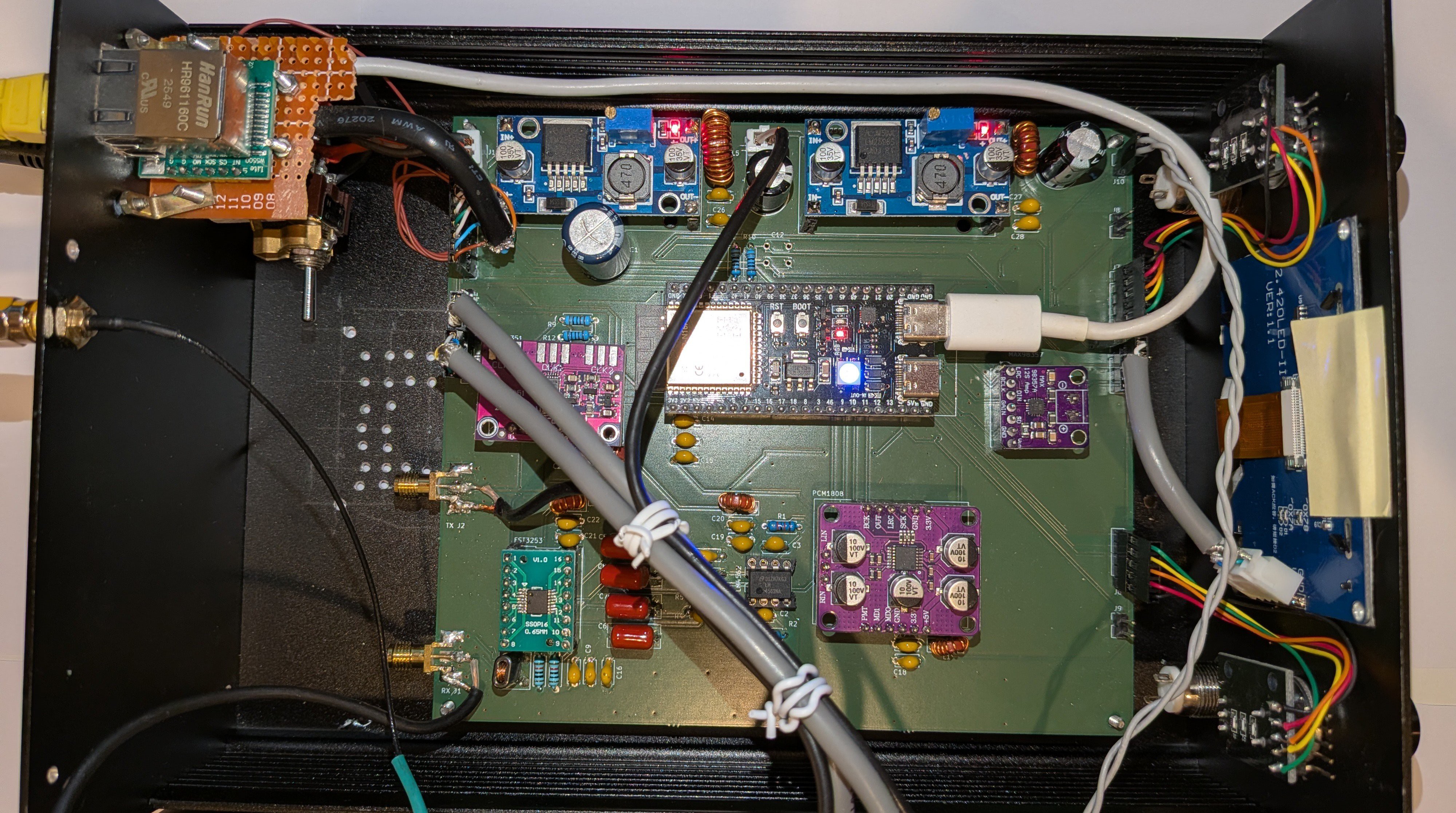

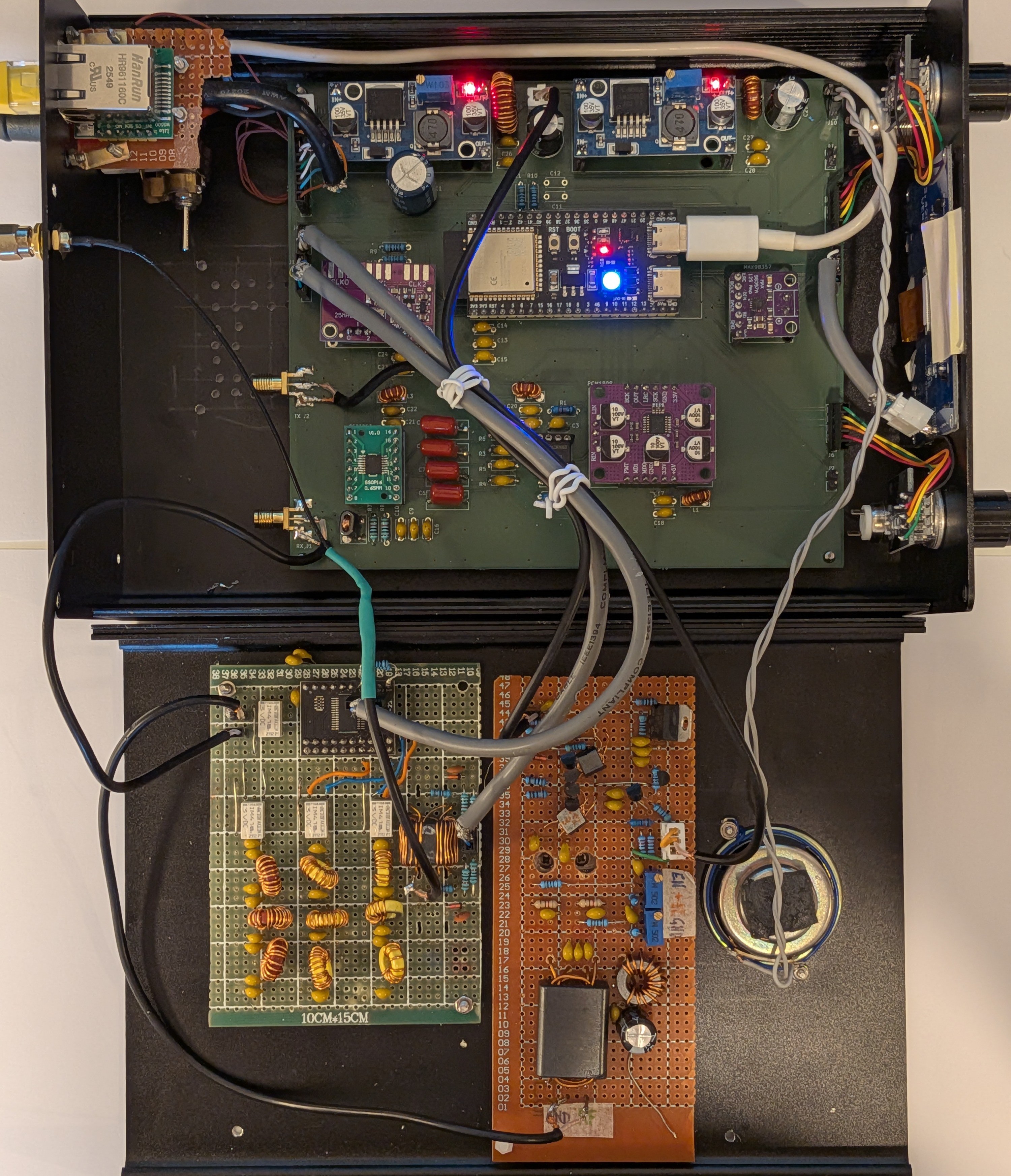

Overall Architecture
The design combines four key subsystems:
- RX: RF signal conditioning (Low pass filters and Tayloe QSD demodulator)
- TX: Power Amplifier, SWR and Power RF measurement
- digital control (ESP32 + MCP23017 filters switching + MAX98357 audio out)
- operator interface (encoders, display, buzzer)
Together these blocks form the front-end control and monitoring infrastructure of a modern QRP HF transceiver platform

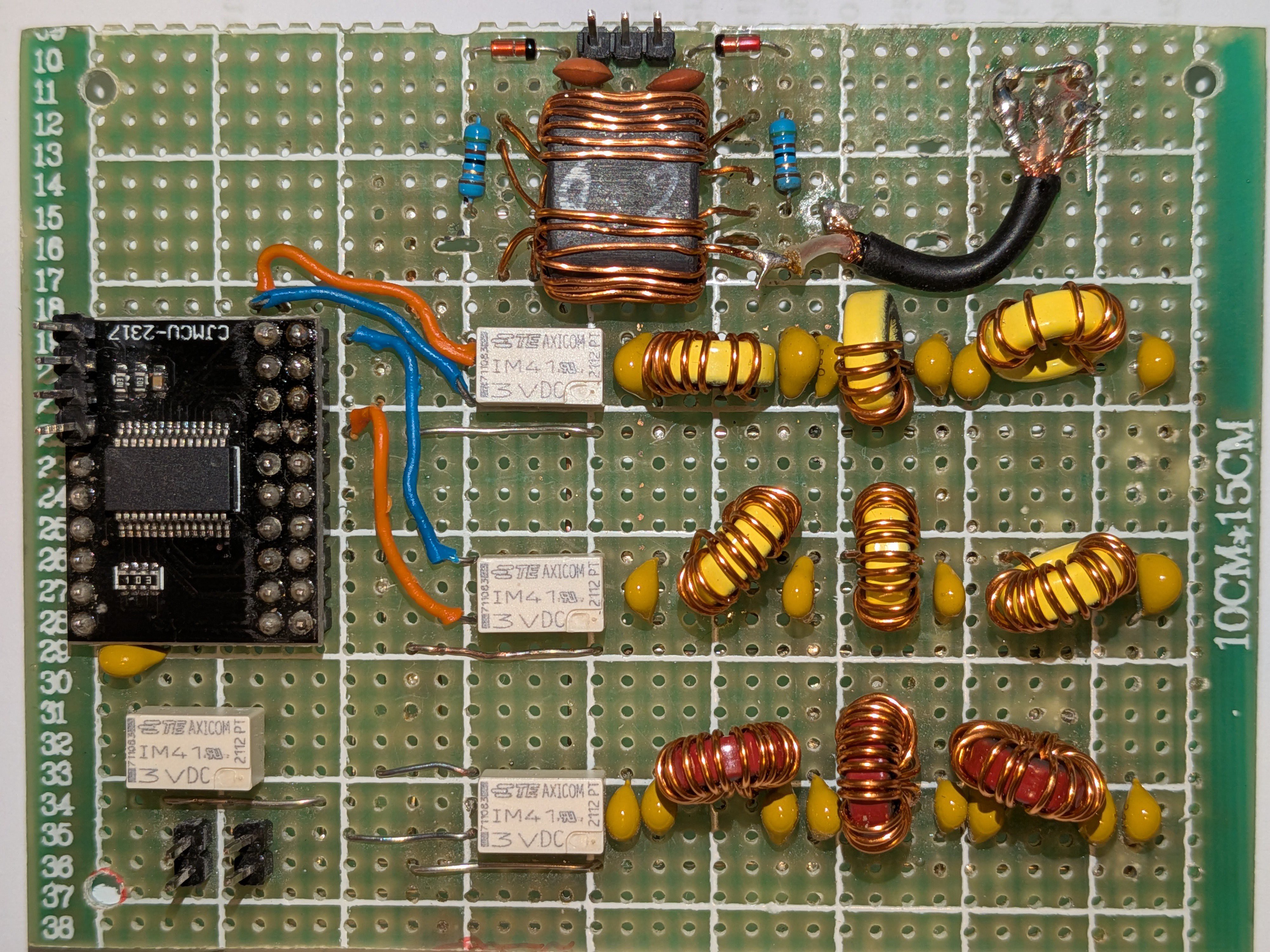

1. Power and SWR Detection Circuit

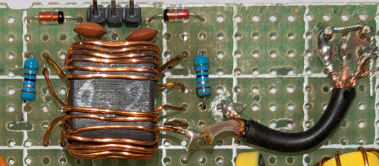

The antenna port feeds a directional coupler built around a binocular ferrite core (BN43-202).
This block samples the RF energy traveling in both directions on the transmission line.
Main functions:
- Sense forward power delivered to the antenna.
- Sense reflected power caused by impedance mismatch.
- Provide low-level RF samples for the measurement circuitry.
Two secondary windings on the binocular core couple a small fraction of the RF current from the transmission line. The resulting signals are rectified by detector diodes and converted to DC voltages proportional to the RF power.
2. Low-Pass Filter Bank
The RF signal passes through a bank of relay-selected low-pass filters (LPF) designed to suppress harmonic emissions during transmission.
The filters cover the HF spectrum using three bands:
| Filter | Ham Bands Coverage | Frequency Range |
| LPF1 | 1.8 – 3.5 MHz | 0.1 - 5 MHz |
| LPF2 | 5 – 7 – 14 MHz | 5.1 - 10 MHz |
| LPF3 | 21 – 28 MHz | 10.1 - 30 MHz |
Each filter is a 7 poles Chebishev LC network built with toroidal inductors and RF capacitors.
Functions:
- Suppress transmitter harmonics
- Maintain regulatory spectral purity
- Provide good impedance matching in the passband
Latch Relays route the RF signal through the correct filter depending on the operating frequency selected by the controller.
The relay bank is driven by an I²C GPIO expander, the MCP23017.
This device expands the number of digital outputs available to the controller and performs several tasks:
- Drives filter-selection relays
- Controls RX/TX switching relays
- Simplifies wiring by using the I²C bus
Using an expander allows the microcontroller to manage many control lines while using only two pins (SDA and SCL).

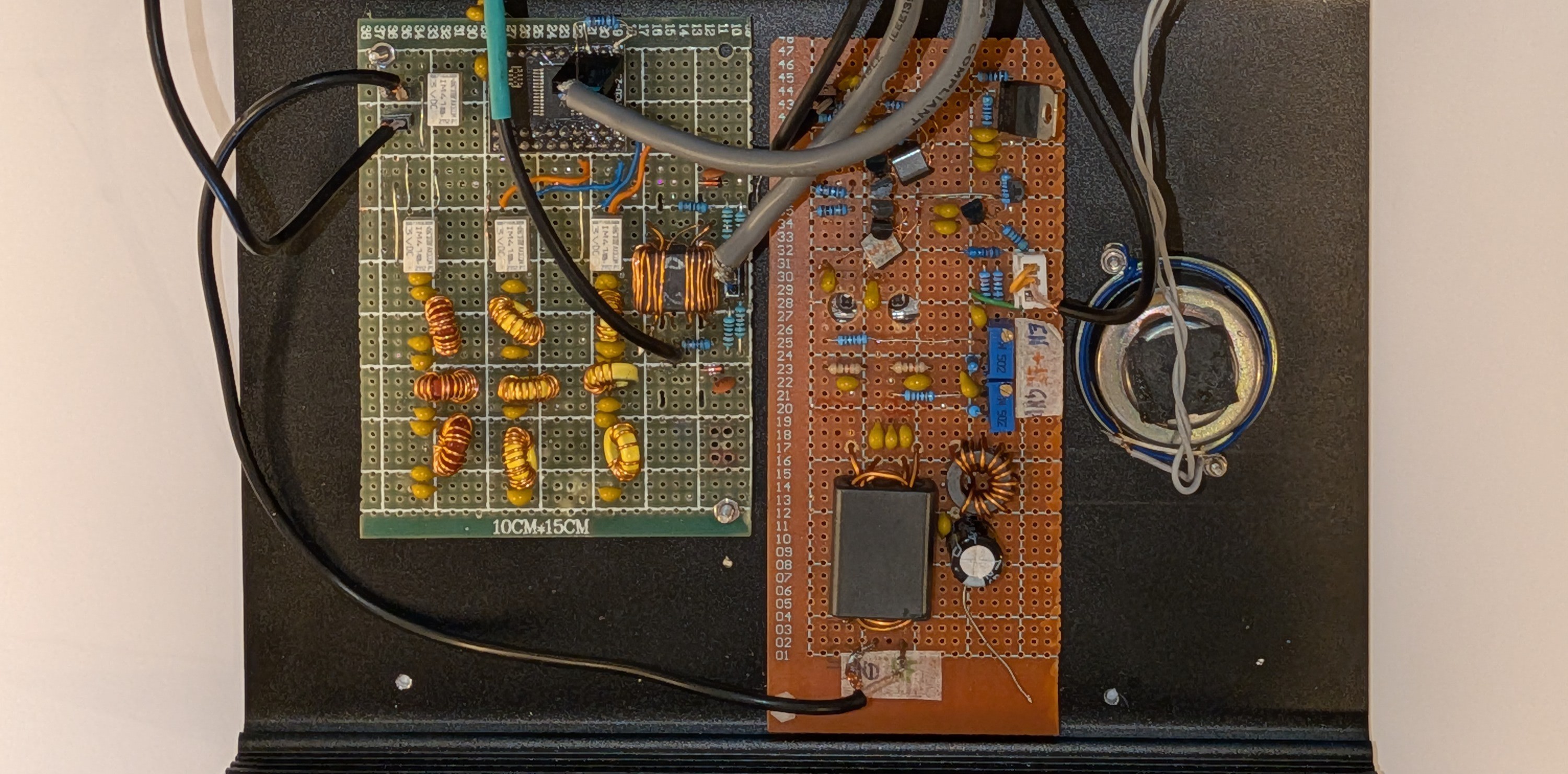

3. RF Power Amplifier Interface
The filtered RF signal connects to the RF power amplifier stage.
This block represents the connection point between the low-level RF system and the final amplifier.
Key roles:
- Deliver clean RF drive to the PA
- Route the transmit signal through the filter bank
- Return the received RF path toward the receiver
Proper impedance control (50 Ω) throughout this section is essential to minimize insertion loss and reflections.
For a complete description, please see my project: 1-30 MHz 0.5-1W (up to 10W) class C amplifier

5. User Interface
The interface allows the operator to control and monitor the system.
Main elements include:
- Frequency rotary encoder (on the right) for tuning
- Volume rotary encoder (on the left)
- Menu rotary encoder for configuration
- Push buttons for commands
- Display module for status information
This arrangement provides intuitive control similar to modern software-defined radios.
6. Power Supply System
The system is powered from an external DC source.
Multiple voltage rails are generated:
| Voltage | Purpose |
| ~ 19 V | Main input supply |
| 12.5 V | RF Power Amplifier circuit |
| 5 V | ESP32 and modules |
| 3.3 V | Quadrature Sampling Detector (FT3253) and ADC Op Amp front end (LM4562) |
Switching regulators generate the intermediate voltages efficiently, while a linear regulator produces the clean 3.3 V rail required by the Quadrature Sampling Detector (FST3253).
7. WiFi or Ethernet
I included the Ethernet option using a W5500 module. You can choose between WiFi and Ethernet (not both) when building software. See https://github.com/guido57/usdx and https://hackaday.io/project/205224/log/247713-a-new-challenge-ethernet

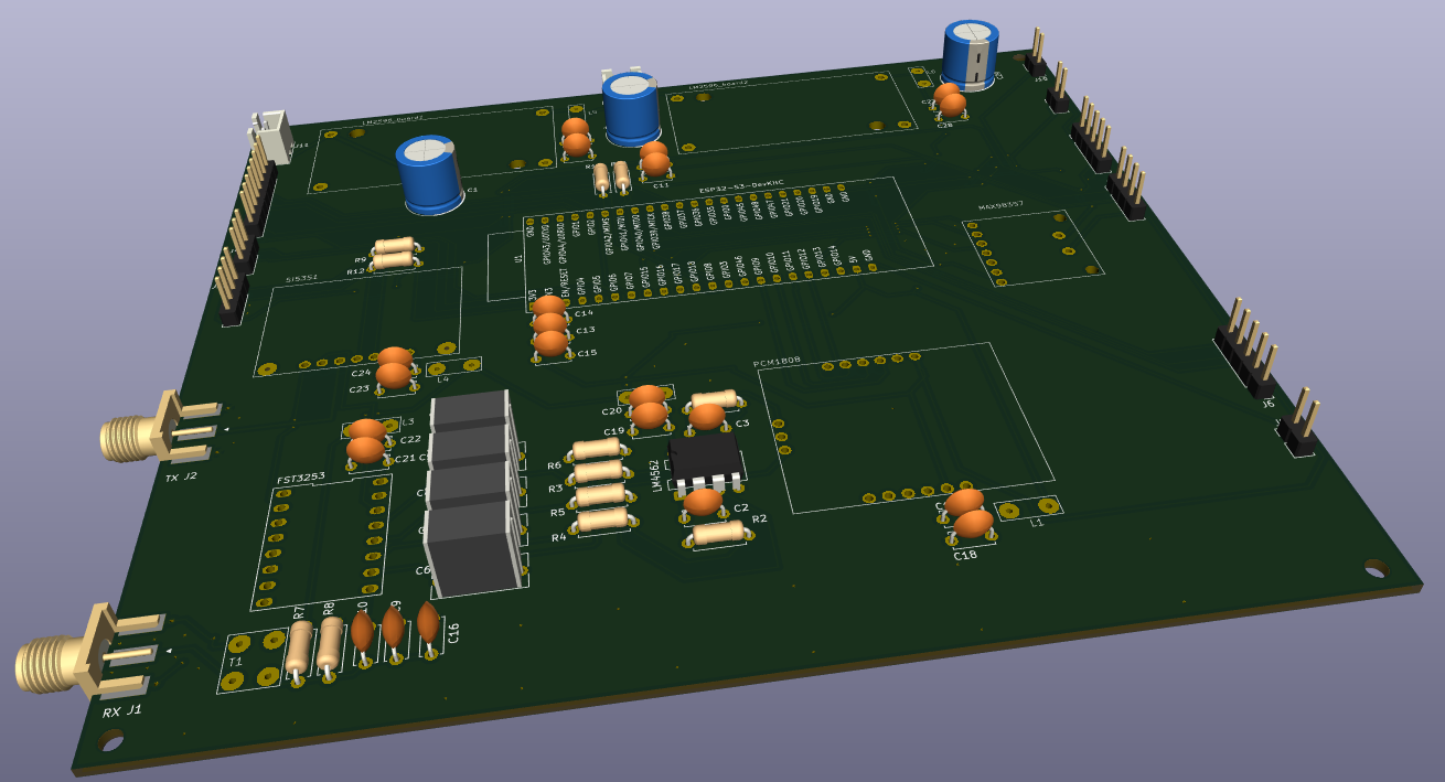

9. PCB
I designed a PCB for the receiver, microcontroller and power supply.
I completely tested it and it works fine.
You can find the KICAD project at https://github.com/guido57/usdx/tree/master/docs/usdx_kicad
At last, the hardware project is finished.

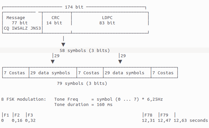

10. FT8
As a reminder, this is the FT8 message format as it is sent by radio.
