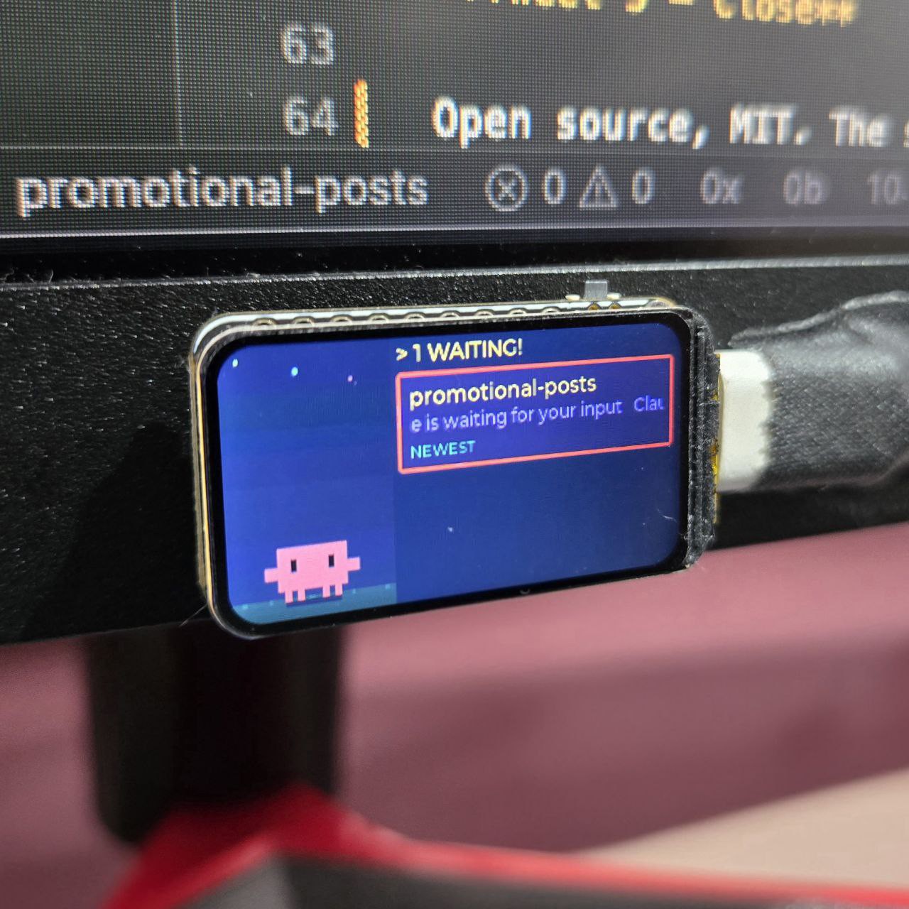

Motivation
Claude Code fires hook events at key moments: when it finishes a task, when it's waiting for your input, when it starts a long tool chain. These events are normally only visible in the terminal — you have to alt-tab to see what's going on. Clawd Tank makes those signals physical. A glance at the desk is enough to know whether Claude is idle, working, or waiting on you.

Hardware
The entire build is a single off-the-shelf board: the Waveshare ESP32-C6-LCD-1.47 (~$12). Everything needed is onboard.
SoC: ESP32-C6FH8 — RISC-V single-core at up to 160 MHz, 8 MB flash (QIO), 4 MB PSRAM (octal). No FPU, so floating-point in ISRs or timer callbacks must be kept minimal.
Display: 1.47" ST7789V, 320×172 pixels, 16-bit RGB565, SPI. The panel has a 34-pixel offset in controller address space that must be applied via esp_lcd_panel_set_gap() on y_gap (not x_gap) in landscape mode. Backlight is PWM via LEDC at 5 kHz on GPIO22. SPI runs at 12 MHz with DMA, double-buffered.
Pin assignments: MOSI=6, SCLK=7, CS=14, DC=15, RST=21, BL=22, RGB LED=8
RGB LED: Onboard WS2812B on GPIO8 via Espressif's led_strip component. On each notification, cycles through a 6-color palette with linear interpolation and fade-out, managed by a non-blocking esp_timer at 30 ms intervals.
BLE: BLE 5.0 peripheral, advertising as "Clawd Tank". PCB trace antenna handles typical desktop distances fine.

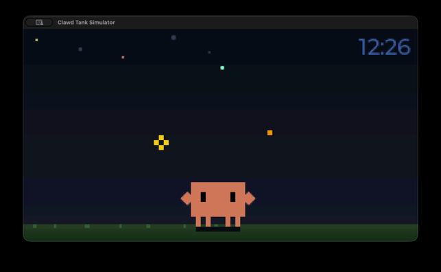

Same-code simulator
The simulator compiles scene.c, notification_ui.c, ui_manager.c, notification.c, config_store.c, and rgb_led.c directly from firmware/main/ — zero copies. ESP-IDF APIs are replaced by shim headers in simulator/shims/. SDL2 provides the display; stb_image_write handles PNG output.
Every rendering change can be tested with a 2-second CMake build before touching hardware. The simulator exposes a TCP listener (--listen, port 19872) that accepts the same JSON protocol as BLE, so the full Claude Code → daemon → simulator pipeline works without hardware.
