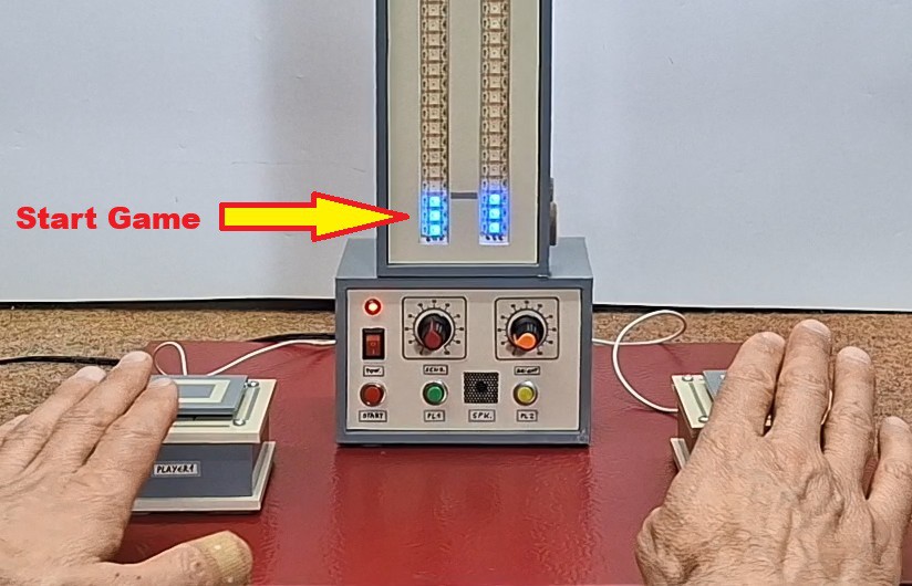

First, let me describe the method and rules of the game. At the beginning, when starting both strips, a simple animation appears accompanied by appropriate sounds. The left bar and button represent player 1, and the right side represents player 2. By pressing the Start button, the first three LEDs on both strips begin to alternately light up with green and blue, which is a sign that the game has started.

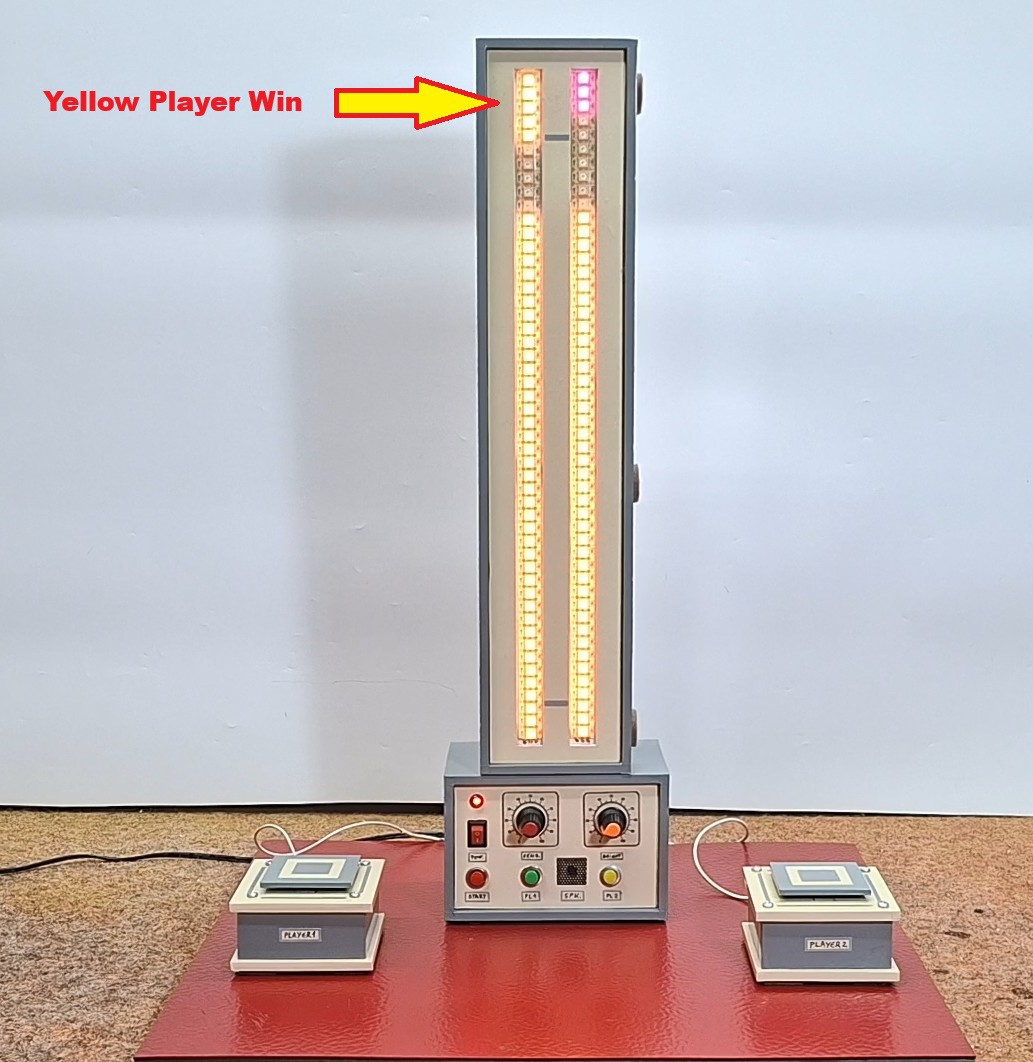

After this, from the third to the eighth second, at some point all the LEDs will light up with red. This is the moment when the players should press the button. The first to press the button is the winner of the individual game. If any of the players presses the button before the red LEDs appear, they automatically lose the game. The next game begins by pressing the start button again. A complete game ends when one player is the first to win five individual games. The result is displayed by the top five LEDs with the appropriate color, player 1 yellow, and player 2 magenta. The winner of the complete game is indicated by flashing all the LEDs with the winning color and the corresponding winning sound sequence.

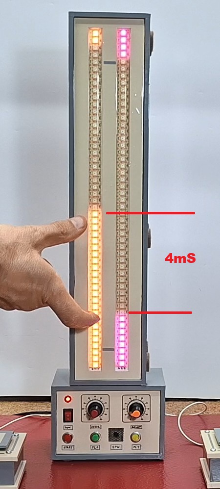

Since the game is based on reaction speed, it is desirable that the reaction time can also be displayed somehow on the strips. For this purpose, I used the Select potentiometer. In the extreme left position, the active scale (45 LEDs) represents a time of 10 milliseconds (4 LEDs approximately indicate 1 millisecond), and in the extreme right position, the scale displays a time of 1 second (one LED indicates 22 milliseconds). At the end of any individual game, we can "Zoom" the time. So we can very precisely determine the reaction time of the two players (theoretically with an accuracy of 0.25mS !!!). This will become clearer to you during the specific demonstration game that you will watch below.
We set the left potentiometer approximately in the middle, where the entire scale represents a time of half a second. The right potentiometer changes the intensity of the LEDs from 0 to maximum.
