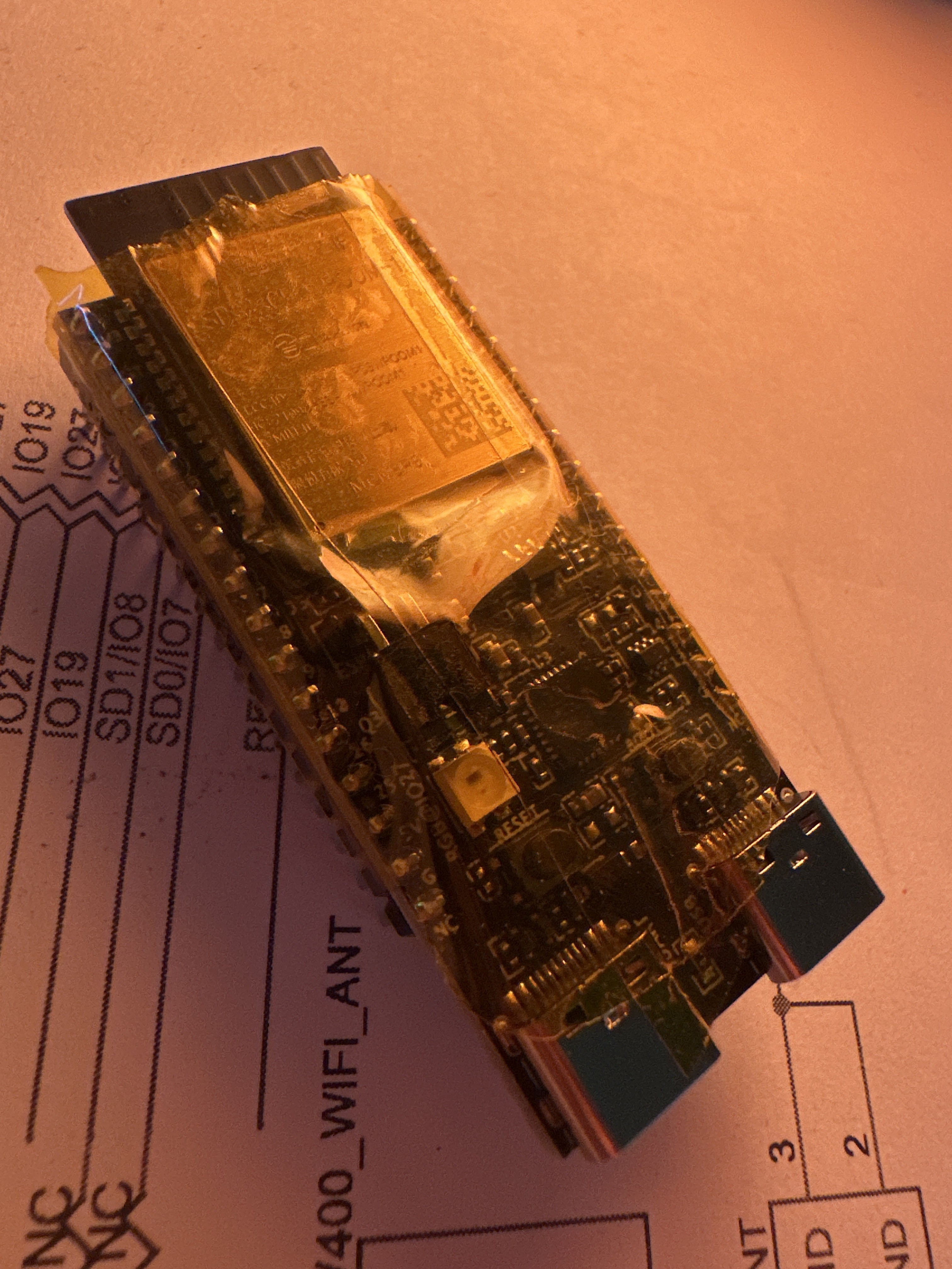

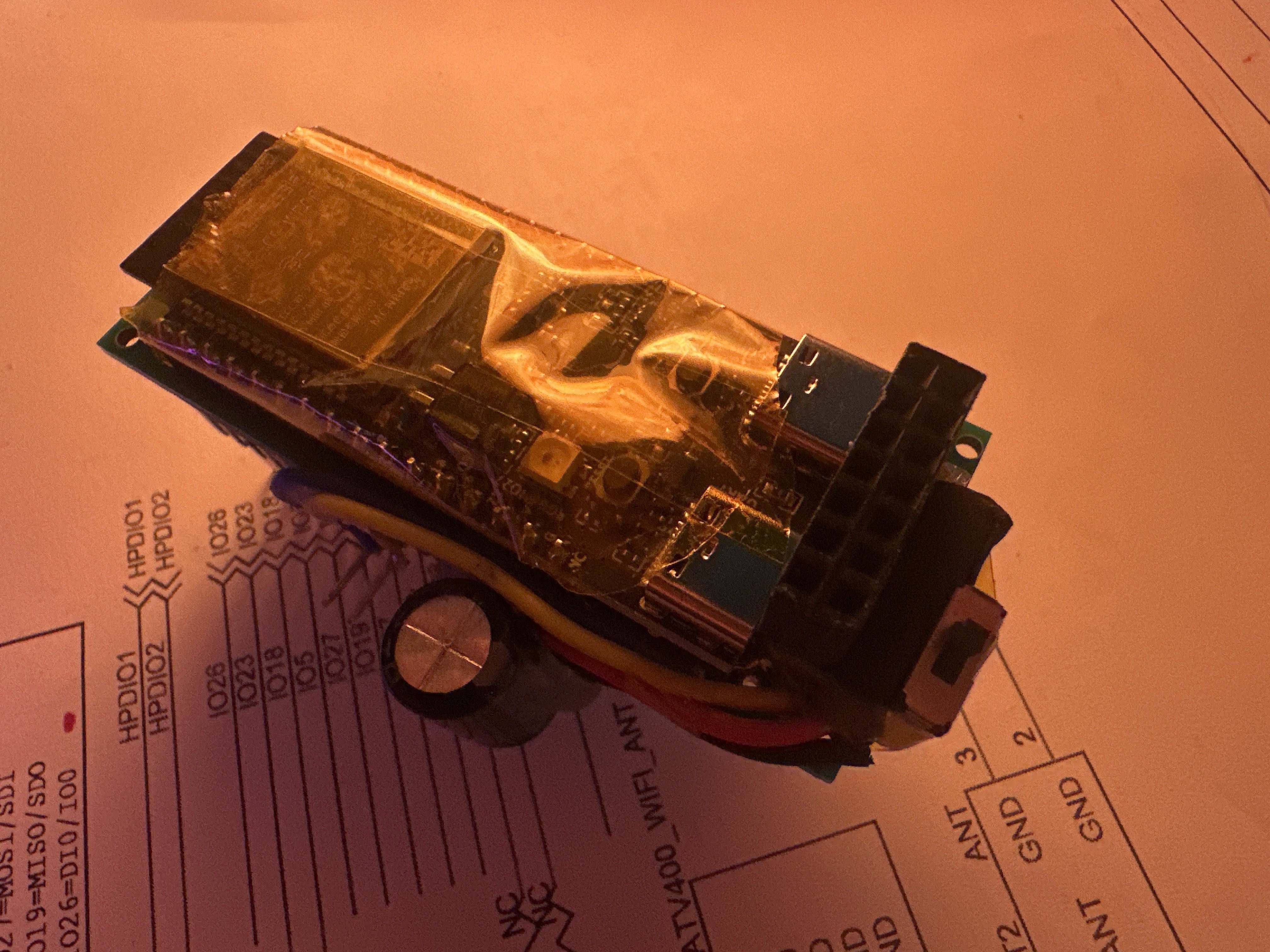

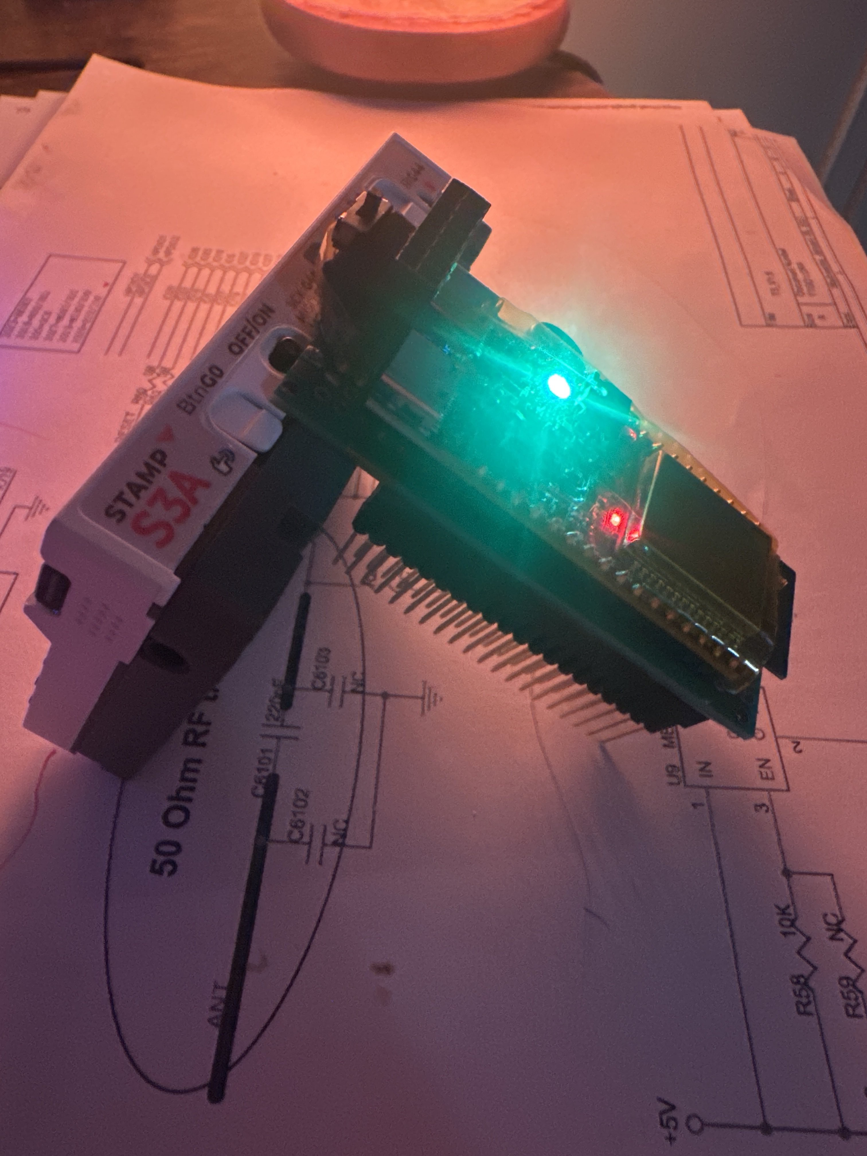

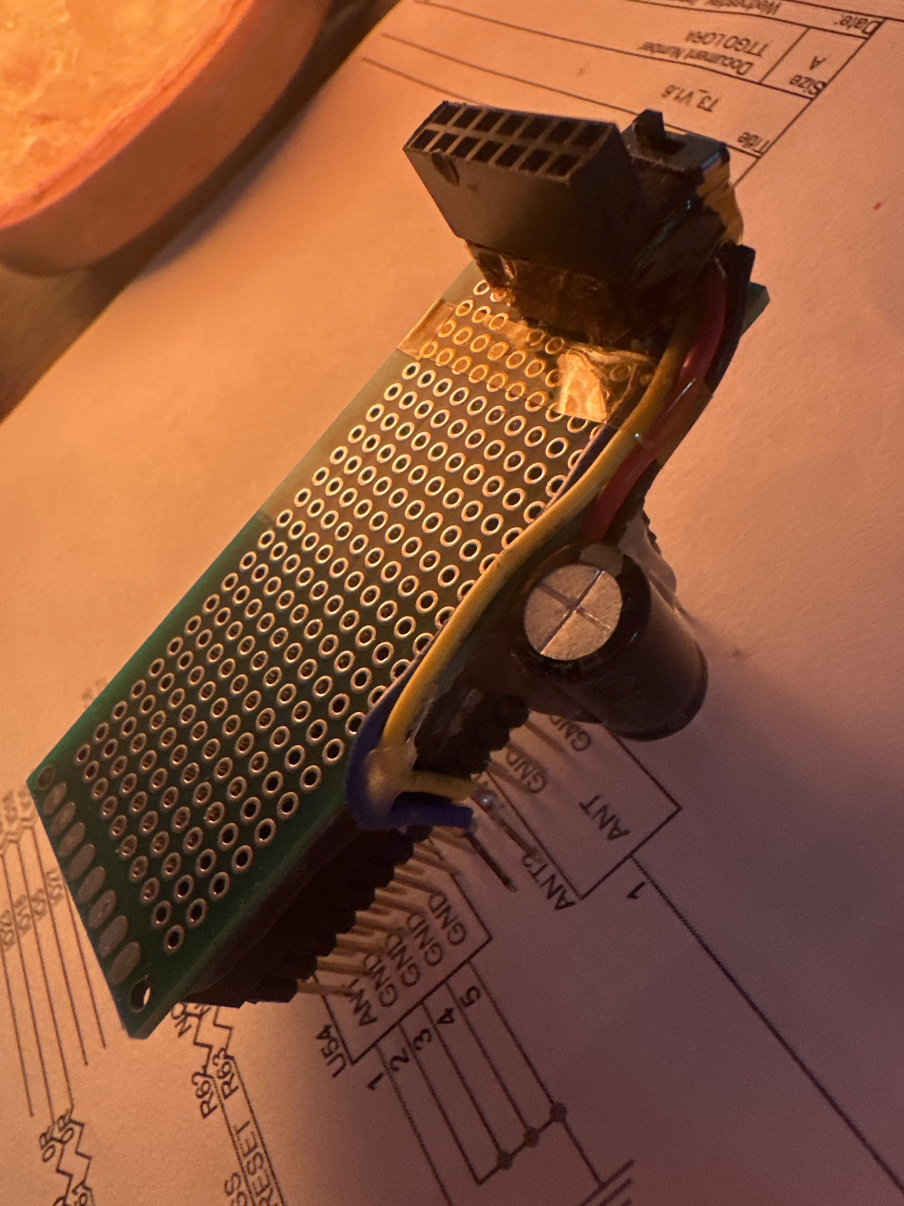

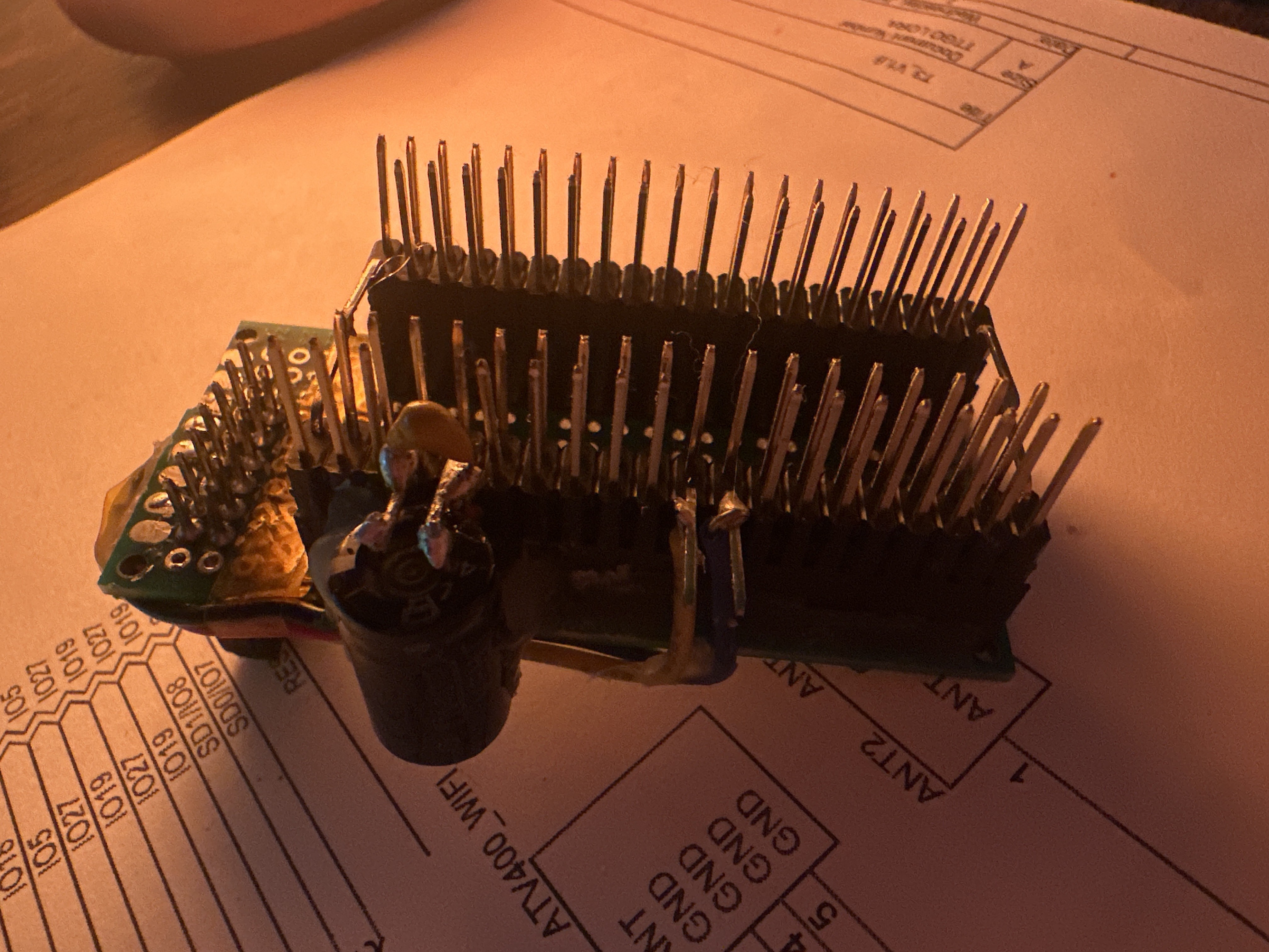

ESP32-C5 Hat/Cap Project for M5 Cardputer running Evil Cardputer.
  • 1 × Espressif ESP32-C5-wroom-1 NOt the Waveshare!!!! (Amazon)
  • 3 × 40 Pin GPIO Header Amazon
  • 1 × 104 Ceramic capacitor
  • 1 × switch Development Kits, Boards and Systems / Development Kits and Boards
  • 1 × 2200 uf Electrolytic capacitor 10vdc
View all 6 components
View all 5 project logs
  • 1
    Pin out
    ESP32-C5 Male Pin 6 --> Top Female Header pin G15 on Cardputer ADV
    ESP32-C5 Male Pin 7 --> Top Female Header pin G13 on Cardputer ADV
    ESP32-C5 Male Pin 5v --> Top Female Header pin 5v out on Cardputer ADV
    ESP32-C5 Male Pin G --> Top Female Header pin Gnd on Cardputer ADV
