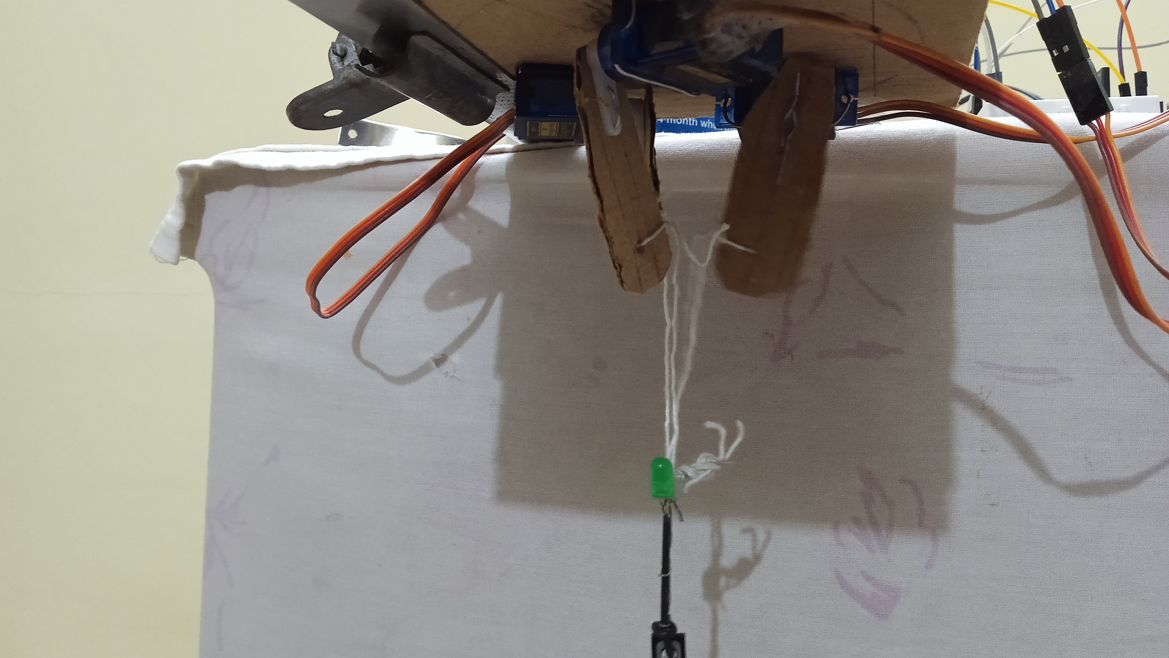

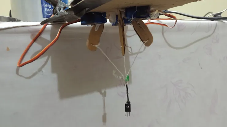

The goal of this project was to design a robot that can move in three dimensions while keeping the mechanical structure simple and lightweight. So this robot with design satisfies all these requirements.

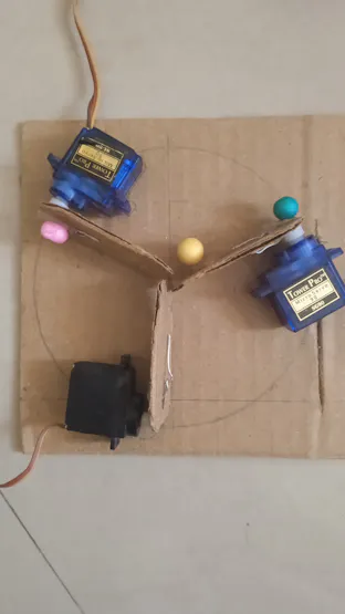

Servo Motor Arrangement For Delta RobotUsing three servo motors arranged at 120°, solid links, and cables connected to the end effector, this robot can reach multiple points inside its workspace.

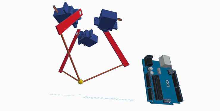

Computer Aided Design (CAD)
CAD of Hybrid Delta Pick And Place Robot
I first designed the robot in CAD, then built the real-world setup following the design. The robot is controlled using an Arduino Uno, and the motion is determined through inverse kinematics calculations.

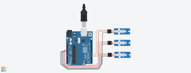

Circuit Schematic
Circuit Diagram of Hybrid Delta Pick And Place RobotThis is the circuit schematic, here we have three servo motors. These motors are connected to the Arduino Uno prototyping board.

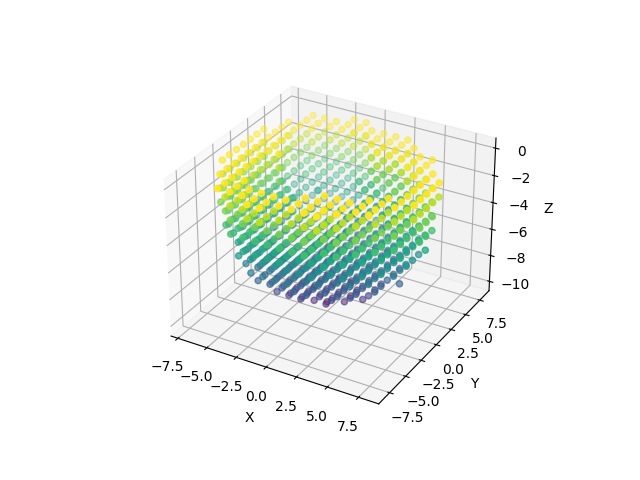

Workspace Of The Robot
To better understand its behavior, I also created a Python-based simulation to calculate and visualize the workspace of the robot. The simulation predicted a bowl-shaped workspace due to servo limitations, and when tested in the real world, the robot successfully reached those same positions.

However, this robot is called a Hybrid Delta Robot because one of its links is replaced by cables instead of rigid parallel links. This introduces an interesting limitation: the system relies on gravity to keep the cables under tension. Because of this, the robot would not function properly in zero-gravity environments, such as on the International Space Station. In space, the cables would go slack, and the robot would lose precise control of its end effector.
I also tested the extreme points of the robot’s workspace, validate the simulation results.
