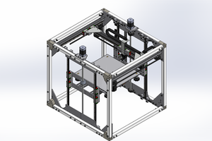

Next try at the design and got much further into it. Better frame design, actually got to the kinematics which are McMaster-Carr brass gear racks with servocity (SC) linear rails. Kept the 'hidden' z rails but tried to use a T8x8 z screw for this gantry. Note: T1-T3 are all a 4' x 3' x 3' frame.
