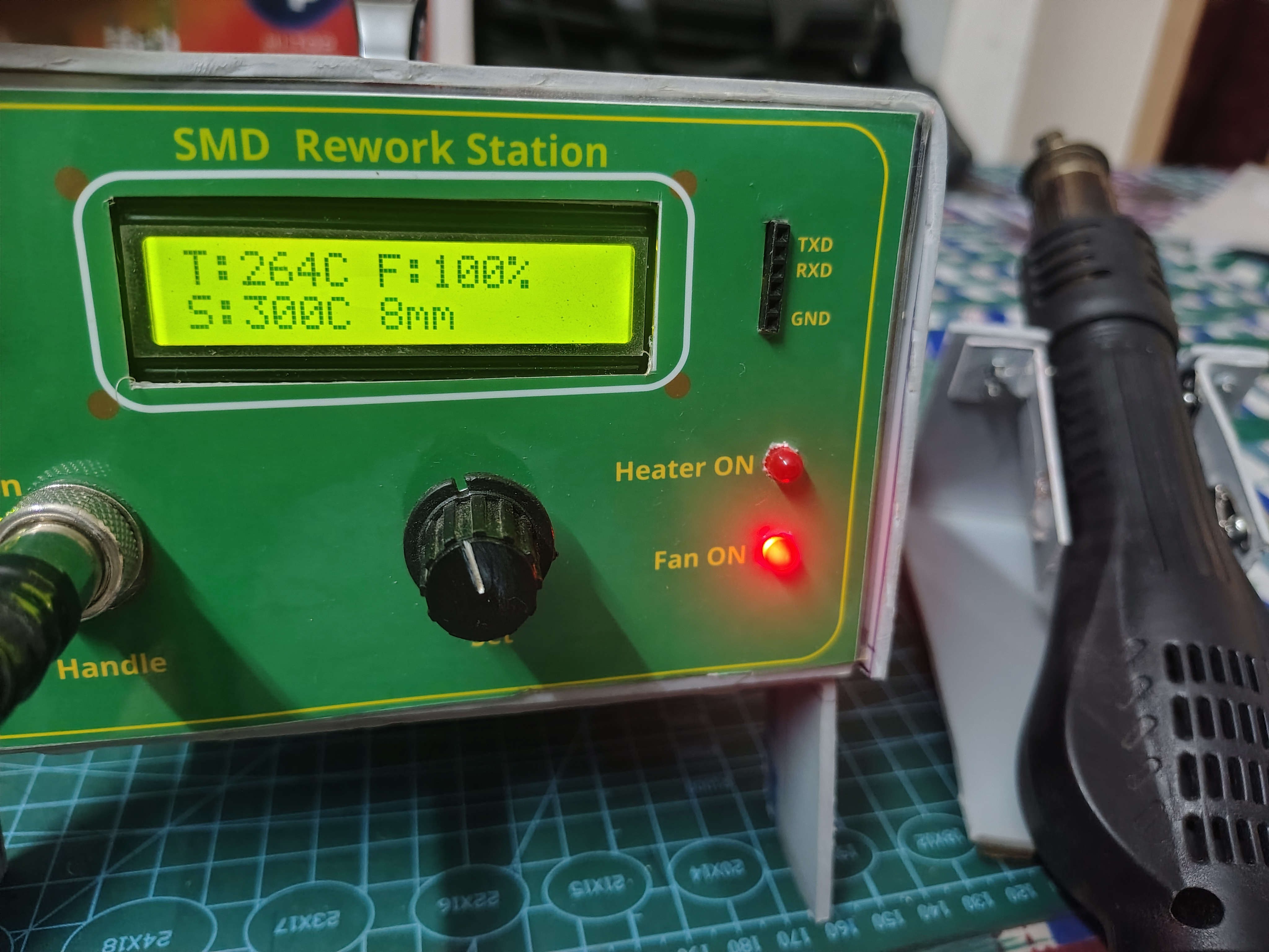

Overview
This project presents a fully functional SMD rework station built from scratch using an ESP32 microcontroller running MicroPython.
This system was developed as a complete engineering solution — covering circuit design, PCB fabrication, firmware architecture, enclosure design, and system validation — all performed in-house, while maintaining a higher level of engineering rigor than conventional hobby builds.
The design emphasizes reliability, safety, and flexibility, with particular focus on power integrity, modular hardware design, and maintainable firmware architecture.

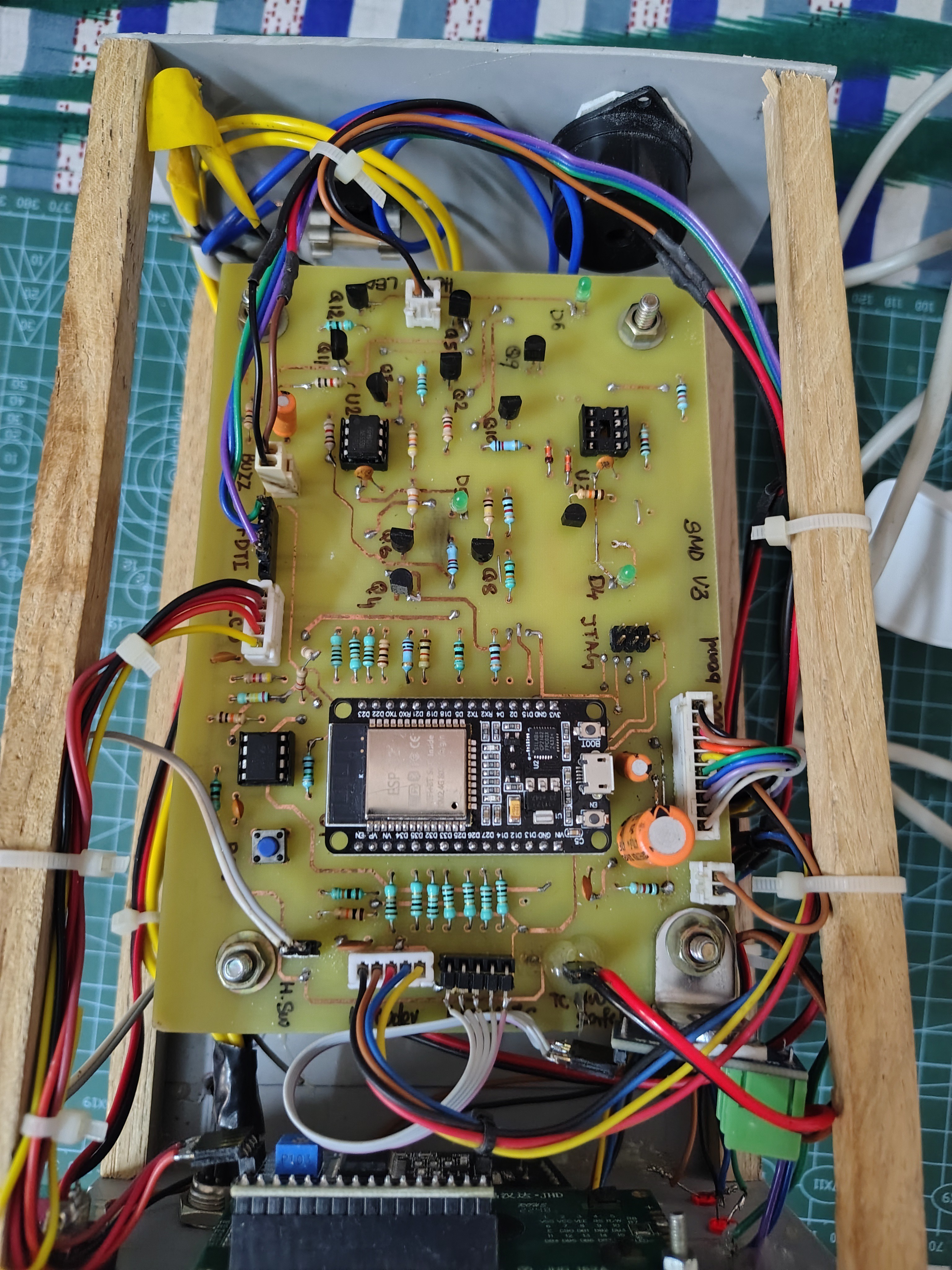

🧩 Hardware Architecture
The system is built using two dedicated PCBs:

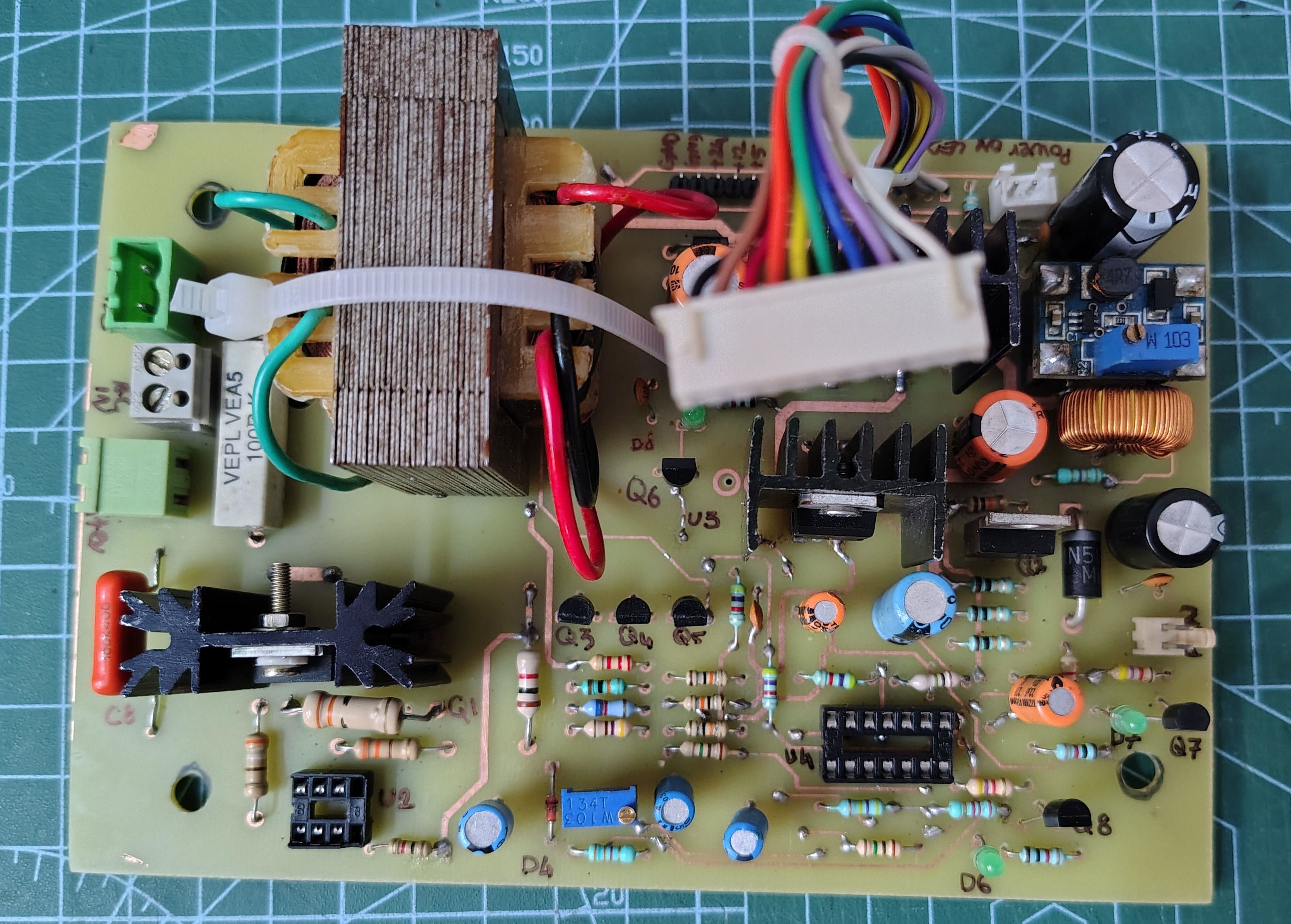

🔌 Power Board
  • Controls 230V heater (~550W) using TRIAC (BT139)
  • Opto-isolated driver using MOC3041
  • Fan control via MOSFET(PWM)
  • Generates regulated 12V and 24V rails
  • Designed for high-current handling and isolation
👉 The MOC3041 is socket-mounted, enabling:
  •        Easy replacement
  •        Safe experimentation during initial bring-up
  •         Faster troubleshooting

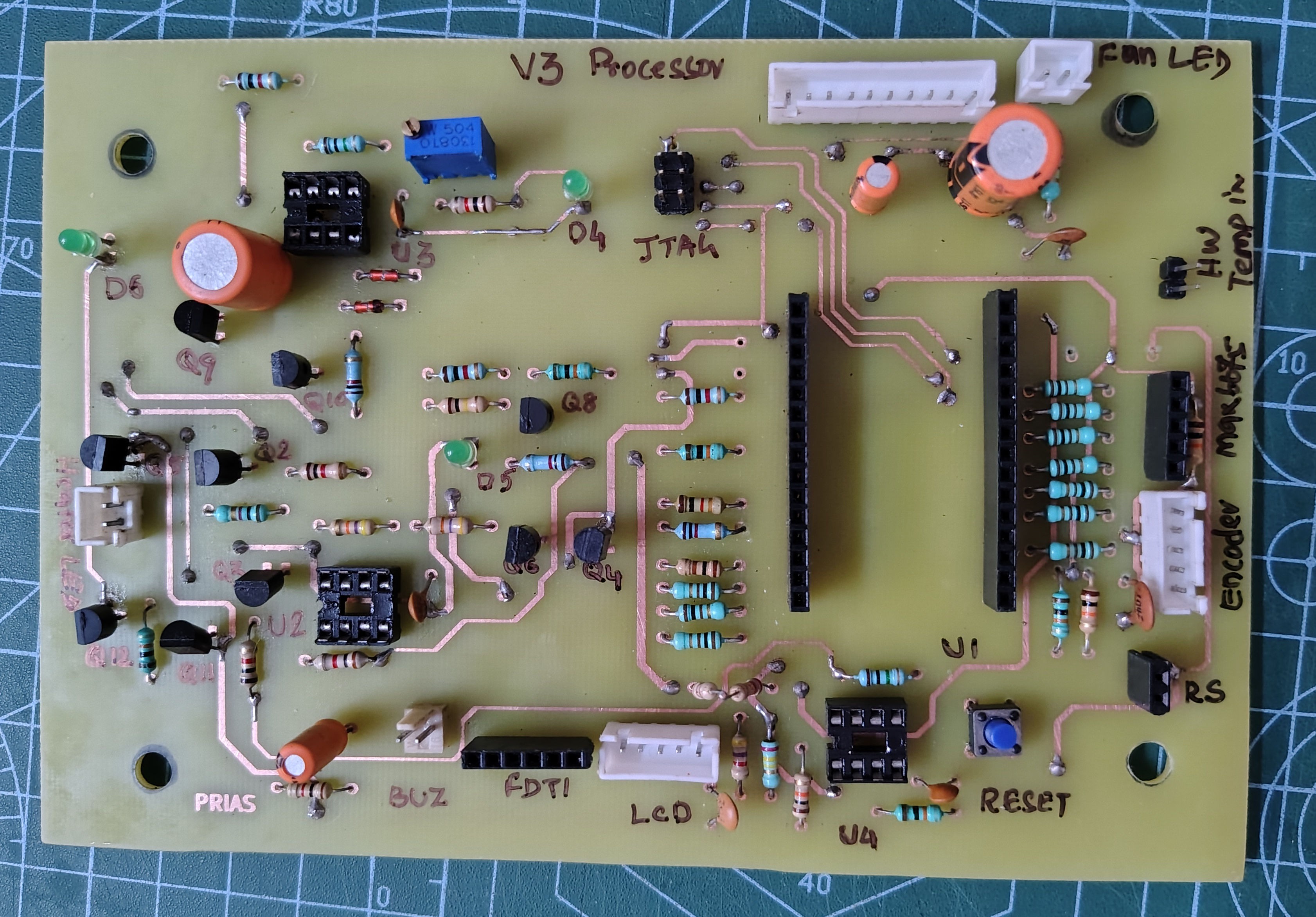

🧠 Processor Board
  • ESP32 DevKit controller
  • MAX6675 K type thermocouple interface
  • Rotary encoder input
  • 16×2 I2C LCD display
  • Control signal for heater and fan

🌡️ Control & Operation
  • PID-based temperature regulation
  • Real-time thermocouple feedback (MAX6675)
  • 24V fan with PWM control
  • Rotary encoder-driven user interface

🔌 Power Design & Debugging
During development, system instability was observed due to:
  • Insufficient bulk capacitance
  • Voltage regulator dropout (7812 under load)
Fix implemented:
  • Increasing reservoir capacitance from 1000 µF to 5000 µF
  • Improving power stability under dynamic load
 This significantly improved system reliability.
🔧 Troubleshooting Features
To aid debugging and maintenance:
  • Dedicated status LEDs for:
  •       Power rails
  •       System states
  •       Fault conditions

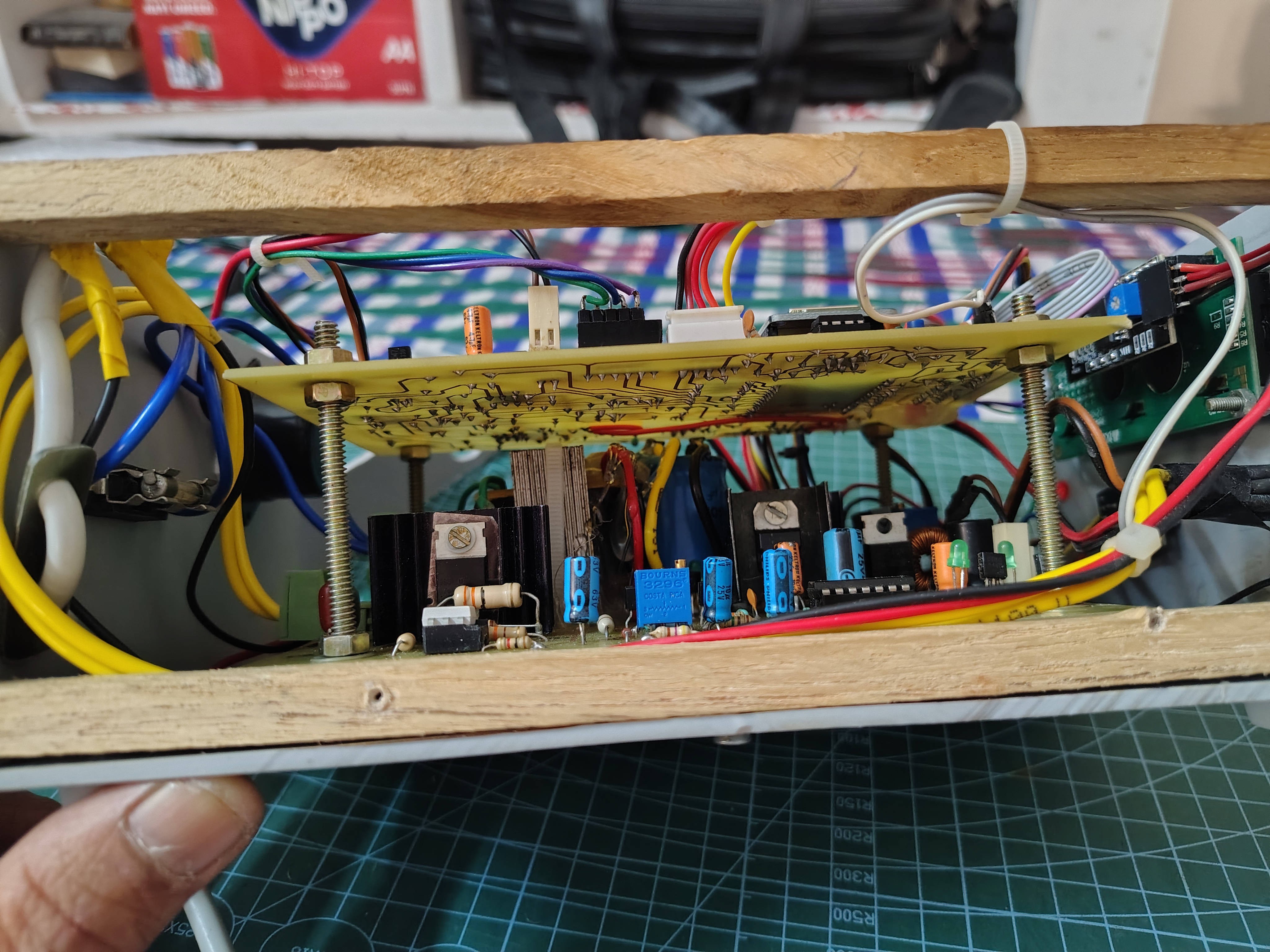

  • Modular PCB design allows:
  •       Independent subsystem testing
  •       Easier fault isolation

  • Relocating the 24V DC Booster – Improving Power Stability and System Isolation
    Srinivasan M S03/20/2026 at 10:39 0 comments
    During the early stages of development, the 24V DC boost converter used for driving the blower fan was initially placed on the processor board.
    While this simplified wiring during prototyping, it introduced several unintended issues during operation.
    The boost converter, being a switching power supply, generated noticeable electrical noise and transient disturbances. Since it was located on the same board as the ESP32 and control circuitry, these disturbances began to affect system stability.
    Symptoms included occasional erratic behavior in control signals and increased susceptibility to noise, especially during fan startup and rapid load changes.
    Further analysis indicated that combining sensitive control electronics and high-current switching circuitry on the same PCB was not ideal for this application.
    To address this, the 24V booster was relocated to the power board.
    This change provided several advantages:
    • Improved physical separation between noisy power circuitry and sensitive control electronics • Reduced noise coupling into the ESP32 and sensor interfaces • Better grounding and current return paths • Simplified routing of high-current traces
    After relocating the booster:
    • System behavior became more stable
    • Noise-related issues were significantly reduced
    • Overall reliability improved
    This modification highlighted the importance of proper partitioning between power and control domains, especially in mixed-signal embedded systems.
    Separating high-frequency switching circuits from low-level control electronics can greatly improve system robustness.
    Would be interested to know how others handle power and control separation in similar mixed-signal designs.

  • Power Supply Debugging – Resolving 7812 Dropout and System Instability
    Srinivasan M S03/18/2026 at 08:37 0 comments
    During the initial testing phase, the system exhibited unstable behavior, particularly when the fan and control electronics were operating simultaneously.
    The 12V rail, derived using a linear regulator (7812), showed noticeable voltage drop under load. This resulted in erratic system operation, including unreliable fan startup and inconsistent control behavior.
    At first, the issue was suspected to be related to firmware timing or PWM interaction. However, further measurements revealed that the root cause was insufficient bulk capacitance on the rectified DC supply.
    The original design used a 1000 µF reservoir capacitor, which proved inadequate for handling transient load demands from the fan and control circuitry. Under load, the input voltage to the 7812 regulator dropped below its required dropout margin, causing the regulated 12V rail to sag to approximately 10.6V.
    To resolve this, the reservoir capacitance was increased from 1000 µF to 5000 µF. This significantly improved voltage stability by reducing ripple and maintaining sufficient headroom for the regulator during peak load conditions.
    After this modification:
    • The fan started reliably across the full PWM range
    • The control system became stable
    • Temperature regulation operated consistently
    This debugging process highlighted the importance of proper power supply design, especially in systems combining high-power loads with sensitive control electronics.
    Ensuring adequate bulk capacitance and understanding regulator limitations are critical for stable operation.
