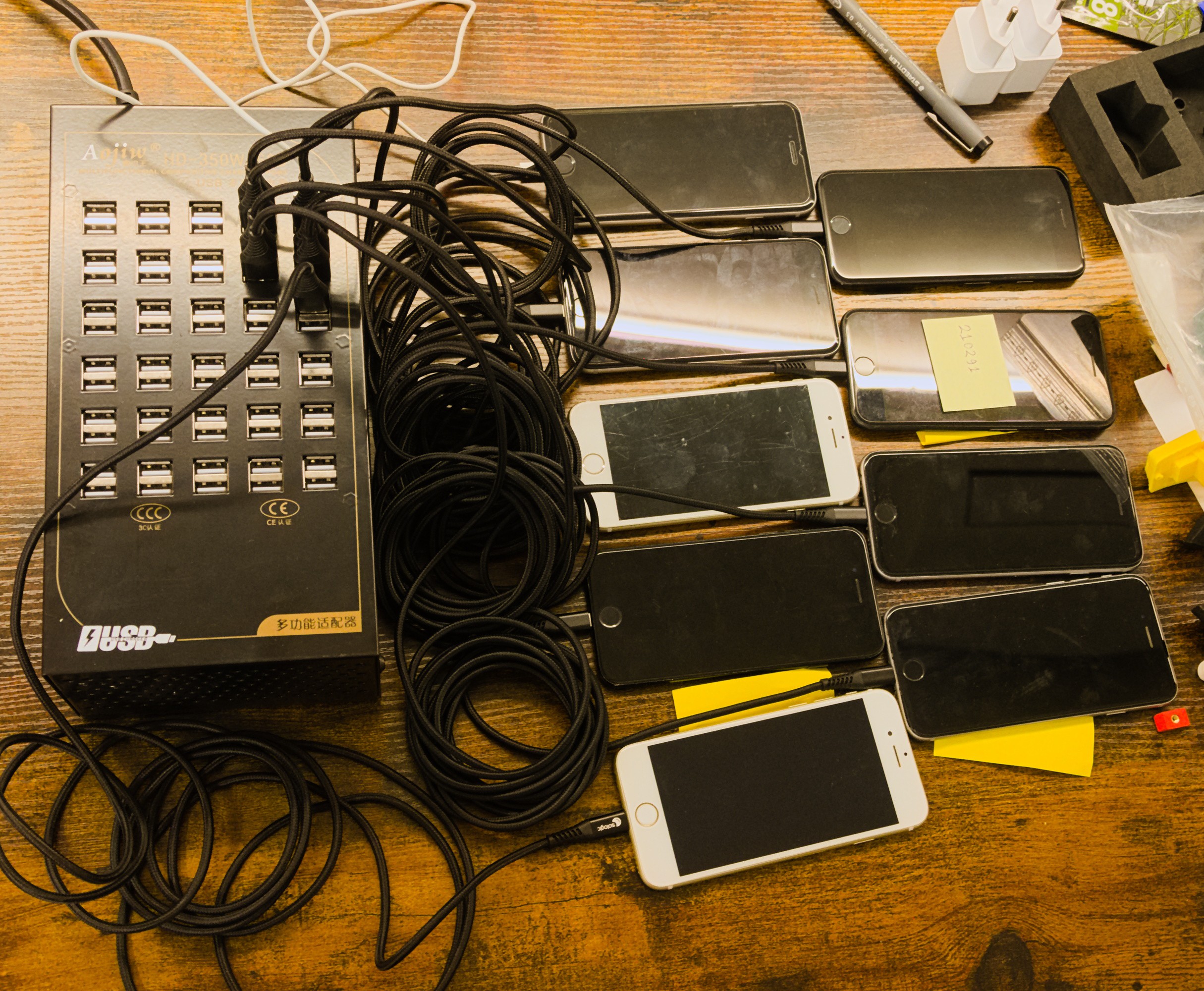

    So, yesterday I completed the binning process:
    • 9 Phones with 90% battery health or better
    • 17 between 80% and 89%
    • 7 between 70% and 79%
    • 1 under 70%
    • 6 (partially) non-functioning
    • 4 device-locked
    One phone that was initially locked (“iPhone unavailable”) I managed to become usable again by re-flashing in DFU-Mode. Unfortunately the device-locked phones are all comparatively new ones. Maybe I will be able to restore them when considering notes at work.
    So only using the 90+ and 80+ phones I will be able to complete the vest – I thought.
    Turns out – as suspected – the battery health indicator isn’t the best. I fully charged the 90+  and left them turned on (but not charging) overnight. One of the phones was under 30% next day, two at about 75, the rest within reasonable range. At least two of the phones have 3rd party batteries, so I hope it’s only a calibration issue. But I doubt it to be honest. So I will have to use some of the 70+ phones or manage to unlock some. I am pretty confident I can unlock at least one, because the person who’s used it in the past is still working for the company.

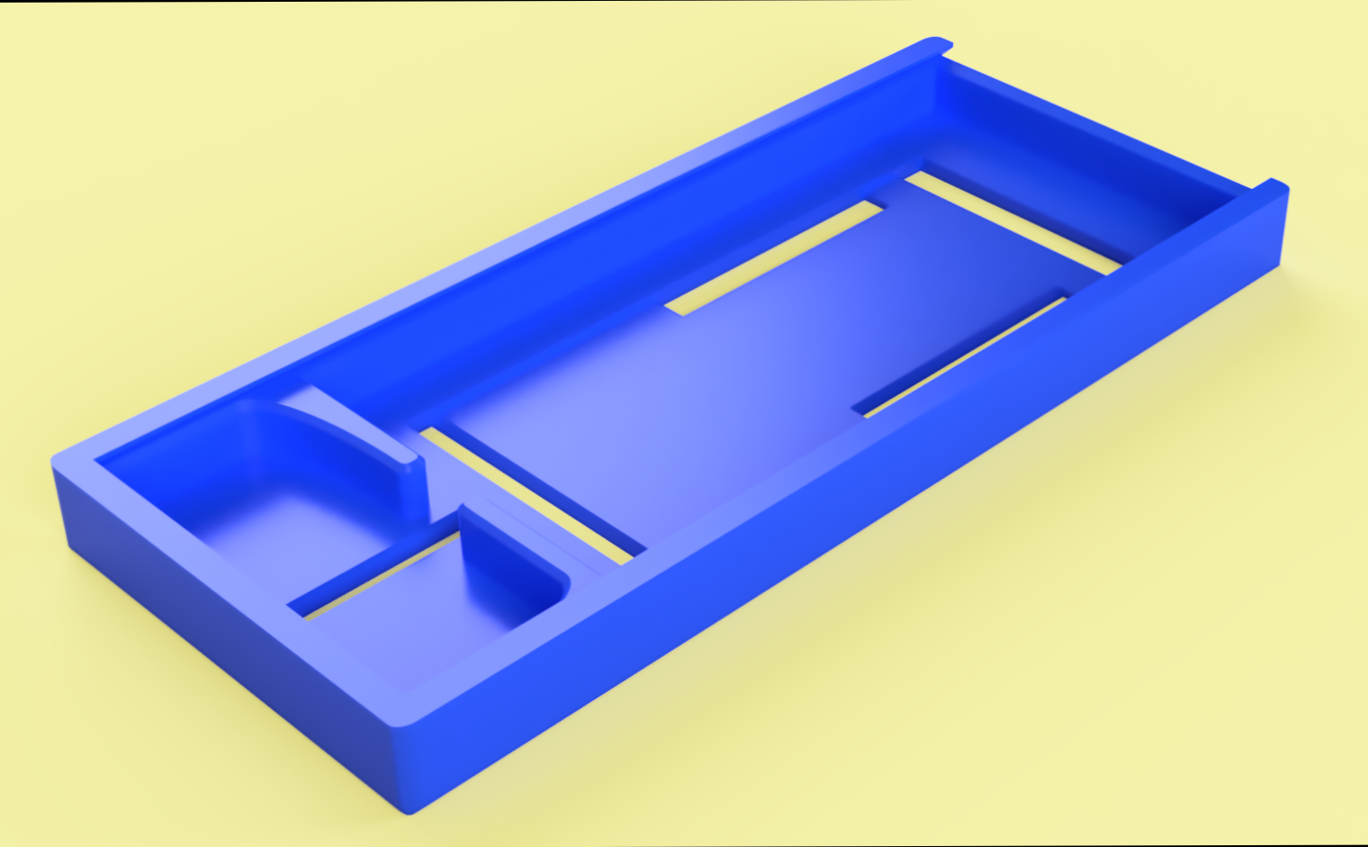

    The mount
    So while the next 10 phones get their charge (I haven’t bought all 24 cables yet, because I want to make sure that they are suitable first) I designed the first iteration of a “phone-tile”
    I want to keep the bottom part universally usable for every model (except for the large ones like iPhone 8 plus). So I took measurement of the widest, tallest and thickest models and constructed a bottom-case. The phone will be placed in the upper compartment using an adapter plate-insert to compensate for the differences in dimensions. The bottom compartment is for the charging plug and some cable to keep it neat and tidy. The slots in the upper compartment (underneath the phone) are for either horizontally or vertically mounting the whole thing on a strap. Finally, I will construct an upper-plate that will slide in from the top to cover everything except the screen.
    I can already see, what needs to be changed for the second design iteration: the slot at the bottom is most likely to narrow for the charging plug (which is a bit thicker than the cable), so I have to adjust for that.

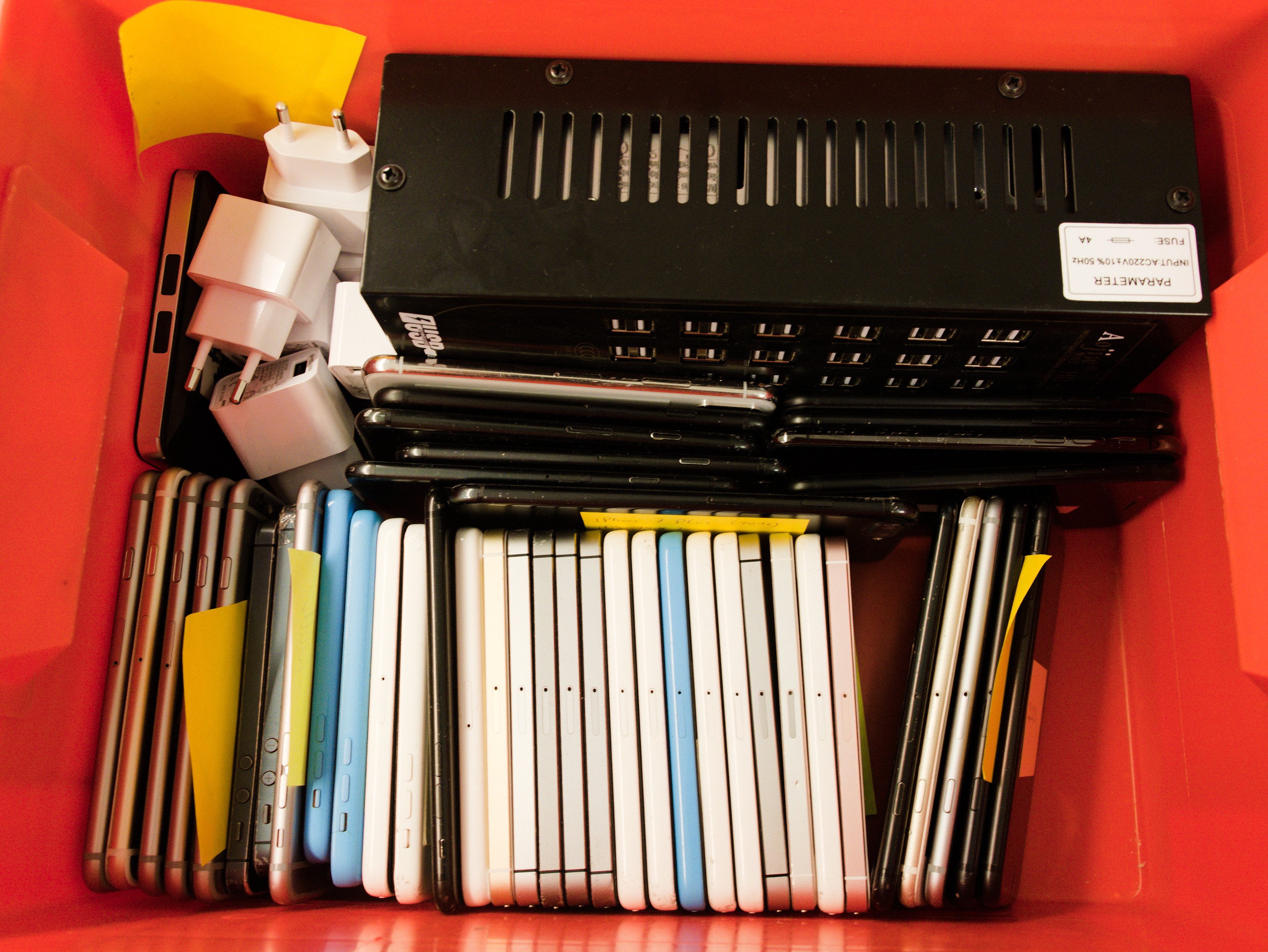

    Ok, so I went to the office and got the phones. Quite an impressive amount, actually. I also found some Android and Microsoft OS phones, but didn't take them with me as they were all mixed makes and models. I also left two old iPads behind, as they are not needed for the current project, but might be a nice addition later on.
    Right now I am in the process of binning (quite literally, actually) the phones by battery health percentage. I don't know how accurate it is, but that's the easiest one as a first indicator.
    Most of the phones haven't even been reset, but luckily enough nearly all of them still have the default-lock code that has been configured, when the devices were handed out years ago. Right now I am at about 50% of the binning process with 3 device-locked phones I am unable to unlock for the time being, and even one phone with 100% battery health. This phone has been on the charger most of the time, so no wonder it's still perfect.
    I am quite confident, that I will get 24 iPhones with at least 80% battery health; models as old as iPhone 4 (2010) all the way up to iPhone 8 and XS (2018).
    One of the phones that didn't have the default lock-code had a note stuck to it with the correct one written on it - which was quite nice.
    oh, and you can pull out a lot of dust cleaning these old charging-ports
