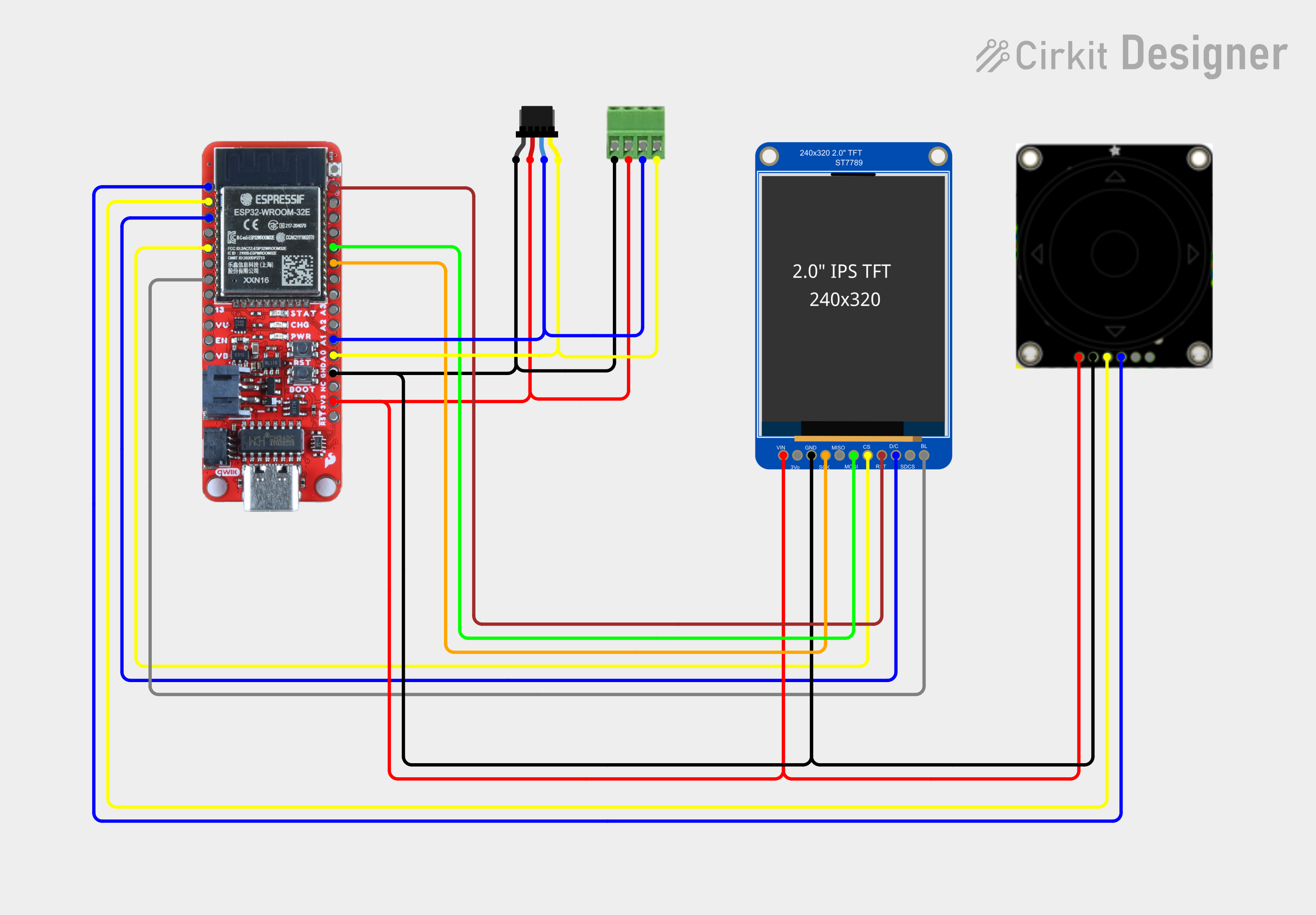

The goal of this project is to develop a tool that will be used to help diagnose issues with I2C buses. There are already a number of I2C scanners available, there is even one of the Arduino sample applications, so why invent another? This version is a stand-alone tool that does not require any external equipment. It uses a few simple components:
  • Sparkfun ESP32 Thing Plus C – processing unit with enough I/O pins to support SPI for the display, an I2C bus to support a rotary encoder for UI control, and a second I2C port for scanning.
  • Waveshare 2 Inch 320x240 color display – Display unit for scan control.
  • Adafruit ANO Rotary Encoder – Input device for UI.
This tool is just the beginning or a larger project which will include several projects to implement accessory control for model trains.
This tool uses Arduino with the Adafruit graphics library, Adafruit ST7789 driver, and the Adafruit seesaw library for UI input controls. Google Material icons are used for various indicators.

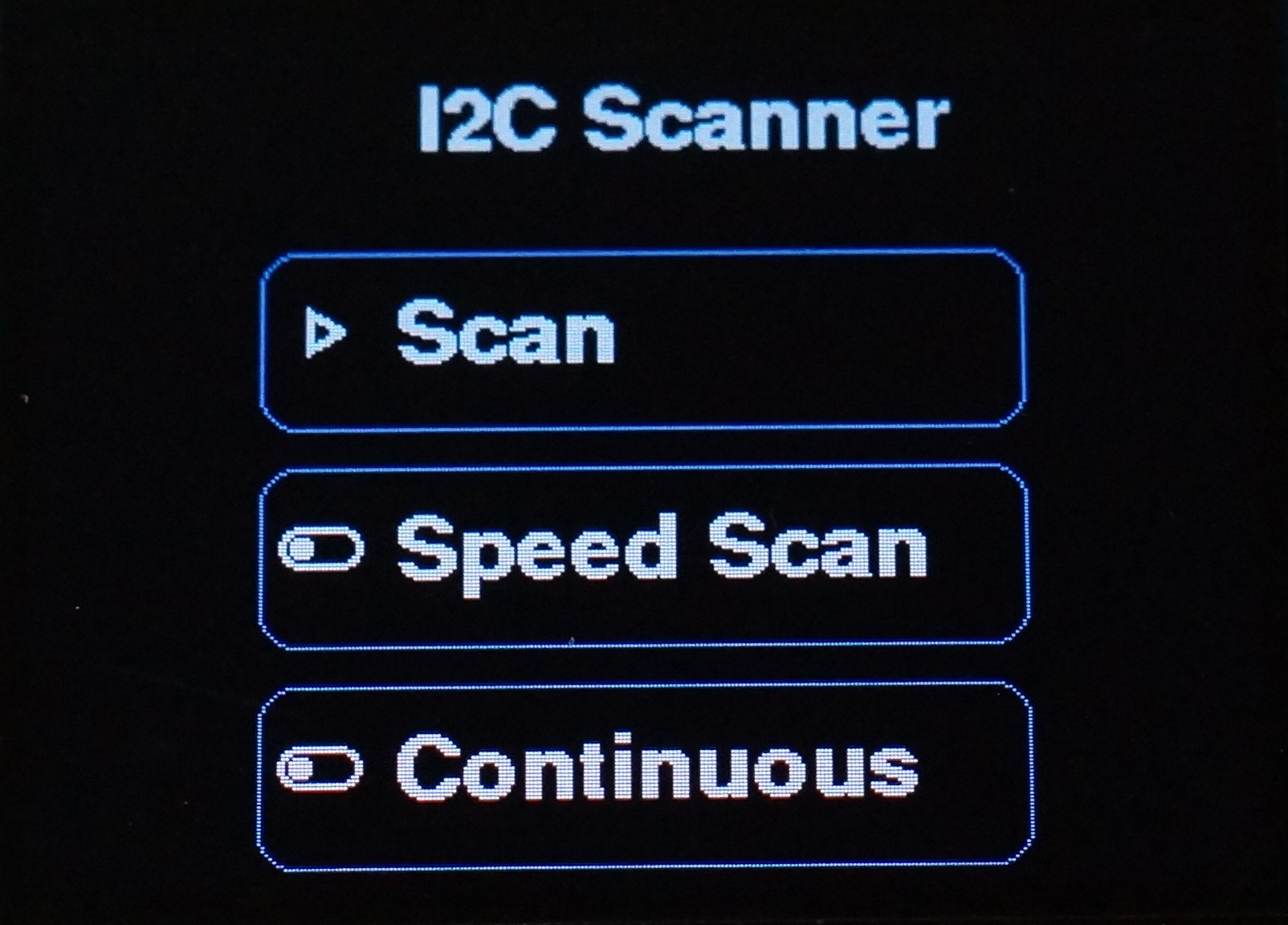

The encoder uses up/down/right/left to move through UI elements which are highlighted, the center button selects elements. The rotary dial controls the display backlight level.
The UI workflow consists of a small number of pages:
On the start page, move the rotary encoder up/down buttons to move between controls. Selecting Scan will perform a scan with a 100 kHz clock.
