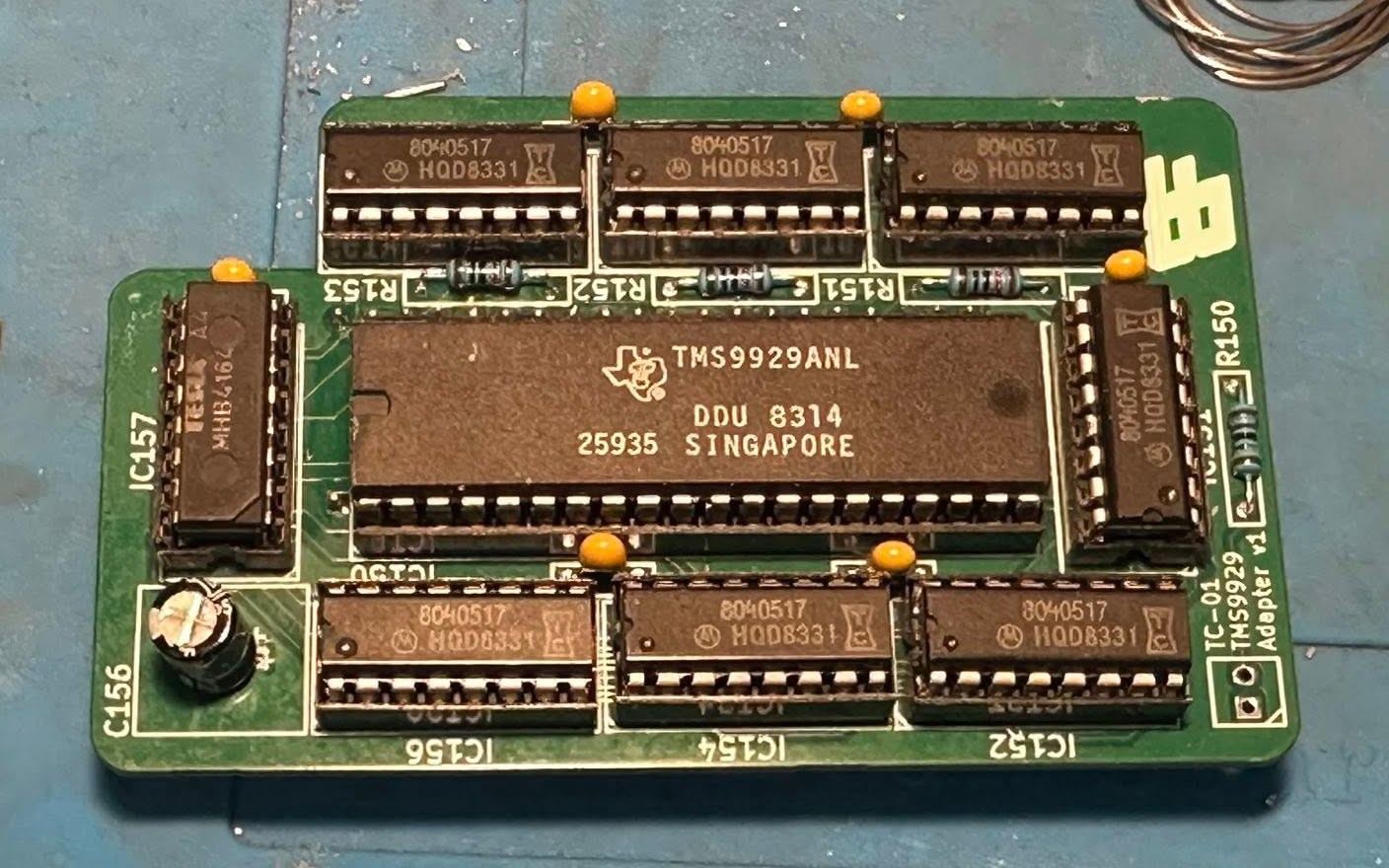

The TMS9129 video chip uses 16k x 4 bit chips. This is an improvement over the TMS9929 which used eight 16k x 1-bit chips, but the 9129 is rarer and costlier than the 9929. Therefore the most economic option is to buy an adapter board. Fortunately I have plenty of 64k x 1-bit DRAM chips. For this board, I plan to modify it to use a pair of 64kx4 chips in the 16kx4 sockets.

    There is a very compact board that produces RGB output and fits underneath the TMS9929. About £37 including postage and VAT.
    You can even buy an FPGA replacement, the F18, but at around £65 this is half the cost of a populated board.
    I want to keep the total cost less than the cost of buying a populated board.
  • Replacing the TMS9129 video chip
    Keith03/26/2026 at 17:31 0 comments
    The TMS9129 is essentially a TMS9929 that uses two 64k x 4-bit DRAM chips instead of eight 64k x 1-bit chips.
    This is definitely good for reducing board complexity, and the TC-01 used it, but it has become much scarcer and pricier than the TMS9929. There are several ways to make an adapter board:
    1. An adapter board with eight 64k x 1-bit chips.

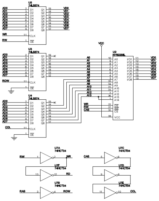

    2. An adapter board with a 32K SRAM chip, three latches and a 6-gate inverter chip.
      This is a bit pointless because 1-bit DRAM chips are still widely and cheaply available.
    3. An adapter board with two 64k x 4-bit chips and a 6-gate inverter chip.
      A lot of clever thought by Greg of Digicool things went into this.
      This looks the best solution where there are 4-bit DRAM chips already on a host board.
    So now I just have to work out how to make the adapter.
    I changed the '244 to a '245, and the inverter gate order to make layout easier.

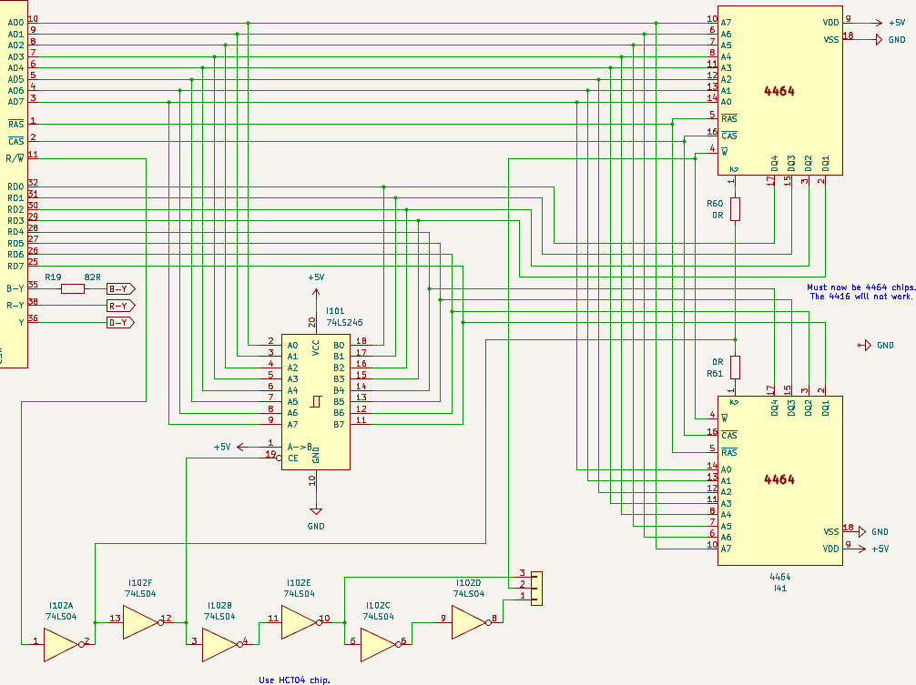

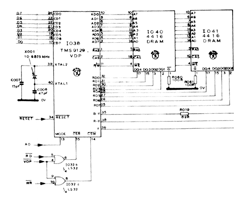

    The TC-01 video memory circuit looks like this:
    Essentially, we will need to
    • connect an 8-bit buffer so that AD7-0 can drive RD7-0
    • DRAM /G pins need their pull-down resistors  R60, R61 removed
    • DRAM /G pins need connecting to the new /G signal from the delay line
    • DRAM /W pins need connecting to the new /W signal from the delay line
    The 9129 socket has no /G pin, so this signal needs carrying on a flying wire.

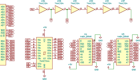

    The buffer and delay gates could sit on a daughter board, with just one flying wire for /G.
    Or they could both sit on the motherboard, with a track cut between R/W and /W.
    I had a go at editing Greg's fix into the TC-01 video memory circuit diagram.
    R60 and R61 tied /G pins to ground via 100R. They can be omitted,
    • Fit 64k x 4-bit DRAM chips (4464). The 16k x 4-bit chips (4416) will not work.
    • Remove R60 and R61
    • Wire the inverters in a delay chain as shown
    • Wire the VDP R/W pin to inverter pin 1
    • Wire inverter pin 2 to DRAM /G pins
    • Wire inverter pin 3 to the buffer /CE
    • Wire the 4 or 6 gate delayed signal fed to the DRAM pin R/!W
