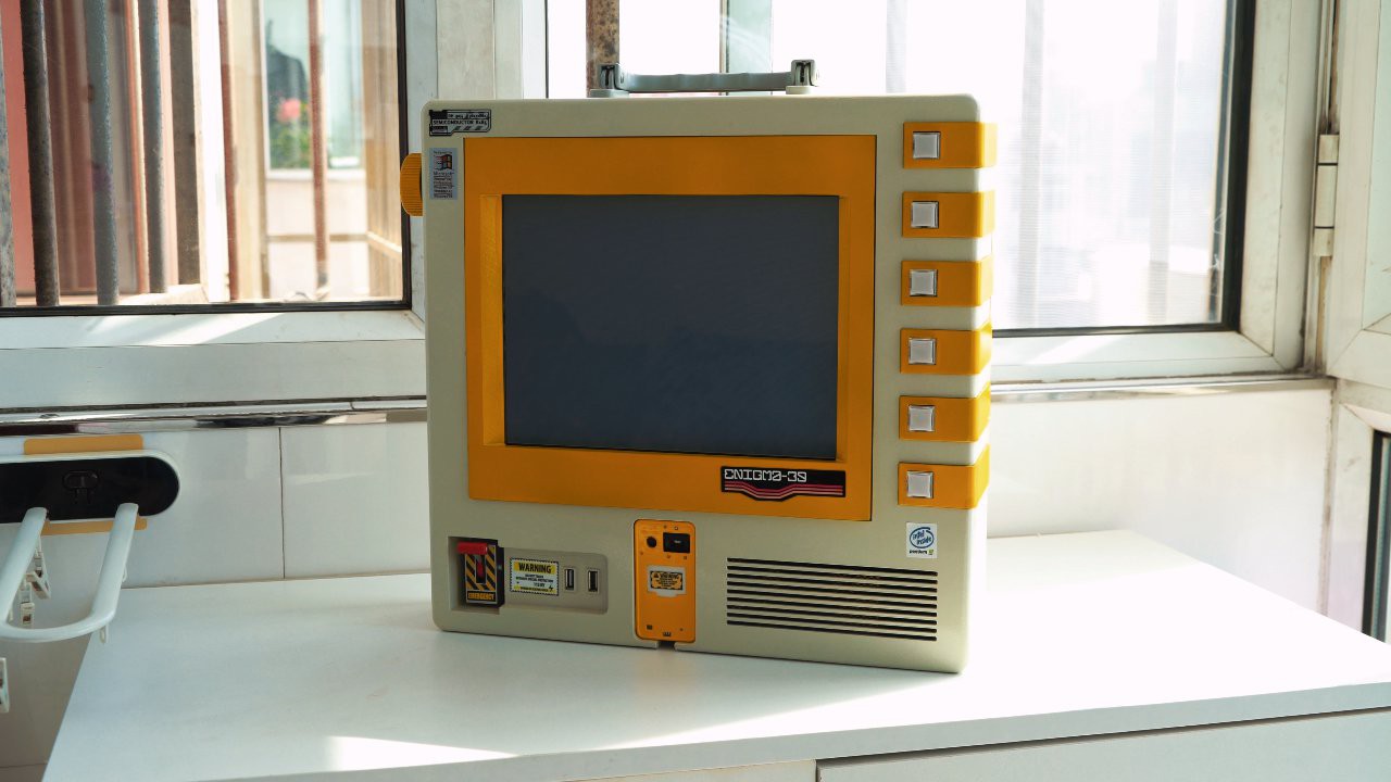

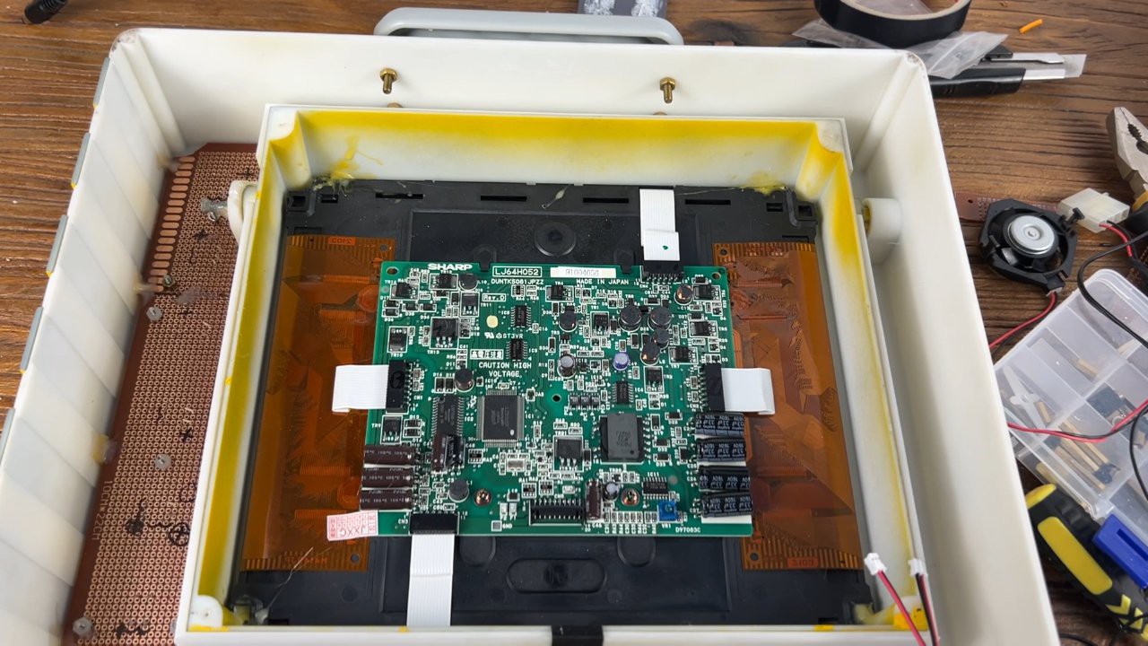

Make a laptop in the style of a post-apocalyptic wasteland.

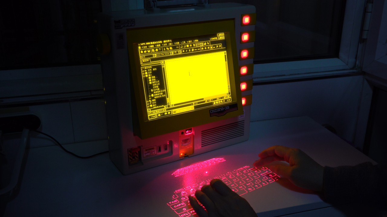

Electroluminescence has a beautiful halo and a more sci-fi feel. When combined with a laser projection keyboard to form a laptop, it's a really cool thing.

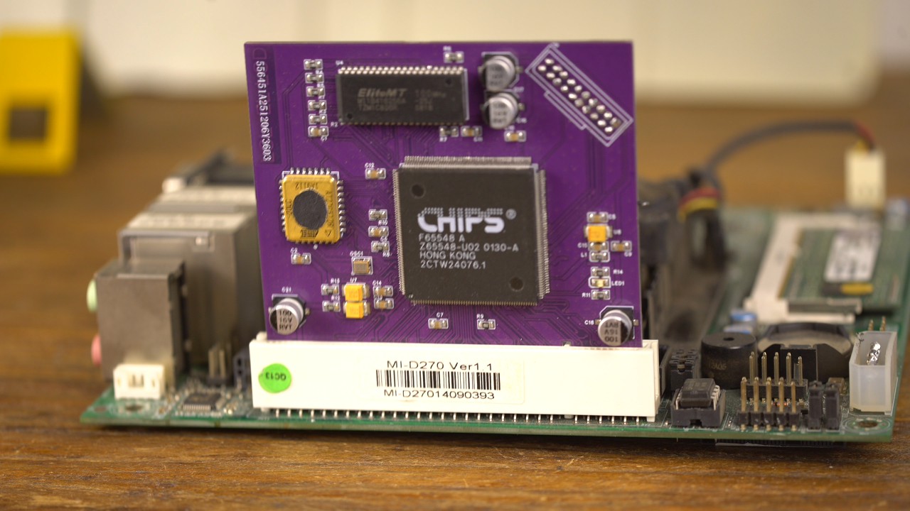

I have developed a graphics card capable of driving a 10-inch electroluminescent screen. It has a PCI interface, and you can also use it with a PCI-E interface through an adapter. The core of the graphics card is chips65548/5, which can be purchased on many platforms. Currently, the tested compatible models of the graphics card are: LJ64H052, EL640.480-AF1, EL640.480-AG1, EL640.480-AM. The price of electroluminescent screens is not cheap.

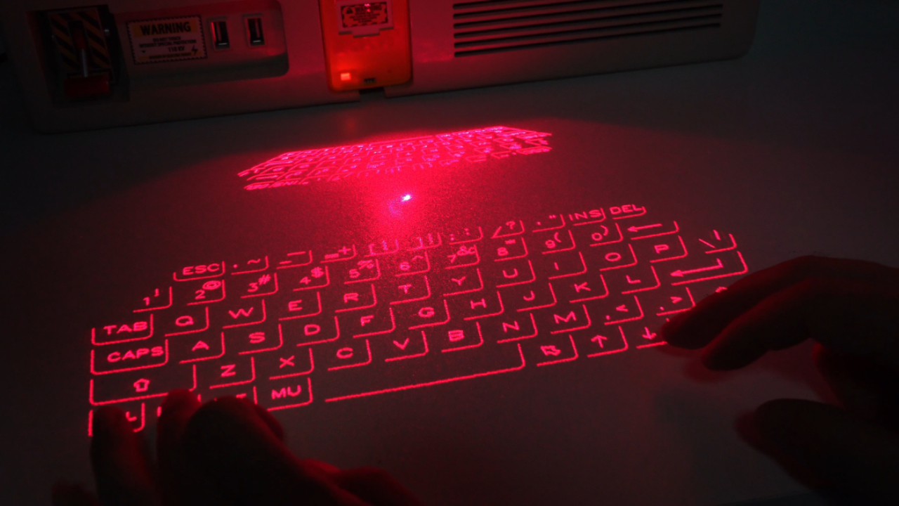

The laser projection keyboard is very sci-fi and has a dystopian cyberpunk feel. This keyboard is available for sale on many platforms.

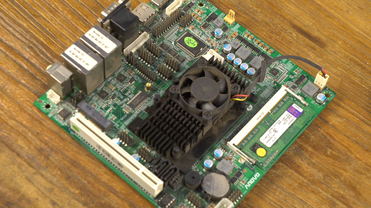

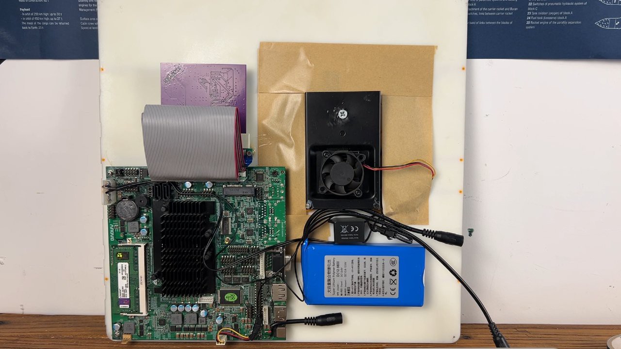

The internal structure is very simple, but the shell requires a large printer. It is very large in size.
