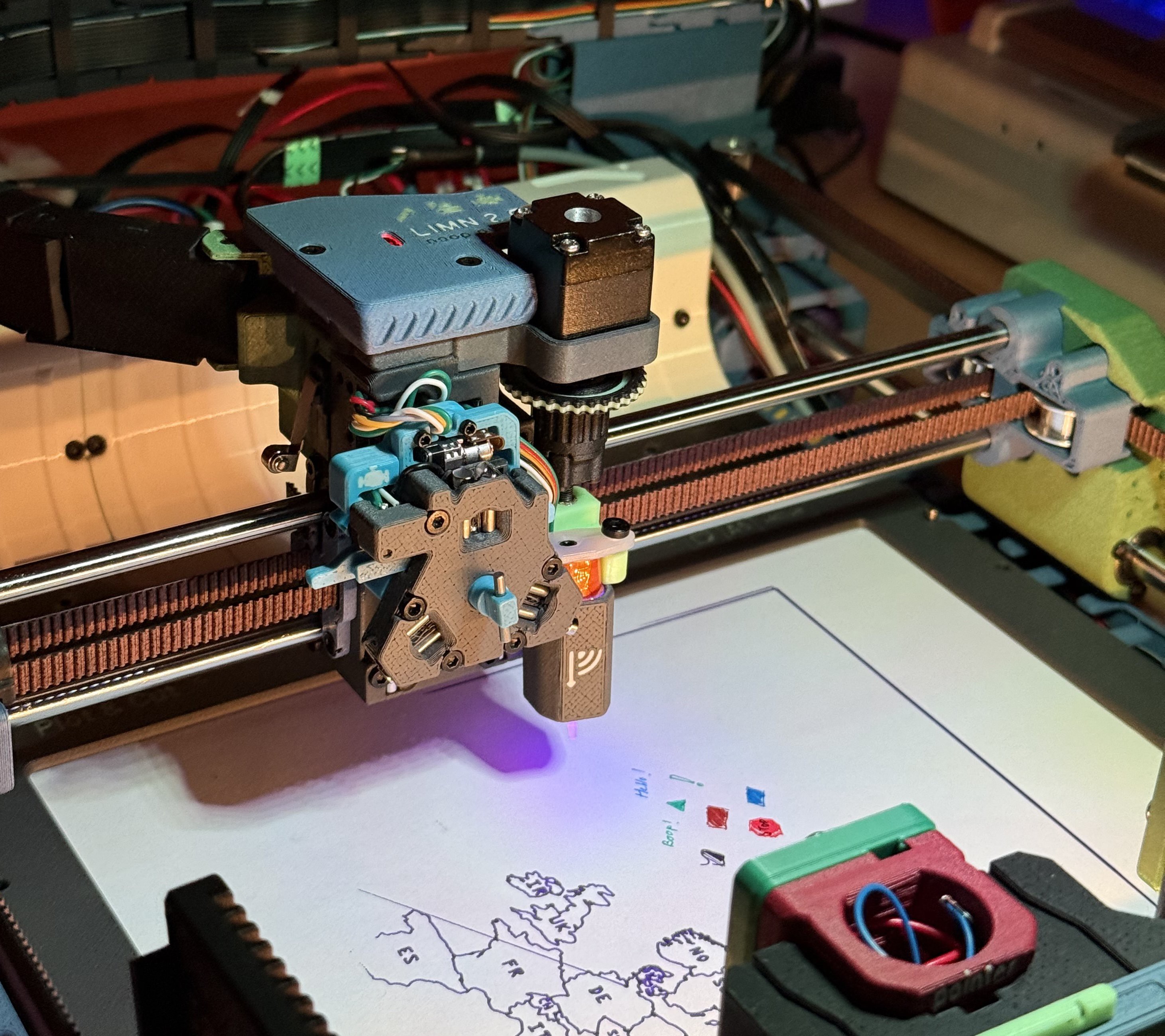

I've always wanted to build my own Pen Plotter that can change tools automatically. Limn can pick and use various tools with high degree of repeatability. Docking and undocking tools works well. The design is close to being stable now.

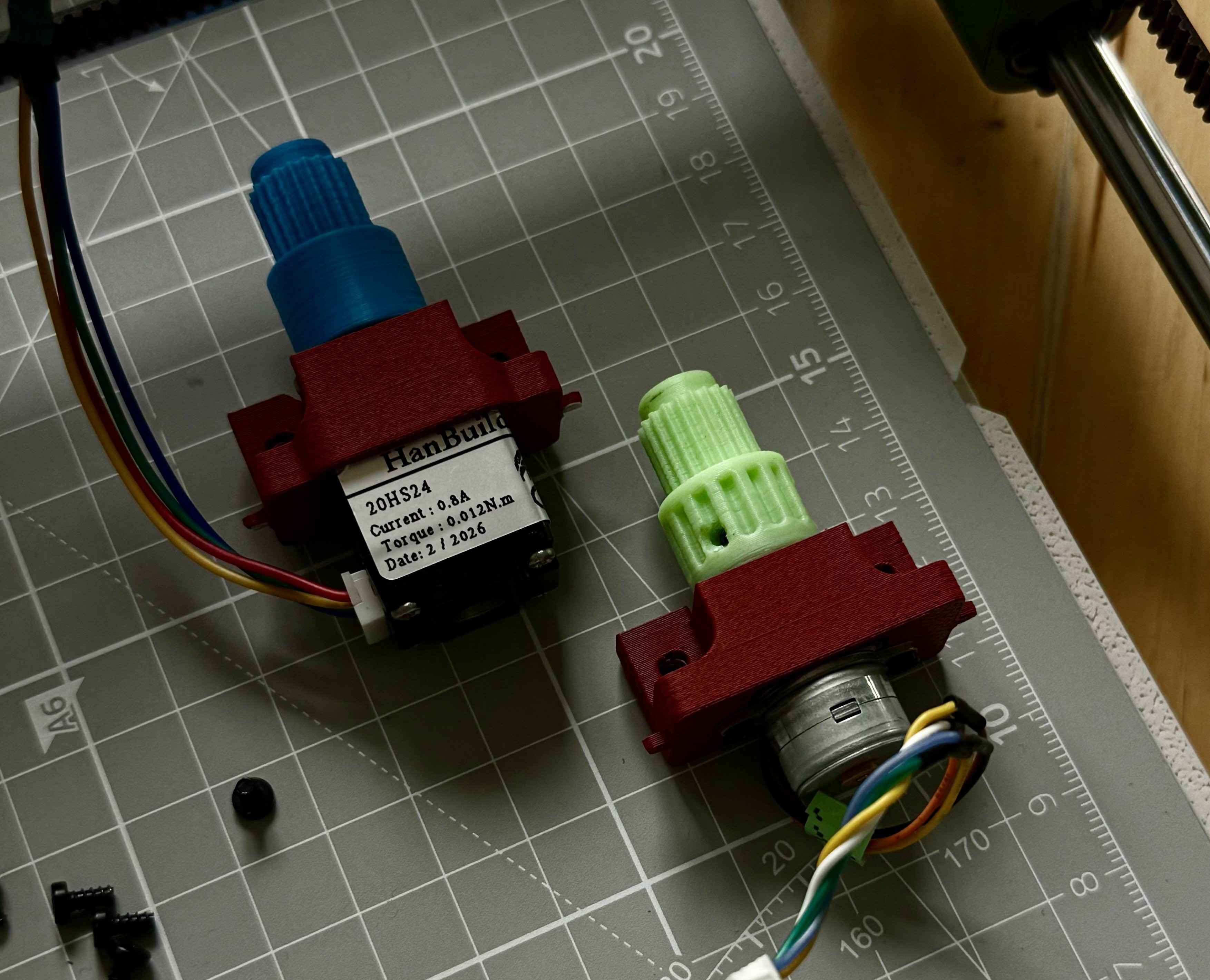

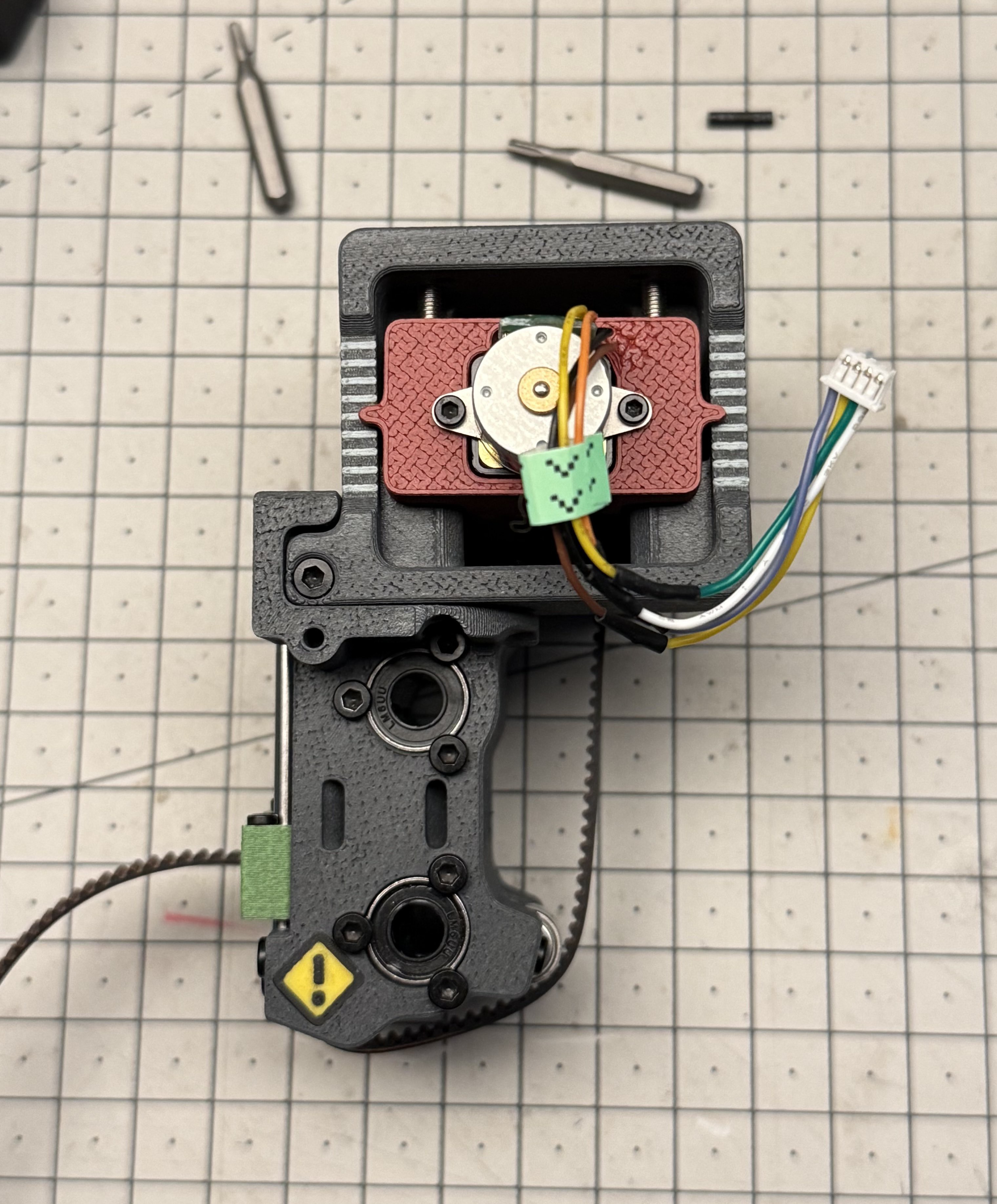

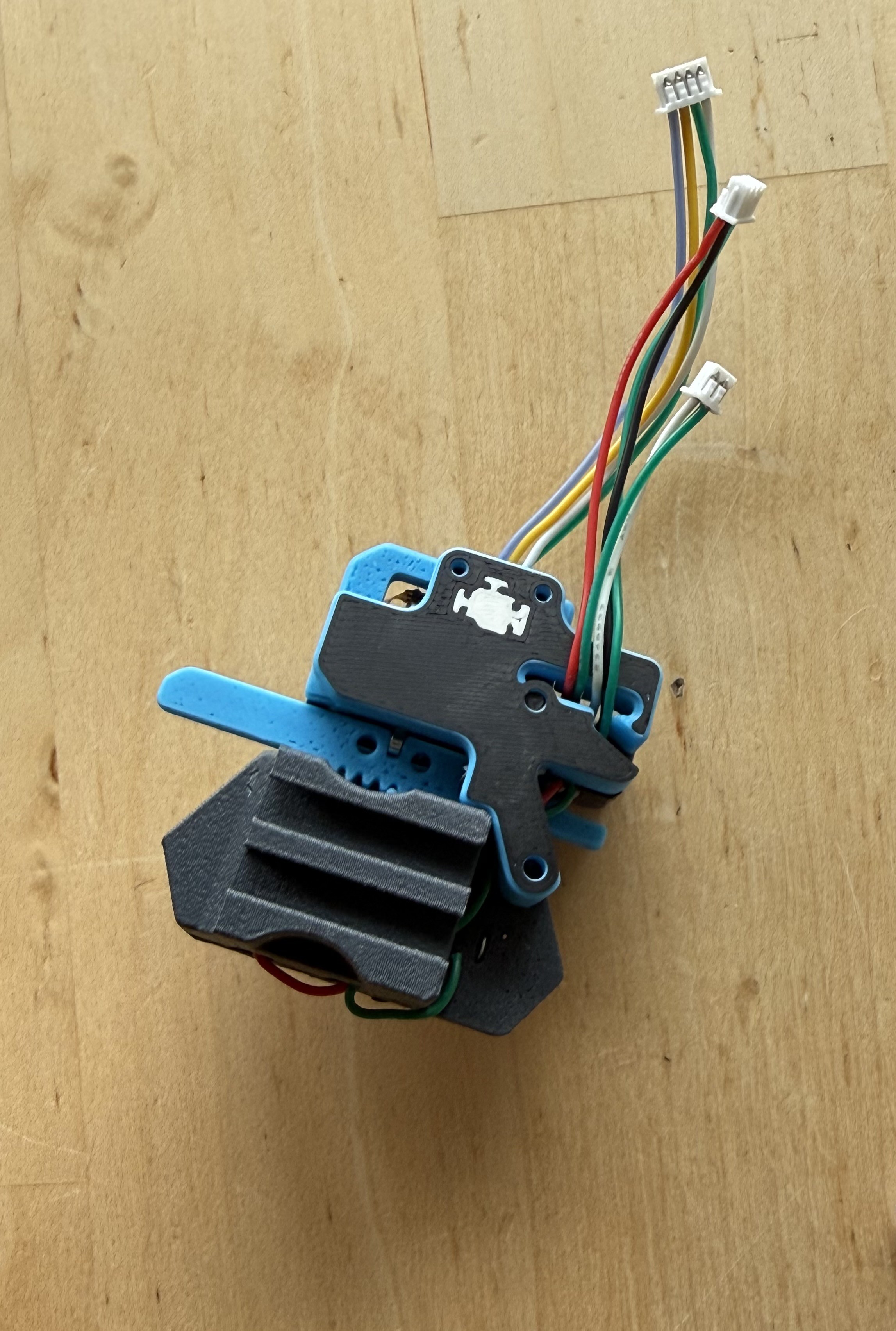

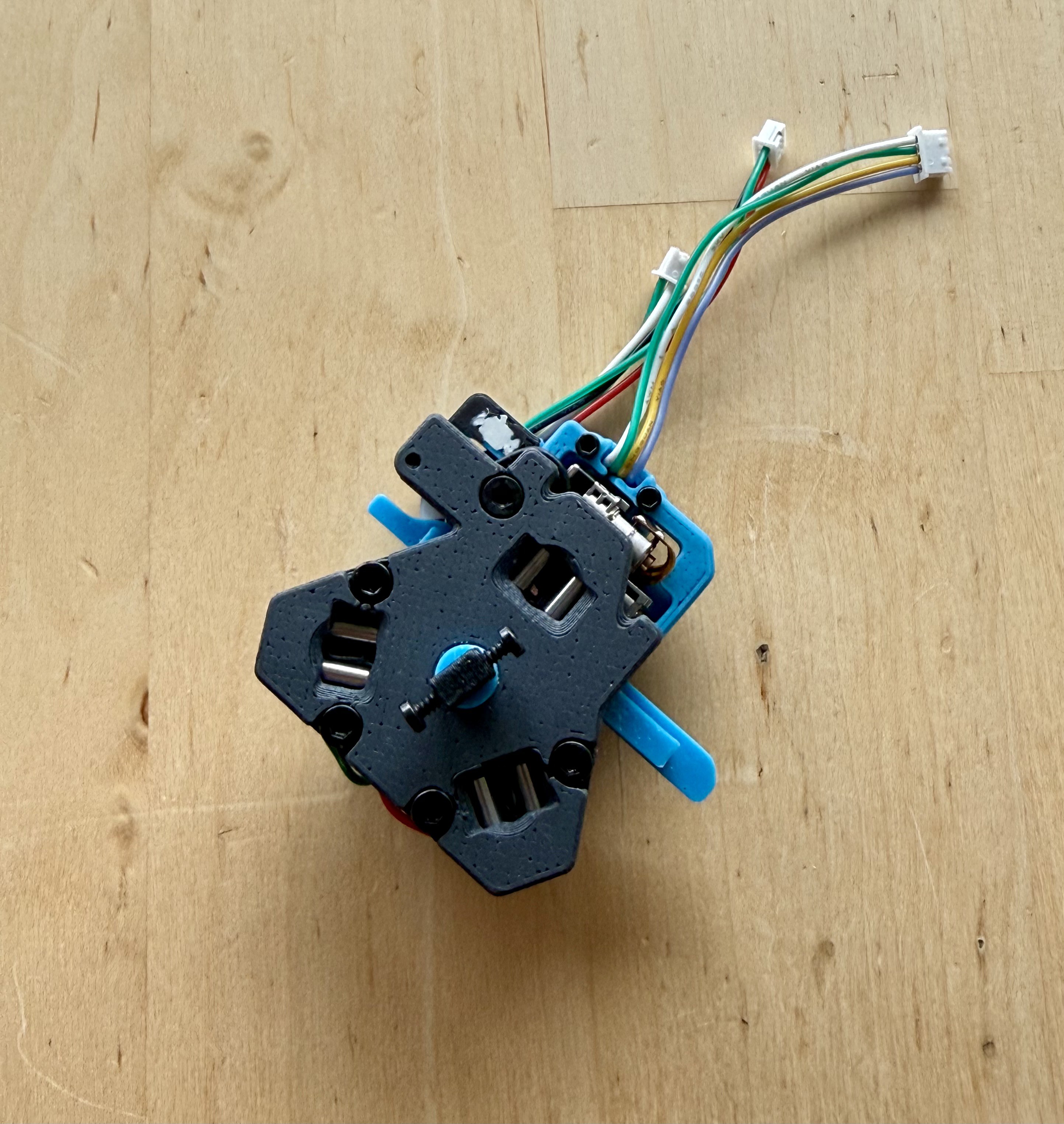

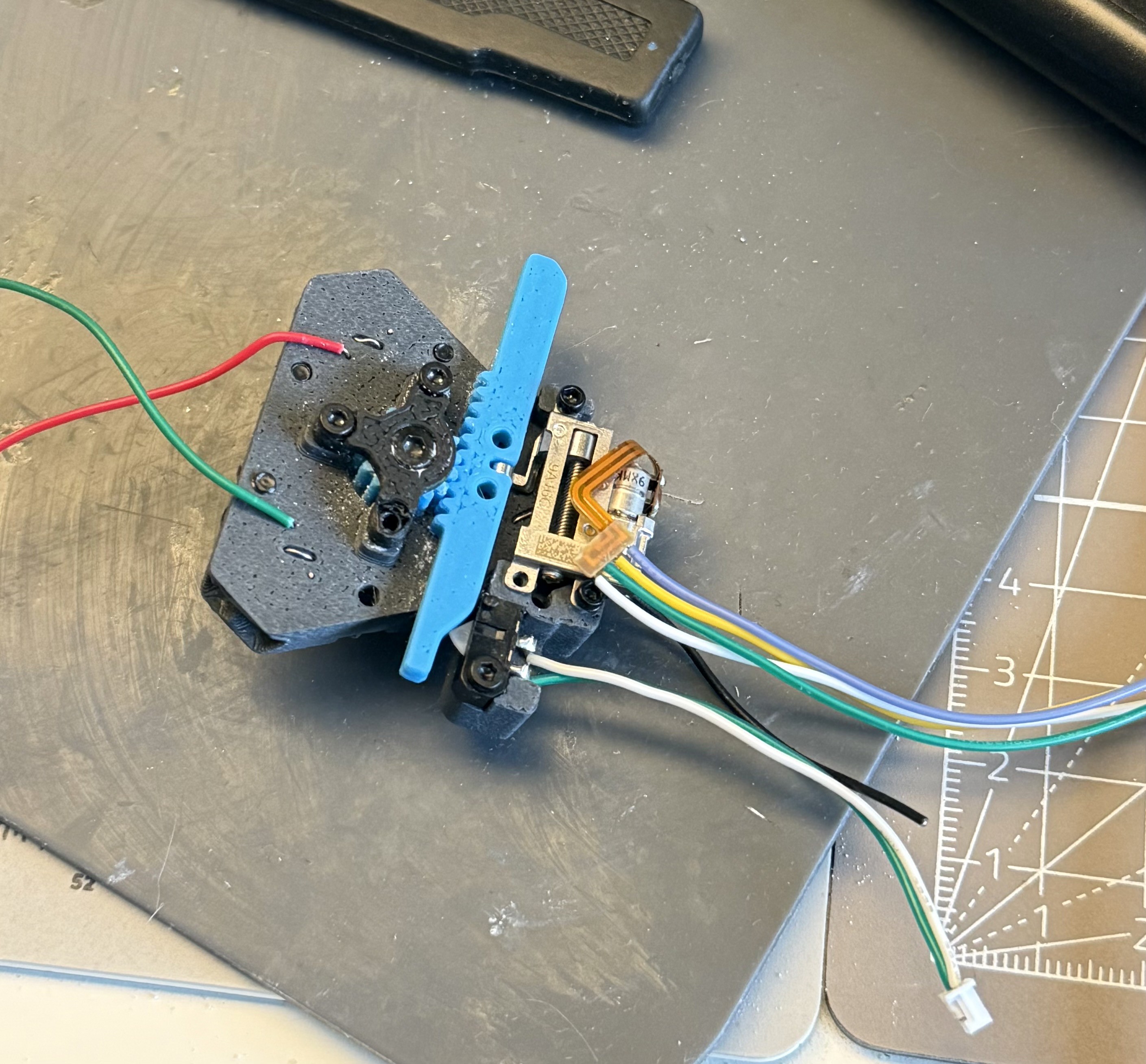

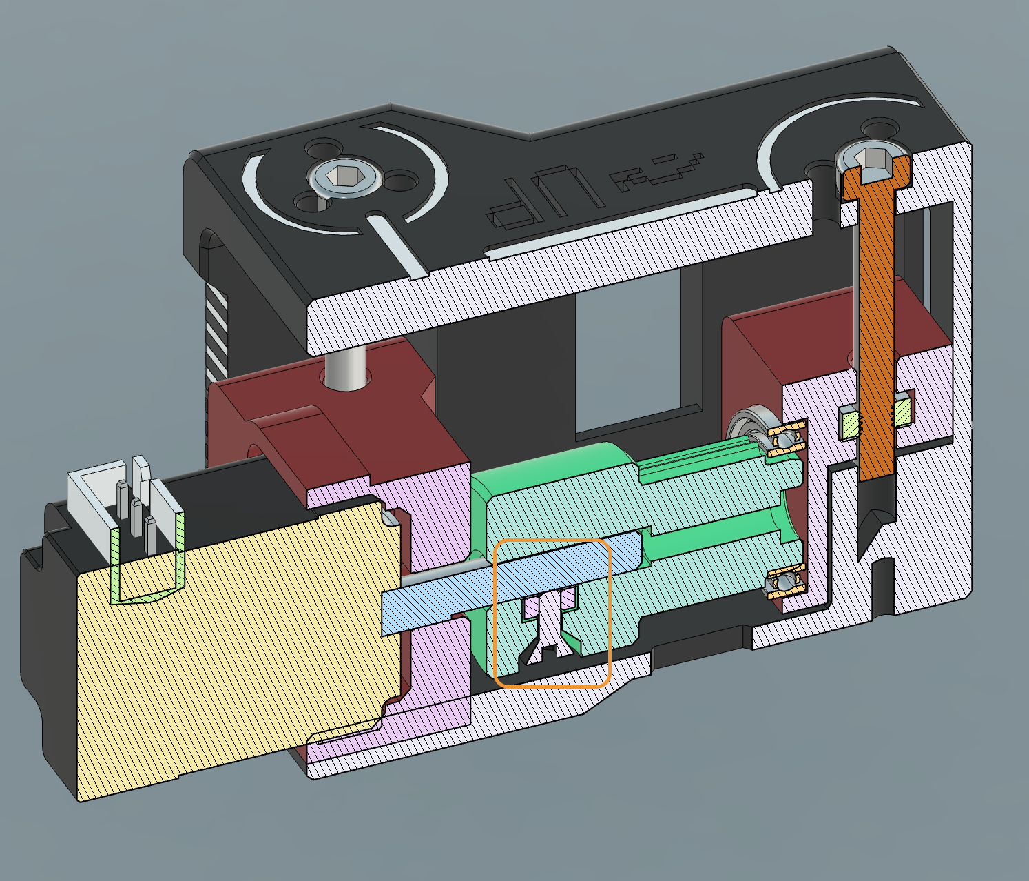

Inspired from E3D, the toolchanger uses a small stepper motor to actuate a rotating key that docks the tools. While the motor is quite low-torque, the geometry and the mechanism makes docking light weight tools possible.
The tools can also connect electrically to the printer using the docking pins, and with an RFID tag we can read and write tool specific parameters (such as offsets, tool properties, etc.) for automatic tool usage. Three pins are available, VCC, GND, and GPIO.
Levers and wheels on the toolhead make manual movement possible.

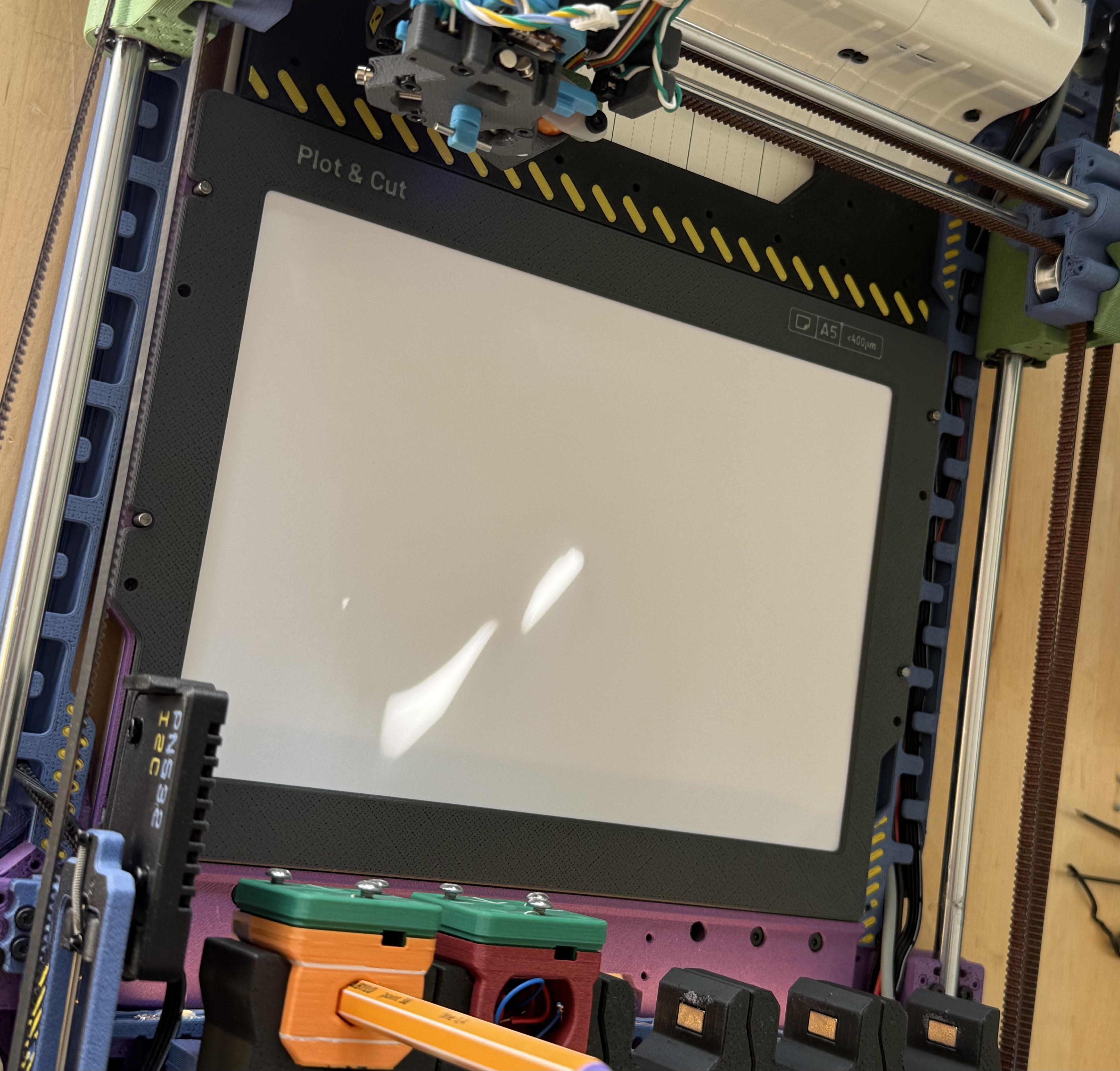

Limn is a Pen Plotter with an E3D style toolchanger. I built it using parts reclaimed from an old 3D printer, some new hardware parts, and 3D printed parts. It runs using Klipper and PrusaSlicer, similar to a regular printer.
Some key parts can be obtained from old 3D printers:
- Control Board (Melzi V2, modified to have 5V stepper voltage on two axes)
- 2x NEMA 17 Stepper Motors
- 8mm rods for the edges (Size can be variable, but need 2x of same length for X axis)
- 2x 6mm rods for the Y axis
- 6 & 8 mm linear bearings
- Idler pulleys
Apart from this plenty of screws, bearings, and belts are needed.

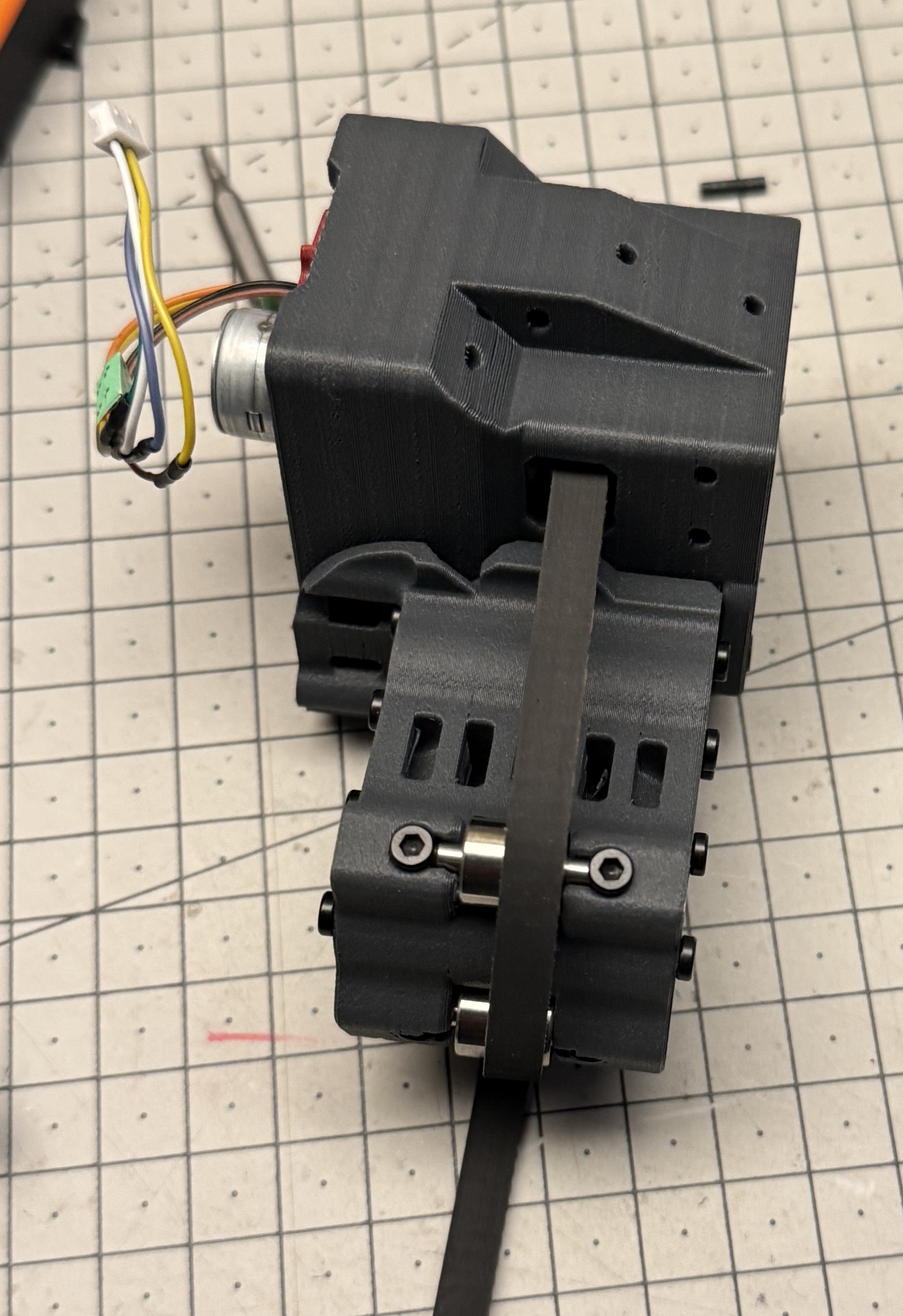

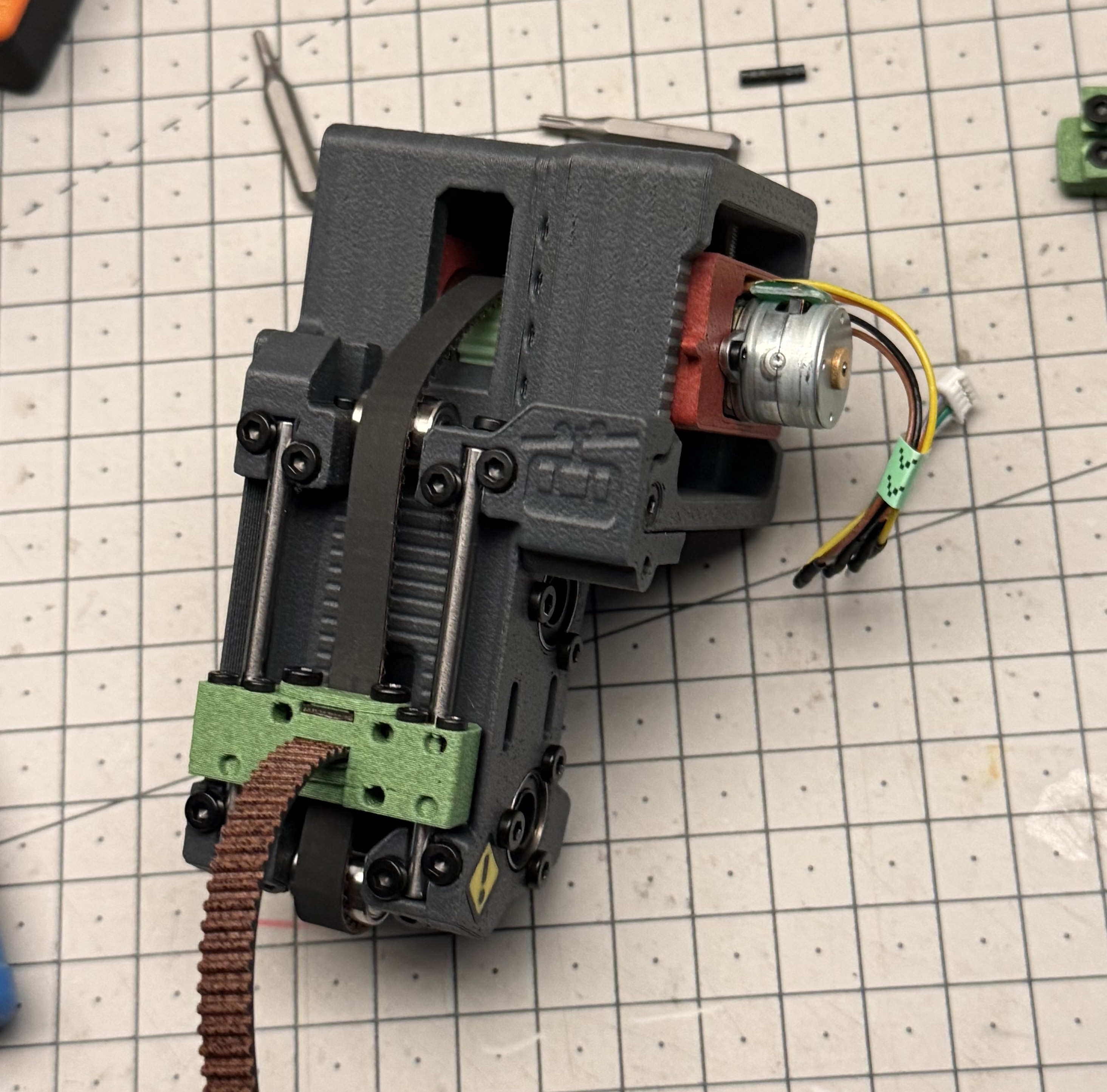

The design uses CoreXY framework. The Z axis is integral to the toolhead.
The toolchanger "locking" system uses a tiny linear stepper motor found on Aliexpress, which drives a rack to turn a gear on which the key is mounted. The torque is VERY low and is making it quite challenging to have a successful coupling.
We needed low wobble and low friction, so the rest of the design has to maintain precision for this to work. Also a bit of PTFE lube worked wonders!
The extra wires are conected to the screws and were intended to power/communicate with the tool in future. I've discovered since that the resistance is too high. Will retry or switch to pogo pins later after eliminating the coupling reliability.

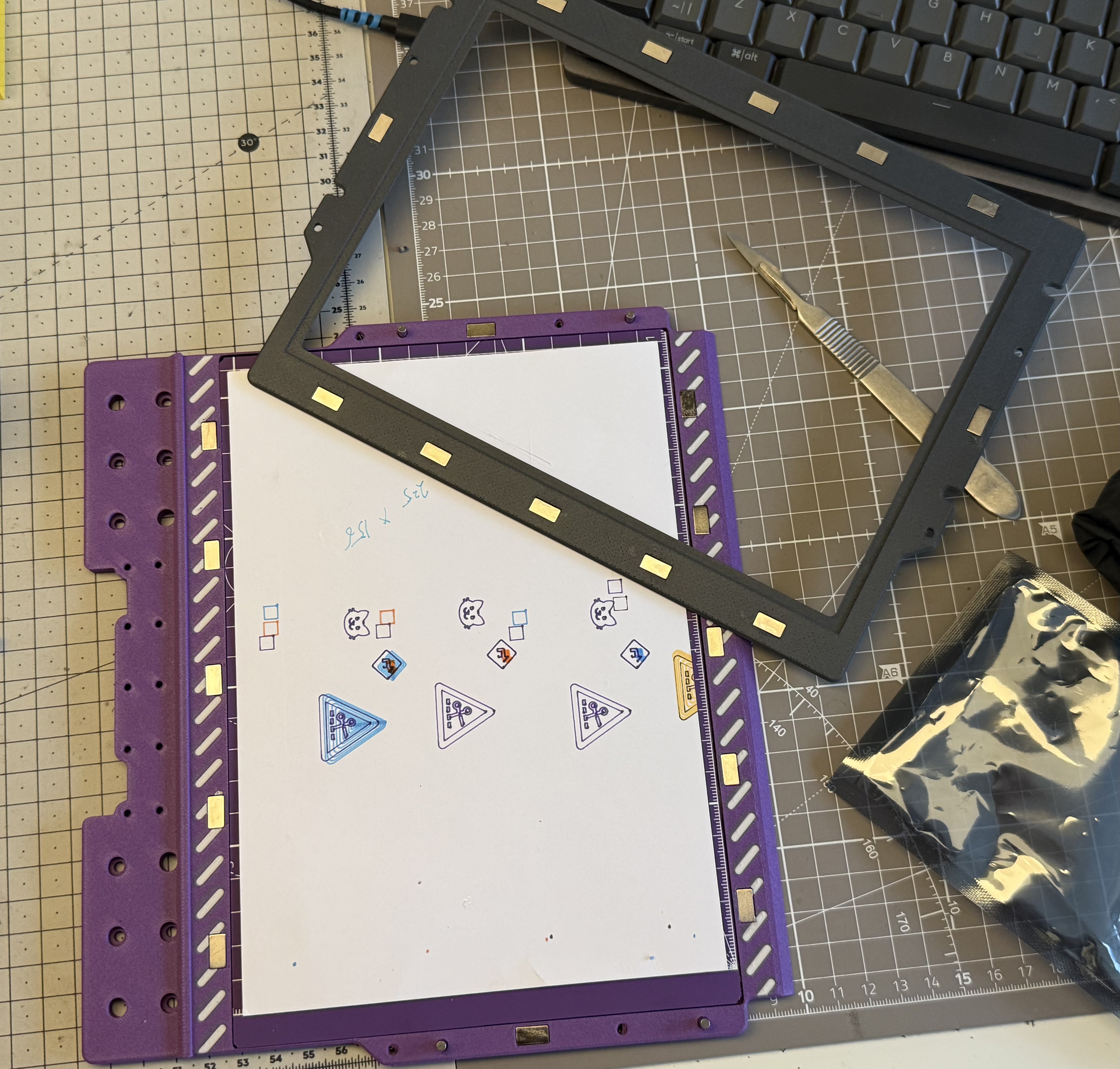

  • Automatic Tool Alignment - Part 3 (it works!)
    Prashant Sinha06/13/2026 at 09:11 0 comments
    After a few trials, updated code, and slicer config, Limn is now able to calibrate its tools. I managed to have ~0.2mm precision with the Resistive Touch Panel to align the tools. In fact, I still haven't trialled the Force Sensor Array because the Resistive Panel seemed quite good already -- at least with 0.5mm pens.
    The system now works as follows:
    Sensor Calibration
    • Calibrate the touch panel and bed using BL-Touch to obtain z-meshes.
    • Pick tool T4, which acts as the "zero" reference pen, and probe the touch sensor at three locations (for touch calibration).
    • Next, collect a set of samples (in plotter's coordinates) on the touch panel.
    • Store the tool's RFID tag with the Z value.
    • Draw a line on the paper and undock the tool.
    • The panel mesh, paper mesh, and sample points are stored as calibration parameters.
    Tool Calibration
    • Pick a tool from the dock.
    • Probe the tool at random coordinates (from the samples set).
    • Subtract the tools' coordinates from the samples set.
    • Write the XYZ offset to the RFID tag.
    • Continue the previously drawn line on the paper for visual inspection.

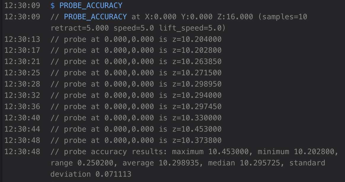

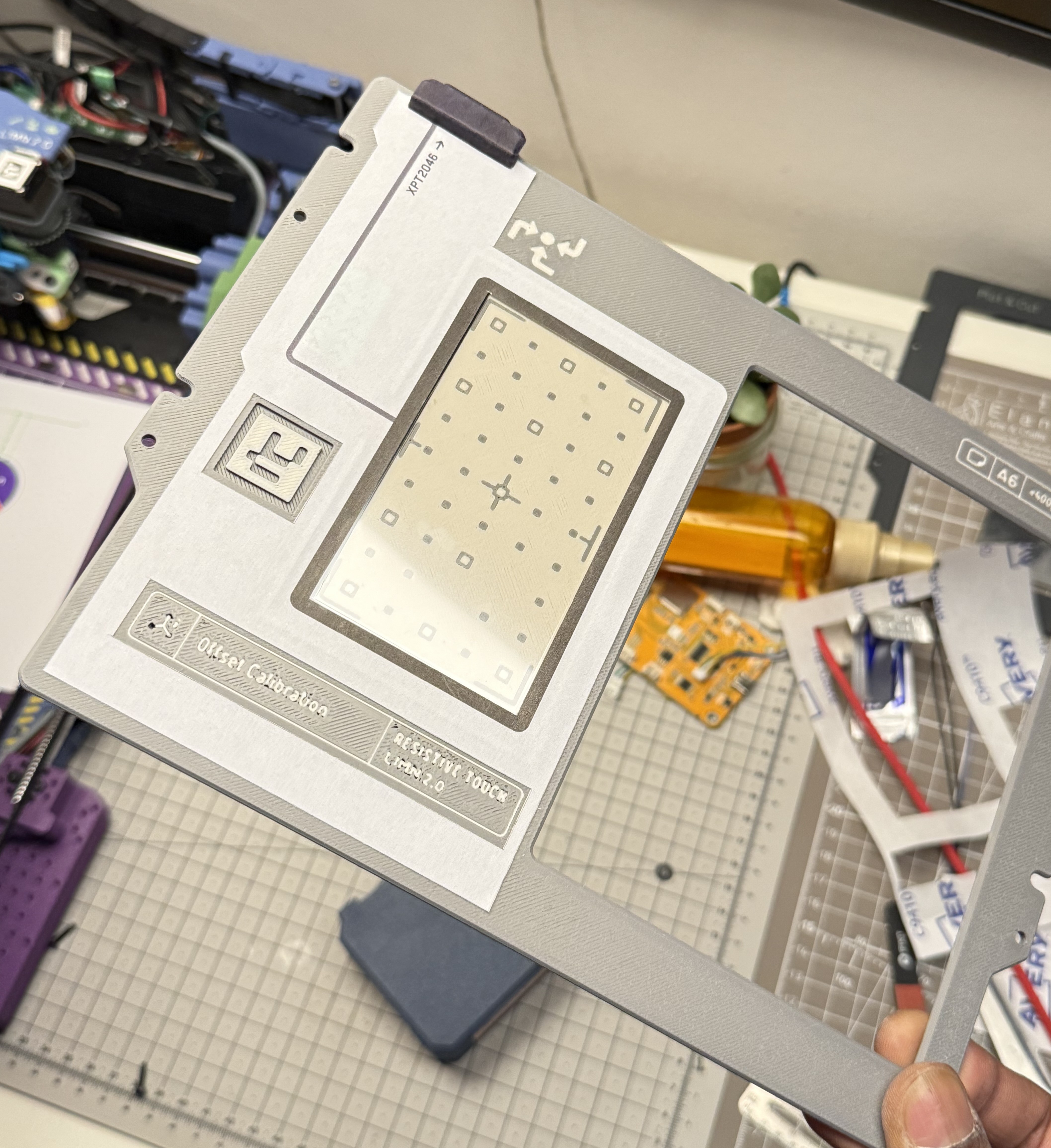

    Using the Resistive Touch Panel I collected an extensive set of samples in order to figure out how to get tool offset. I simulated deviations in XY using this probe (pictured) -- the desired offset from center could be achieved by unscrewing a particular screw a bit.
    There were 9 coordinates in total, and three samples were taken for each points in a grid. Raw values from the Resistive touch panels require filtering and transformation in order to obtain coordinates in plotter's space. Therefore a calibration step takes measurements at three locations (ref. AVR341 app. note) to get transformation parameters.
    Following show the data I collected, indicating that the resistive panels can get us close to alignment. The data and transformation steps are noted here.
    I've since concluded that I'll use the panel for rough XY and precise Z calibration. For getting precise XY calibration, I decided to use an 8x4 2.5mm array of Force Sensitive Resistors (FS-ARR-4x8). Idea being that we can aim for a particular cell and know precisely where we land.
    I modified the bed to have two RP2040 modules (with 4 ADCs) each controlling the Resistive Touch Screen and FSR. I had to make the bed a bit thicker, at ~3.2mm, and sand a FFC breakoutboard to get everything to fit.
    The pogo pins induce noise and having power always present on the pins didn't seem like a great idea, so a third RP2040 can provide the power upon detecting the bed. The detection is by measuring the resistance between two pins on the connector. I posted a demo video:
    The three MCUs run micropython and I'm still working on the firmware. For this purpose we do not need to chase speed so upython seemed particularly nice.

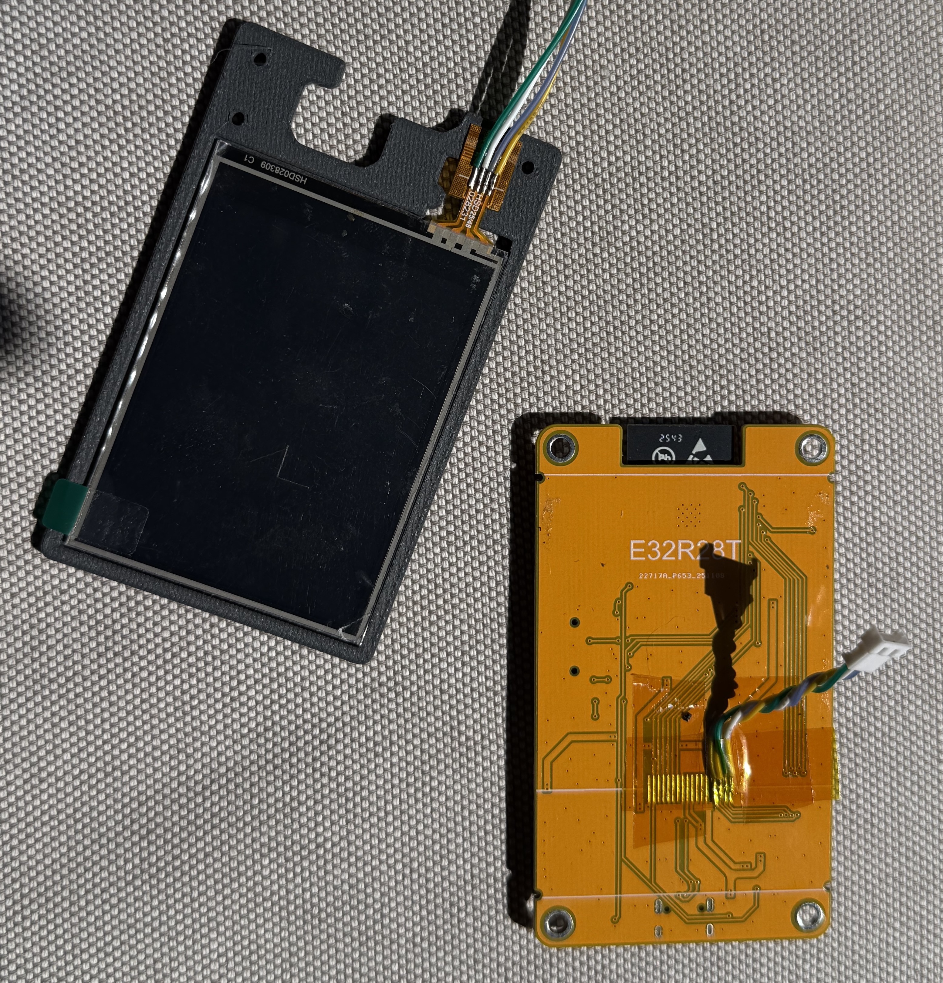

    Here's an early picture of the back side:

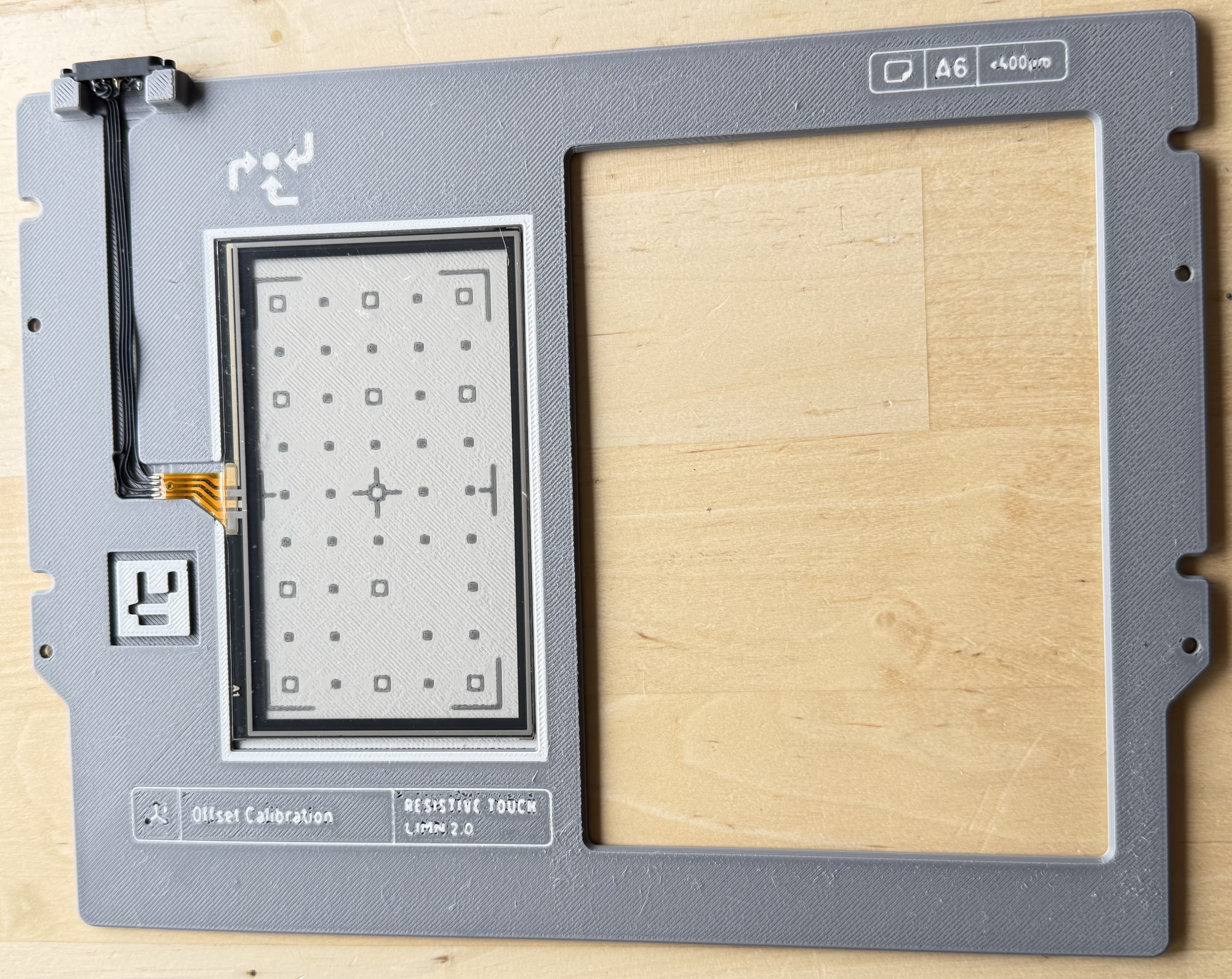

    Last weekend I spent ~30 minutes calibrating three pens manually. Annoyed, I decided to automate this process as well. For complete pen alignment we need to offset the XYZ coordinates -- the offsets are stored in a RFID tag (more details)
    A Resistive Touch Panel was used to build a new plotter bed. By probing a tool over the panel at several location we can know the three spatial coordinates.
    I used a Cheap Yellow Display (CYD) 2.8" which contains an XPT2046 resistive touch controller and panel. I removed the display entirely and soldered pigtails to four touch panel pins. Then I used another larger resistive panel that I reclaimed from an old car GPS. Magnetic Pogo Pins allow connecting the panel when needed.
    The new bed is 2.5mm thick and magnetic alignement is highly repeatable. I posted a demo video of it in action.
    Hardware
    To connect the touch panel to klipper, I'm currently keeping the CYD in use.
    • The CYD outputs a 3.3V 10ms pulse whenever a touch event is detected.
    • An OR gate built with two NPN transistors combines the BLTouch Probe
      Signal and the touch signal, output of which is used as PROBE_ENDSTOP on klipper.
    • Now, when running Bed Mesh or Probe calibration, the toolhead stops when
      EITHER resistive touch event or BLTouch trigger is detected.
    • This essentially means that basic Z offset calculation work using BLTouch with no changes to klipper.
    • CYD is connected to Klipper Pi over USB.
    • There's a screen protector layer over the panel and the software will implement wear leveling to use the entire panel evenly.

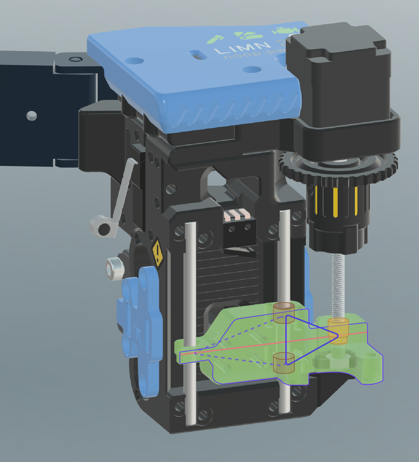

    I spent some time reflecting and then decided to actually fix the backlash issue in the Z axis. My initial tests showed that the NEMA 8 motor would be good enough for a lead-screw driven axis. A 35mm M3 bolt was attached to a bracket with a nut and fixed with thread-locker. Then the "lead screw" is fixed to the motor using a coupler.
    The lead-screw, which drives the Z axis, is placed on one side. This posed a challenge because the "rider" would tilt up/down and jam. I looked around at slide mechanisms, and noticed that many optical drives a common layout -- the rider is kept level through triangular geometry. The following shows the current slider layout:
    This works surprisingly well, although is a bit slower than belted axis. I'd need to recalibrate the tool dock and also find the correct rotation-distance.
    Update: I'm reasonably close to correct value: 0.03 mm/rotation (the value is explained by the fact that I'm using no microstepping on a driver hard-wired for 16 microsteps. I can't use microstepping because the AVR MCU can't generate steps fast enough.) The probe accuracy is reasonably better:

    The tool docking mechanism relies on Maxwell Coupling for repeatability, however this repeatability only holds per tool. As such, different pens will land at varying positions on the paper for the same coordinate.
    My current understanding is that it will be too much effort to precisely align each tool, and rather it'd be easier to calibrate each tool against a reference tool (ideally the sharpest pen). Hence we need a way to configure the tool parameters (`{offset_x, offset_y, offset_z, depth...}`).
    For the sake of simplicity it'd be good that the printer handles this at runtime. Any print file could be printed by any tool/tools.
    I really did not want to reinvent any more wheels, so I stuck to PrusaSlicer. A new printer config, with custom gcode templates, multi-extruder toolhead, and some regex susbtitution later I can now drag an SVG file in the slicer, and generate the exact GCODE that klipper is expecting.
    Pen Up and Down motion is achieved by replacing `retraction` events. I chose to keep raw Z values here, and change Z-offset on klipper instead, so that the travel moves reflect actual pen moves in the preview. Similarly extrusions are kept only to have something in the preview, but are ignored by G1 macro.
    The slicer emits T0..T4 commands for each tool change. On klipper side custom macros translate these commands to actual movement.
    I still haven't figured out varying nozzle sizes while slicing but it should be possible.
    Back to detecting tools: A basic detection can be done by physical contact with the coupling surface -- on the tool's side we can bridge two screws with a wire. I'm aware of 1Wire EEPROM being a thing but did not find any to buy. There seems to be several Spool detecting projects, such as OpenSpools, which can use RFID readers to detect the spools. We could use something like that.
    To set the parameters there's now a spring-loaded-retractable RFID sensor mounted near the first tool. It can be slid back by the Y axis.
    (I did not realize that I wired the PN532 with I2C, but OpenSpools needs SPI connection. I'm too lazy to take it out so I'll likely have to figure out an alternative on this.)
    On the tools we stick a tag and the docking macro will eventually use the sensor for tool parameters.
  • NEMA 8: No Go & Backlash Correction
    Prashant Sinha04/03/2026 at 15:46 0 comments
    I received the AliExpress NEMA 8 motors yesterday and replaced the SRM1509 for a test. After tightening the belts I can turn the axis manually but the stepper just buzzes. I tried upping the stepper current till 0.8A but I could stop the shaft with my fingers. Oh well. I went back to the previous motor.
    I wanted to make a note about the pulleys. Normally even if you make the shaft hole good size the pulley would not engage and the little flex it has will allow it to turn. I figured a good way to prevent this is by embedded nuts. Essentially a nut on the flat surface of the shaft, and a screw.
    Since for now we have to live with the gear play I attempted correcting the backlash in software. Klipper allows you to override any macros, including G1, and with a macro variable one can keep track of the direction the motor was going in previously. If we are about to go in opposite direction then extra motor movement can correct for backlash IF it is stable (it is in my case). Only problem is that BED_CALIBRATE does not seem to be using a G1 command so the bed mesh is not corrected.
    For plotting without a bed mesh the backlash is not really a big deal. With bed mesh we need to just be careful to not overshoot the end positions on the axis. I haven't found a clean way to do this yet, but I'm looking at /extras dir in klipper right now.
