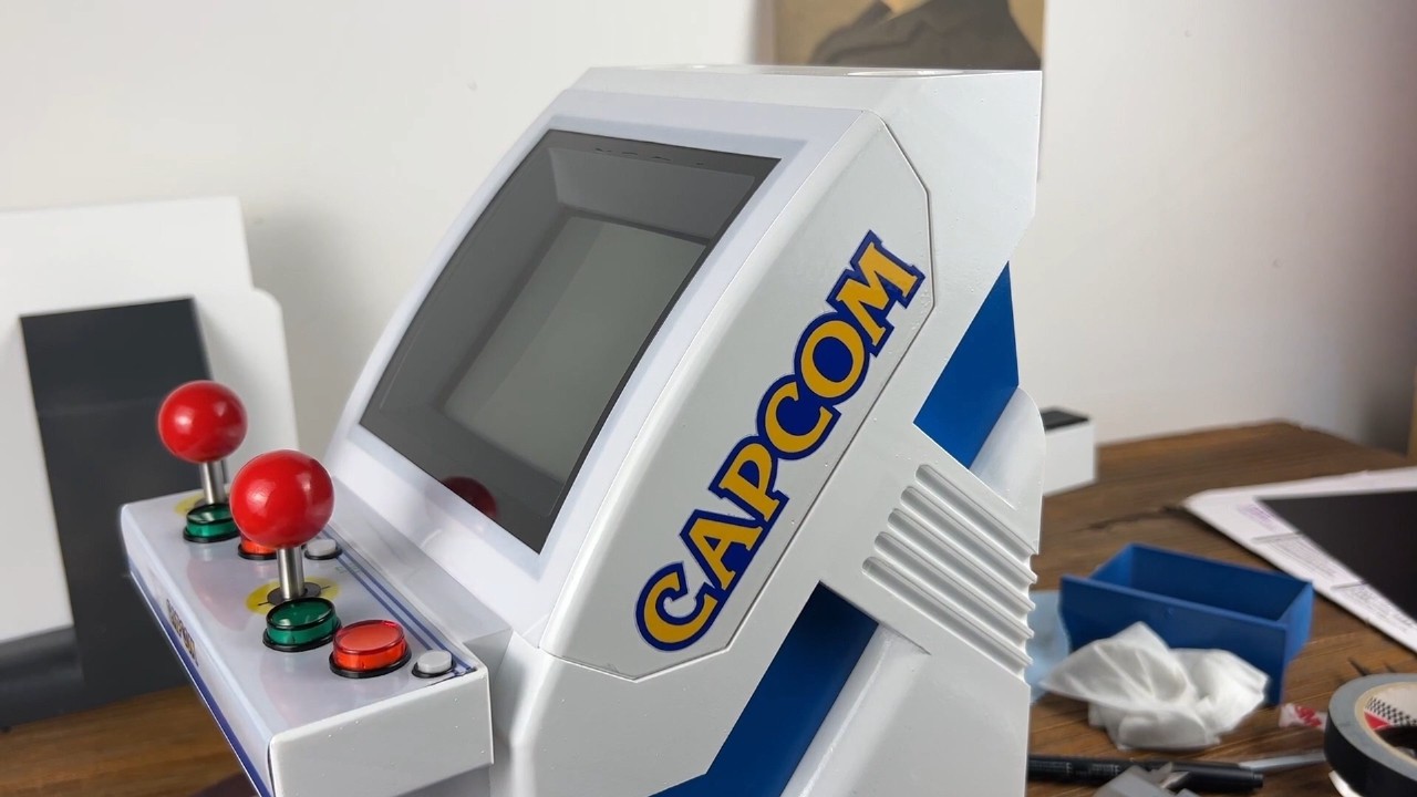

SNK, TAITO and Sega have all launched their corresponding mini arcade machines.However, the arcade game giant Capcom has not released a mini arcade. This is a pity, so I plan to make a mini arcade of Capcom by myself, which can play classic games like "Dino Dilemma" and "Street Fighter".

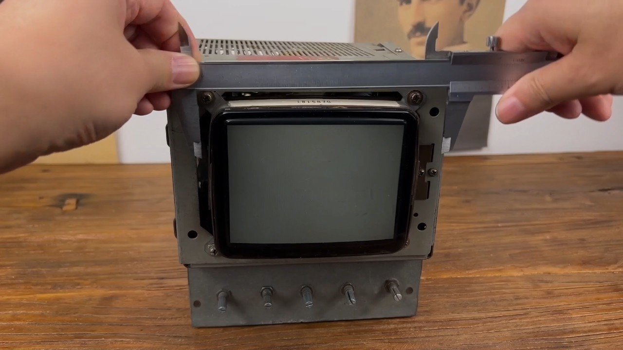

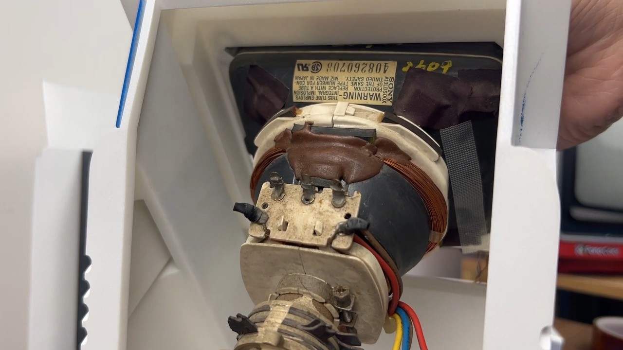

To faithfully reproduce the arcade effect, I used a 6-inch mini cathode ray tube monitor. This may seem crazy, but the display effect is very nostalgic and beautiful.
Sony's 6-inch picture tube actually comes with RGBS input.

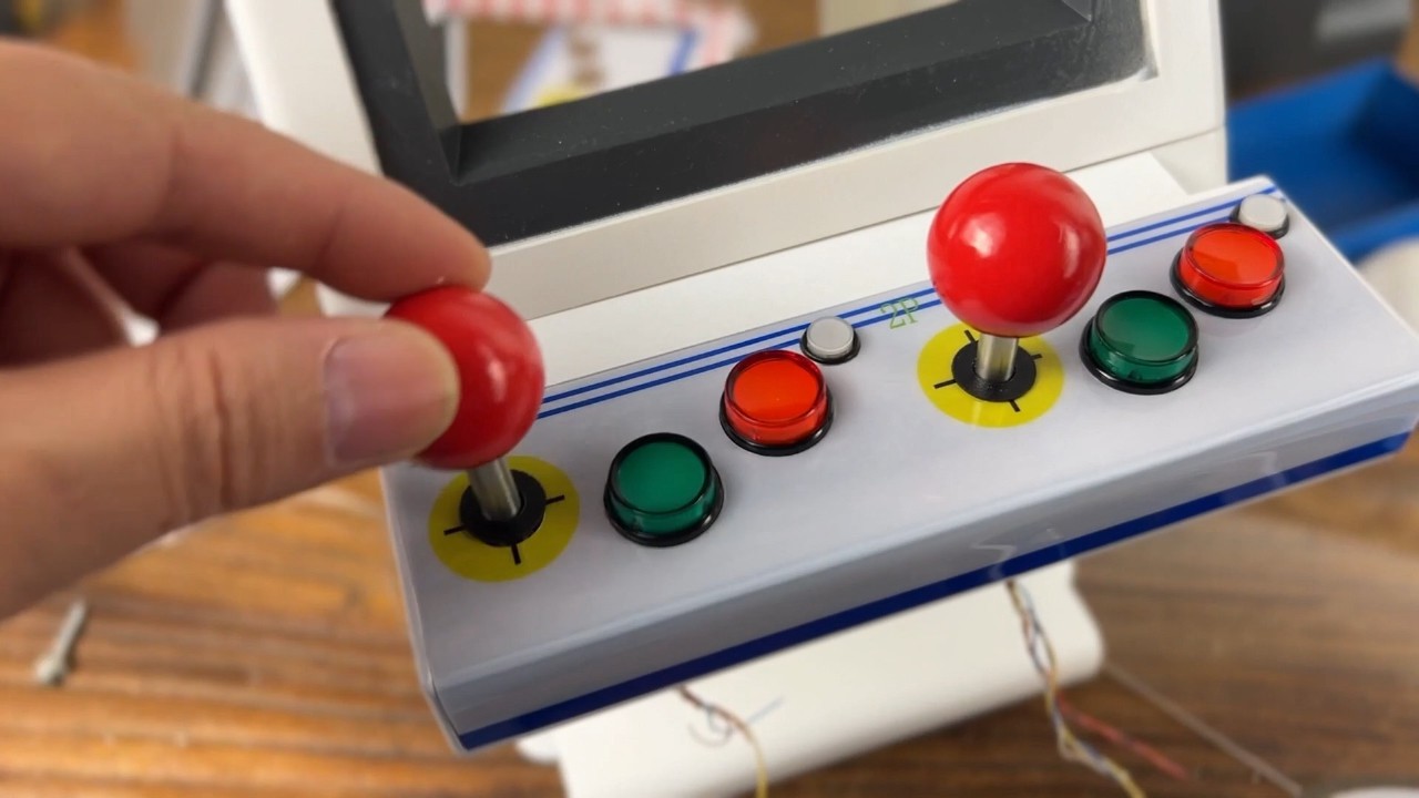

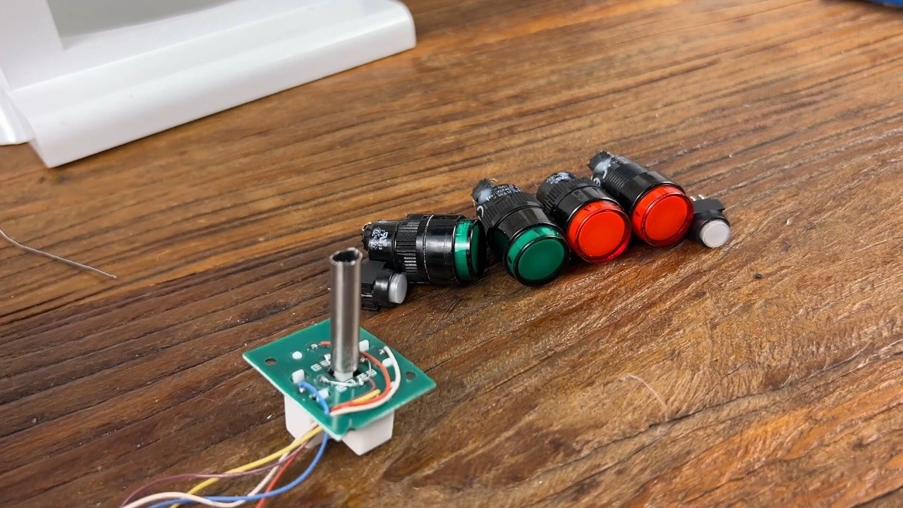

For the joystick, I adopted the physical joystick structure of the SNK handheld game console.

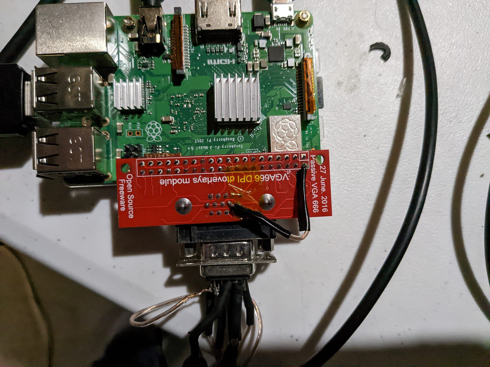

The Raspberry Pi is connected to the VGA666 to output RGBS signals.

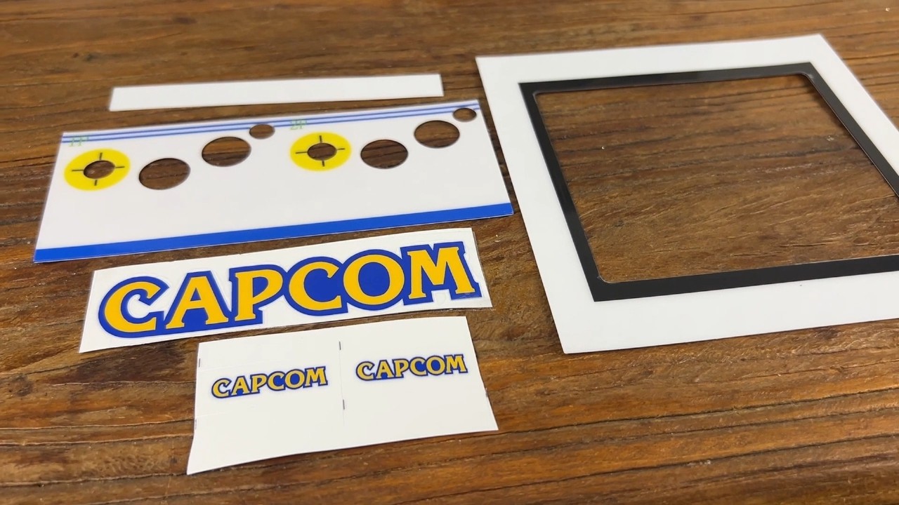

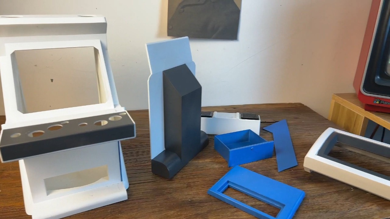

The shell was printed by light curing and stickers were also designed.
