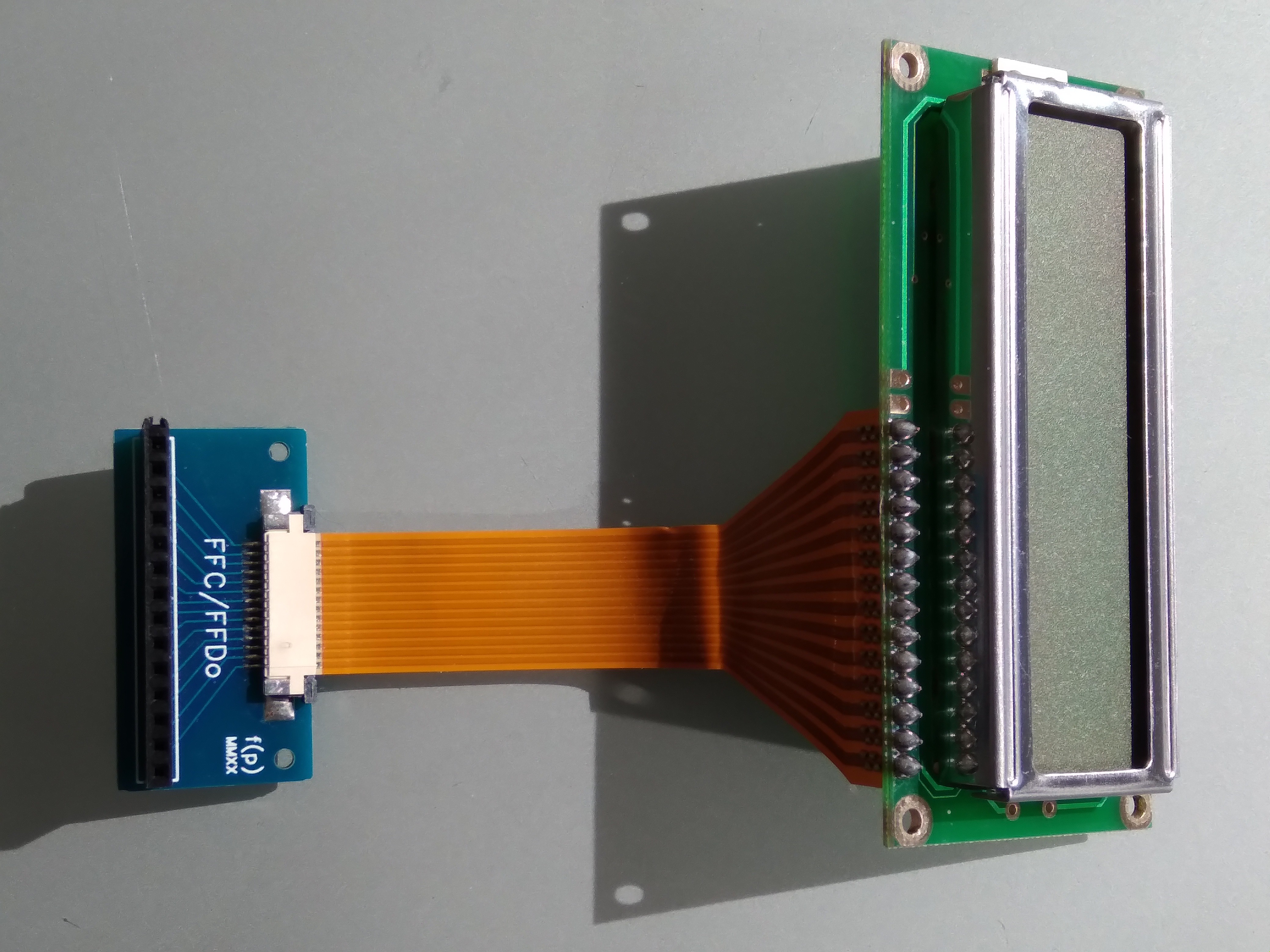

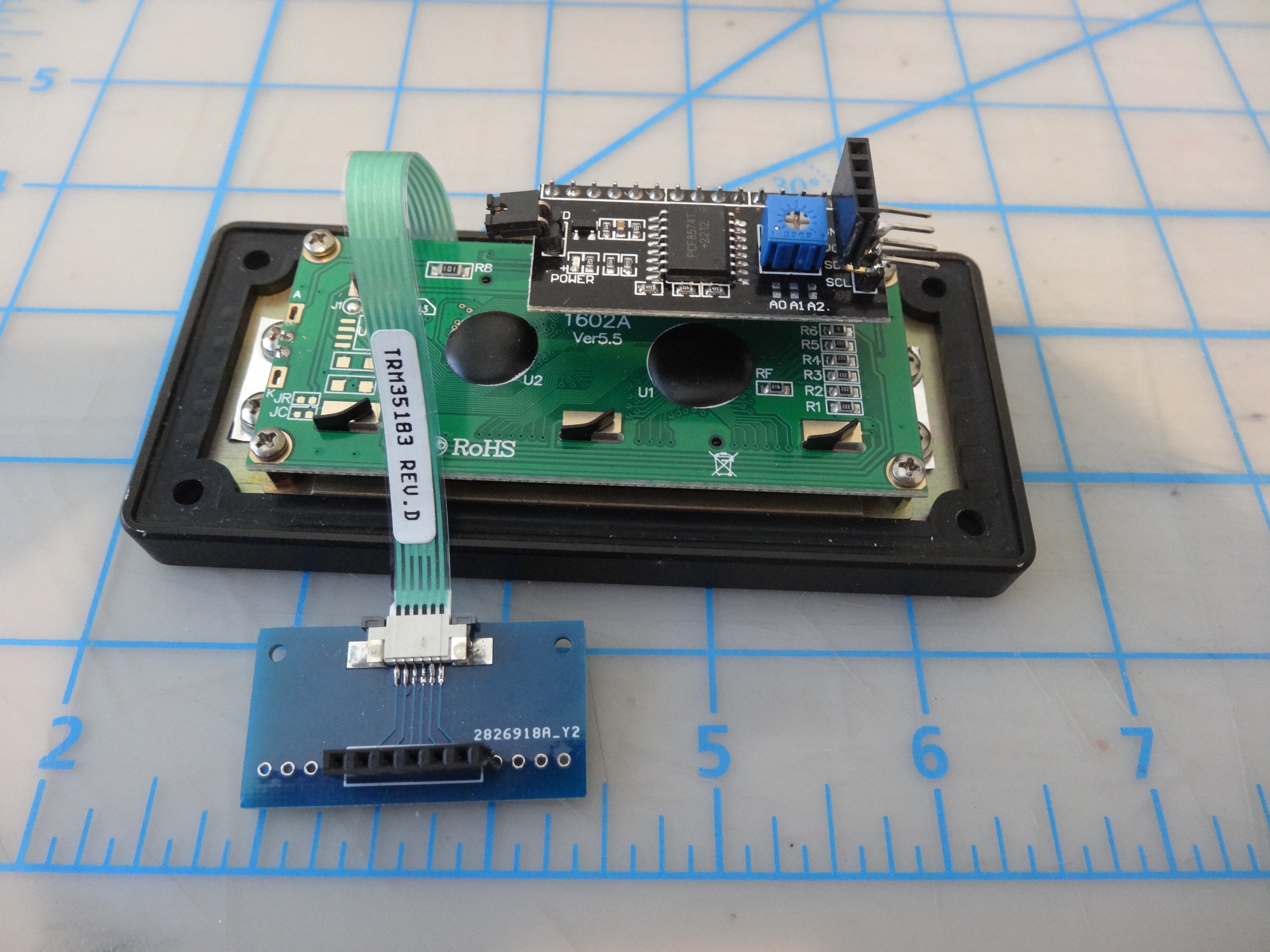

The unit had 14- and 6-conductor Flat Flexible Cables (FFC) to the 2x16 char LCD display and membrane keyboard, respectively. I made a small breakout board so I could try interfacing with them. The board has pads for an SMD FFC connector and standard header strip, 6 pins (kbd) on one side, 14 pins (display) on the other (I used two boards). See Gerber_FFCBreakout.zip in the repo.
The keyboard was trivial, a pin for each key and a couple of Grounds. But I could not get the display to work despite much effort. So that’s where it sat, for a long time. When I came back to it, I discovered the HD44780 display is actually a standard part and fit the original mounts, so I bought one (like this) but yellow to match the original and an I2C backpack, to keep the pin count down.

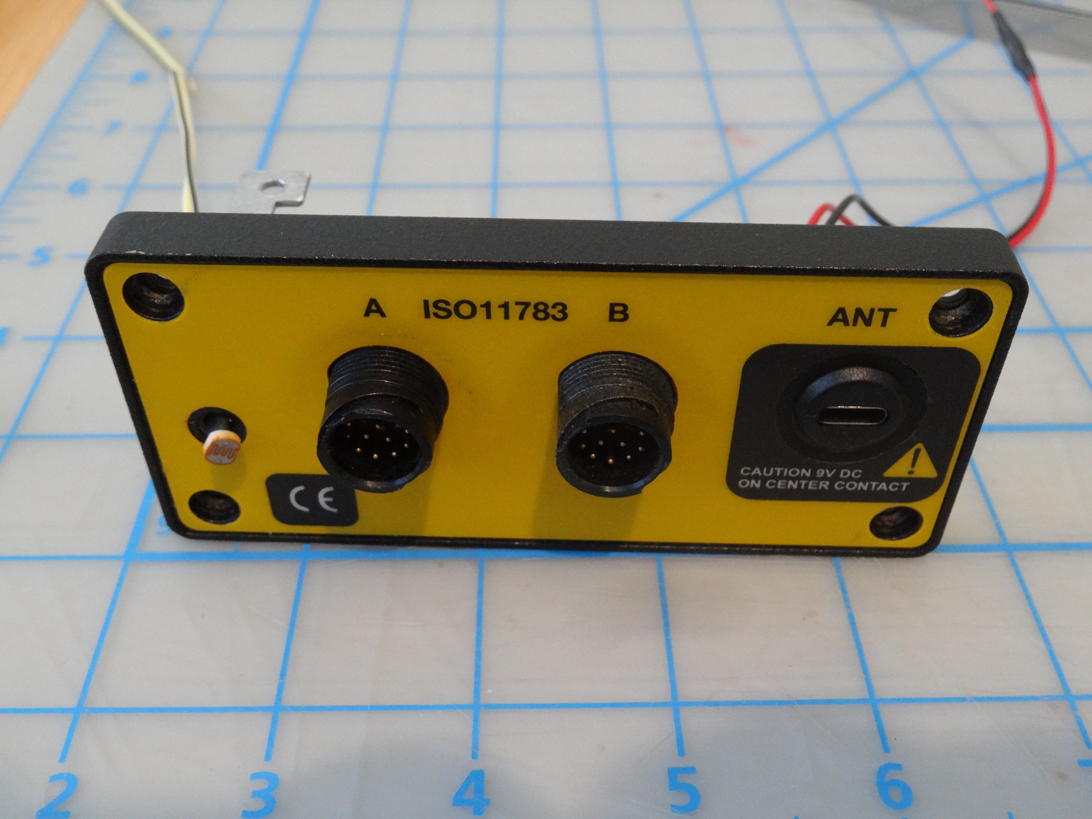

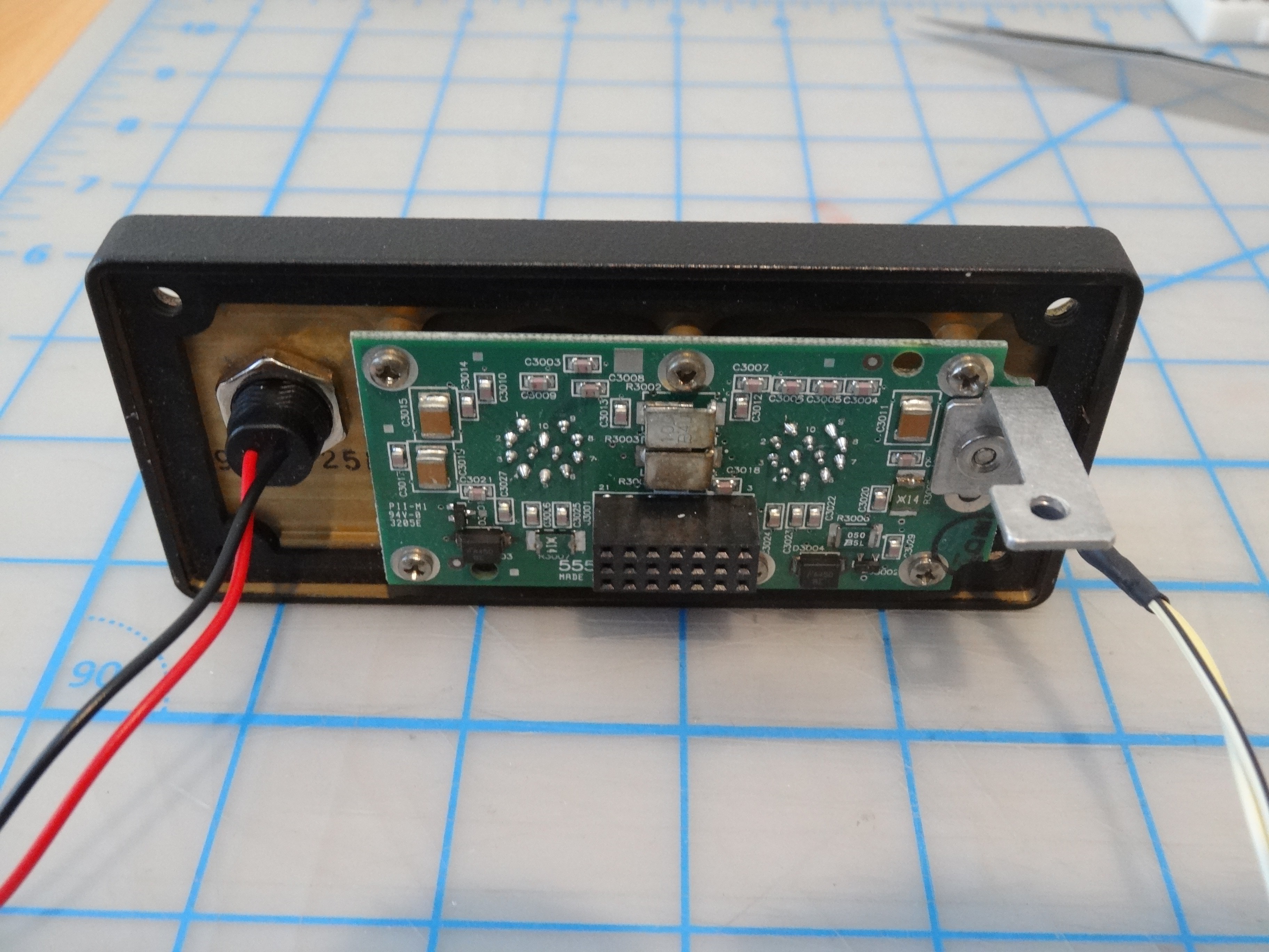

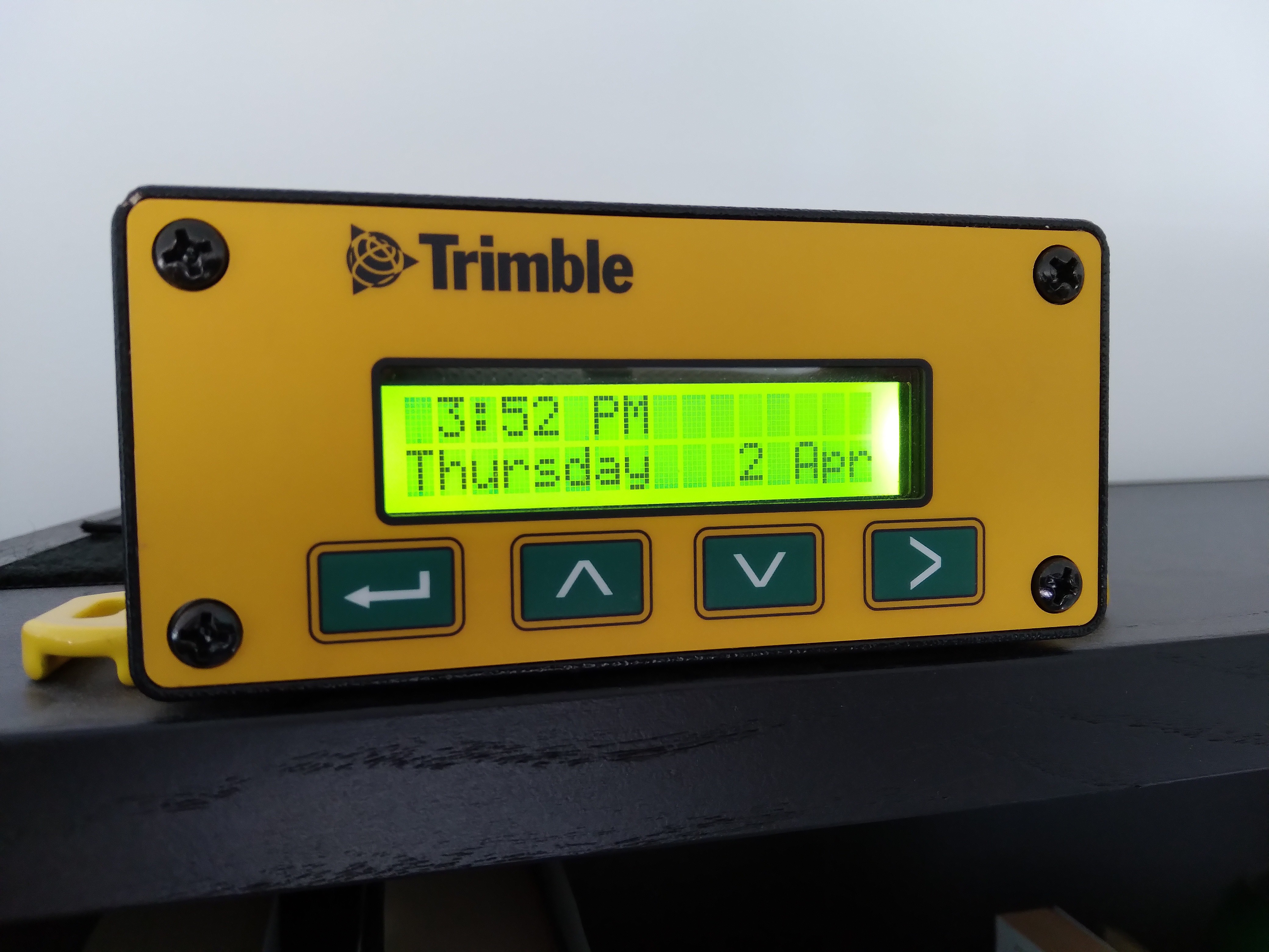

The sketch (on GitHub) runs on a Leonardo Tiny Atmega32U4 board. Dedicated I2C pins go to the display and RTC breakout. Four Digital pins go to the four keys and an analog pin goes to an LDR which turns the display off at night (it’s bright). The LDR pokes out the back through the vent hole (left) and I found a USB-C socket which fit where the antenna feed went (right).

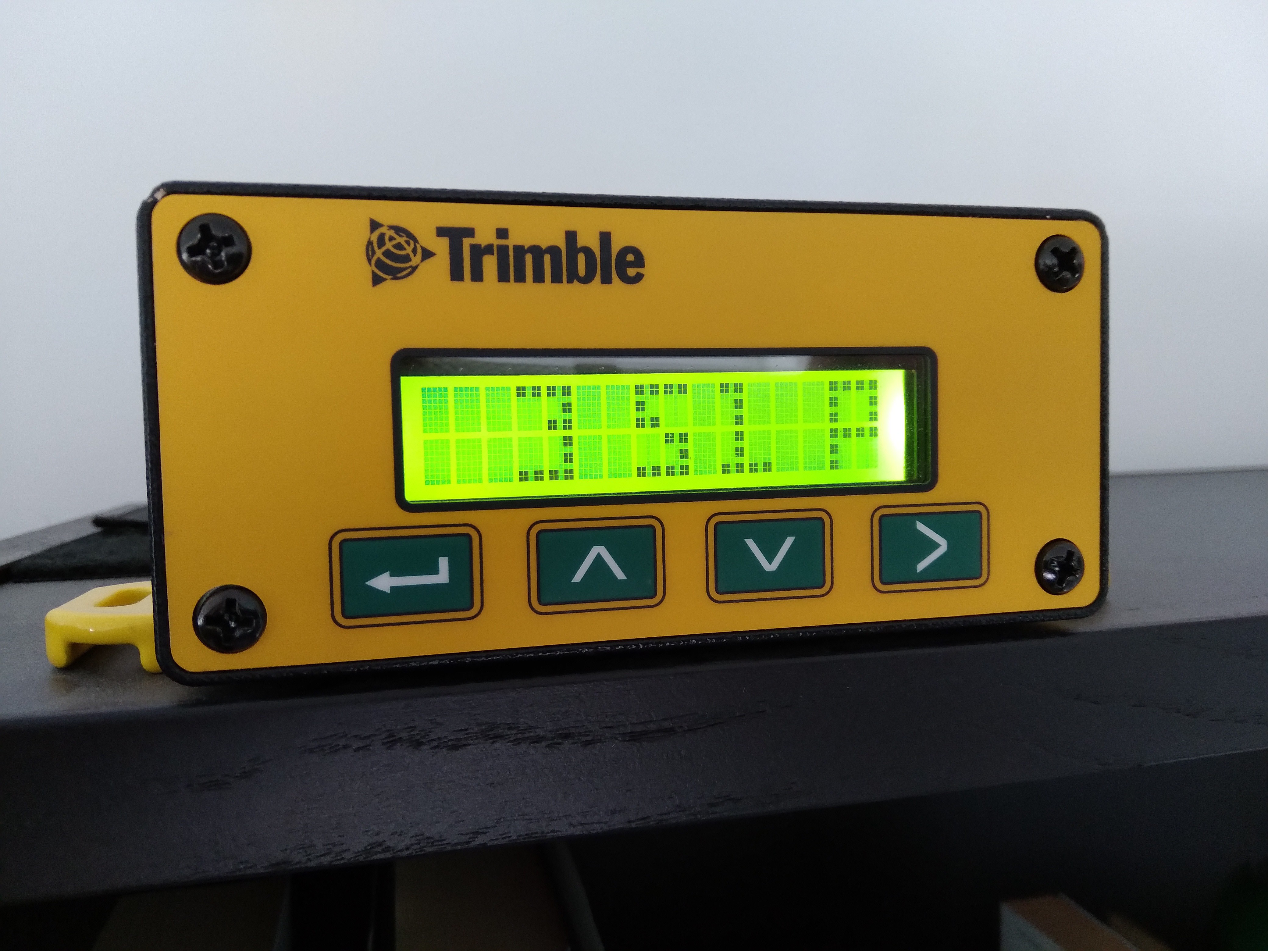

The clock is pretty straight forward but has several "faces".
"Default" is time and date as normal characters

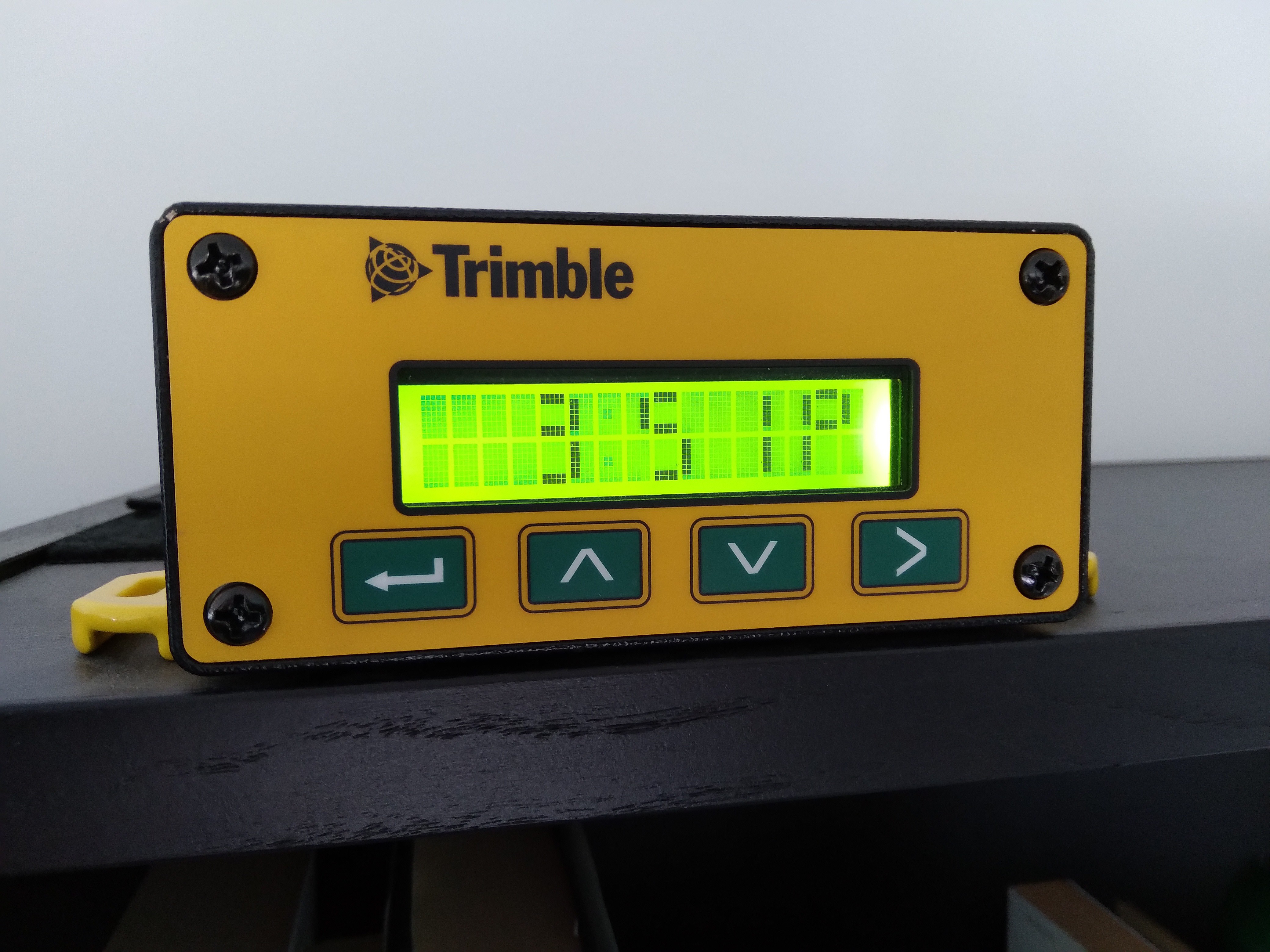

"Tiles" uses large characters formed from custom chars to show just the time, double-height
"Segments" is like tiles but with a 7-segment look

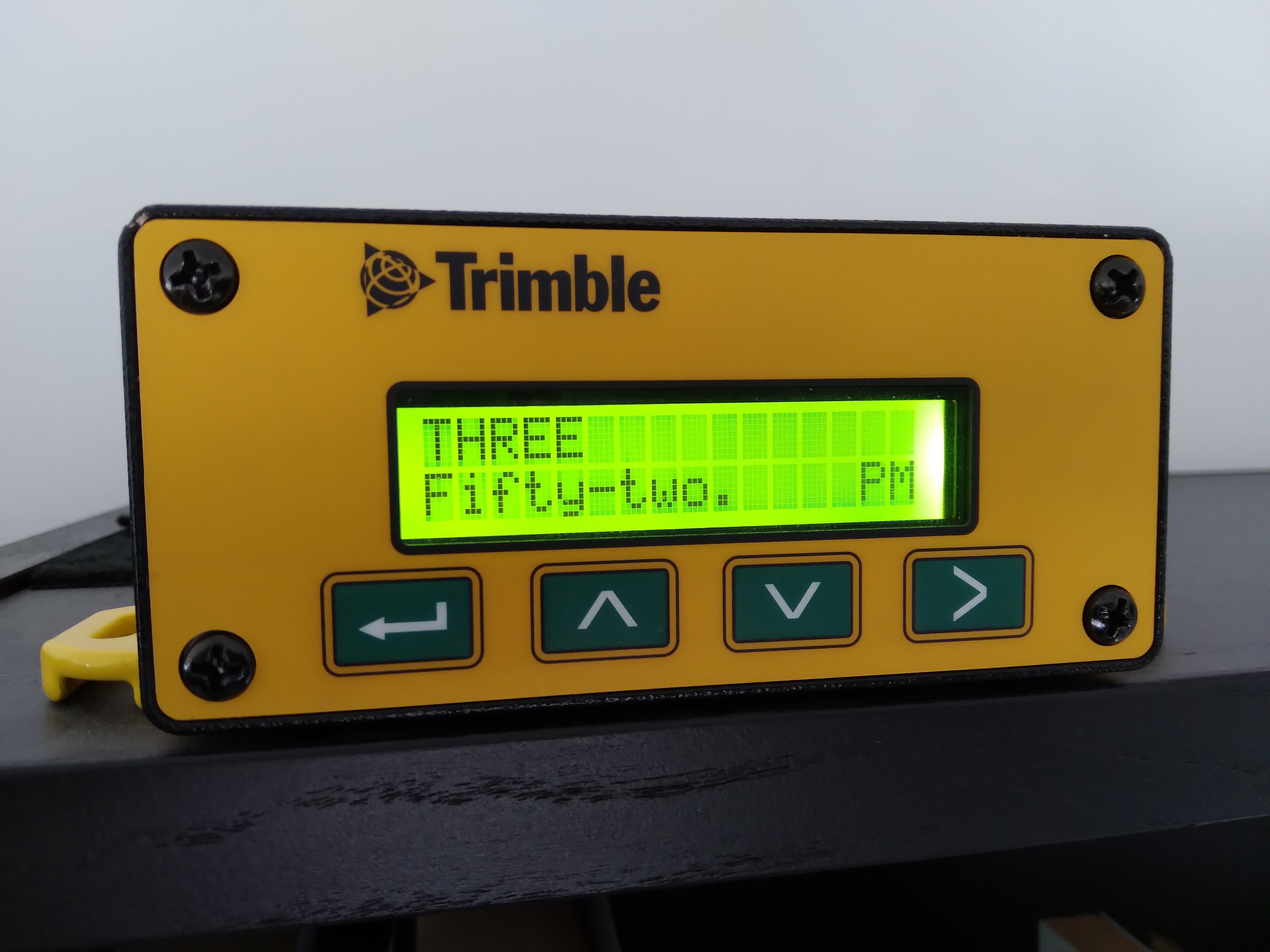

"Words" shows the time in words
There's also an experimental "Bar" face.
The Enter key configures the time & date, Up toggles Daylight Savings, Down over-rides the backlight status and Right cycles through the faces.
