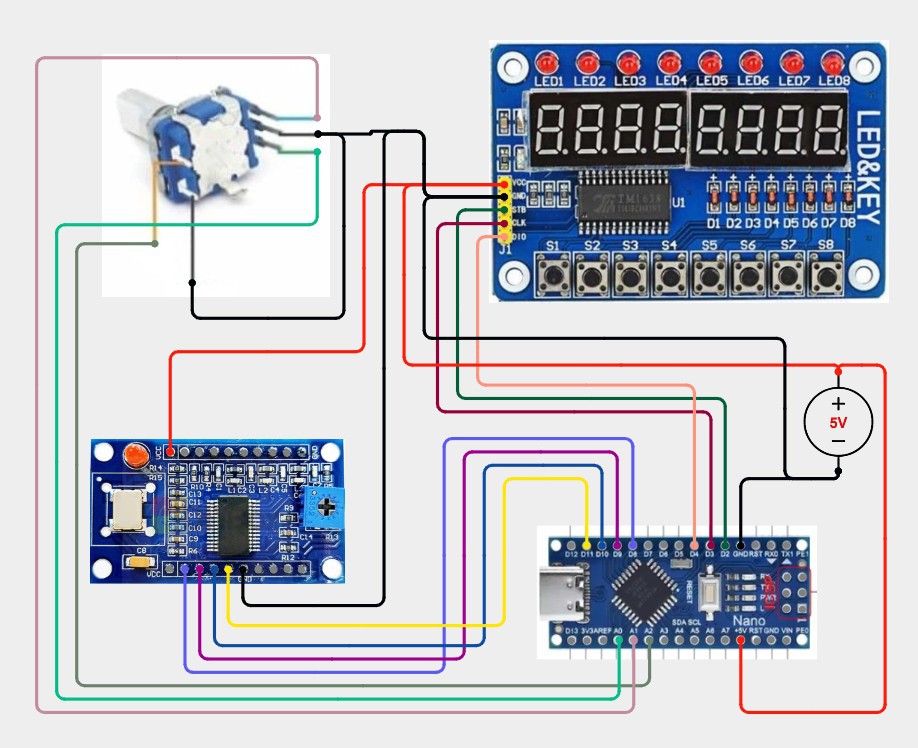

 - fst, there's the AD98500 module,
 - Arduino Nano microcontroller board,
 - a rotary encoder,
 - and the previously mentioned TM1638 module.
You can see two more components mounted on heat sinks and an additional assembly with two transistors on the PCB. The assembly is a Buffer Amplifier that raises the signal level from 1 to 5Vpp, this one is an LM317 stabilizer and provides 9V for the buffer circuit and the other one is a 7805 linear stabilizer through which the AD98500 module is powered. I made these additional modifications for the needs of one of my devices with special requirements, otherwise the assembly without these modifications is quite sufficient, using a direct 5V power supply. You can also see the schematic of the buffer amplifier below.

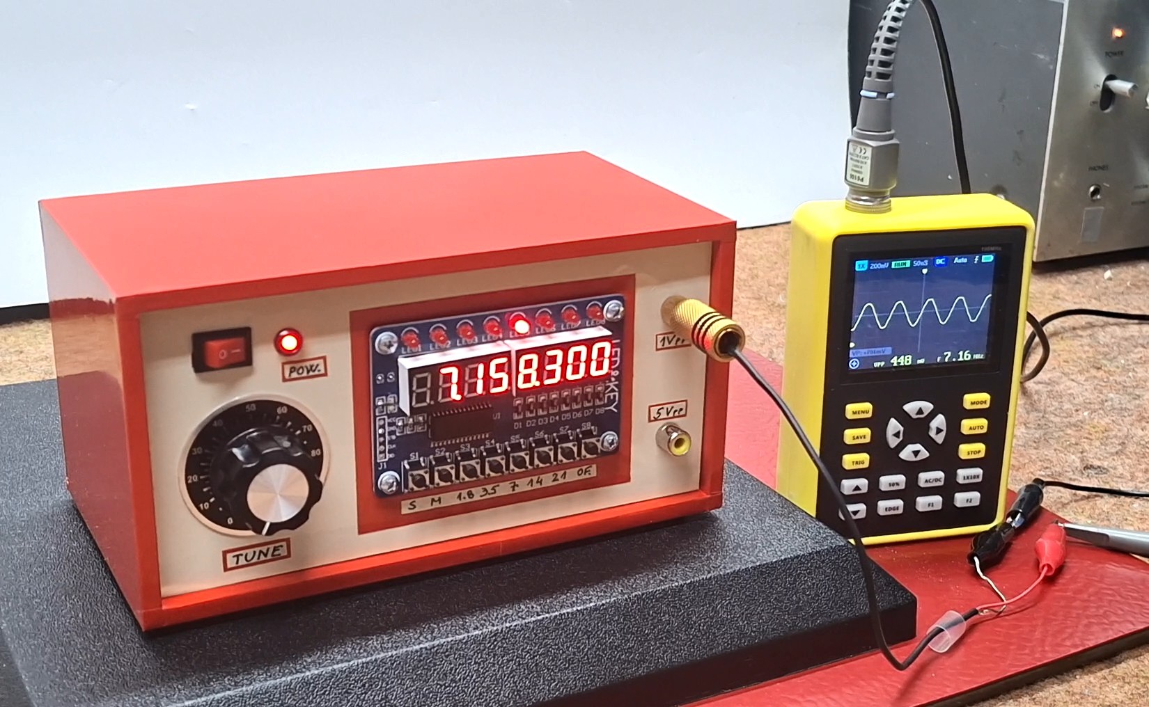

  Now let's see how the device works in real conditions. Immediately after turning on the display shows the default frequency that was previously entered in the code. With the rotary encoder we can change this frequency in steps of 1kHz. On the first button we can change this step to 10Hz 100Hz 1kHz, 10kHz and 100kHz. On the second button the modulation type AM, USB, or LSB is changed. The next 5 buttons are used to directly activate one of the 5 most used HF Bands successively. (1.8, 3.5, 7, ....). It is important to note that we can continuously change the frequency from one band to another, so this also includes broadcast frequencies. The last button has a function when using this VFO with Superheterodyne receivers with an IF of 455KHz. Namely, by activating this option, the actual output signal is 455KHz higher than the one shown on the display. The eight LEDs at the top, signal which of the options is currently active. Another very useful feature is the ability to change the intensity of the display and LED lighting. By pressing the encoder button we enter a mode where the display brightness can be changed from 0 to 100%. This is very useful in conditions of work at night, which is the most common case in reality.
  To verify what I've said so far, we'll connect the output of this VFO to an oscilloscope to see the shape of the signal.
  And finally a short conclusion:The AD9850-based VFO provides a clean, sine-wave alternative to square-wave oscillators, ensuring your HF receiver remains free from unwanted harmonic interference. With the TM1638 interface, it offers a functional, retro-styled control center perfect for any homebrew radio build.
