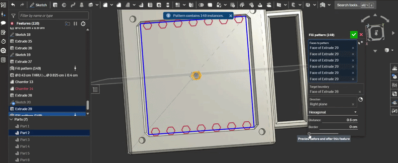

I started working with OnShape mainly because it was free and cloud-based, I quickly became familiar with the main controls and functions, translating all my (wordefully) hand-drawn designs to a virtual 2D sketch that later became an actual 3D model.
Printing plastic for me holds great responsibility.
Every print has its own cost, both in terms of energy consumption and plastic waste, for this reason, I tried to test every part in software before using PLA filament, carefully ensuring clearances and assembly process to avoid any unnecessary print.

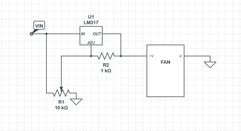

The control circuit is fairly simple, the main component is the LM317 an adjustable voltage regulator extremely common given its versatility.
It is commonly used in combination with two resistors with fixed values to adjust the output voltage in a fixed voltage regulator configuration.
To have a smooth control over the voltage regualtor we are going to swap R2 with a potentiometer (P) with a resistance value that goes from 0 ohm to 10K.
LM317 recycled from old circuit board
This is the basic circuit you'll need to make the extractor work:

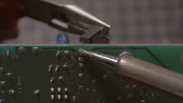

I've added a couple of decoupling capacitors and a reverse polarity protection diode near the input voltage connectors, I was able to recycle all the componets from an old board.

For the filter container layer I used an hexagonal pattern structure to avoid the obstruction of airflow while mantaining significant structural integrity.
