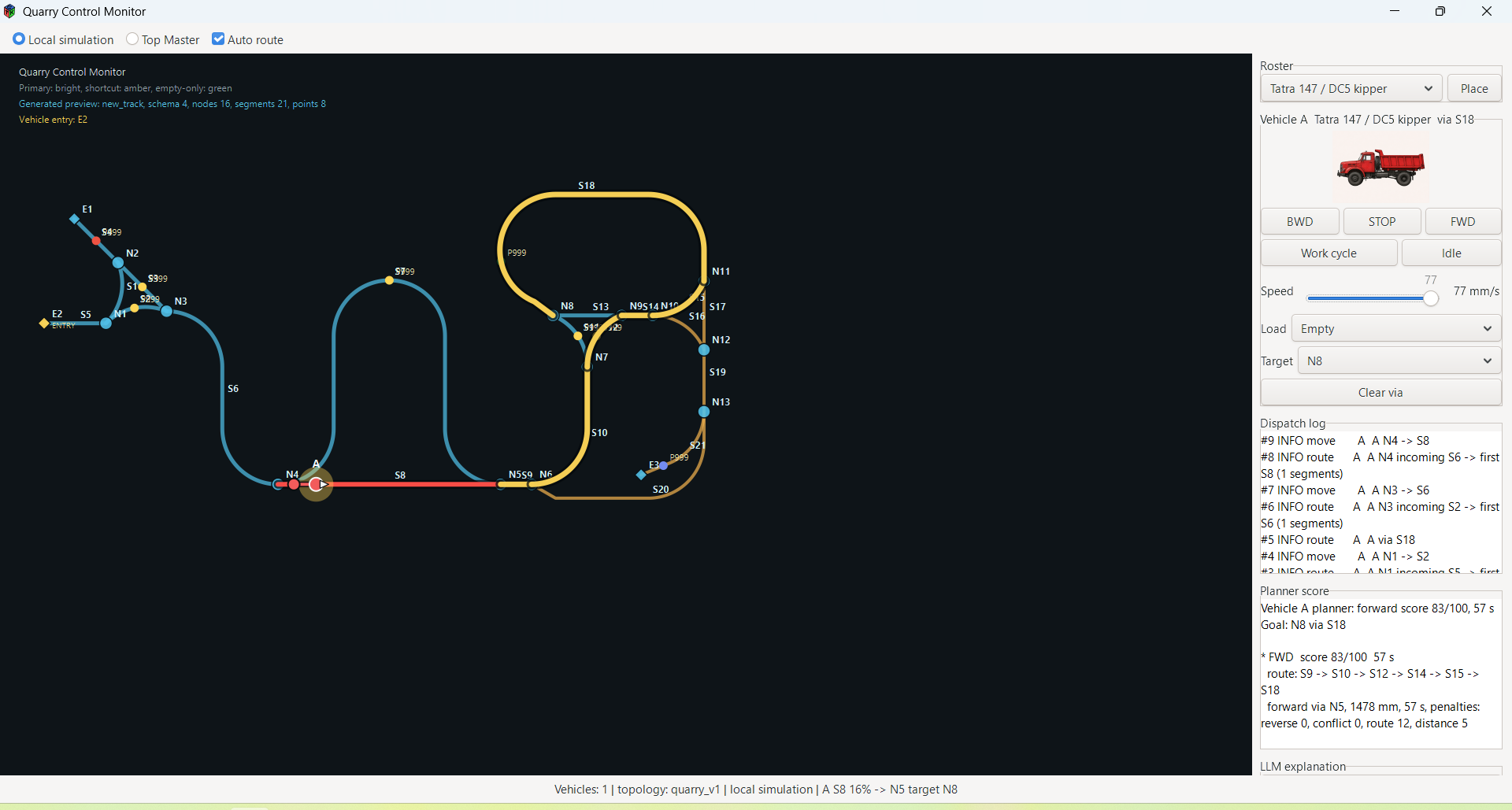

The Control Monitor is the second part of the system. It is a separate C/GTK application that loads the data generated by the editor and uses it for simulation, visualization, and debugging of traffic.
The editor creates the track.
The Control Monitor operates it.
The monitor can display the track topology, vehicles, planned routes, occupied and reserved segments, the dispatch log, planner score, and other information. It can simulate vehicle movement without real hardware and verify whether the route logic matches what was designed in the editor.
The screenshots show the Control Monitor with a quarry route, a Tatra 147 / DC5 tipper, route planning, and the debug panel.
