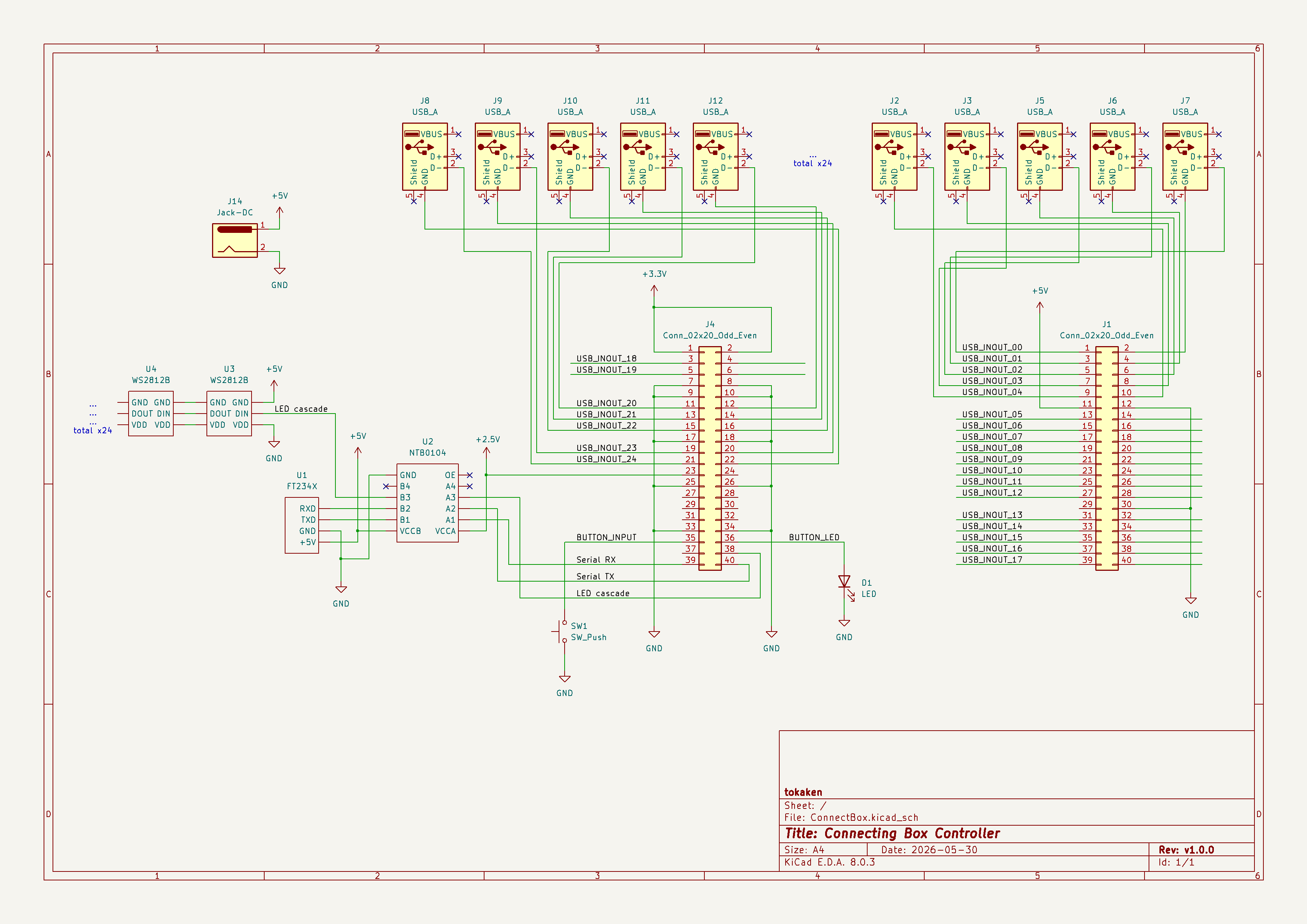

The controller consists of 24 USB ports, 24 LEDs (each USB port and LED are arranged as a pair), and one button.

Why Can the Controller Detect Connections?
This controller detects when connectors are connected to each other. At first glance, this seems easy to implement. But is it really? How do you think this controller is implemented? Imagining and predicting how something works is very important in making things.The requirements this controller needs to satisfy are listed below.
- It can tell that a connector is not connected to another connector.
- It can tell that a connector is connected to another connector.
- If a connector is connected, it can identify the number of the connector it is connected to.
Unless these three requirements are satisfied, this controller cannot be implemented.
If we think about it simply, when a cable is connected, two points become electrically connected, so it may seem possible to implement this function by detecting that. However, doing so would require a huge matrix switch, probably. This is not very realistic. Complex wiring makes creation and modification difficult, which increases the difficulty of the project. In the first place, I feel like there would not be enough microcontroller I/O pins.
So, What Do I Do?
We loosen the previous requirements a little.- It is enough to be able to detect whether two specified ports are connected.
It is not necessary to detect connections between those two ports and any other ports. - These two ports can be changed dynamically.
To implement this, I used an FPGA. The reasons are as follows.
- The direction of the I/O can be changed dynamically.
- There is a reasonable number of I/O pins.
A USB port consists of four wires, and one of them is used as a communication line. The communication line has either an INPUT or OUTPUT direction, and this direction can be switched dynamically.
- In OUTPUT mode, the port continuously sends its own port number via serial communication.
- In INPUT mode, the port waits to receive data via serial communication.
At this time, when an INPUT port and an OUTPUT port are connected by a cable, the INPUT port can recognize the data from the connected OUTPUT port. Since the OUTPUT port is sending its own port number, the connected port can be identified. This mechanism only works when an INPUT port and an OUTPUT port are connected. The relationships are shown below.

Controller Circuit

- Each of the 24 ports has serial communication transmit and receive functions.
- Each port’s serial communication transmit(OUTPUT) and receive(INPUT) modes can be switched dynamically.
- From the game side(PC), a pair of ports is randomly selected as a phone request. One is set to INPUT and the other to OUTPUT, and their LED colors are set.
- If those ports are connected by a USB cable, the INPUT receives the serial communication from the connected OUTPUT, and that information is sent to the game side(PC).
- On the game side, the PC recognizes that the ports have been connected and performs score calculation and other processing.
- Return to step 3. until the time limit ends.
