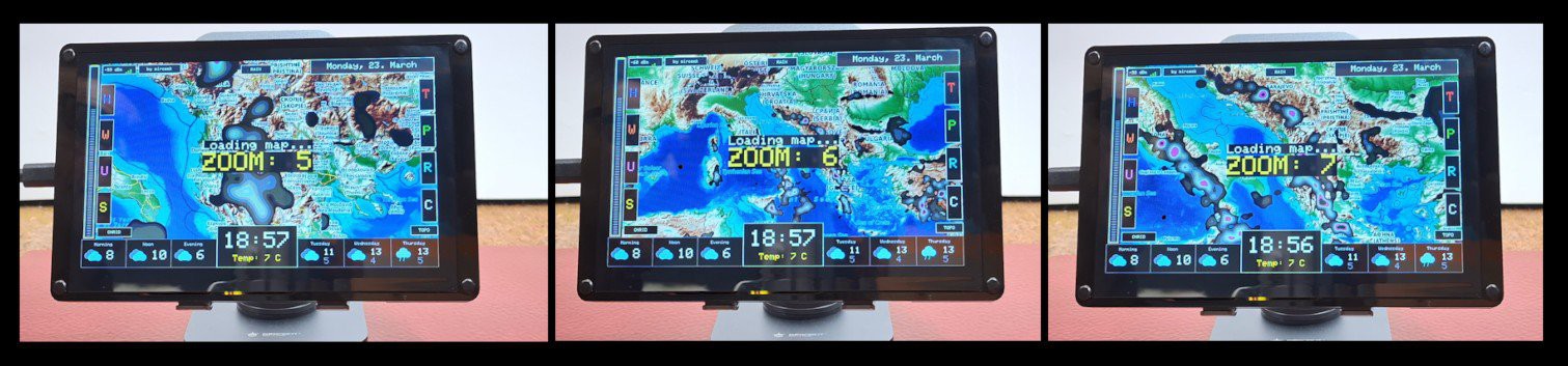

  The most interesting part follows, a description of how it works and a demonstration of all functions and options. By turning on the module, the message "connecting to internet" appears, and then "connected". This is followed by the "Loading map" message, which takes a little longer for the following reasons: The map and the map layers are composed of 6 individual squares that are merged into one complete image. Those 6 small images are downloaded compressed and then decoded with the PNGdec library. So the map image that we see on the display is composed of 6 smaller images - two rows with 3 images each. With each update, change, or restart, the same operation is repeated. So, on the display, in the center, there is a part of the map according to the coordinates entered in the code.The exact location of the entered coordinates is marked with a red marker and is drawn last above both layers so that it is always clearly visible. There are three zoom levels 5,6 and 7 and the default is 6.

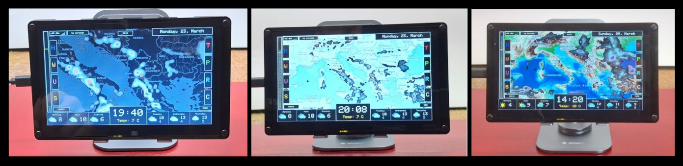

By pressing the middle of the display, these 3 zoom values are changed. The default background map is DARK, and by pressing the clock we can choose between the three modes DARK, TOPO, or OPENSTREAM map.

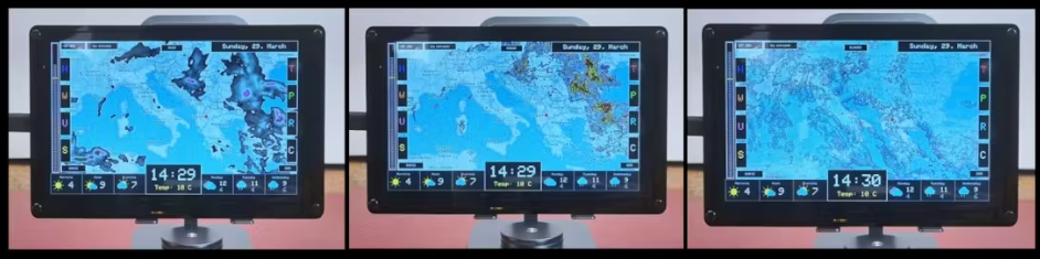

And the meteorological part, which is represented by three different layers drawn above the map. These are the RADAR, CLOUDNESS, and RAIN PROBABILITY layers. They are selected by pressing the rectangle at the top in the middle.
The dark background map is the simplest but also the most readable in terms of interpreting the meteorological condition. The topographic map is the most visually impressive, but it is a little more difficult to determine, especially the RADAR layer. In particular, I most often use the DARK map.

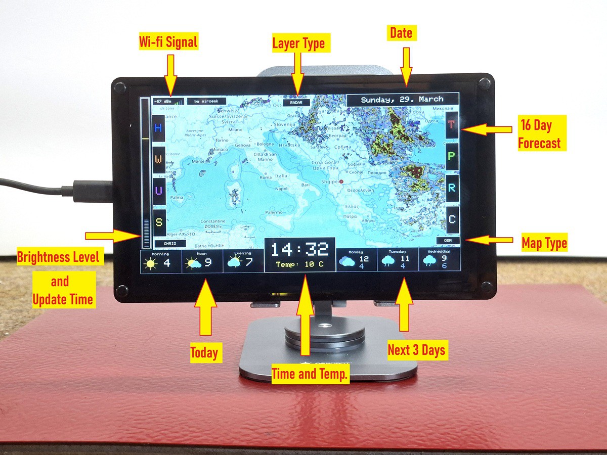

   Now let's move on to the other functions and accessories. At the top left is the strength of the Wi-Fi signal received by the device, as well as my nickname, in the middle the meteorological layer above the map, and at the very top right is the current date. At the bottom left is the name of the Location marked with the marker, and on the right the type of the background map. At the bottom in the middle in a large rectangle there is a clearly readable clock and the current temperature in yellow. To the left of the clock is today's forecast Morning, Noon, and Evening with the predicted temperature, and on the right is the forecast for the next three days with the predicted minimum and maximum temperature.
The weather condition is displayed with 7 types of appropriate icons, namely: Sunny, Partly Cloudy, Mostly Cloudy, Cloudy, Rain, Heavy Rain and Snow. On the far left of the display is a vertical bar with two functions: The weather information is updated every 10 minutes. In this bar, one small bar is drawn upwards approximately every 5 seconds, so it takes 10 minutes for the entire bar to fill. The filling of the bar actually shows the time that has passed since the last update. The other function is the regulation of the display backlight, either continuously or in steps. The yellow bar shows the current brightness level.

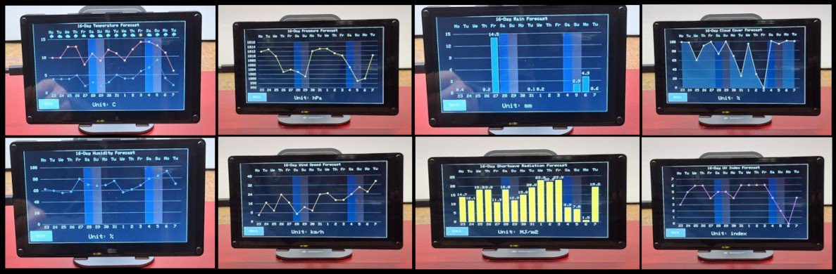

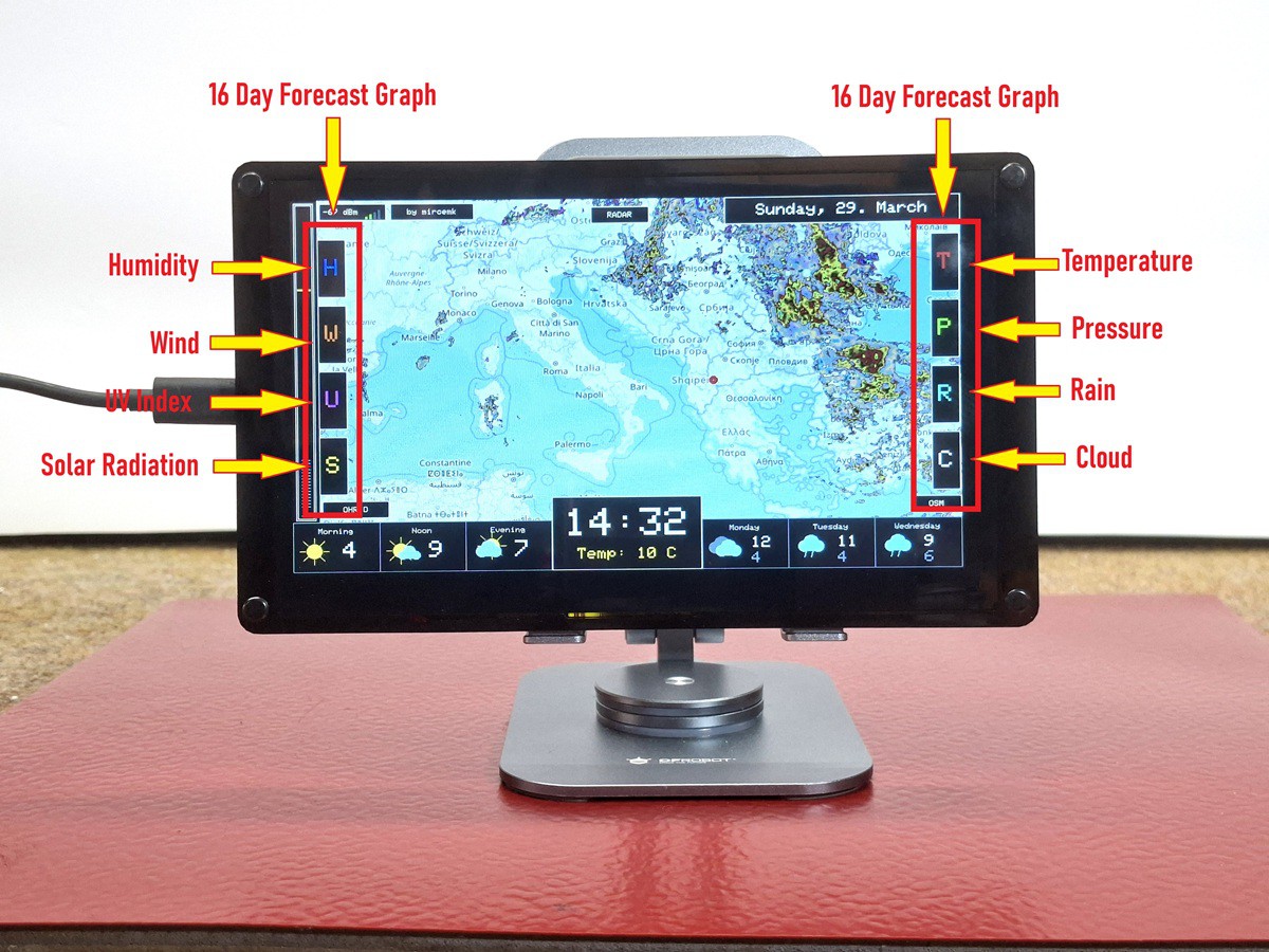

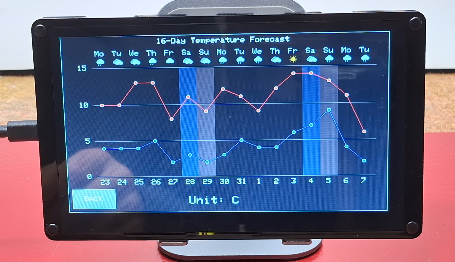

 The remaining eight rectangles with large colored letters on both sides. They actually represent a 16-day forecast for different weather conditions. By pressing the square, the corresponding 16-day graph opens. The first T shows the minimum and maximum predicted temperature for each day, as well as the general weather condition represented by an icon. The forecast type is written at the top (in this case, temperature), immediately below it are the Days of the Week, and at the bottom under the graph the corresponding date. On the left side (the Y axis) are written the values, which are automatically adjusted depending on the minimum and maximum values (resizable).
For greater clarity, the days of the weekend are marked with pale colored vertical bars. On the far left is the BACK button, and at the bottom the corresponding unit. With BACK we return to the main screen, and each button has a corresponding graph.
