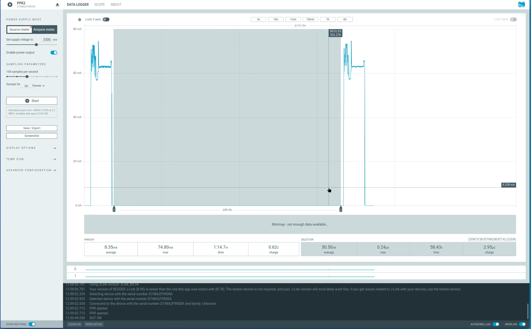

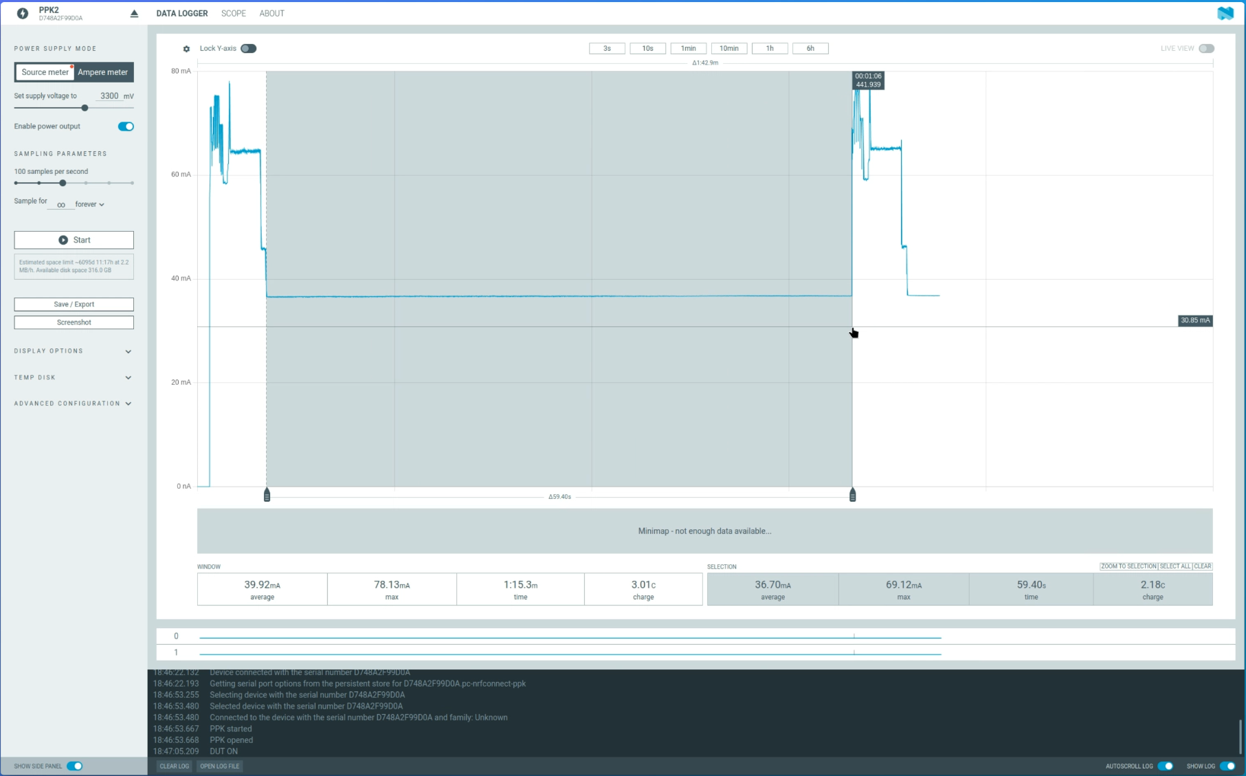

- Idle consumption with deep sleep mode: 36,7mA
- Idle consumption with this module: 50nA
734.000 times less idle consumption!
Demo note at the bottom.
| Sleep mode | PowerTimer |

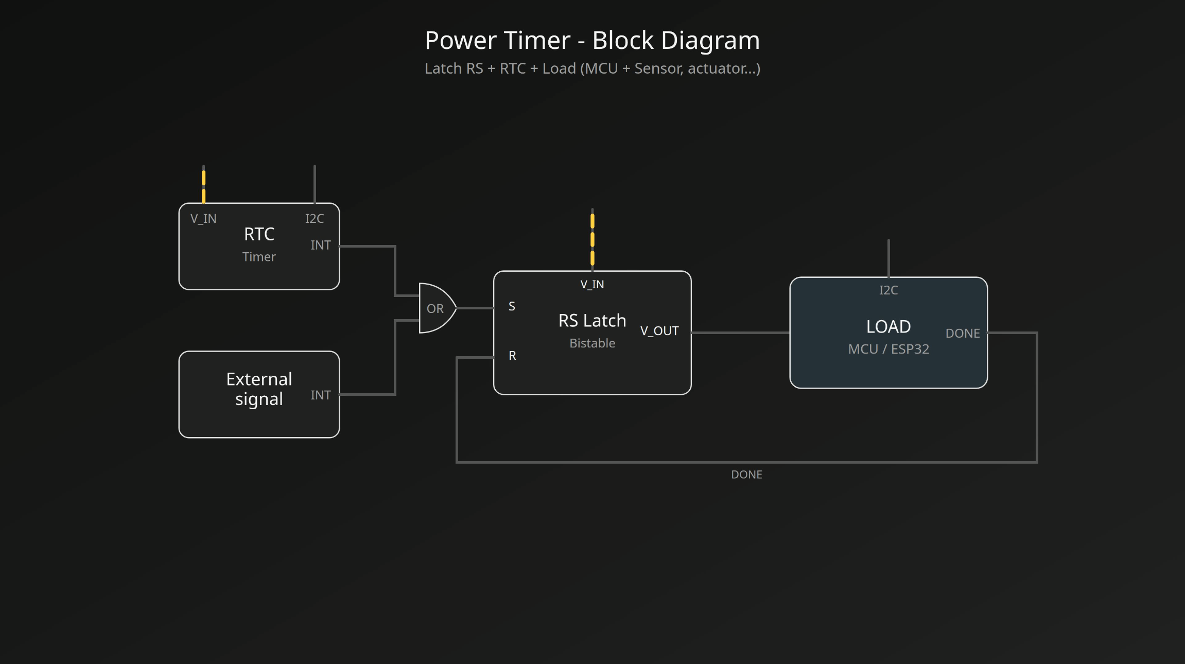

The idea is as follows:
The latch provides energy to the MCU, sensors, and modules. We do some processing; once it's done, we program the RTC and raise the DONE signal. When the RTC alarm triggers, it sets a high level to the SET pin and starts the cycle again. On the other hand, if we have an external module, we could have asynchronous wakeups based on specific conditions.
The architecture is the following:
- Latch R/S: This block manages the energy, allowing it to be provided or cut. Since it's a quite classic circuit, I've decided to implement it manually using passive components and transistors. This implementation is cheaper and allows for fine-tuning the consumption.
- RTC: This component is key because it's on all the time, so I needed to find something very efficient. I've chosen the RV3028-C7. This RTC has a consumption of 45 nA, allows three separate types of events: timers, alarms, and external interruptions (not implemented in this part).
- OR gate with diodes: I don't know if it's some kind of consumption paranoia, but I've implemented a simple OR gate with diodes to connect the RTC interrupt output, a button, and a possible external interruption.
