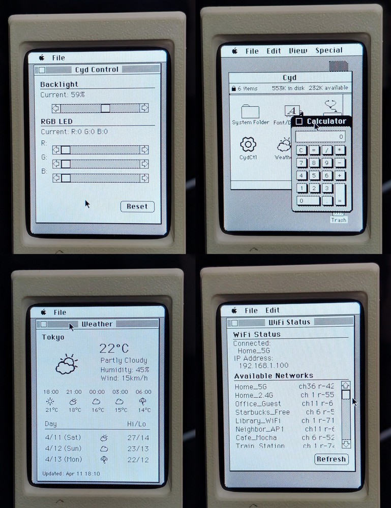

A Macintosh Plus emulator port for Cheap-Yellow-Display board (ESP32), with some little 68k Mac applications. A umac port for ESP32 = System 3.3 with WiFi Connectivity.
- Macintosh Plus emulation using umac and Musashi 68k emulator
- 240x320 LCD with touchpad emulation for mouse control
- *Homebrew* Mac applications built with Retro68 (Weather, WiFi status, etc.)

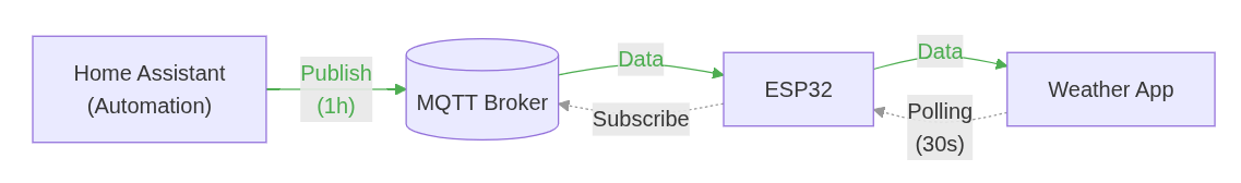

- IPC between Mac and ESP32 (WiFi scan, MQTT weather data)
