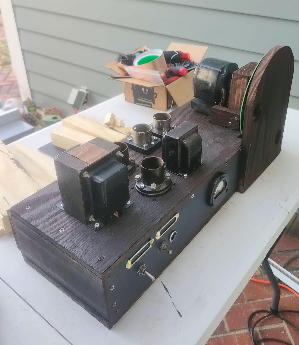

  • Cabinet Assembled
    Paul Kocyla05/04/2026 at 22:25 0 comments
    The cabinet is finished, and all the heavy parts are assembled.
    The neon bulb, lens fixtures and electrolytic caps are still missing - waiting for shipment, but overall the device is ready for being wired.

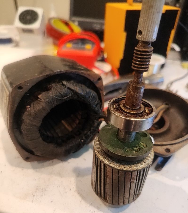

  • Motor Repair
    Paul Kocyla04/18/2026 at 17:12 0 comments
    I got two synchronous motors (see previous log).
    The most period correct model is seized.
    The bearings look OK, but the grease inside has hardened.
    I used flux remover to get them going almost instantly. Now I am rinsing the rotor in isopropyl alcohol.
    The inside looks undamaged - i will just wipe it clean from eventual rust particles and will not give it any other treatment.
    The windings measure good.

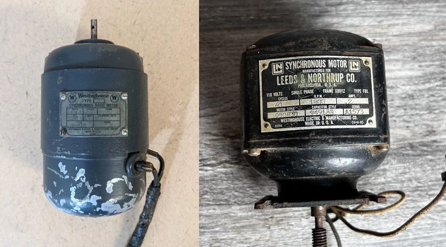

  • Motor Choice
    Paul Kocyla04/13/2026 at 12:51 0 comments
    Found out that Baird used synchronous motors after it's been proposed that the US should have a phase synchronized 60Hz grid.
    At first, the electricity companies didn't want to have an additional burden for zero benefit, but it's been adopted very soon, as it proved beneficial, because they could use the grid to compensate for failures and power lacks.
    I decided to go with a synchronous version for the first try. I was able to source two synchronous motors (however untested). The one on the right looks period correct (early 30s ?), the left one is a backup.
    Let's see if they work. It's the best substitute I can get, and it's what they were able to buy off the shelf back in the mid 20s.
    They will lock onto the 60Hz which will make things MUCH easier. However, you can't guarantee the phase at start. Depending on the number of poles (4,6,8), it might lock in a different position.
    I guessed this could be compensated for by either rotating the whole motor assembly (has been done), or by briefly interrupting the power supply for a quick moment.
    And yes, looks like Baird did that as well. There was a push button that the user had to tap a few times, until the motor locked to the correct phase.
    I found a picture where he uses a synchronous motor in his late 1920s setup that looks pretty much identical to the one on the left.
    Fingers crossed that those motors are OK, as finding an old synchronous motor of that type is not easy.
