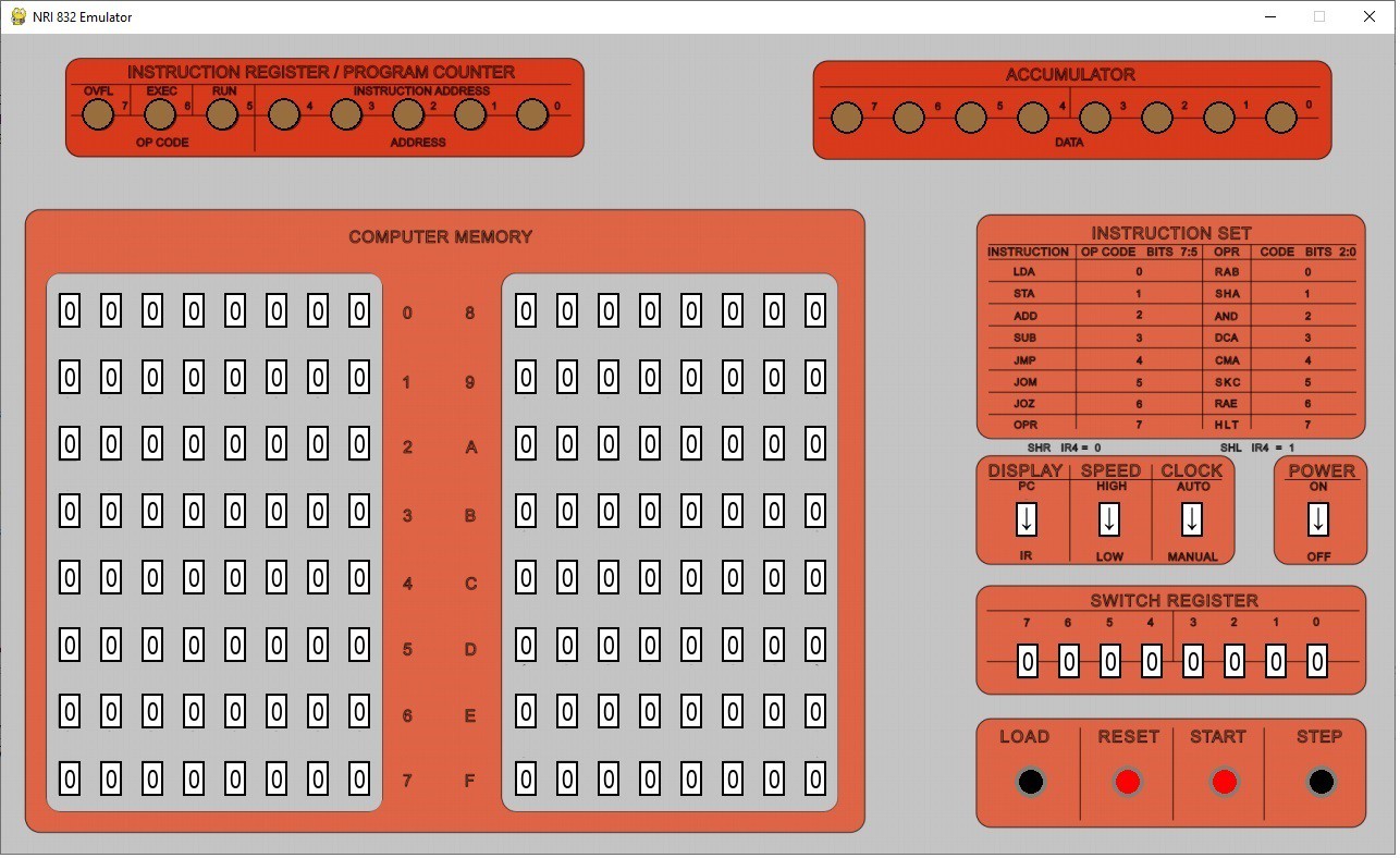

  • No Hardware Required
    Michael Gardi4 hours ago 0 comments
    I just finished a software only NRI 832 emulator.  I have posted the Python script and some documentation to the Files section of this project.
    Give it a try.
