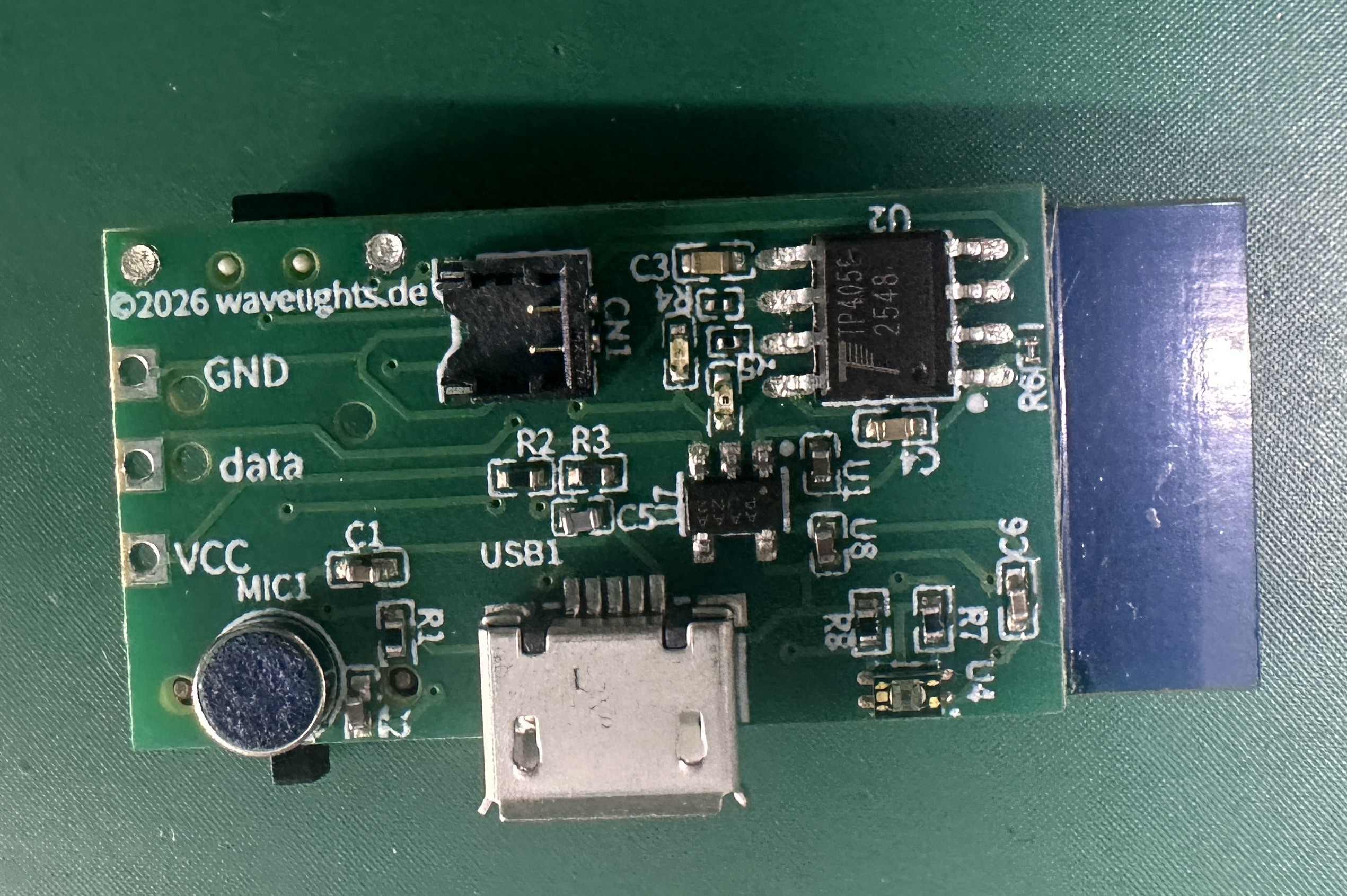

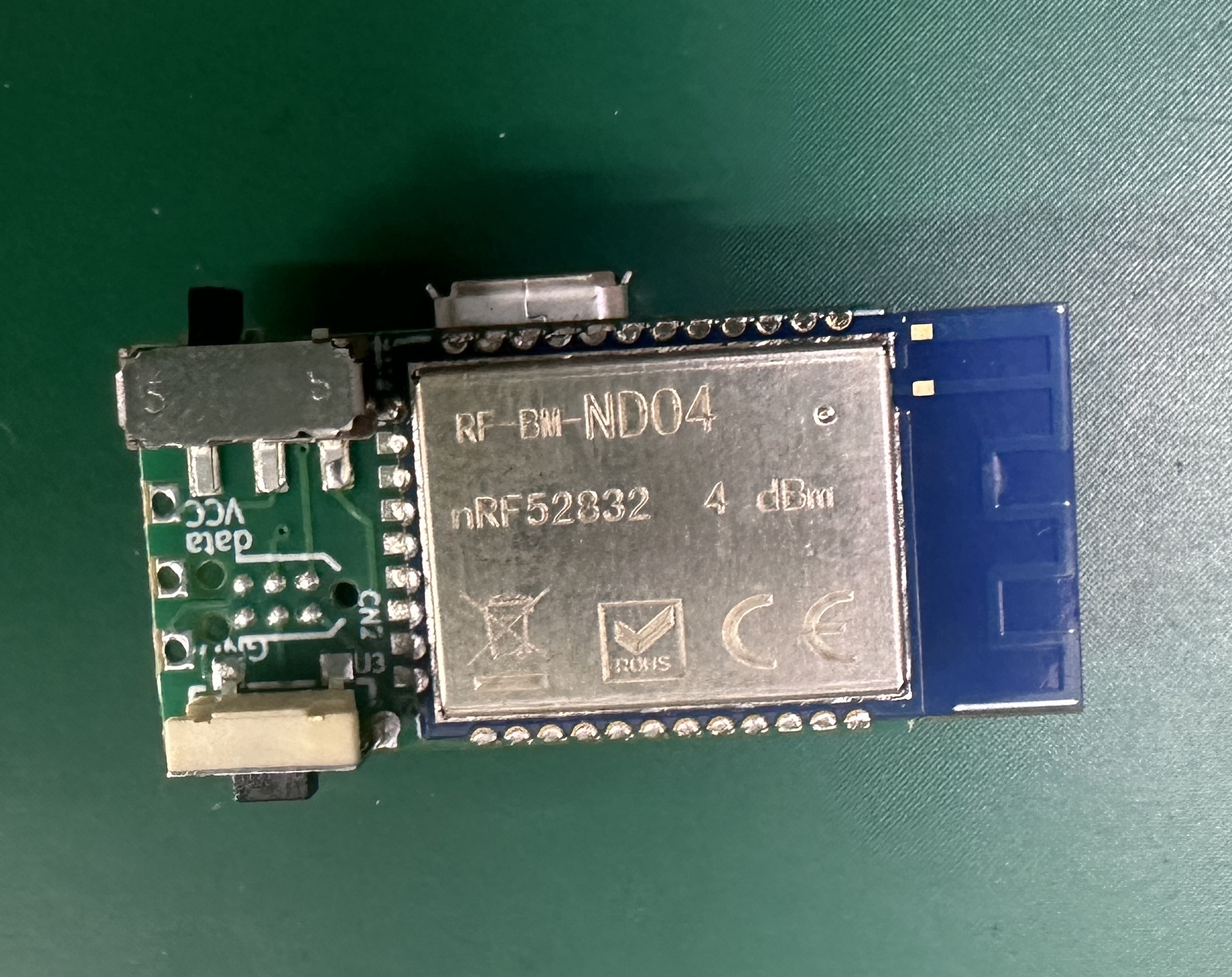

  • First production photos from the factory :: Gen3 PCBs are real
    Markus Loeffler • 05/22/2026 at 18:28 • 0 comments
    A milestone worth documenting: the first production photos of the Gen3 LumiBand PCB just arrived from Minewing, our PCB manufacturer and assembly house in China. Twenty units in the first batch.
    Seeing your own design come back from a factory fully populated is a different feeling from holding a prototype. Everything you agonized over in EasyEDA is suddenly real and physical.
    The module: RF-BM-ND04 Production uses the RF-BM-ND04, a compact nRF52832-based BLE module. Prototyping was done on an nRF52840 but the switch back to nRF52832 for production was straightforward: cost. The nRF52832 handles everything LumiBand needs at a significantly lower bill of materials cost per unit, and at festival scale that difference compounds quickly.
    The RF-BM-ND04 is a clean module with good antenna performance and a manageable footprint. Module layout around it was one of the trickier parts of the PCB design.
    Tag-Connect pads Programming is via SWD through a Tag-Connect TC2030 footprint: no header pins, no wasted board space. If you haven't used Tag-Connect before it's worth knowing about for any project where you need SWD access without committing to a permanent connector.
    What's next Units ship from China in approximately 4 weeks. First order of business when they arrive: flash firmware, verify BLE connectivity, and test the app pairing flow end to end.
    Photos in the gallery above show the populated board fresh from the factory.
    Meanwhile The Kickstarter pre-launch is live while we wait for the units to arrive - if you want to be notified when the campaign goes live, following is free and genuinely helps with the launch algorithm: Link here

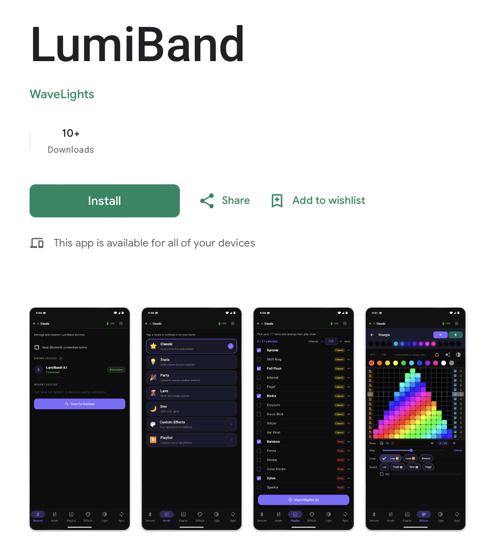

  • The LumiBand app - BLE control, animations, and the joy of app store approvals
    Markus Loeffler • 05/13/2026 at 18:10 • 0 comments
    Every hardware project eventually needs an app. LumiBand is no exception, the Gen3 uses BLE for setup and control, which means someone has to write the software side. That someone was me.
    What the app does The LumiBand app is built in Flutter, which was the right call for a solo developer needing iOS and Android from a single codebase. It handles four main functions:
    • BLE device pairing: scanning for nearby LumiBand wristbands, connecting, and managing multiple devices simultaneously. In a festival environment you might be pairing up to 6 units before a show, so the UX needed to be fast and reliable.
    • DMX addressing: assigning each wristband a DMX universe and start address directly from your phone. No laptop, no physical connector, no pulling wristbands off people's wrists. Ten seconds per unit via BLE. Once set the address persists on the device.
    • Animation control: selecting and triggering pre-built animations that react to sound directly from the app over BLE.
    • Live color and pattern editing: building your own visual style in real time and pushing it to connected wristbands instantly.
    App Store status iOS version is live on the App Store now, Apple's review process was straightforward for a BLE hardware companion app. They came back with an ask to record the app pairing with the actual wristband.
    Android is a different story. Google Play requires a mandatory closed testing period of at least 14 days with a minimum of 12 active testers before granting production access. The app itself passed review - it's purely a process gate. Currently recruiting Android testers to complete the requirement.
    If you have an Android device and want early access to the LumiBand app, drop a comment below :: looking for testers right now.
    Screenshots in the gallery above show the device pairing flow, basic modes, playlist, and animation editor.
