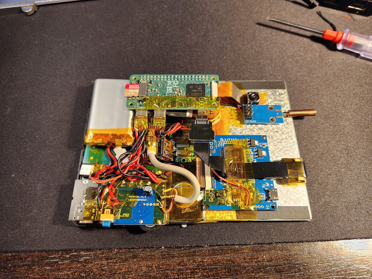

    The Scout started as a janky abomination of aliexpress modules and kapton tape. I posted it to the cyberdeck subReddit for a laugh and was surprised to see it somewhat applauded for its vibes <3

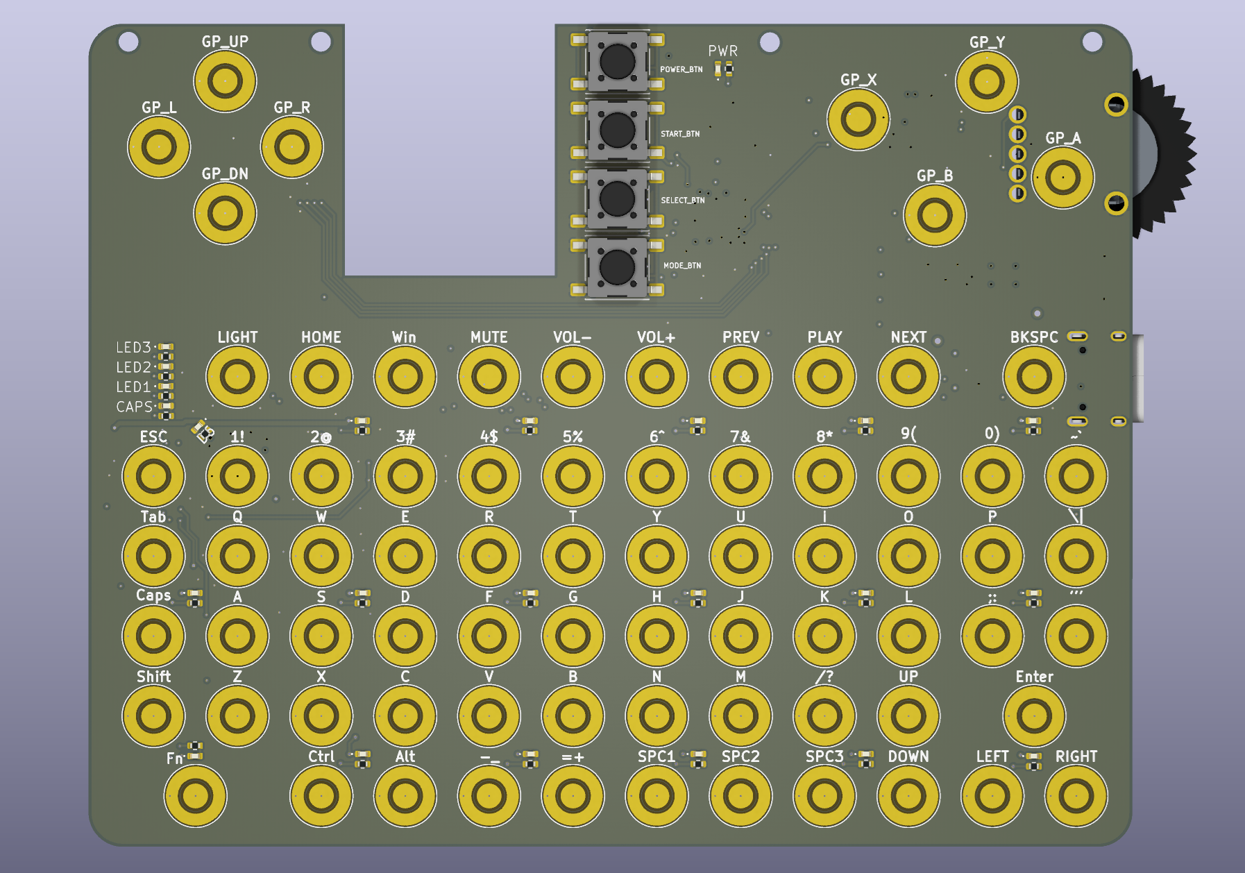

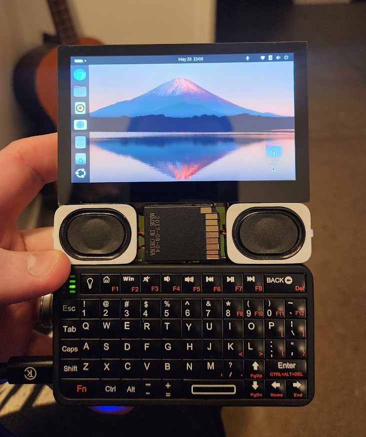

    It was centred around a Radxa Zero 3W and actually was pretty usable. Once I'd proven the modules worked, I immediately decided the bluetooth keyboard was not gonna work for me. I dove straight into designing a replacement PCB that offered USB connectivity while using the same keysheet and sticky sheet of tactile domes. I used QMK firmware for the keyboard and while I was at it, added a gamepad, audio DAC + Amp, and USB-C downstream port to it:

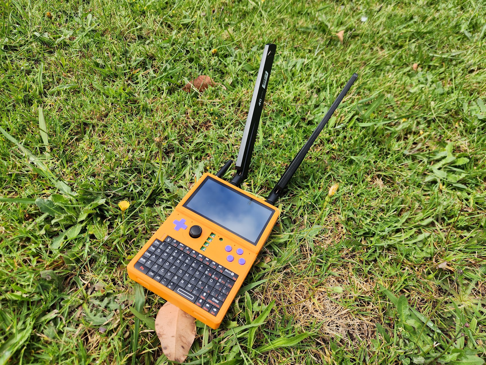

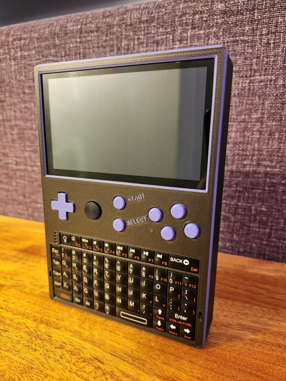

    As you can imagine I also moved immediately onto 3D printing a case for it. That turned out something like this:

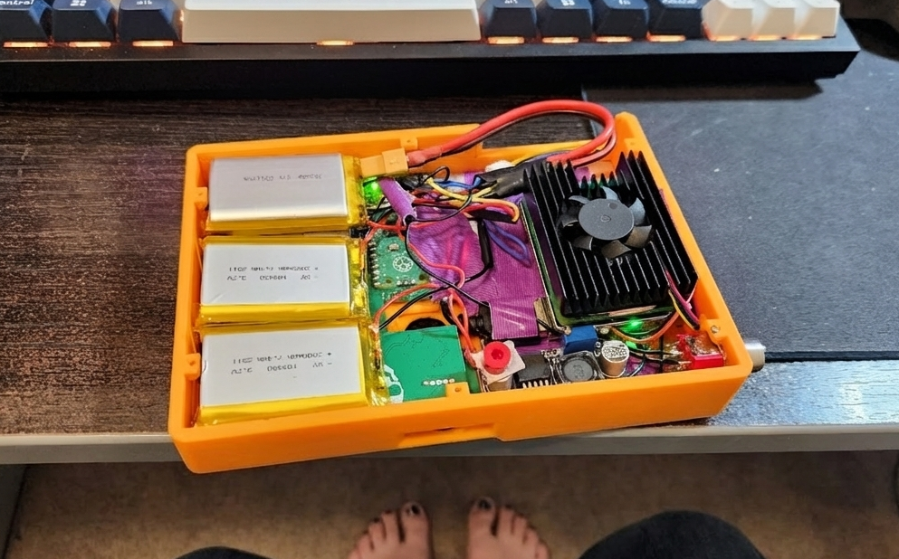

    While I was doing the PCB design I realised at that same moment that having to connect accessories to the "zero" form factor using USB and HDMI display connectors internally kinda sucked. I switched to an Rpi Compute Module 5 and the smallest carrier board I could find, a Waveshare "Nano B".
    I think at that point I was looking at this thing and seeing how much space inside was being wasted by the constraints of the ports and component layouts, so formed the idea to go the whole hog and design a mainboard. I'd be able to make it way slimmer and fit in way more features!
