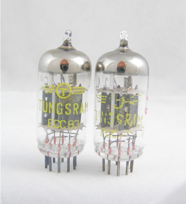

 From this project I will use only the preamplifier part with minor modifications and I will implement the power supply in a slightly different way. The heart of the preamplifier are the well-known ECC83 tubes that are widely used in quality branded audio preamplifier stages.

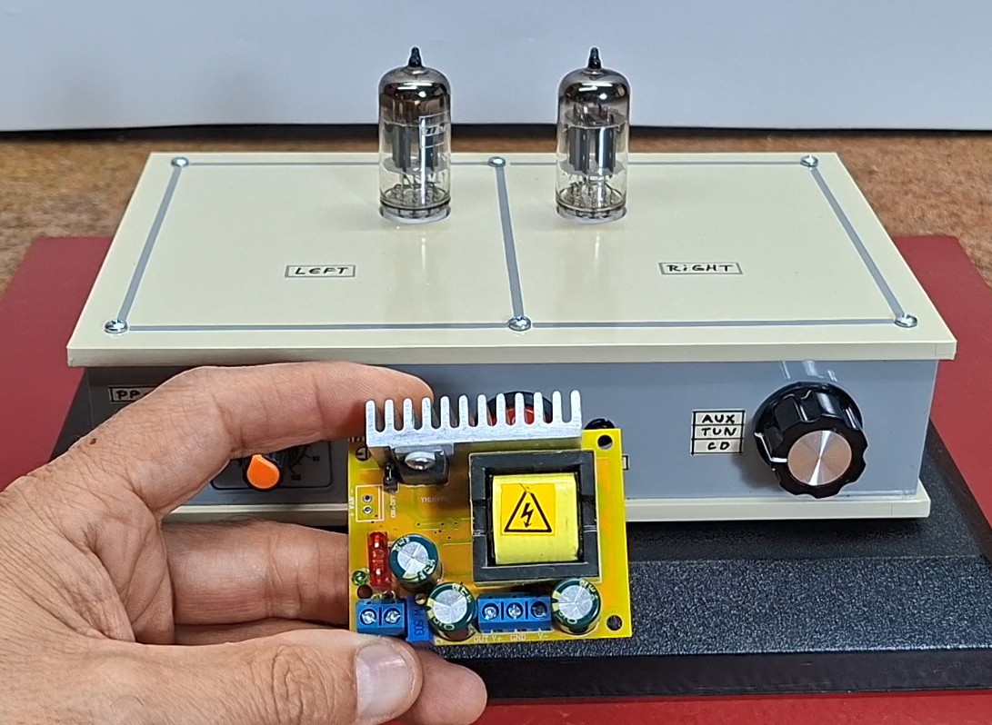

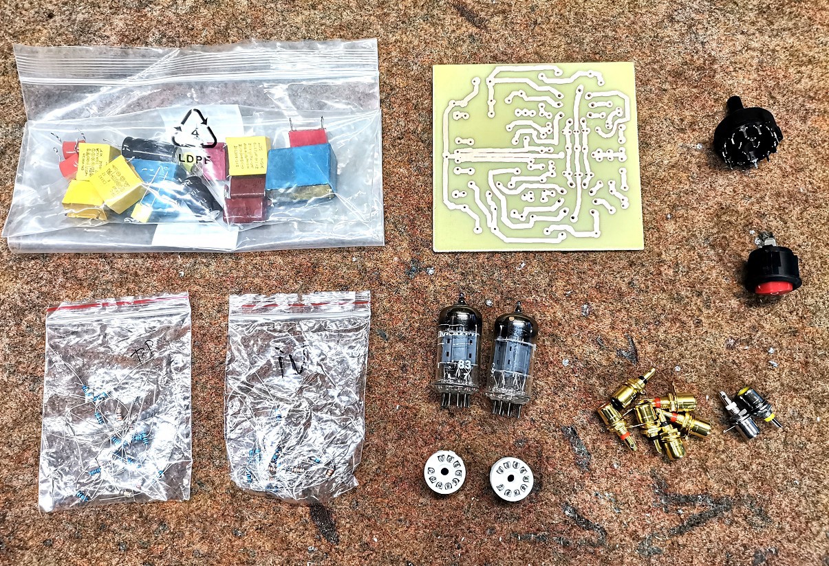

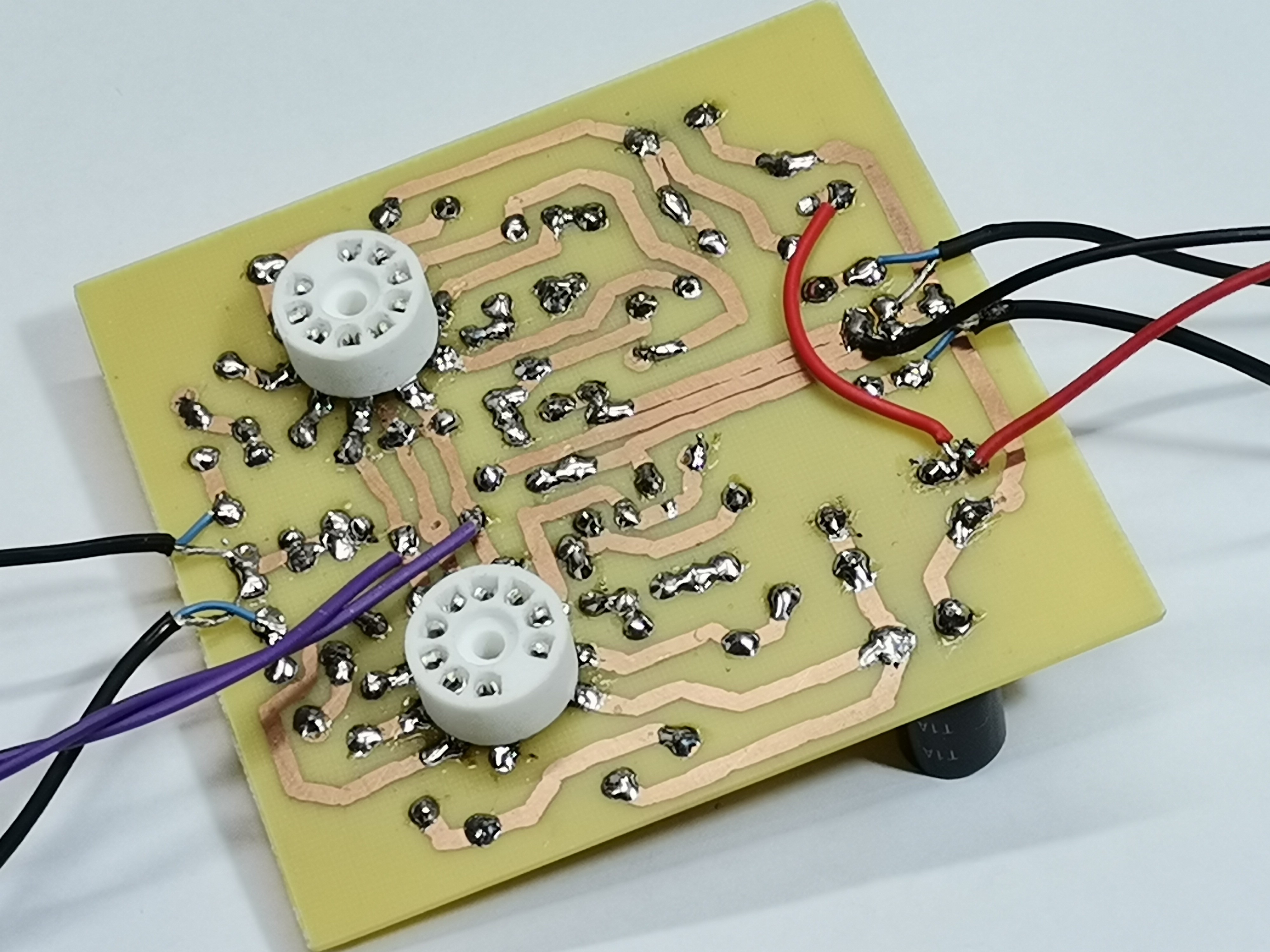

The original project contains a number of characteristic elements that are relatively difficult to obtain, but I tried to replace them with standard available components without major losses in quality. At the end of the text, the original circuit diagram for one channel is given, and the other channel is identical. I made the PCB for this prototype like in the old days by drawing with a permanent marker.
In almost all tube projects, the most difficult part to purchase and make is the power supply stage. This project in particular uses a 250V DC power supply plus 12V for heating the cathodes of the tubes. I solved this in a very easy and elegant way with the help of a cheap DC-DC boost converter.

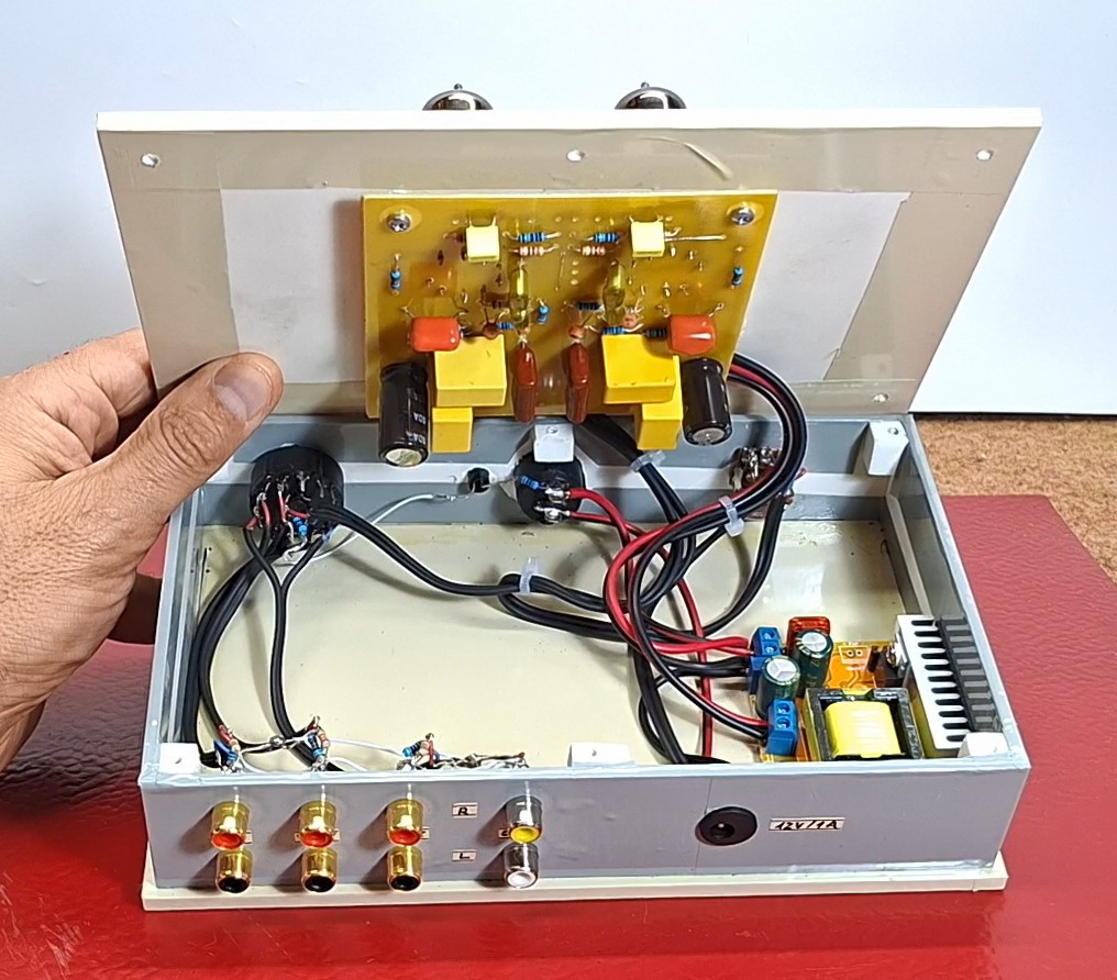

 This preamplifier does not require high currents, so this converter is ideal for this purpose. The input voltage the converter is 12V and the same voltage is used for heating the tubes. At the output of the converter, we set a voltage of exactly 250V using this small multiturn potentiometer. Now let's look inside the preamplifier. In one part there is the DC-DC module which is desirable to be shielded to avoid interference with the preamplifier. Also the preamplifier PCB as well as the input section should be shielded for the previously mentioned reasons.
The coaxial cables used should be as high quality and short as possible. For the same reason the voltage dividers are made directly on the input connectors themselves. I use a 2x6 switch to select the inputs. The original project contains an attenuator instead of a potentiometer, but for the sake of economy and simplicity I decided to use a potentiometer.

   At the time of production, I did not have enough quality MKP capacitors, but I will certainly purchase and install them in place of the standard ones in the future. Also, the tubes I use in this project were taken...
