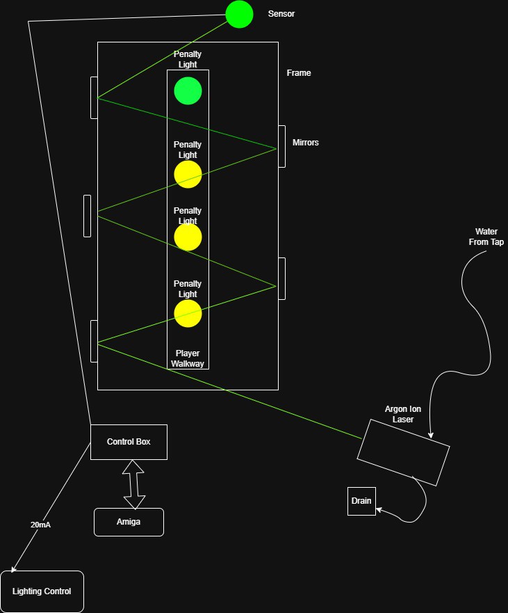

Our job was to:
* Detect the laser beam
* Feed that signal into the Amiga
* Let the Amiga trigger a signal back to the control room
* Convert that into a 10V control signal to drive a studio light
DMX was not used in the studio...everything was analogue.
The production would supply the lasers, Amiga, mirrors, and mounting. We had to build the electronics to tie it all together.
We were told the laser would be “visible”. We accepted. Given a deadline, we got to work.
I found an optical sensor that worked across most of the visible spectrum and designed the circuit in EasyPC (still going!).
Input to the Amiga was simple—a transistor switching 5 V.
Output to the control room was more interesting.
The control room was about 100 m away and electrically noisy. I used a 20 mA current loop to send the signal reliably. A second box in the control room converted that back and drove relays, switching a 10 V signal from the lighting desk.

They produced blue and green light. The blue was removed using internal optics, leaving the green beam, which was fed into a built-in galvanometer scanner. The system switched the beam between two paths to make the maze more difficult.
We only had a single optical sensor. The beam switched paths in milliseconds, so the Amiga software simply ignored that brief gap.
You can see the two beam paths in the screenshots—the sensor sat at the final section where both paths converged.
Granada built the frame from 20 mm box section steel, with a raised walkway down the middle. The beams ran roughly at knee height.
When we arrived to set up, we discovered that mounting everything to the same frame was a mistake—any movement caused enough flex to throw the beam off the sensor.
Our fix was… direct.
We got an angle grinder and physically separated the walkway from the optical system.
Problem solved.
Here's a diagram of the system
