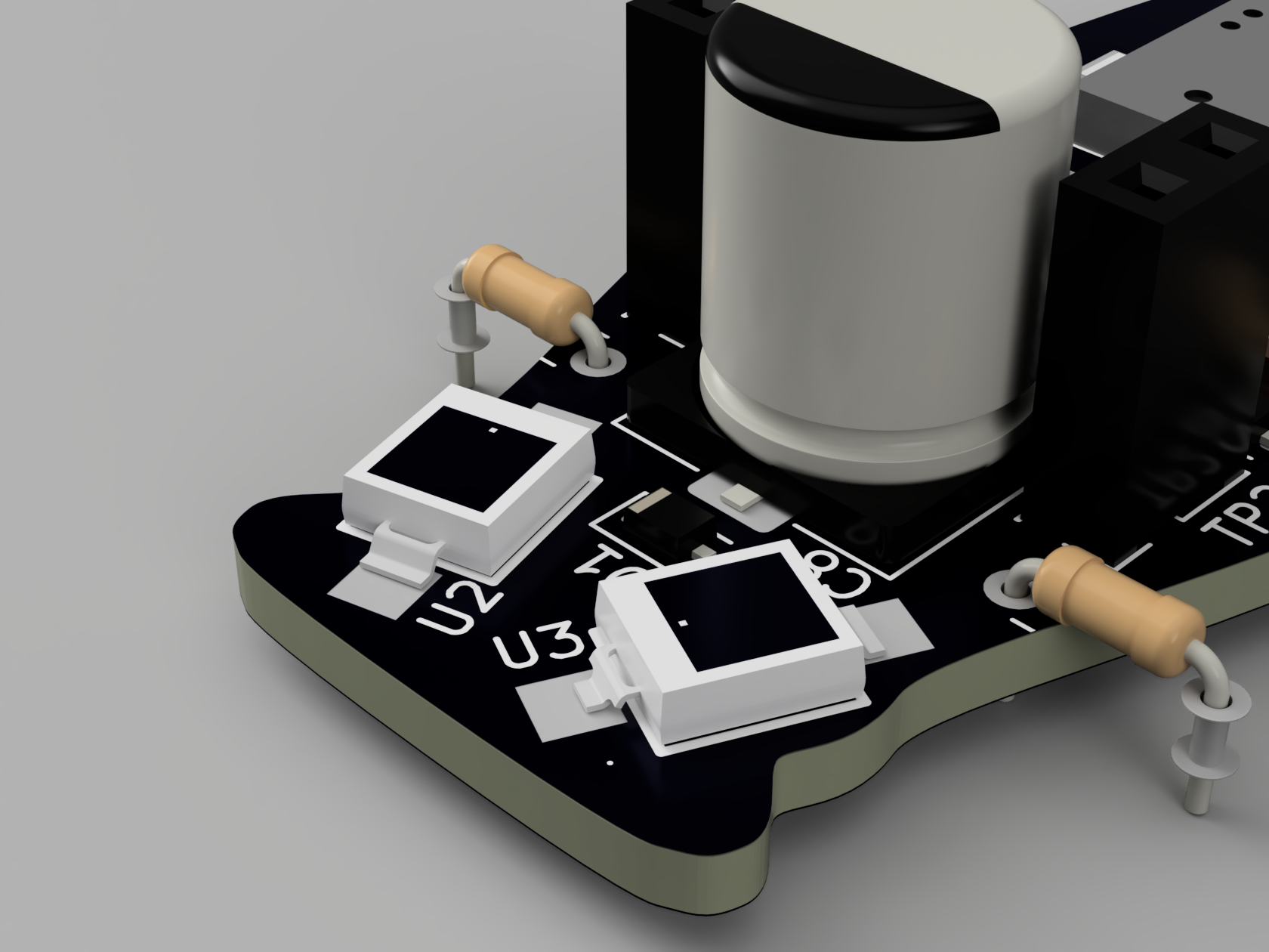

The initial thinking for solar cells was to use BPW34 photodiodes which was inspired by this photodiode powered BLE chip. This made sense to go on the wings and it was the initial starting point of the project concept as it would look cool and capture plenty of light while the blue shade would add some nice contrast to the design.
After exploring the power we'd get with the photodiodes, it seemed less feasible. As an option, we kept the photodiodes on the main board design but depopulated it and rather went with KXOB25-03X4F-TB to make it more feasible to achieve its ambitious goal.
Here are the BP34W and KXOB25-03X4F-TB cells side by side.

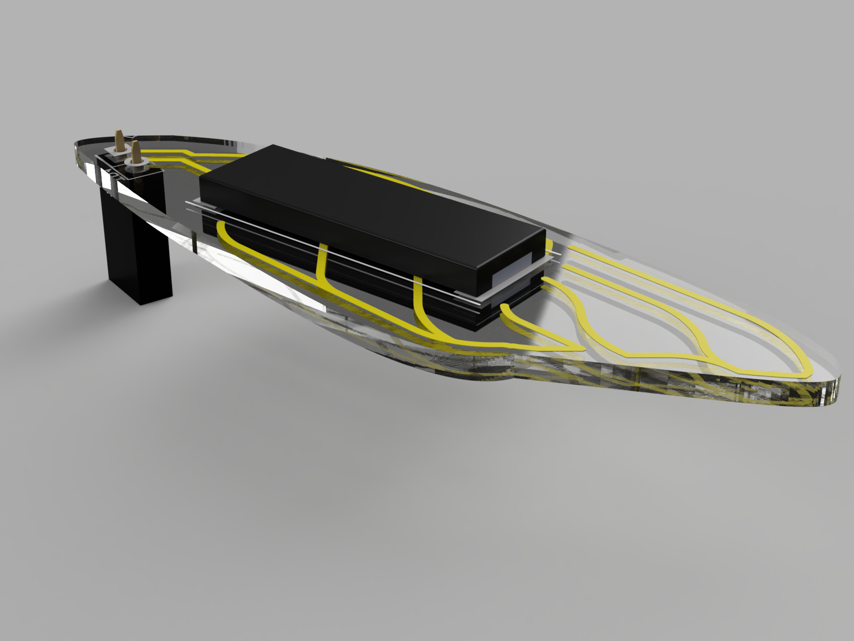

We used tracks in a combination of functional and aesthetic ways, playing with the inherent rigidity of pcb design and the organic shapes of the cicada's wings and veins.
The original plan for the wings was to have them made from PCBway's new glass PCB material. We think 1mm thick glass would look great and also want to try out this new material.
Since the process of getting glass PCBs isn't as straight forward as transparent FPC, we have decided to start with transparent FPC for now while we explore the glass PCB option with PCBWay.
The problem with the FPC approach is the 0.24mm thickness of FPC which we plan to stiffen a bit with some clear acetate sheets.

We've included some optional 'eyes' to the main cicada board. We've kept them unpopulated for now but will try running the system with only 2x BPW34. The charge time may be much longer on indoor light but it would allow for the wings to be clearer and make the aesthetics cooler.

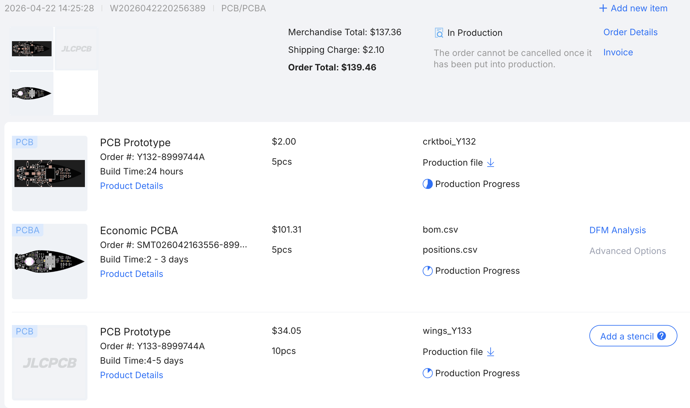

The initial PCBs should arrive soon from JLCPCB and we will write up some updates for its first power up.
